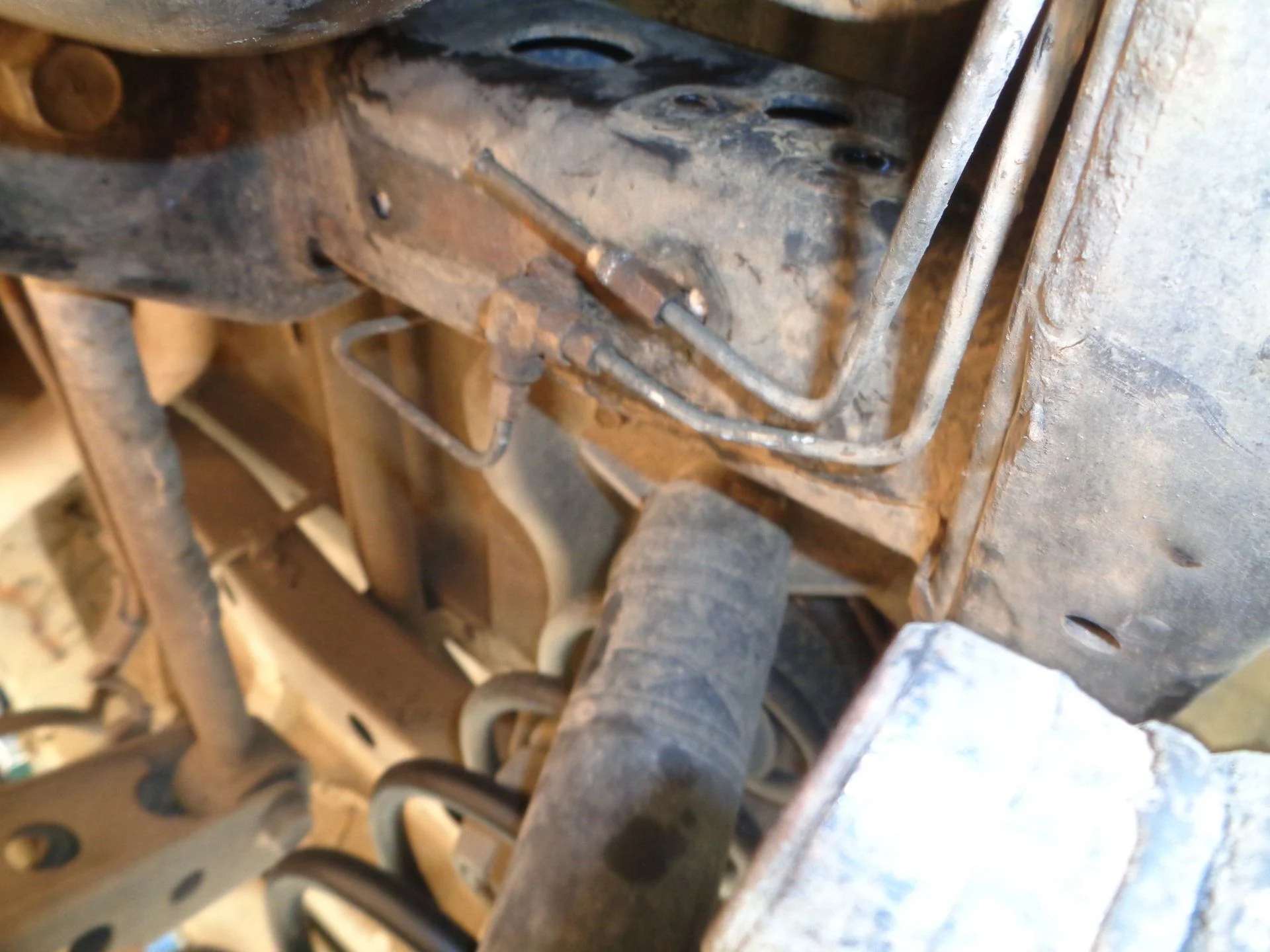

Started the process of deleting the ABS system will post pictures of end result. There is a lot of room now though for something on the drivers side now. Once this is complete will need to get serious about deleting the egr system and replacing vacuum hose.
Cool... Rob and I both want to do this delete on FOO and Lexi. I have all of Erik's brake line tools right now, so if you need to bend up a line let me know, and we can make three of them.
I was able to bend the lines to make the connections needed under the hood by hand I think that is what the person I am kind of copying did with his and it seems to have worked. Also I took parts from the 94 so that I already had some of the prep work done to start so with my now spare T piece and small line we could prep one vehicle at a time.

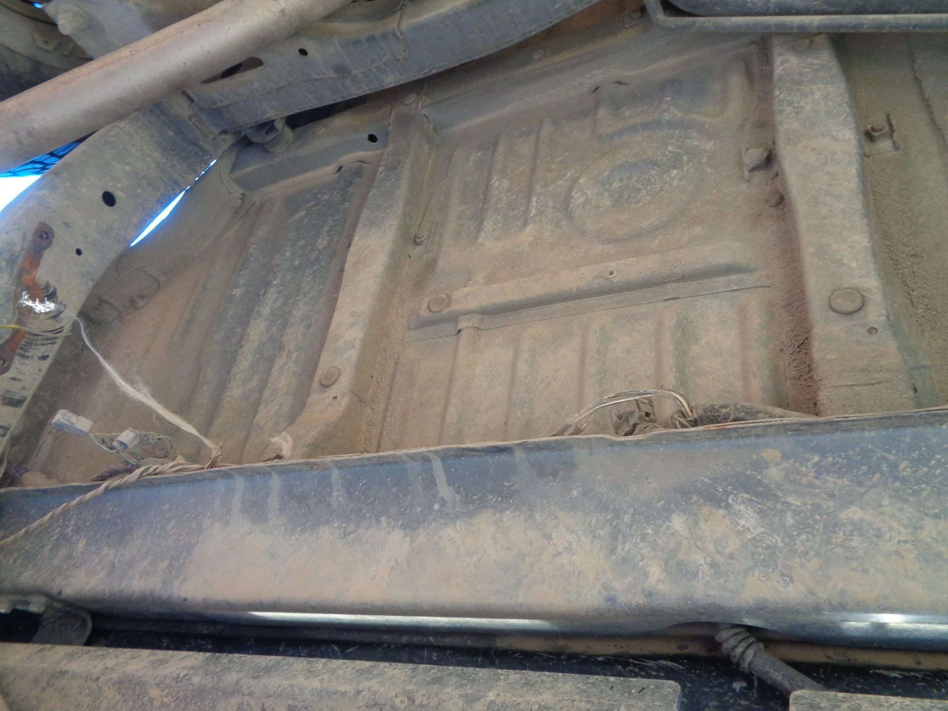

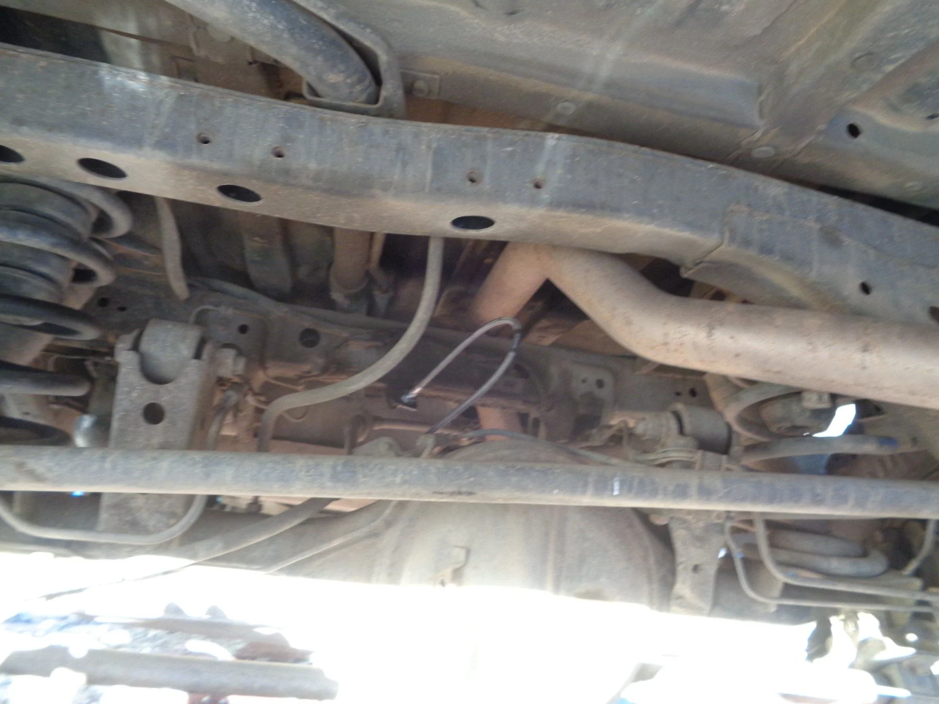

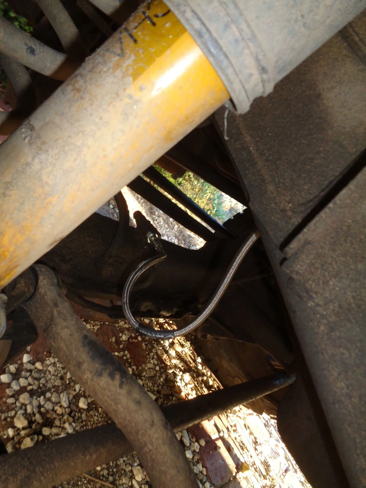

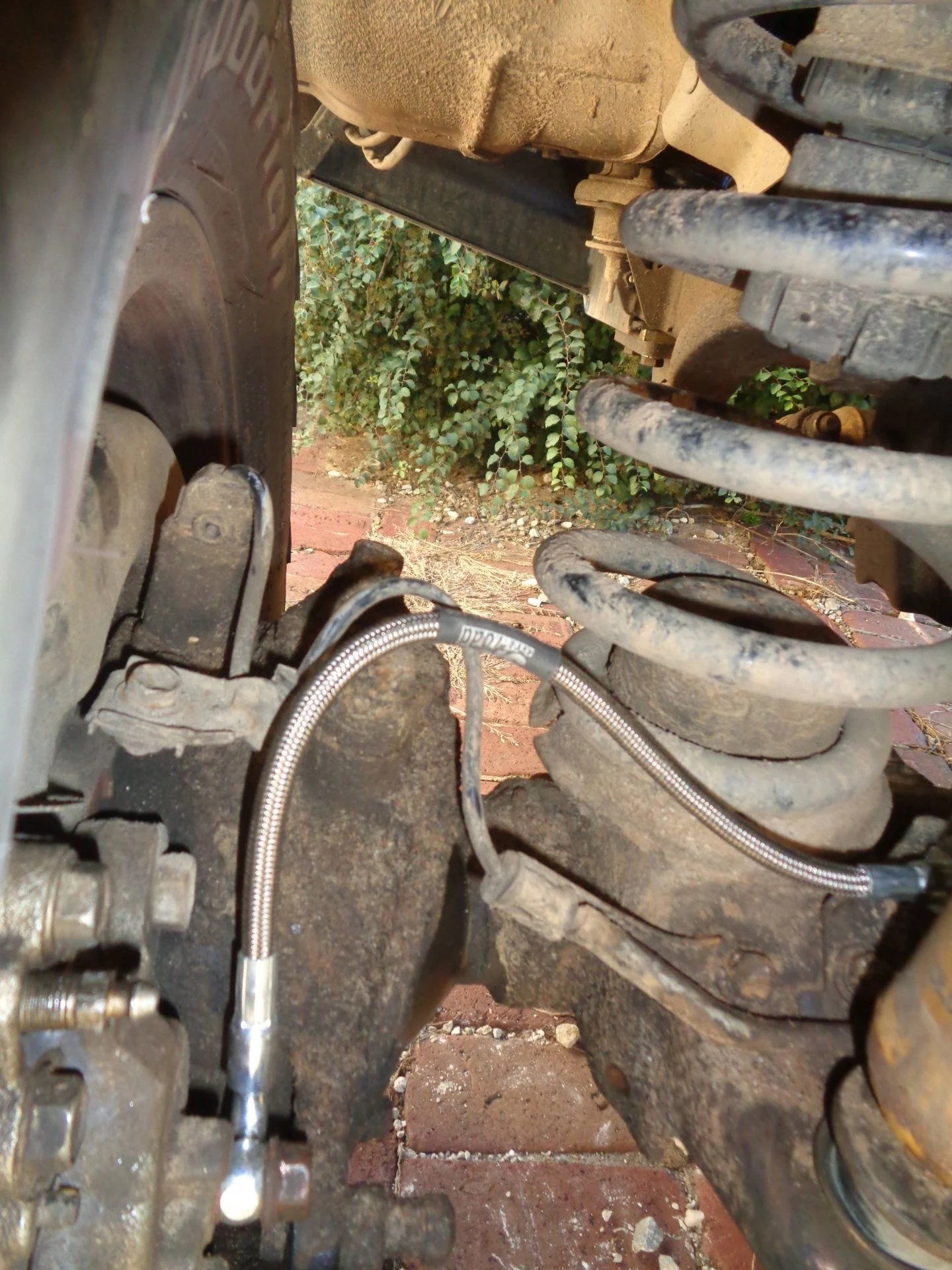

Ok finished up the ABS delete and installation of Slee ss brake lines on Sunday but my computer shot craps so had to wait for new ribbon for hard drive before posting up after pictures of the install. Also broke the bolts holding the LSV so will need to get those pulled out so I can use the spare bracket with elbow that I have.
