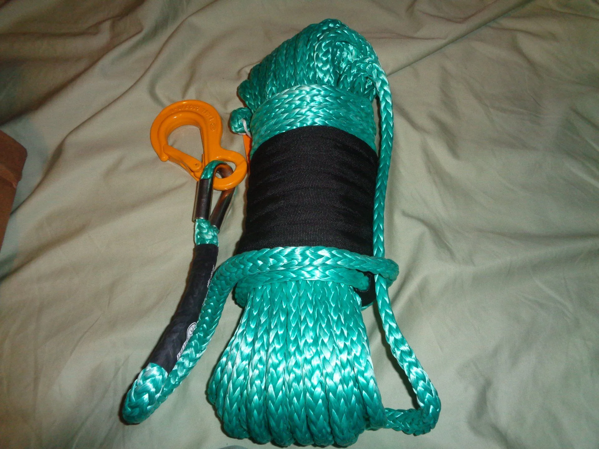

Well I finally purchased a rope for my winch 100' of teal colored diamond line with the excel hook, now if I copy @half k cruiser and get dobison springs for Zippy the colors will match. Also included is a sticker that came with it that I am not allowed to put on the truck…
Well I finally purchased a rope for my winch 100' of teal colored diamond line with the excel hook, now if I copy @half k cruiser and get dobison springs for Zippy the colors will match. Also included is a sticker that came with it that I am not allowed to put on the truck…View attachment 1510392View attachment 1510394
WTF ? I didn't know that color and that sticker were an option.
