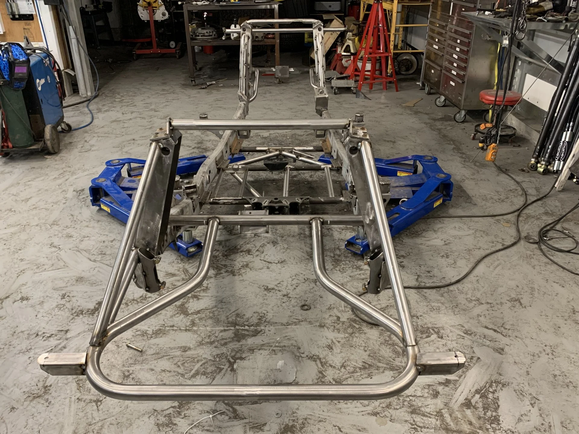

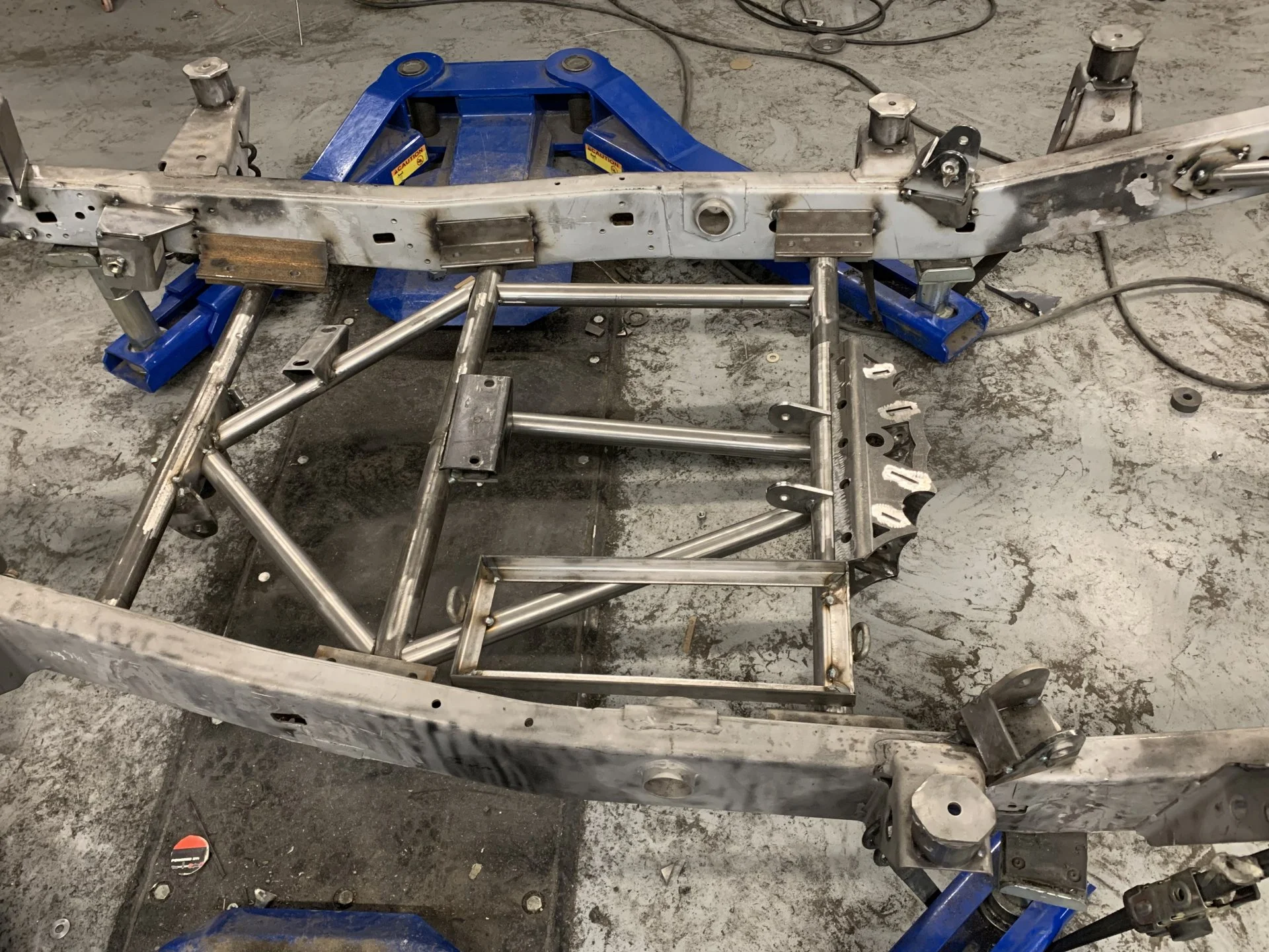

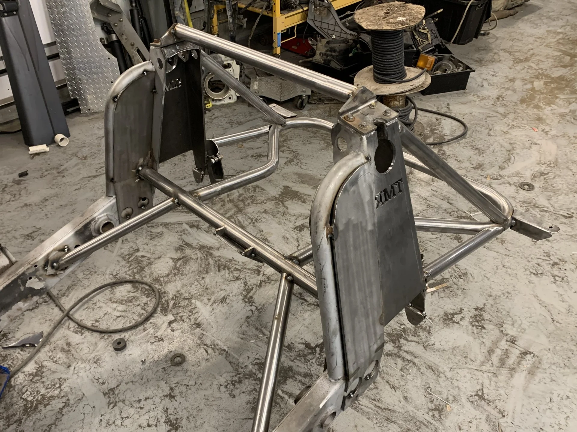

Ive actually been working on this. Other than a few gussets and tabs, the frame is ready for final welding.

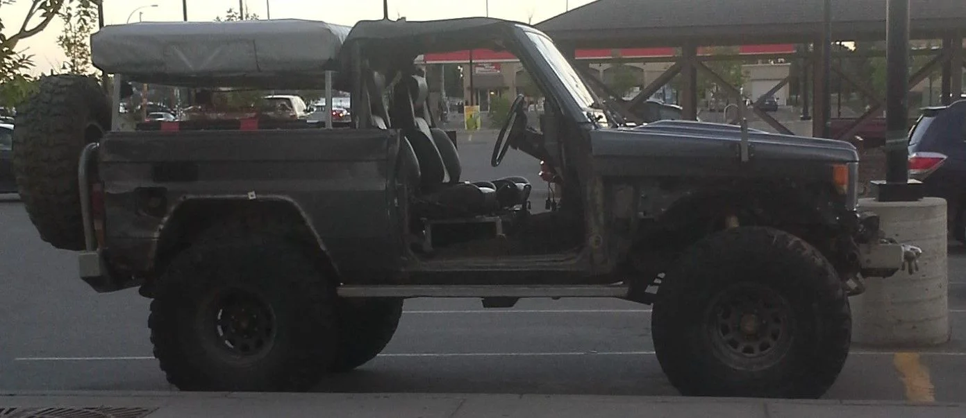

Some of you may remember Ziplock, my first BJ74, first acquired in 2002. It was always my 'back-up' wheeling rig, but eventually became my go to off-roader. It had a spring over, 4.88 gears, one of the very first Marlin Toyboxes, factory cable lockers, 4x4 labs steering with home-made assist ram, longfields, roll cage and 40" tires.
Together, we went a lot of places. Rubicon, Black Hills, Canol Road, Moab, Satan's out house, most River Shivers, and a T-Bar, that I can think of... Memories.
But, I rolled it in Moab (Area BFE, Green Day trail) in 2015.
Twas merely a flesh wound. I ordered a whole new fiberglass clip from Australia (Hood, fenders, windshield etc), and it was back on the trails by July. But, the July long weekend trip in 2015 would be one too many for poor Ziplock.
Ziplock's last stand....
During that last trip, the axle housing that I bent on the Rubicon in 2006, then further bent on the Alaska highway in 2009, was right fully twisted when it was rolled over back onto it's wheels in Moab. The Full Float axle shaft was shearing off studs. But what really did it in was the classic Toybox / H55F failure which we now better understand... I towed 45Kevin some 32 kms with a dead clutch off the trail... all that torque overcomes the clamp that Marlin provides to hold the output shaft of the H55f, and causes the output shaft to bind against the input shaft. So, I had a bad transmission in need of a rebuild, and a bent axle housing. For those that know me... you will know that this is the EXACT combination of failures that triggered me to build TippyR back in 2002, and put 53" tires on my 60 series (see avatar pic)

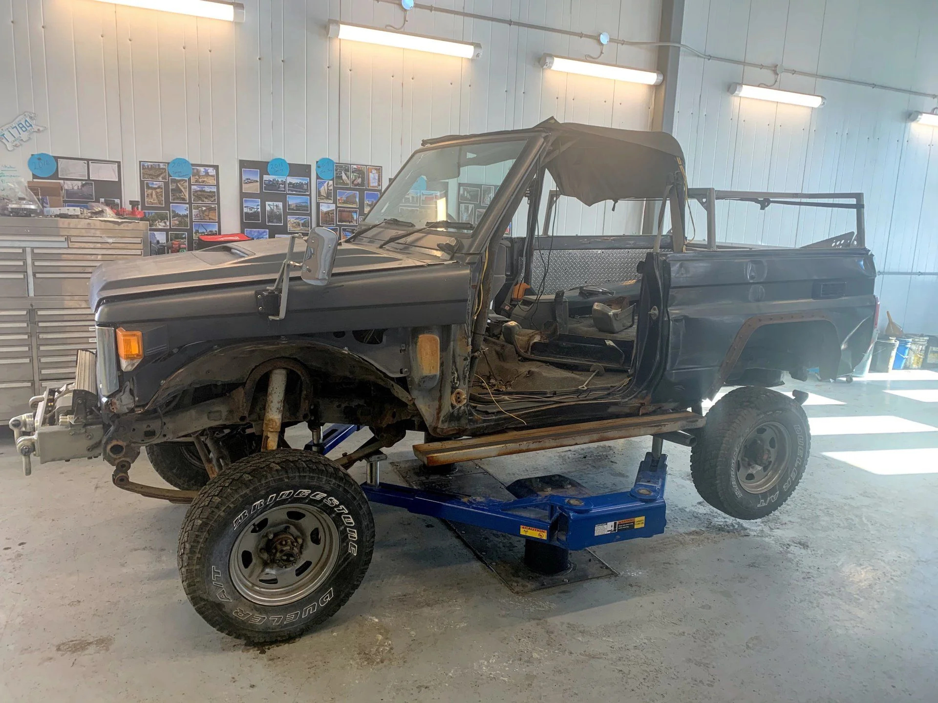

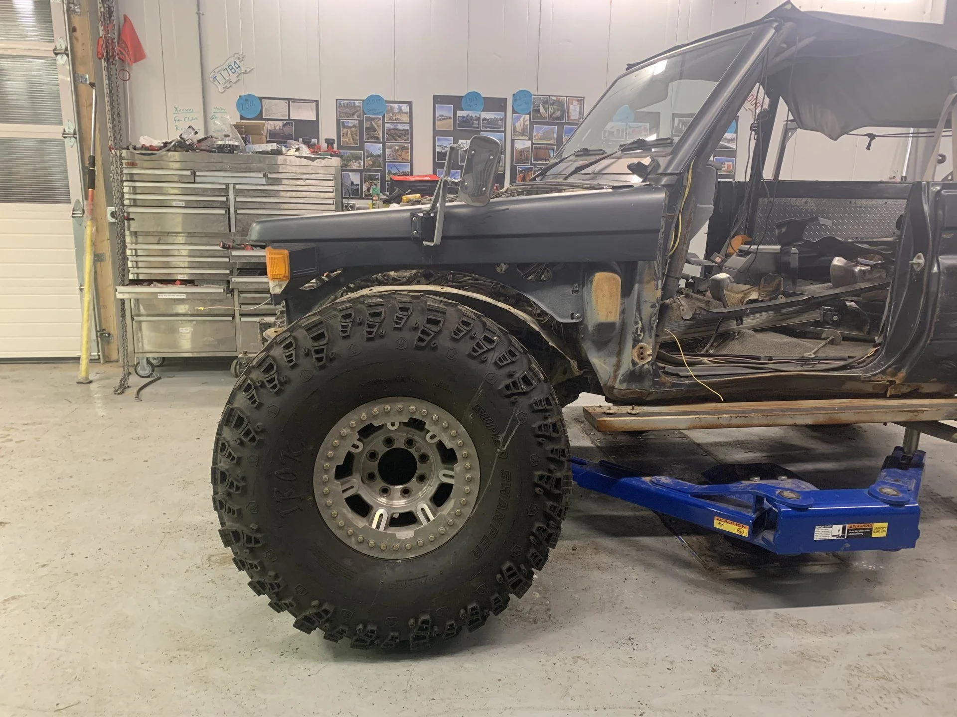

This weekend, I started ziplock's revival. I towed it into the shop to asses the situation.
It's been scavenged for parts... Headlights, Seats, alternator and a/c compressor all stolen for the other BJ74s. Tires, lockers, gears, longfields and air compressor are now in Shaker the BJ42. Tub is in bad shape - the 3 or 4 roll overs over it's life have take their toll. And 18 years in Canada has exposed all the rust spots.
The first step is to strip it down. I am going to pull the body entirely off the frame so I can fix the suspension, but before that... I already have the tires... 42" iroks. some inspiration...
This would make the wheelbase about 118", up from 105. It would enable a fantastic approach and departure angle! What do you think?
118” WB is longer than a Troopy! 🥶 sick project. Love seeing 70s built to wheel HARD 🤘

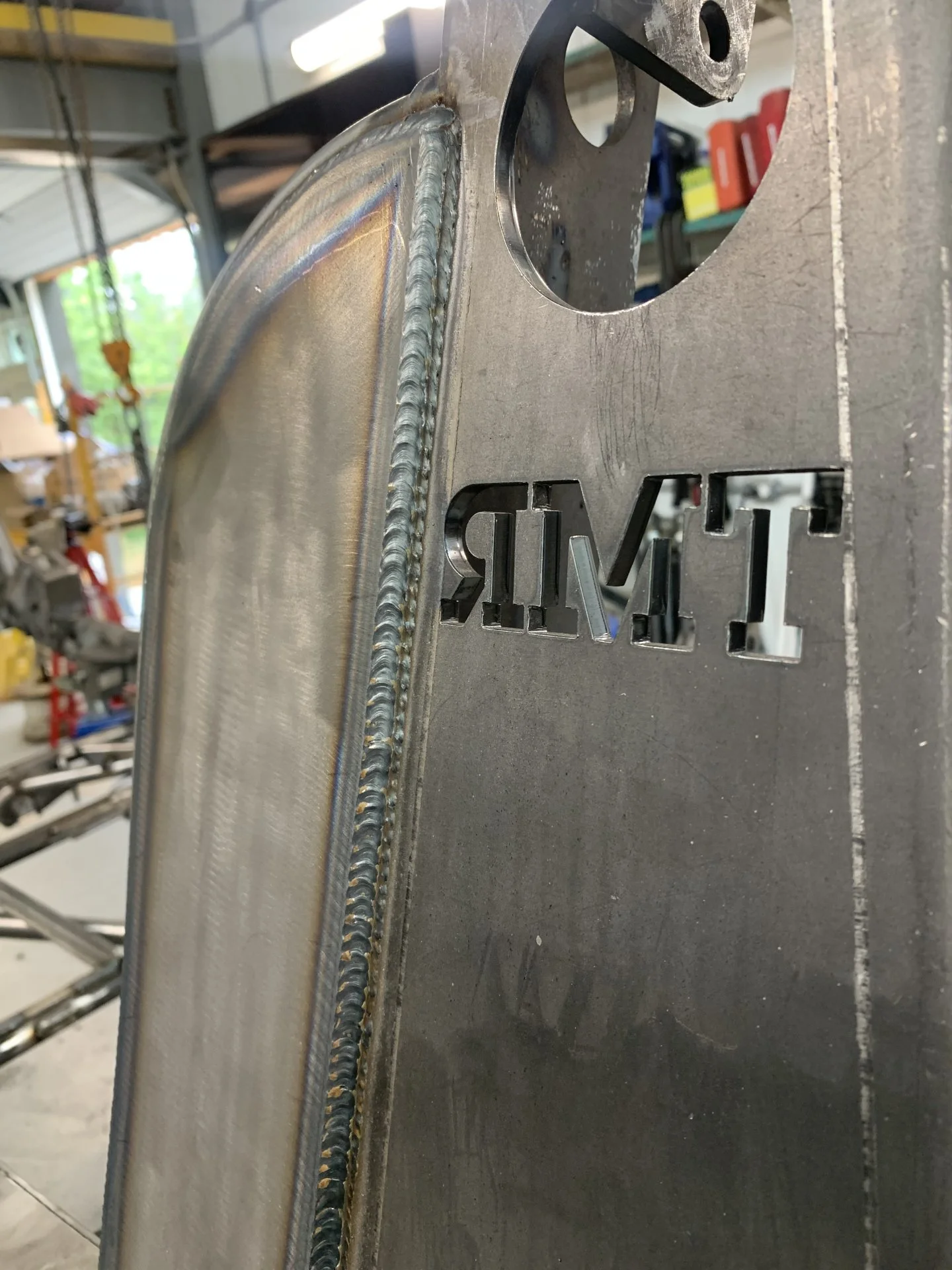

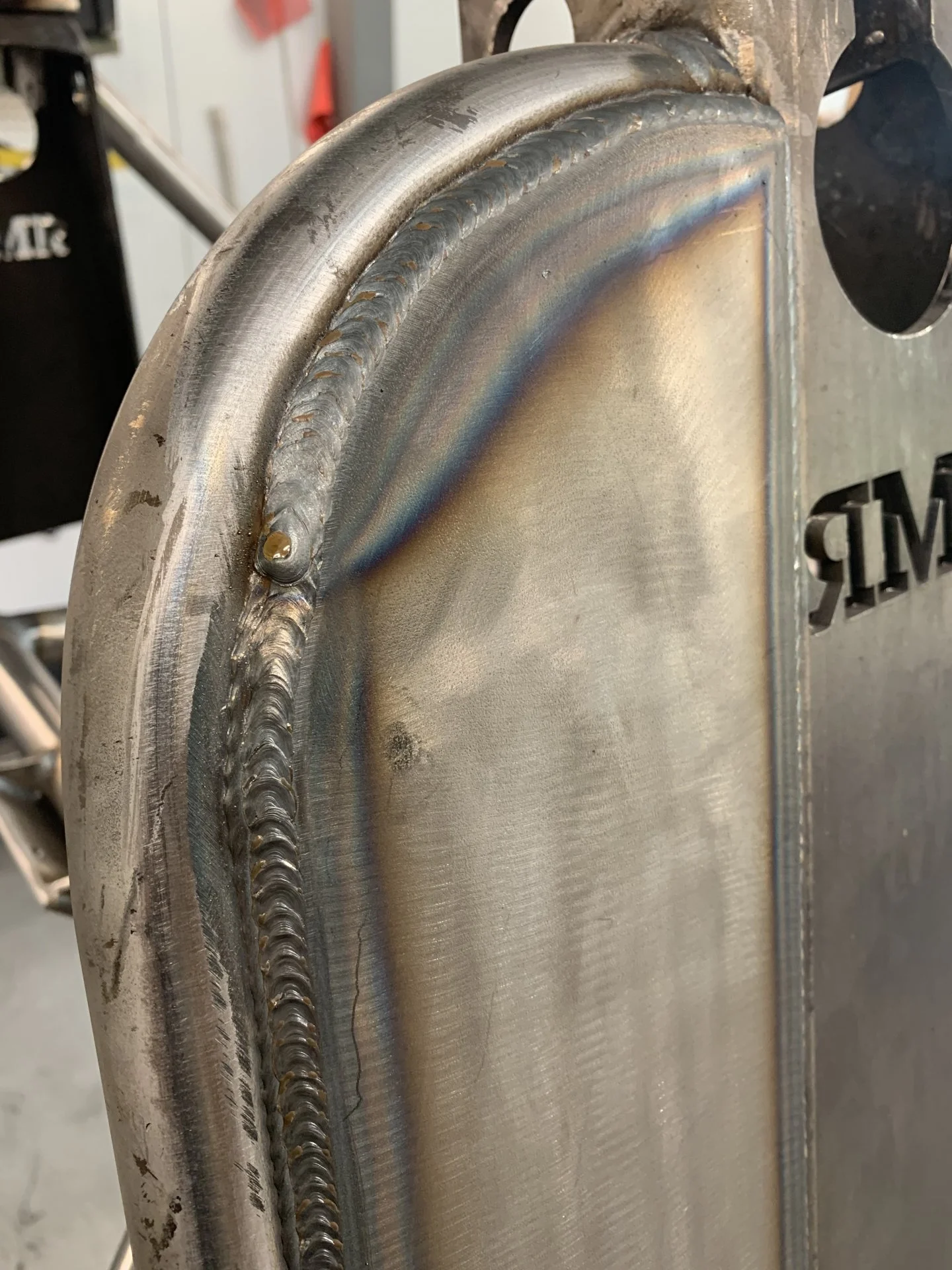

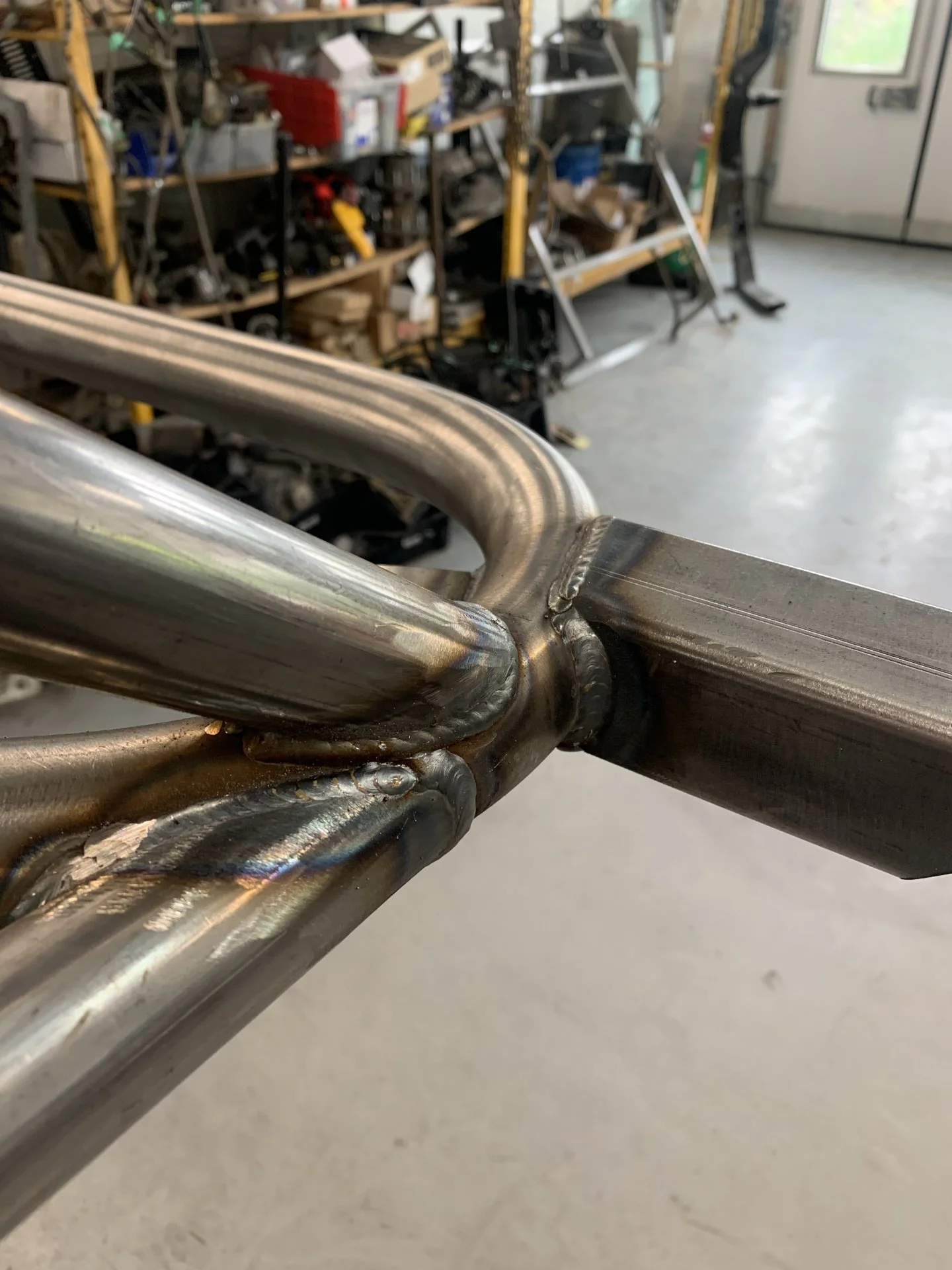

Frame welds. #KnowYouLimits #HireAWelder

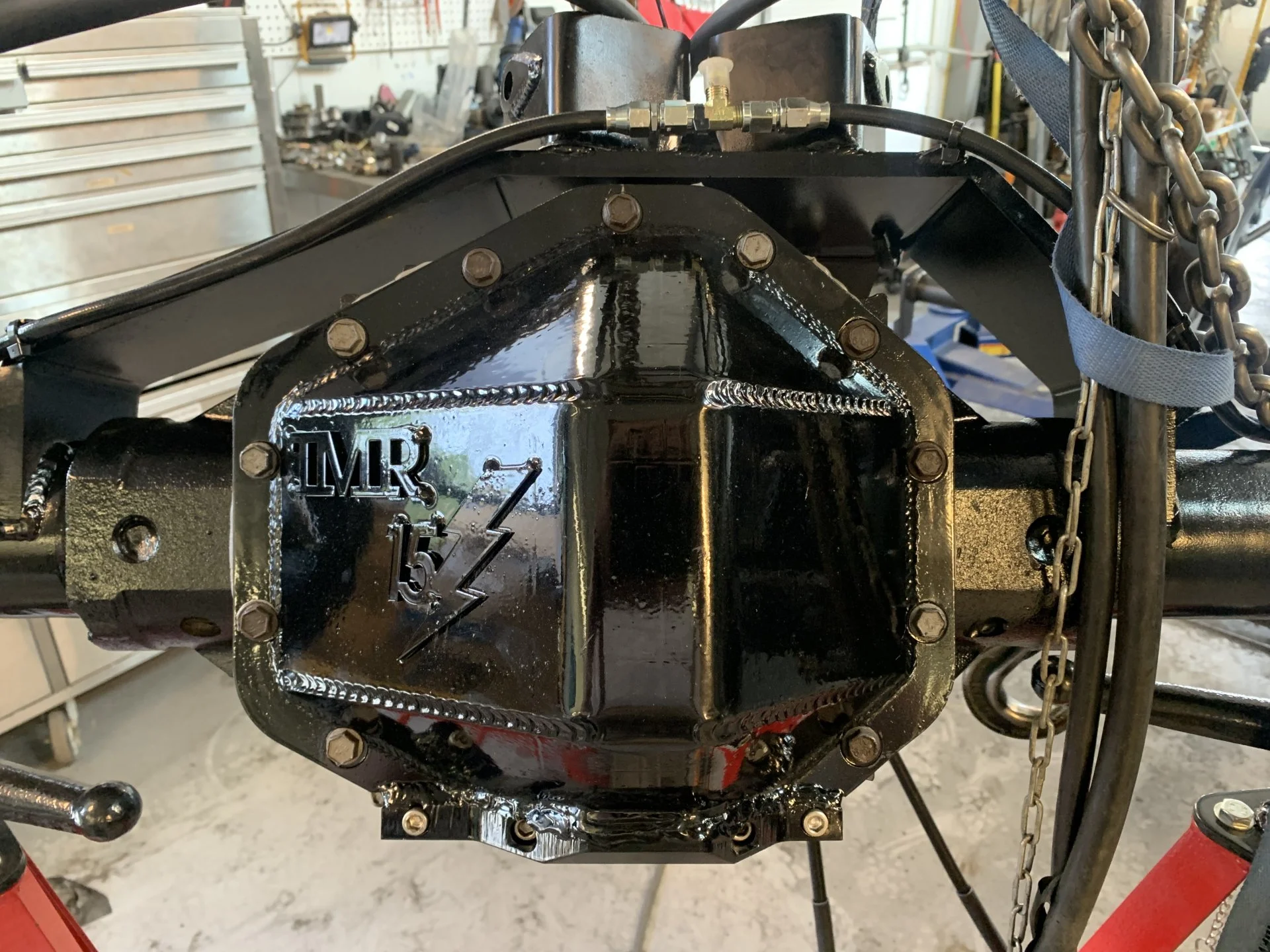

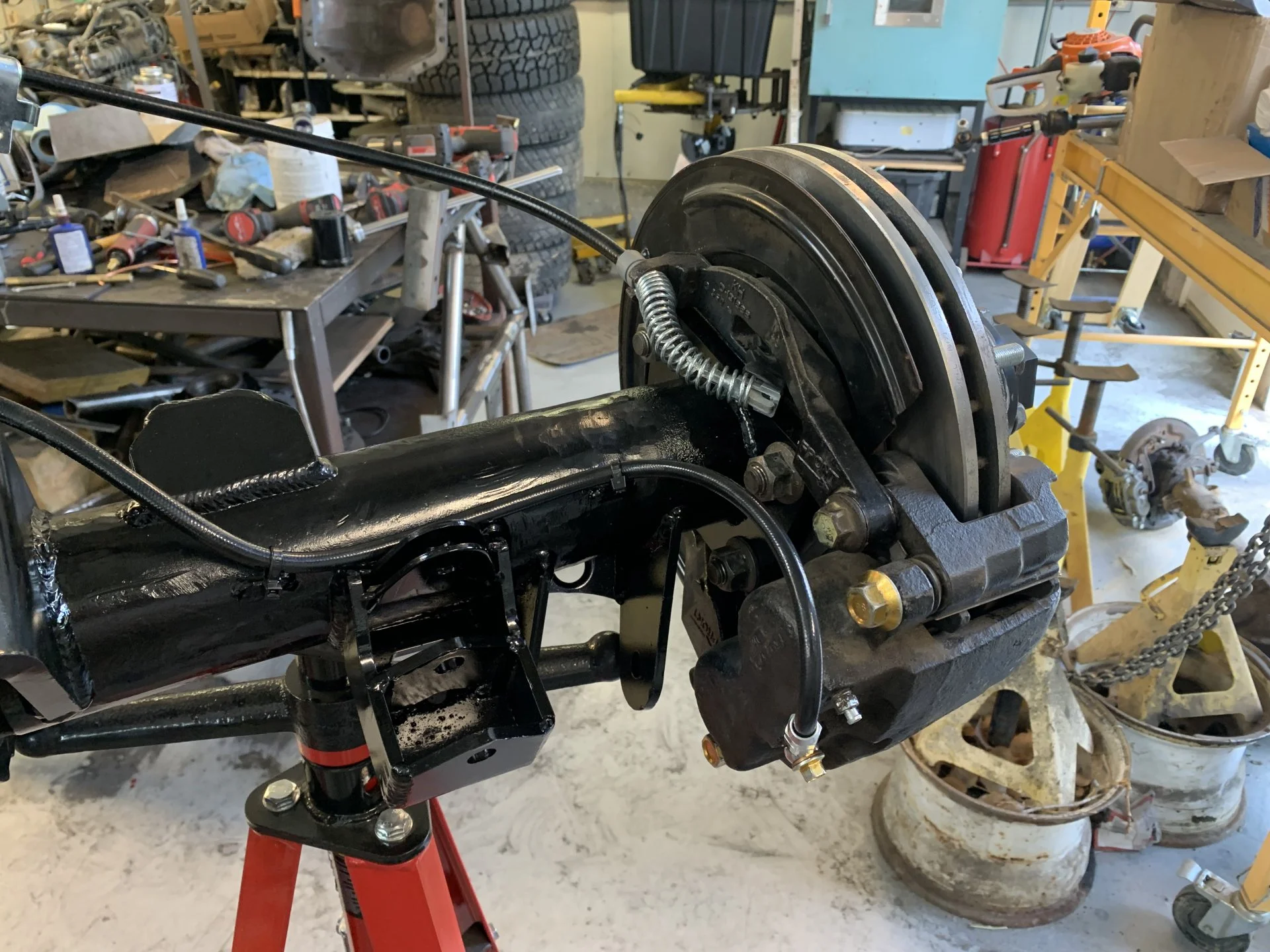

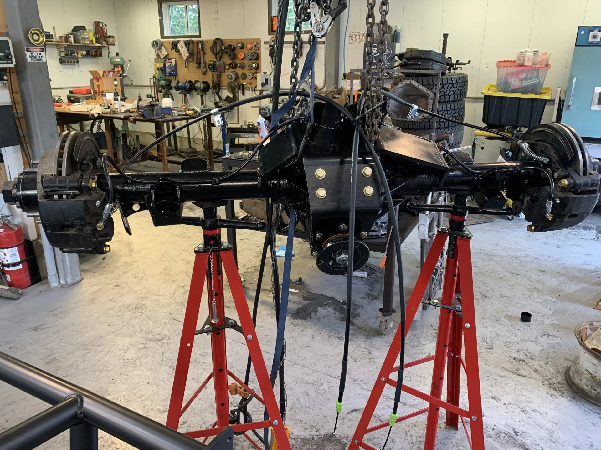

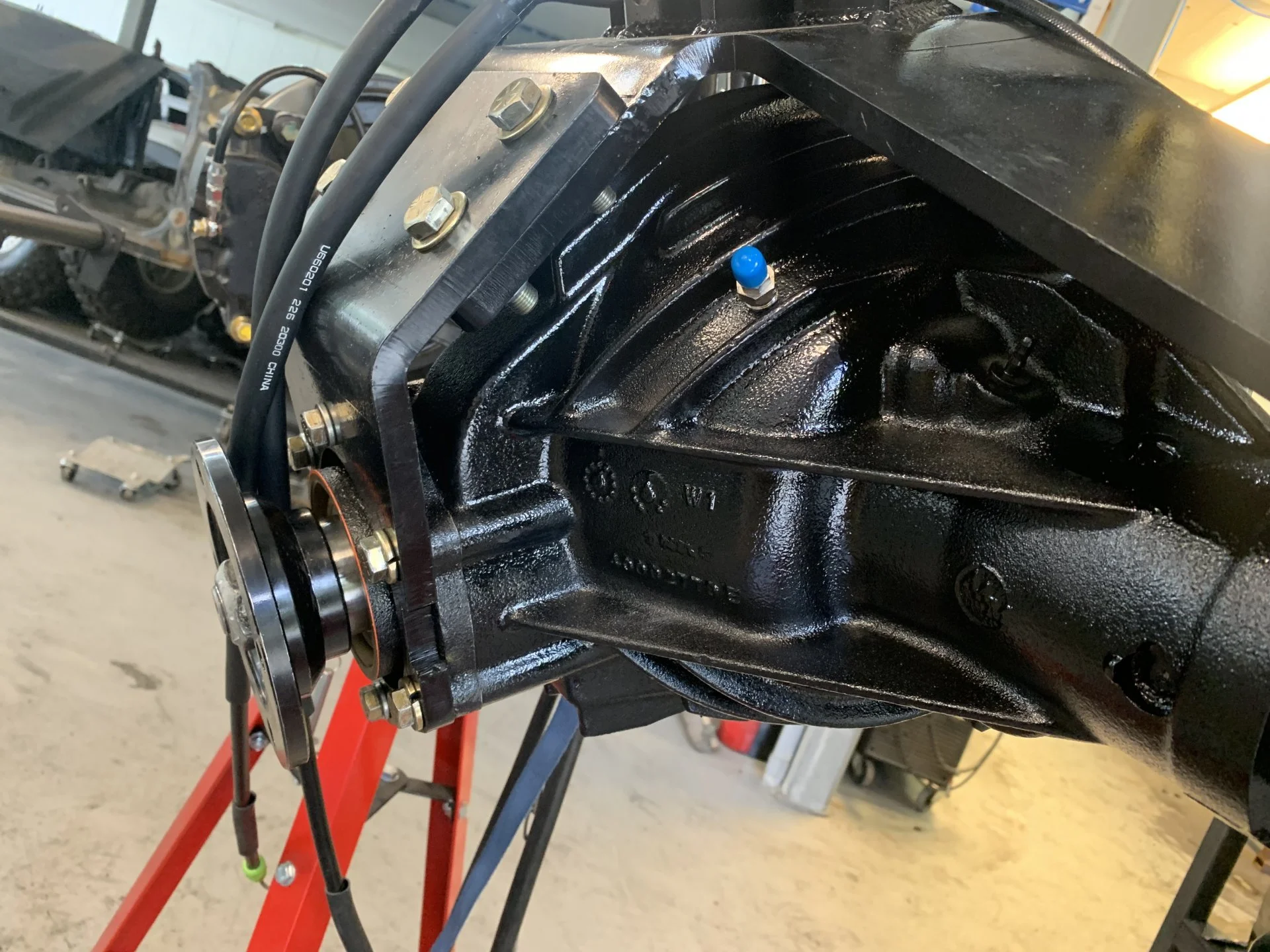

Rear axle:
Full float 14 bolt (originally a drum brake from a late 90’s E-350 van) converted to factory disk/parking brakes from a 01-11 GM 2500HD.
Housing narrowed to 63” WMS and diff shaved with TMR kit. 5.38 Nitro gears (also shaved) on ARB air locker.
Custom RCV axle shafts.
Lots of TMR stuff on this including link, shock, limit strap, zip tie, and tie-down brackets, shorty truss, pinion support and diff cover.
Pinion flange is the rockwell 1480 flange.
All assembled, torqued, sealed, painted, adjusted measured, bench tested and ready for install. <note to self… it still needs oil>

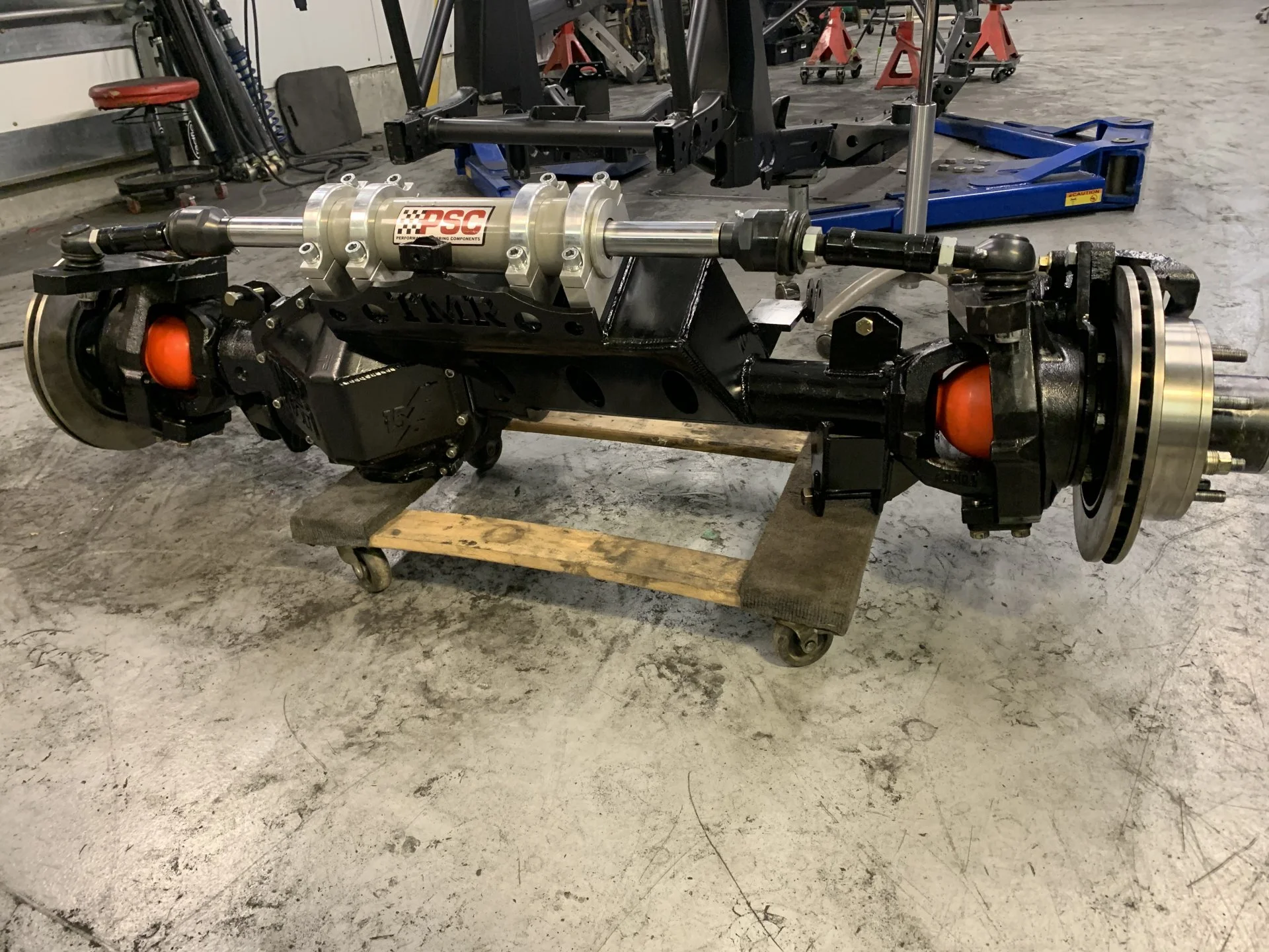

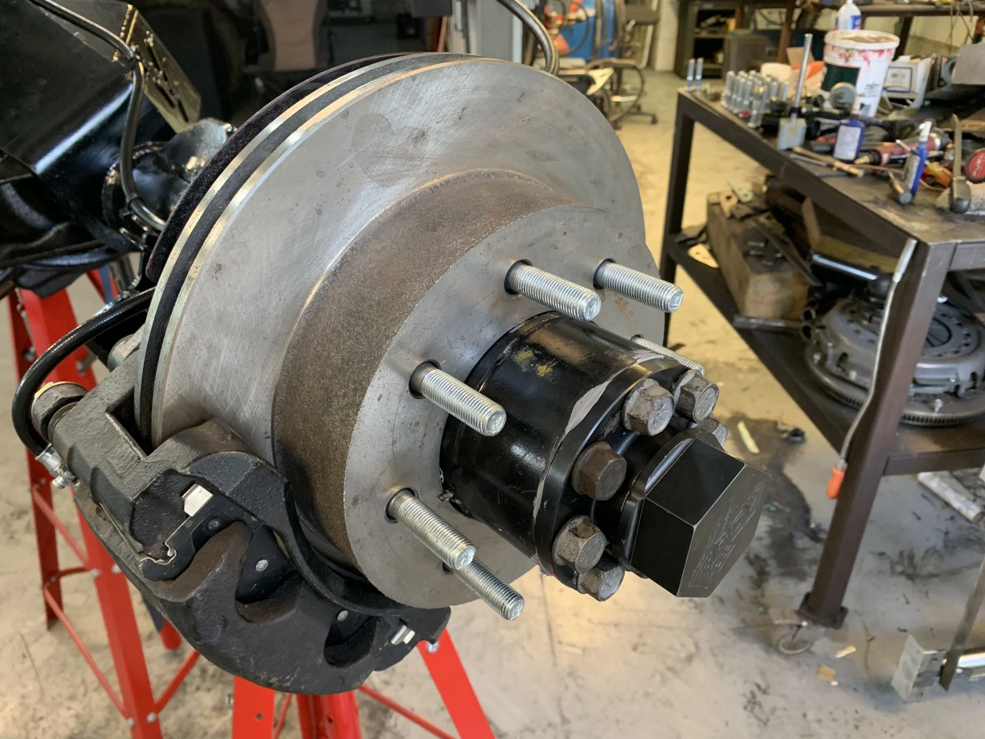

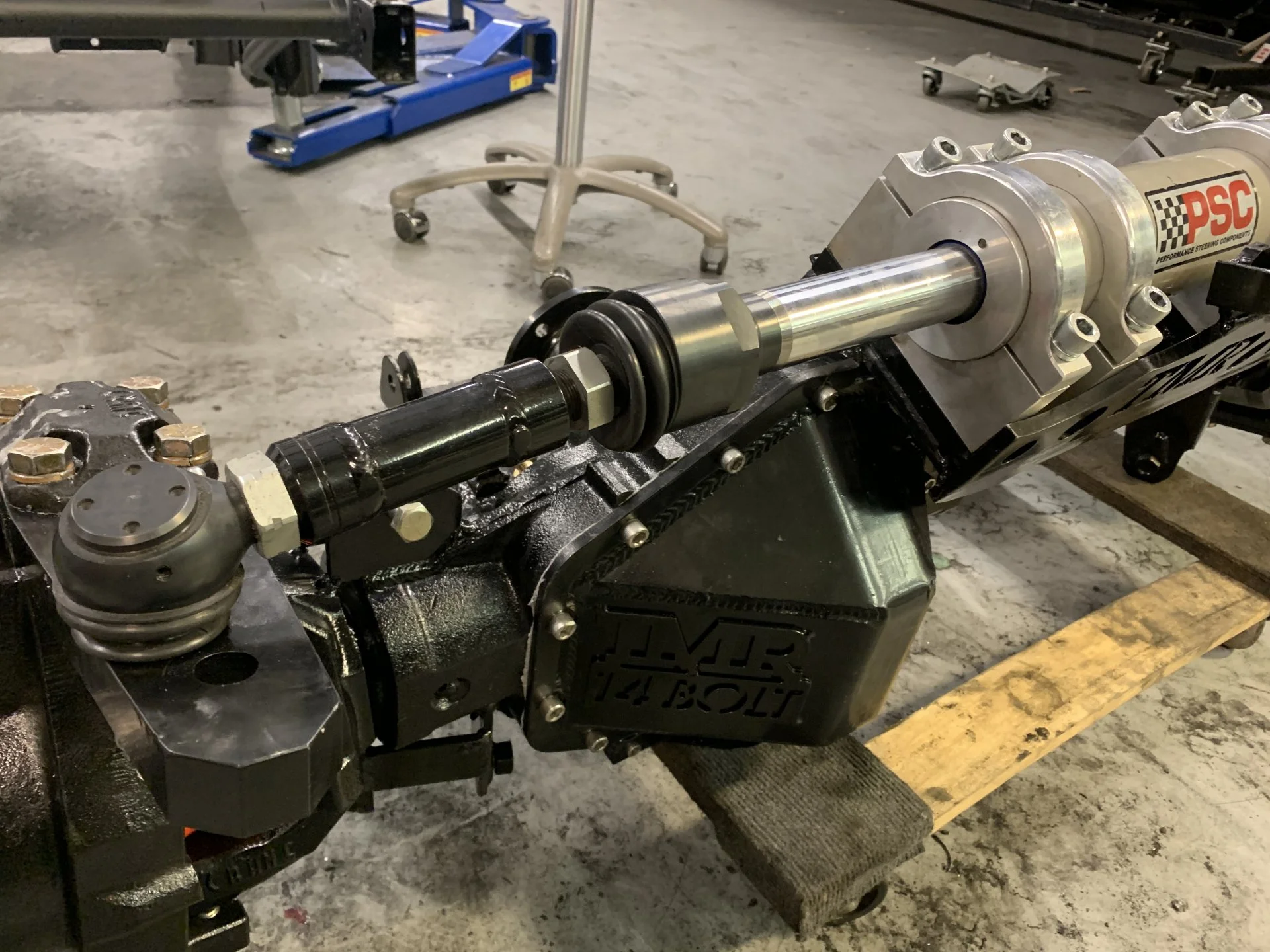

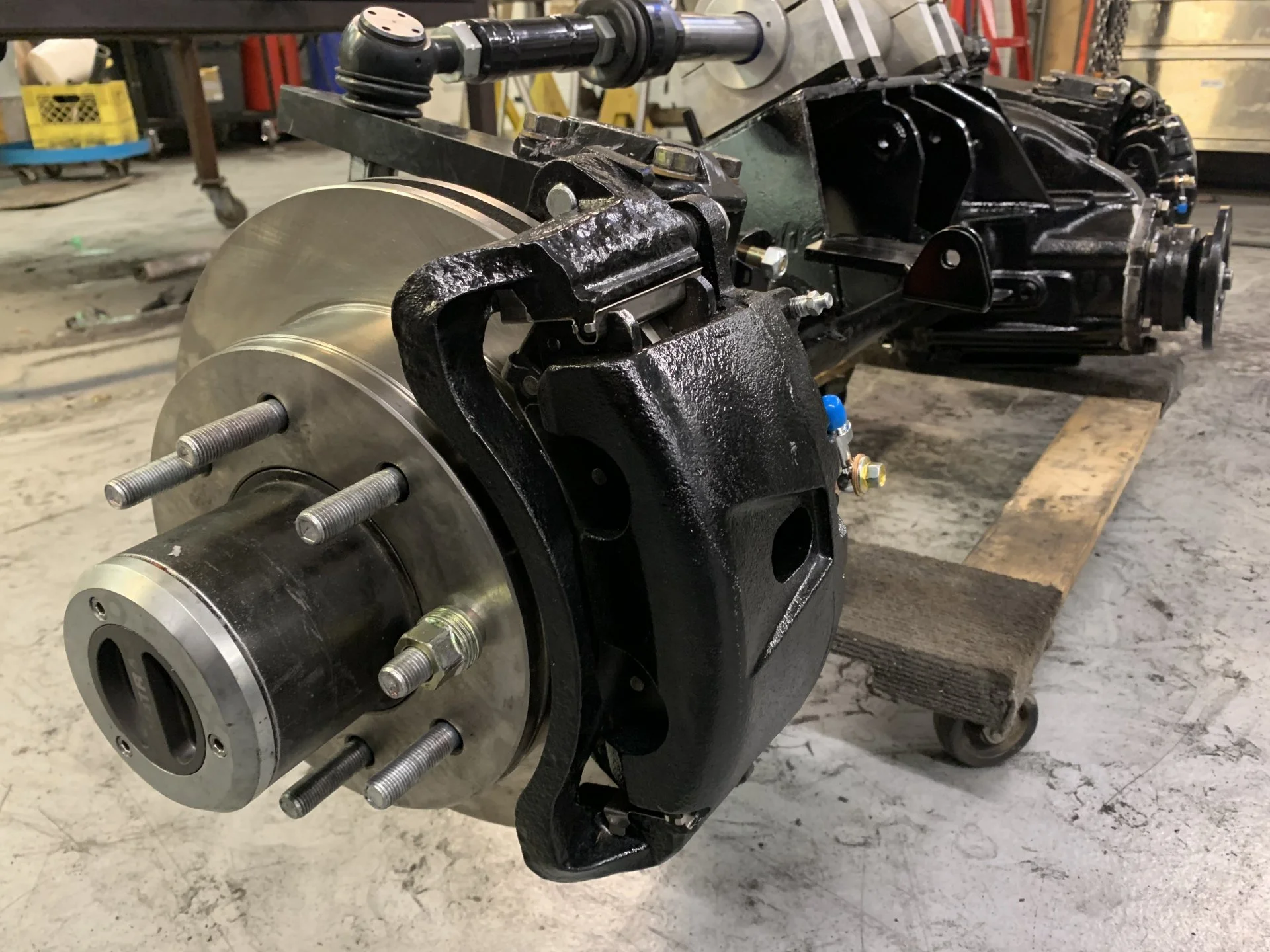

Front Axle:
14 Bolt dually housing. Converted to steering axle with Crane Axle revolution14 inner seals, C’s and knuckles and keyed high steer arms, all built to 63” wms width.
housing and ring gear are shaved for clearanve with TMR shave kit and front cover.
ARB locker, 5.38 Nitro gears, 1480 rockwell pinion flange
Hubs and spindles are Dynatrac stub hubs, with Dynaloc hubs.
axle shafts are custom RCV’s
PSC 3”x9” double ended ram with EMF steering joints.
15 degrees of pinion angle to achieve 7 degrees of castor and 8 degrees of pinion tilt.
brakes are 01-11 GMC 2500HD front Calipers with rear rotors and a DIY bracket.
a bunch of TMR brackets, including a pulley mount to mount a front suck down winch
it litterally took me a week and a half to assemble aftermarket parts from 10 different vendors. It took some figuring!

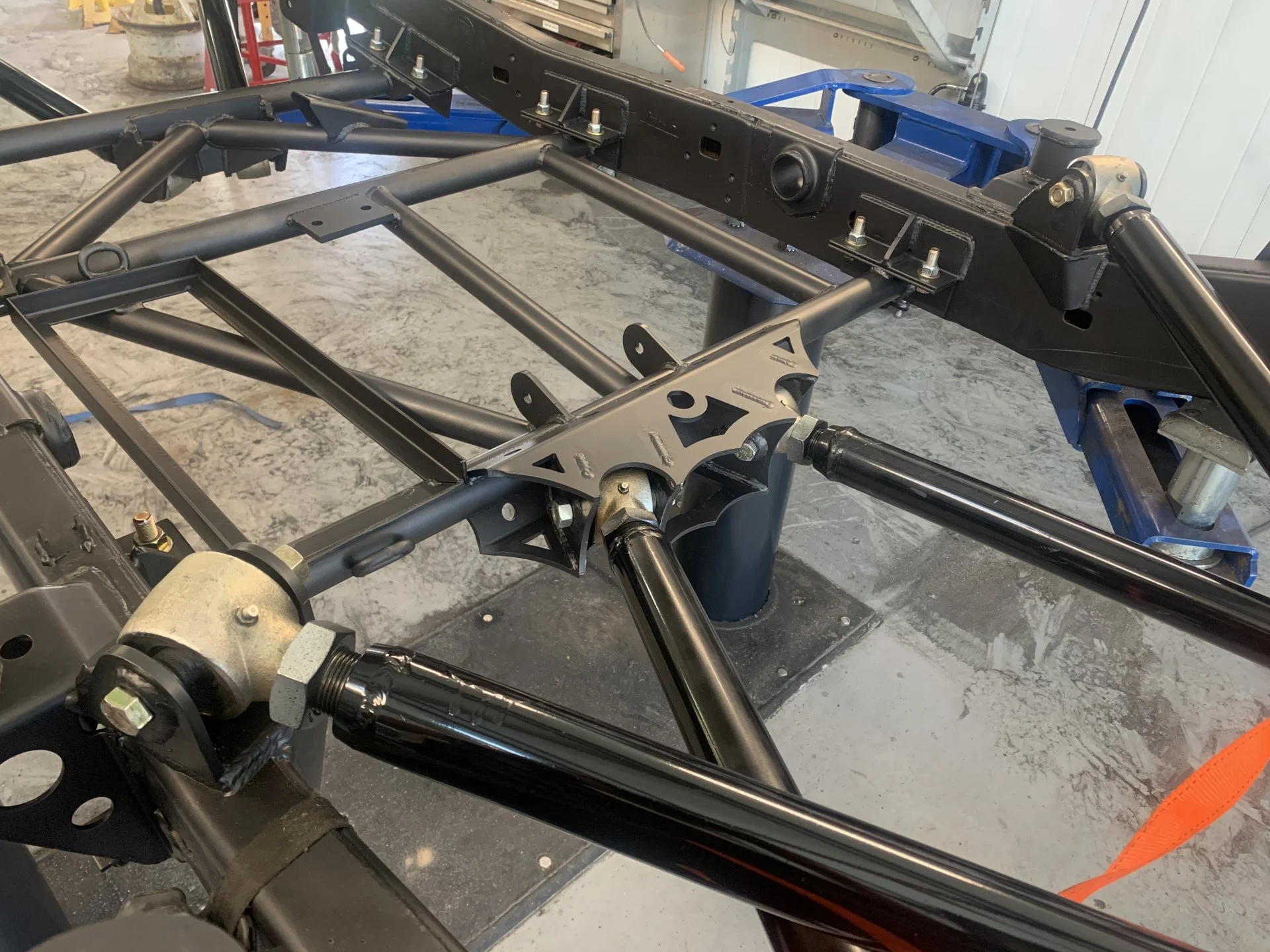

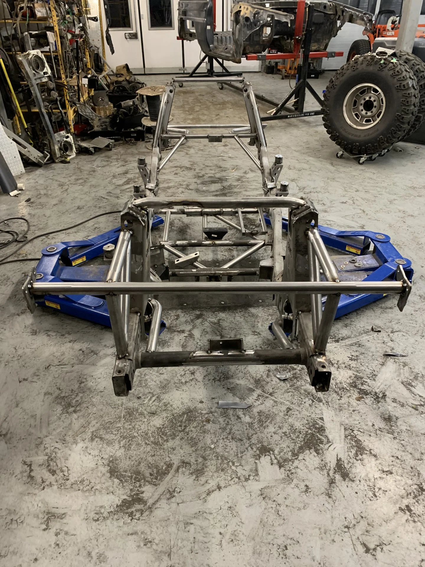

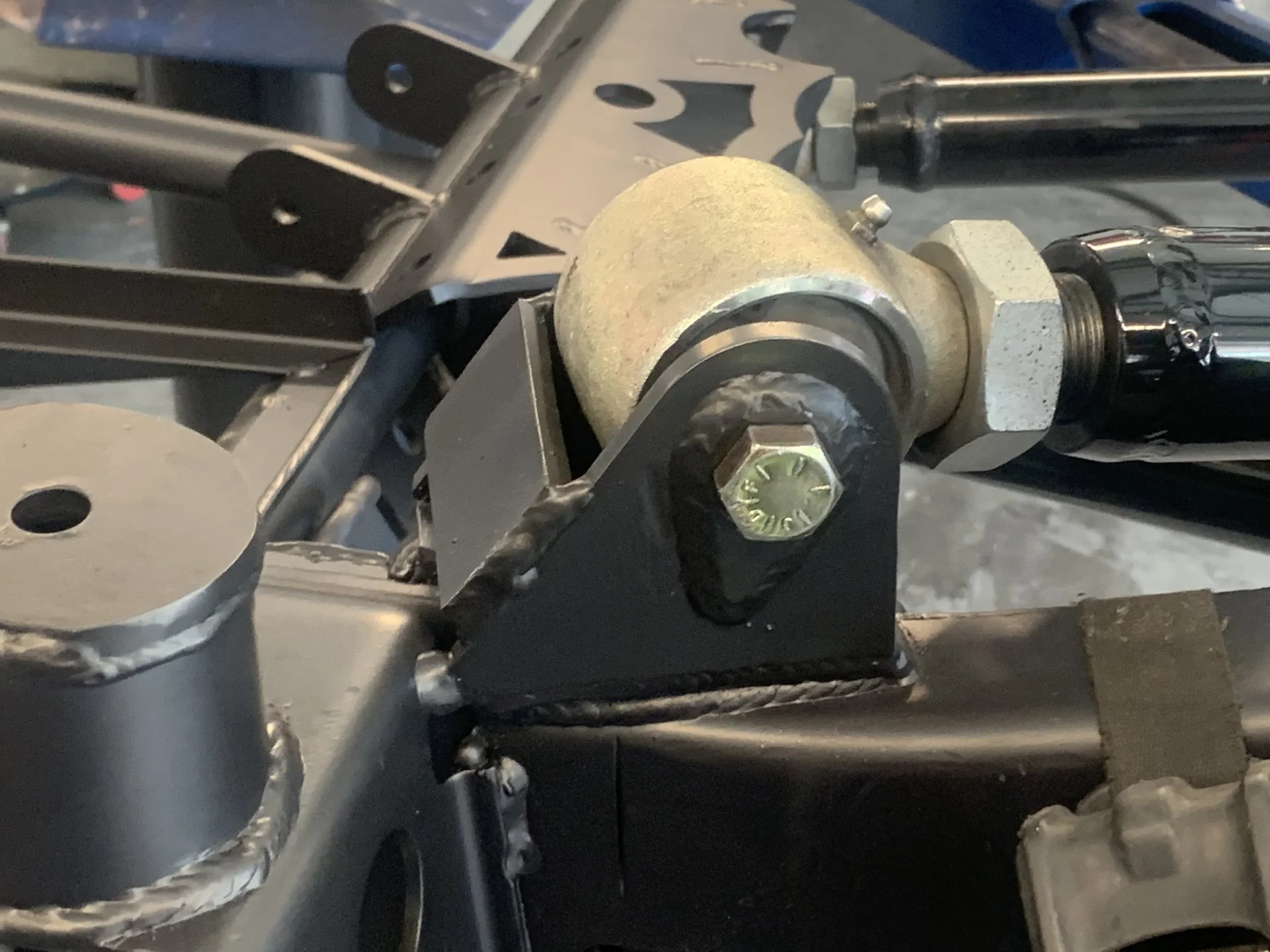

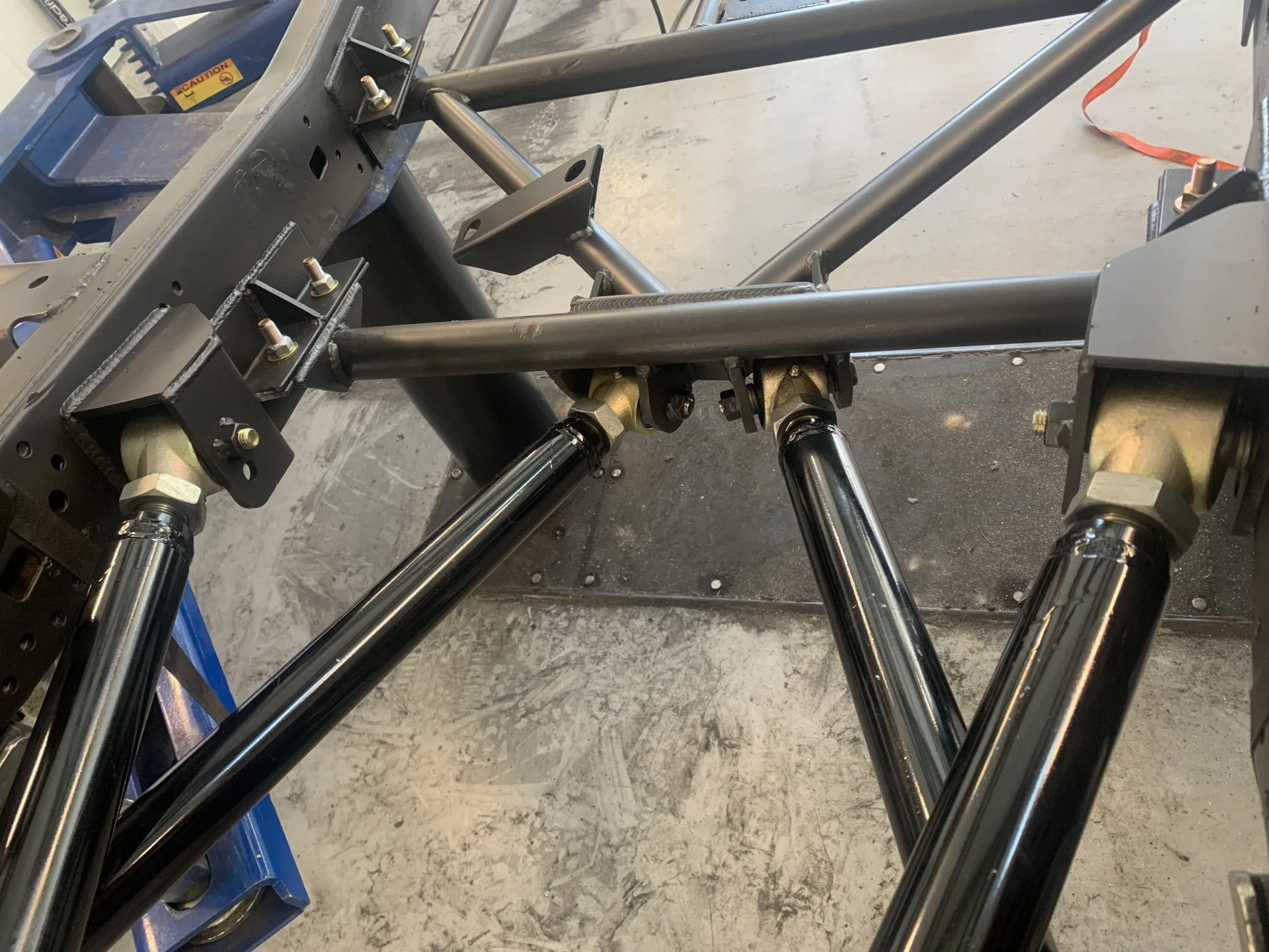

both front and rear suspension is a double triangulated 4 link design.
links ends are “Johnny Joints” with 1.25” left and right hand threads into threaded tube inserts & 9/16” bolts.
links themselves are 2” x0.25 wall DOM. All 4 Lower links have a slug of 1.5” aluminum inside them to resist crushing and bending upon impact with pointy things.
lengths, for those that must know:
Front Rear
Lower 965 1080
Upper 730 1040

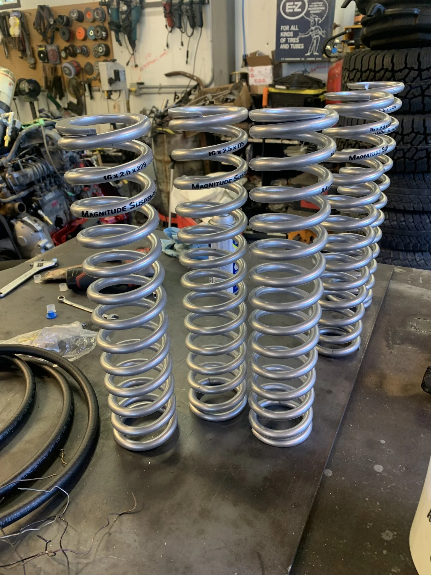

Springs!
Radflo 16” remote 2.0” coil overs.
Initial springs rates are: fronts springs 175/300 coils, rears are 225/250.
Step 1 dismemberment. Remove front clip. Undo things attached to the body. Install a nominal 1.5" body lift, take some measurements of frame to body clearance with the body lift. Then remove the body with my overhead crane, which is built into my shop specifically for lifting body's off frames. Am I bragging about my new shop? no. I am simply making a statement of fact which highlights the superiority of my shop over you garage, which, presumably, lacks a built in BJ74 body lifting crane.
