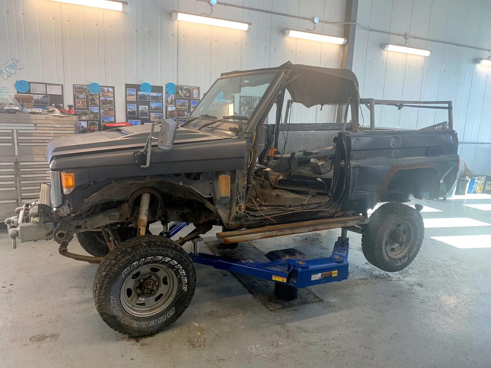

This weekend, I started ziplock's revival. I towed it into the shop to asses the situation.
It's been scavenged for parts... Headlights, Seats, alternator and a/c compressor all stolen for the other BJ74s. Tires, lockers, gears, longfields and air compressor are now in Shaker the BJ42. Tub is in bad shape - the 3 or 4 roll overs over it's life have take their toll. And 18 years in Canada has exposed all the rust spots.

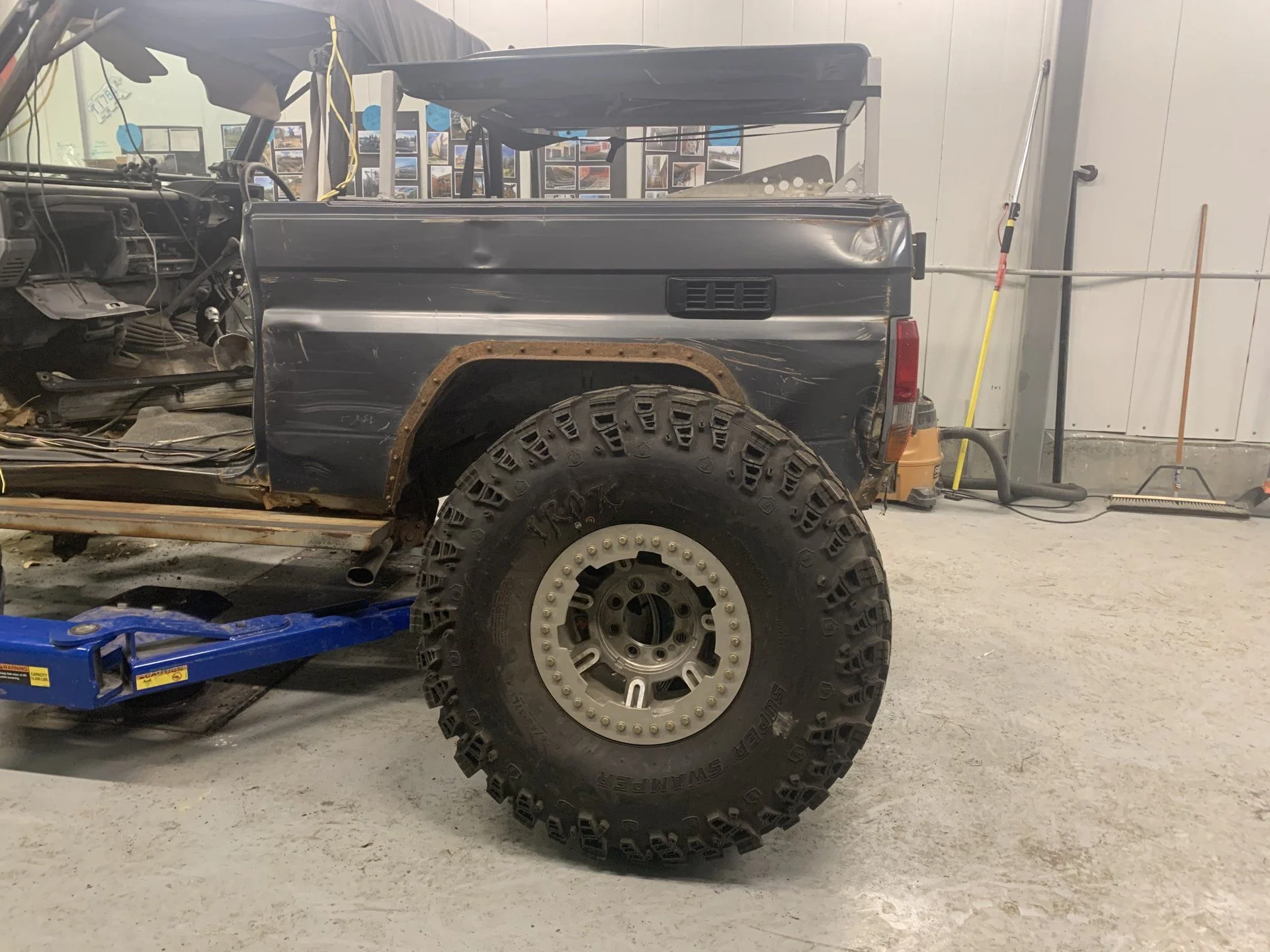

The first step is to strip it down. I am going to pull the body entirely off the frame so I can fix the suspension, but before that... I already have the tires... 42" iroks. some inspiration...
This would make the wheelbase about 118", up from 105. It would enable a fantastic approach and departure angle! What do you think?

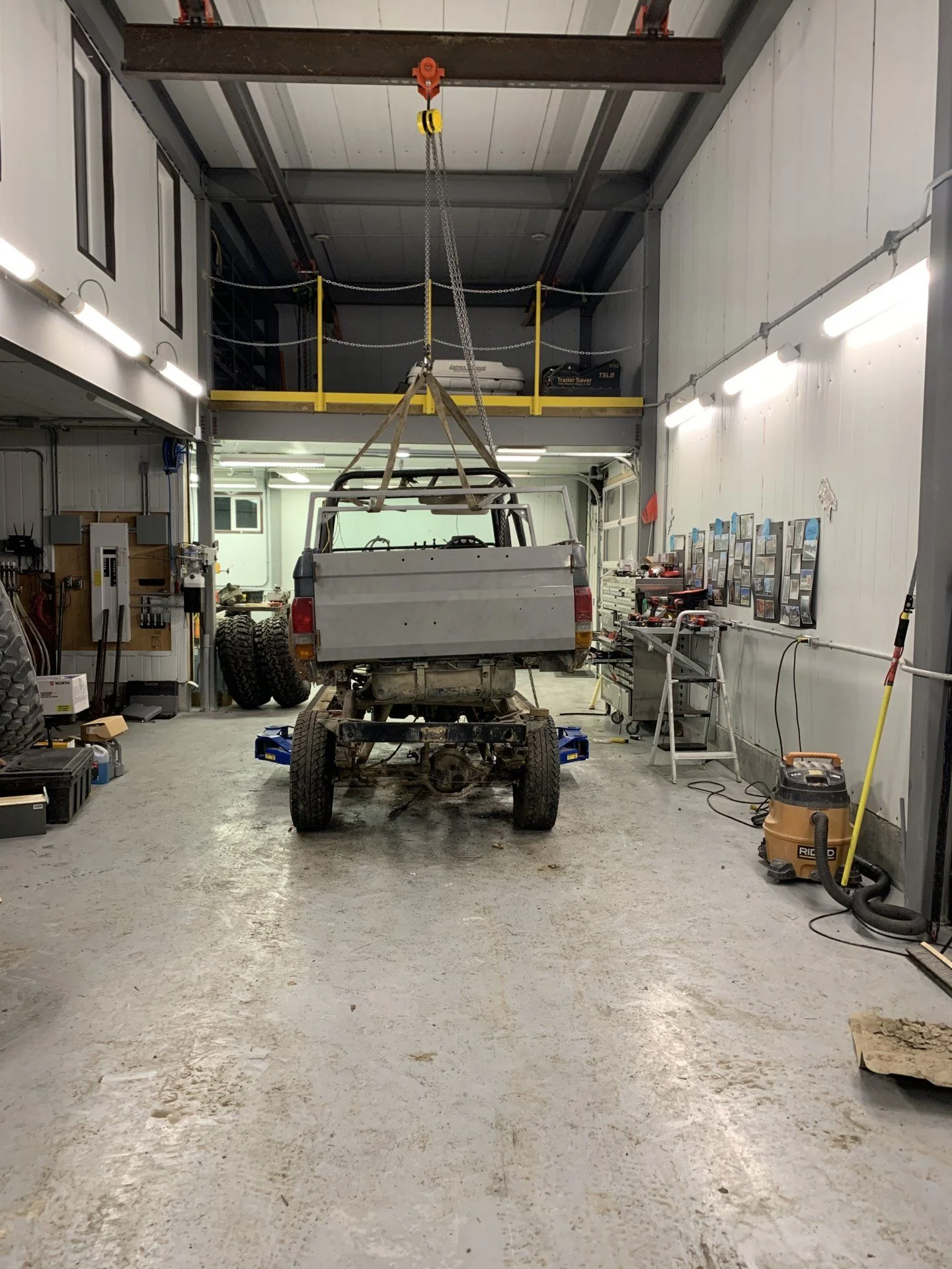

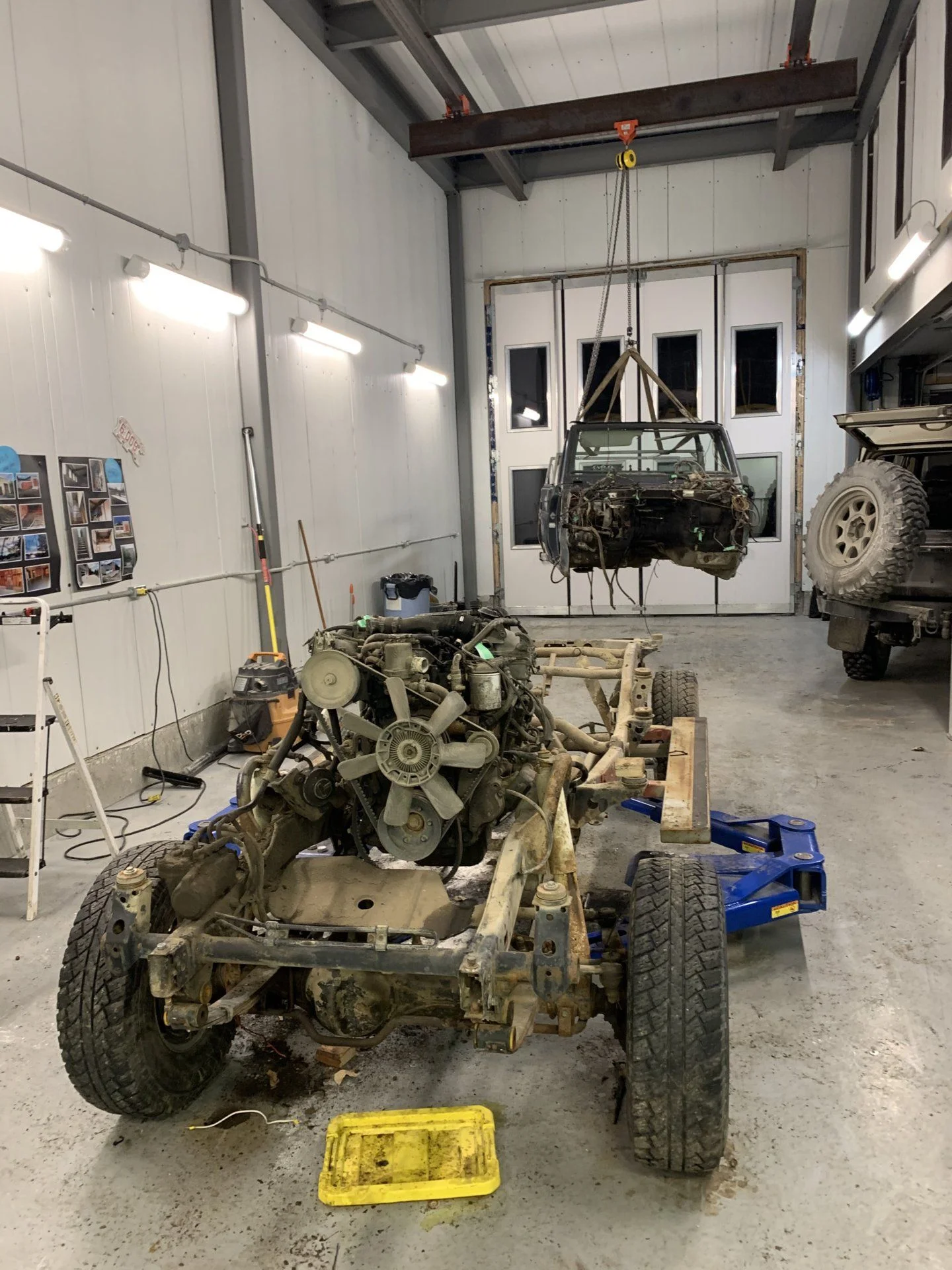

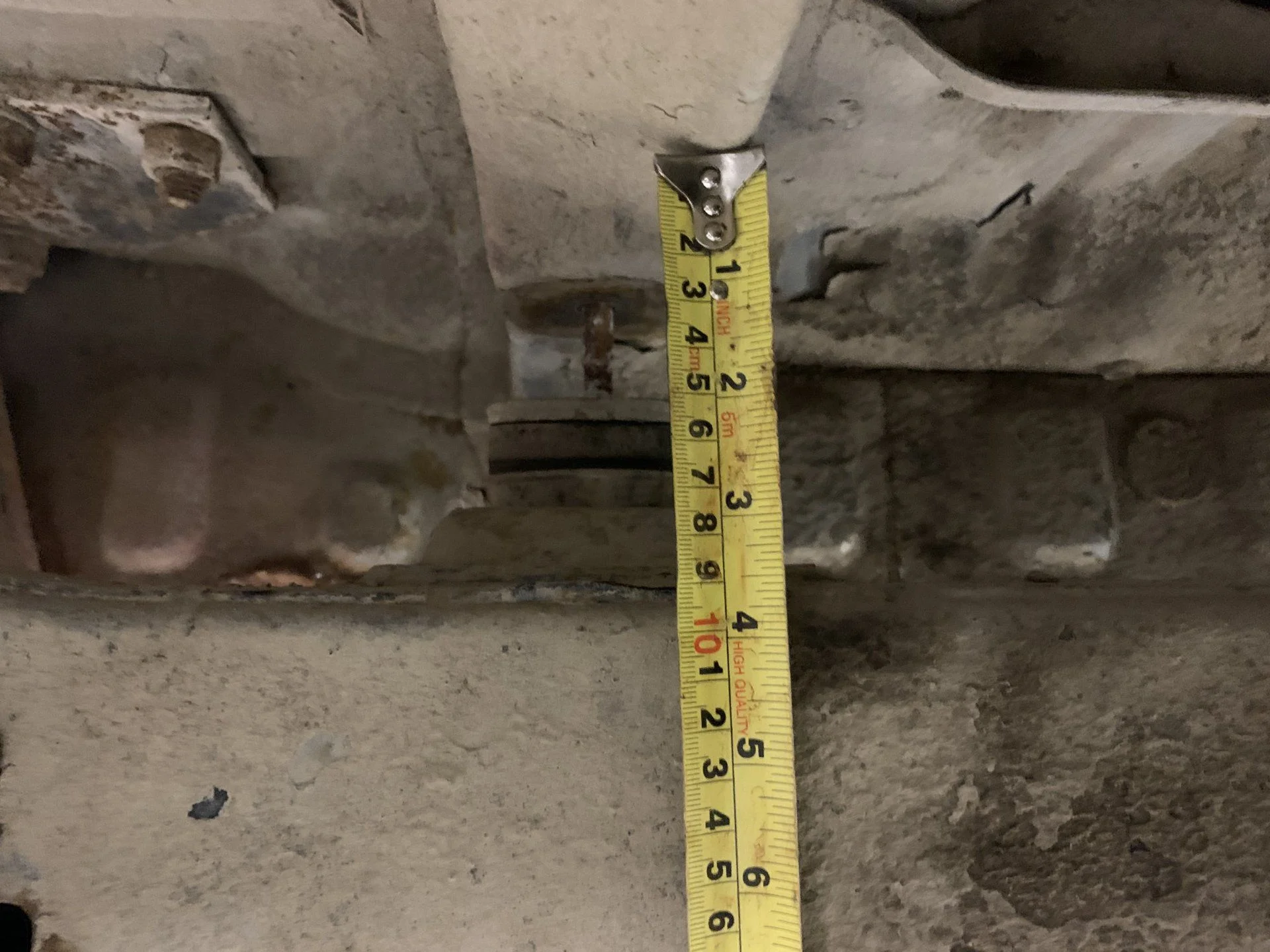

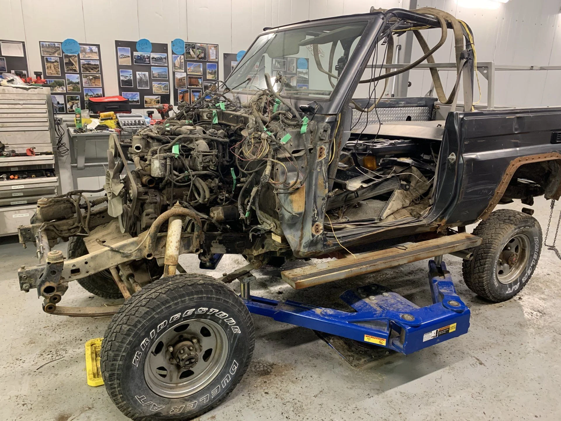

Step 1 dismemberment. Remove front clip. Undo things attached to the body. Install a nominal 1.5" body lift, take some measurements of frame to body clearance with the body lift. Then remove the body with my overhead crane, which is built into my shop specifically for lifting body's off frames. Am I bragging about my new shop? no. I am simply making a statement of fact which highlights the superiority of my shop over you garage, which, presumably, lacks a built in BJ74 body lifting crane.

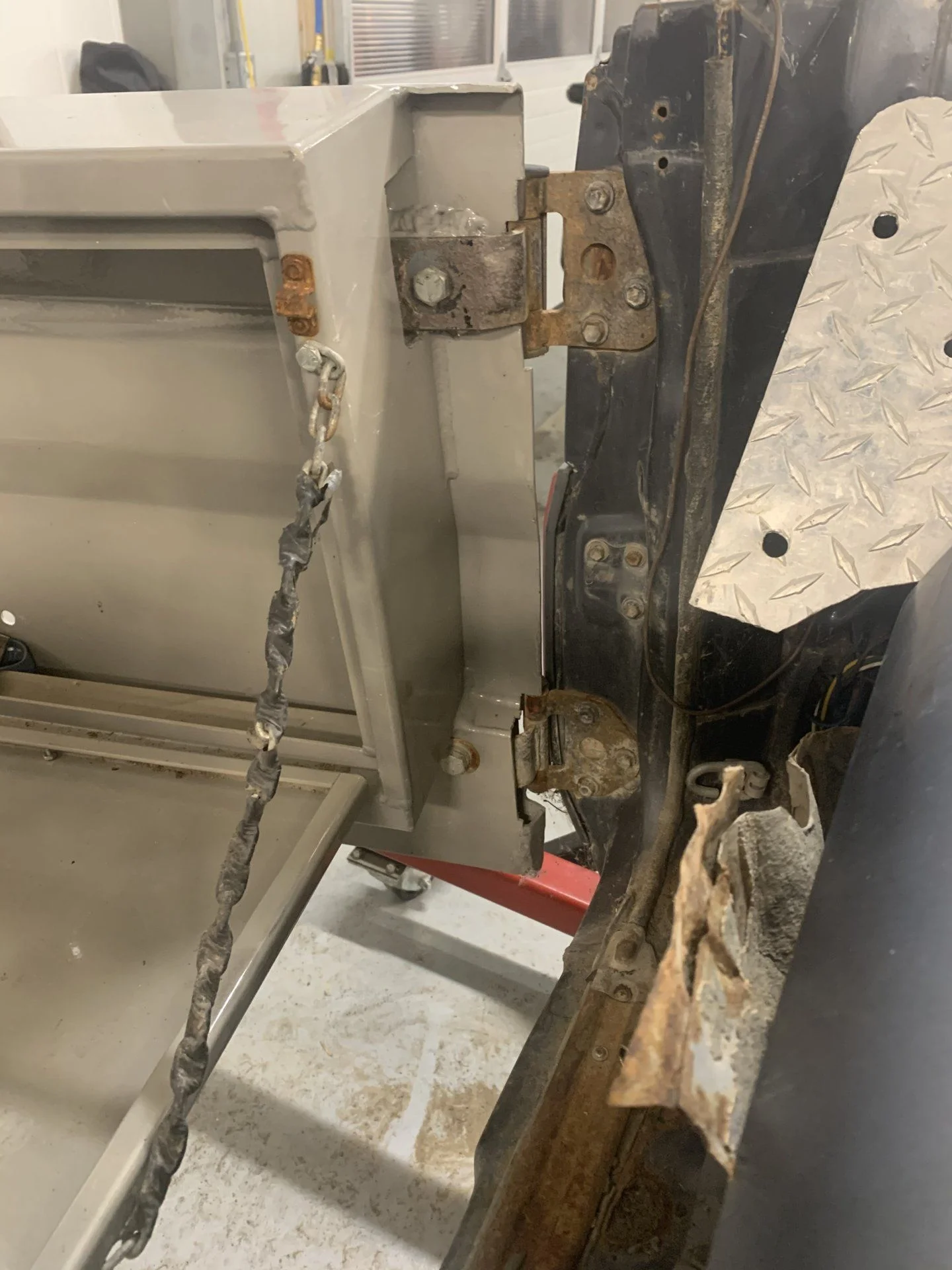

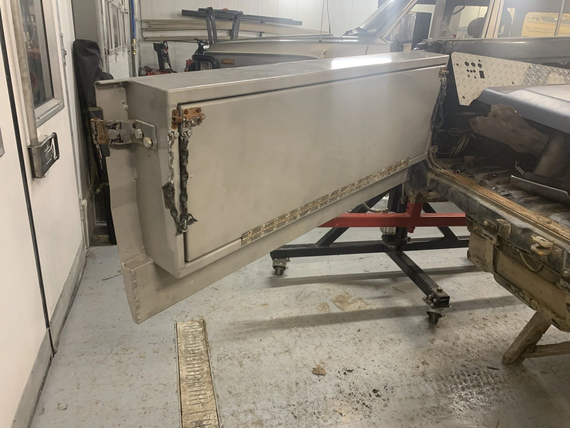

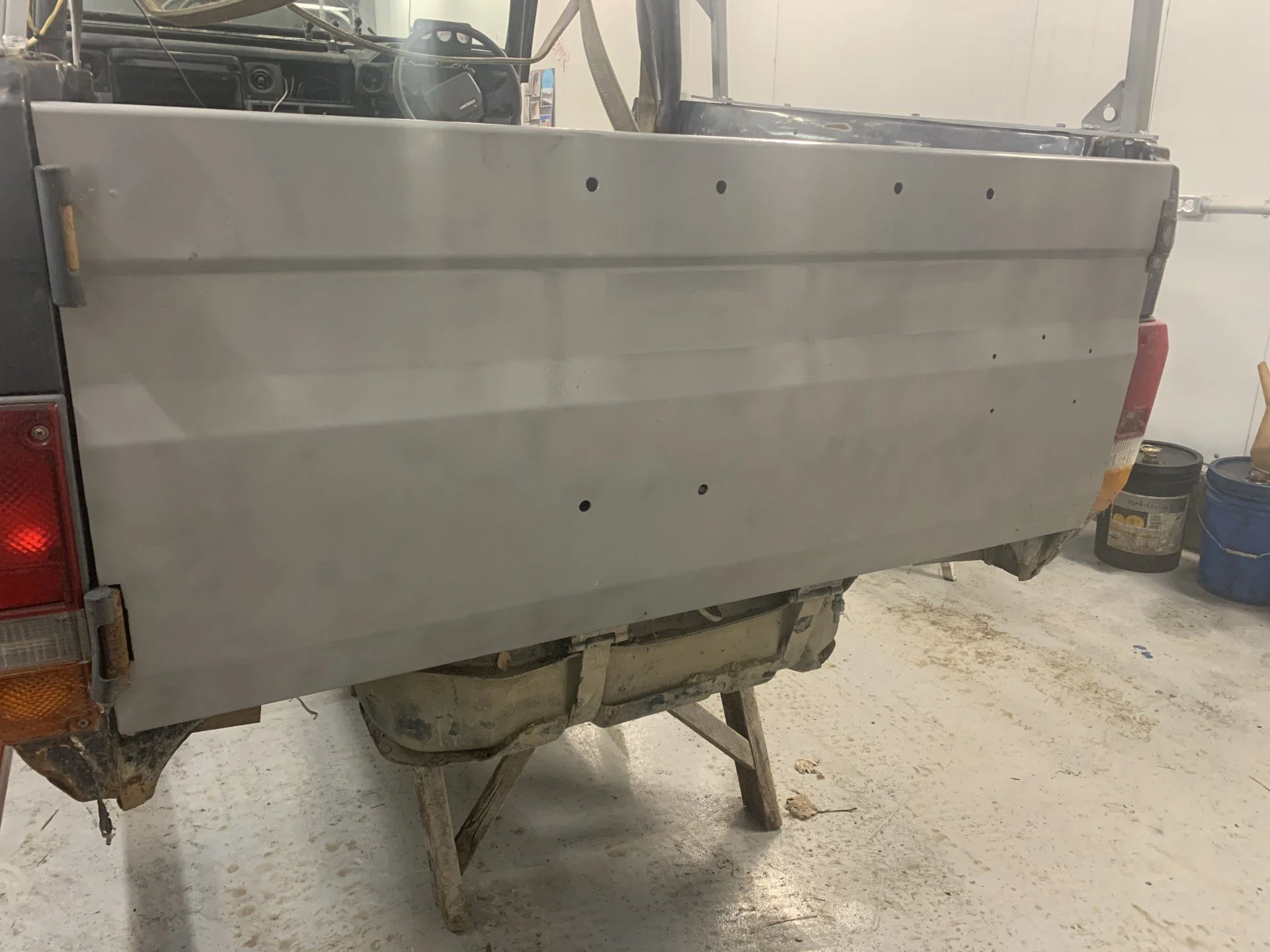

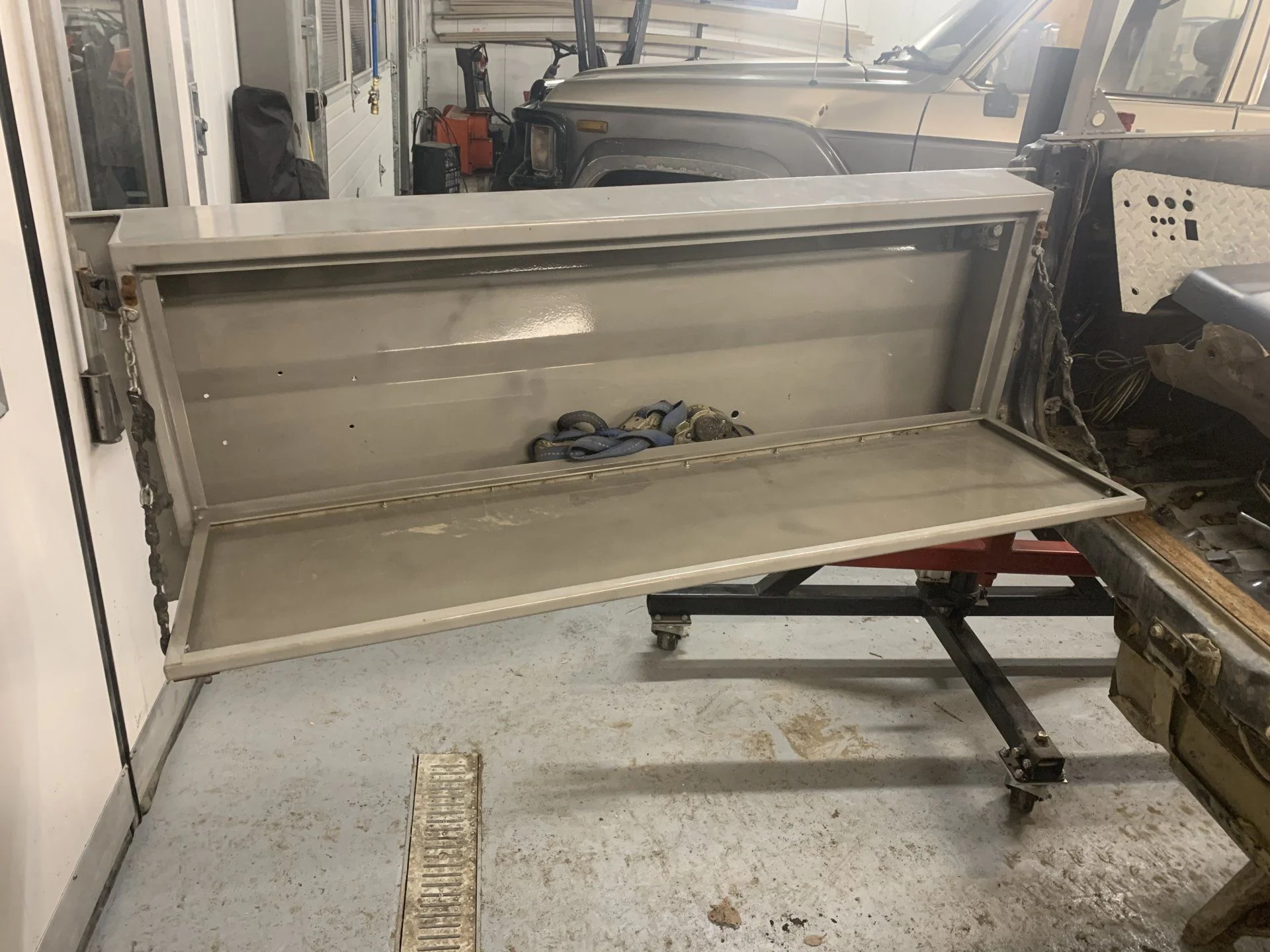

Dang that’s a nice looking tailgate , diy or available for sale somewhere ?

x2 on the tailgate, what’s the scoop on that?
OK, the tailgate. I got it on a parts trade from Crushers back in the olden days. He had it fabricated by a local metal fab shop for a project that never happened. The tailgate is all aluminum, with an integral box inside of it. When I received it, there were no provisions to mount it in any way. I had to weld up some strategically placed aluminum blocks and thread them to accept the factory hinges. For a latch, i just used a pin to lock it. There is no seal along the bottom of the tailgate, but when I use it, there's also no top on the truck, so that probably does not matter. I had it sand blasted and powder coated with clear coat, so that colour is raw aluminum. It is a very swank bit of kit that I quite like. The holes are from the spare tire carrier and licene place holder. Believe it or not, this gate carried a 40" spare tire, before I built my aluminum rear bumper.

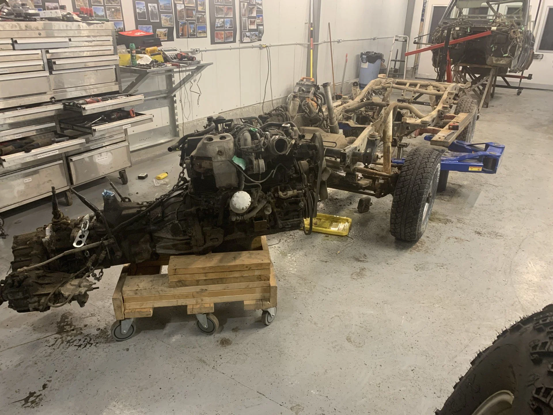

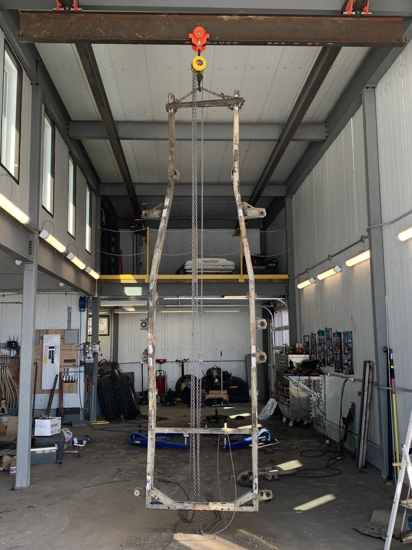

I removed most of the rest of the clutter.... with the body off, the crane easily lifted the entire driveline out of the way. A few minutes with the plasma cutter, and the old suspension was 'fixed'.

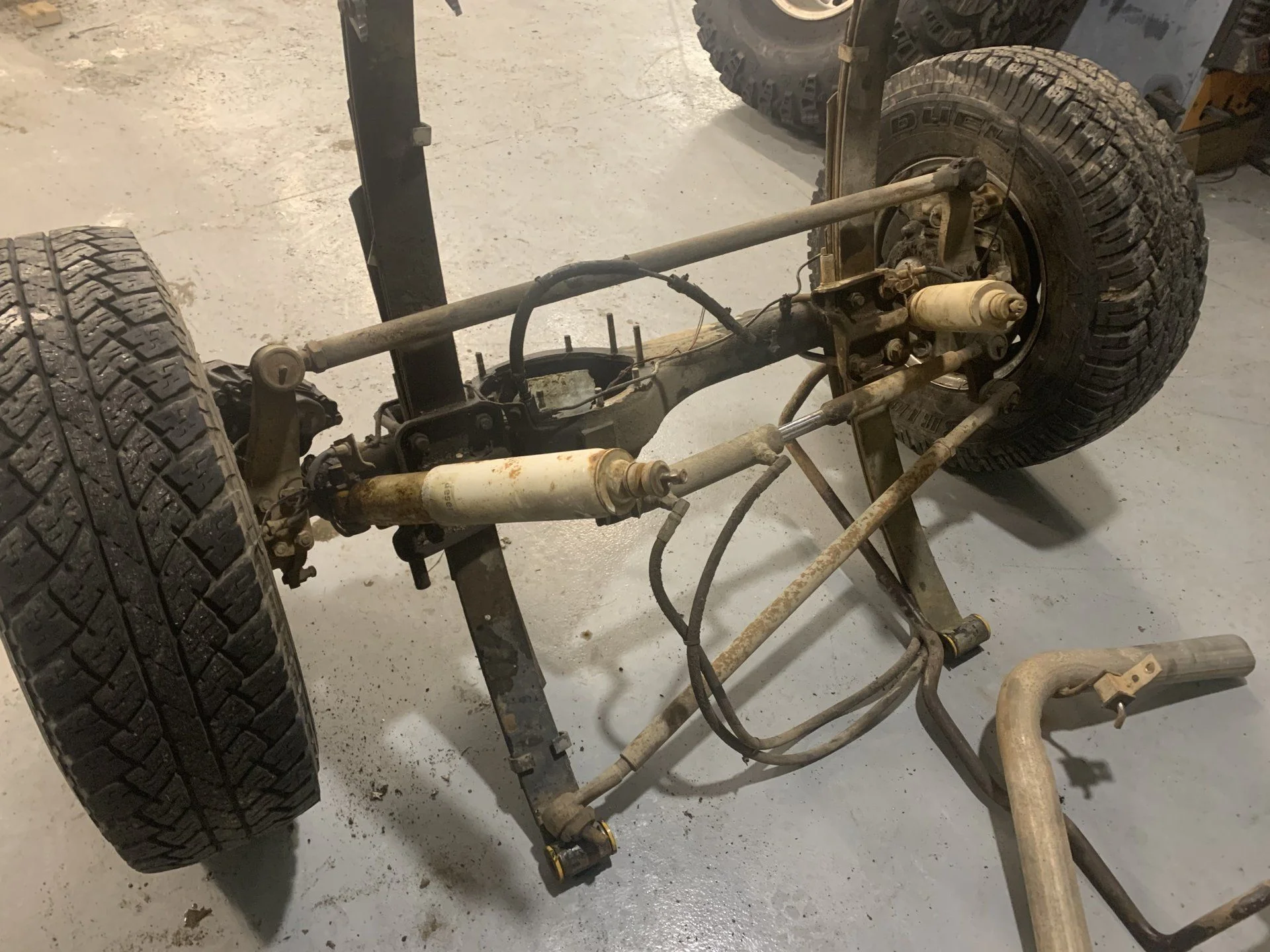

Let's take a moment to remember the epitome of turn of the century Cruiser suspensions... the Spring over. Ziplock had one. and by all acounts, it was a good one. Look at that front axle... in it's prime, it had factory cable locker and 4.88 gears, longfields, sky widening kit, 4x4 Labs steering arms with 1 ton rod ends, hydro ram assist, and still had factory anti-sway. That reminds me, anything you see in those pictures is probably for sale.
And the rear axle... air bag helper springs, anti-sway from an FJ62, and to counter axle wrap, I built an actual, real-life and functional Bam Bar. That's that 3 way articulating contraption in the center of the axle. I tried so hard. But that poor rear axle is bent. so. bent.

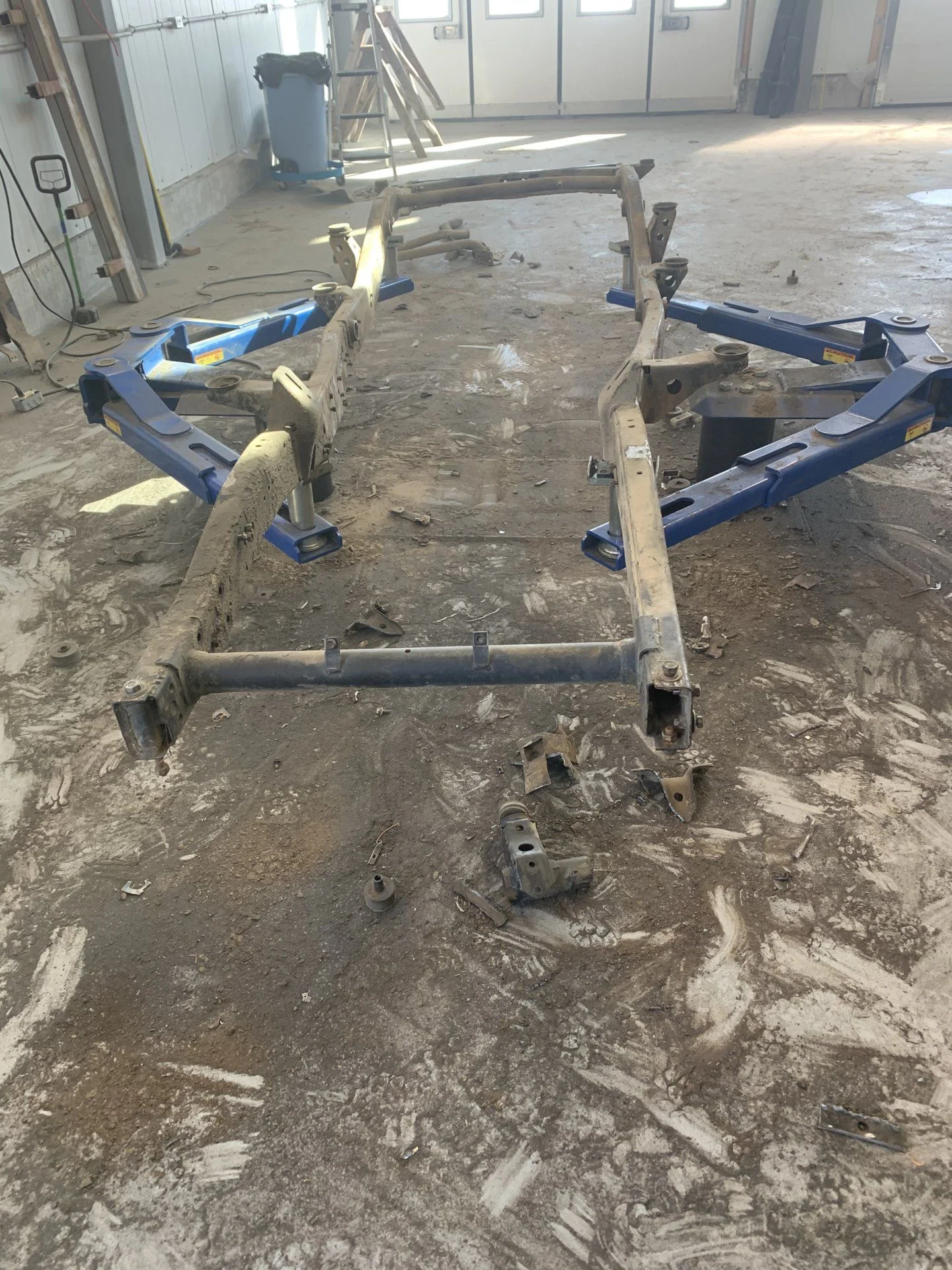

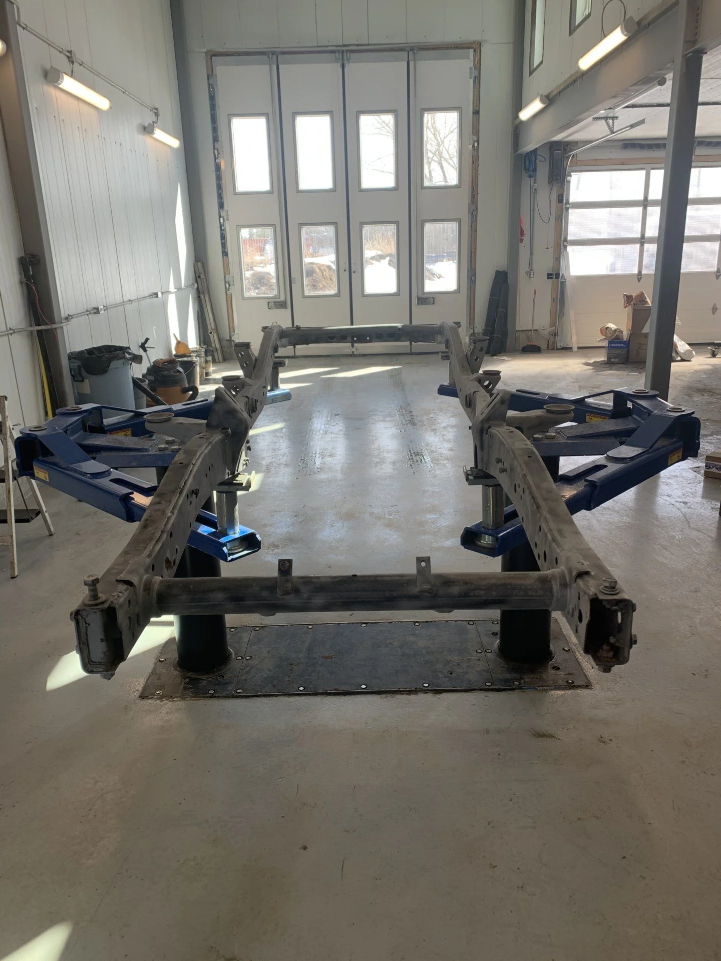

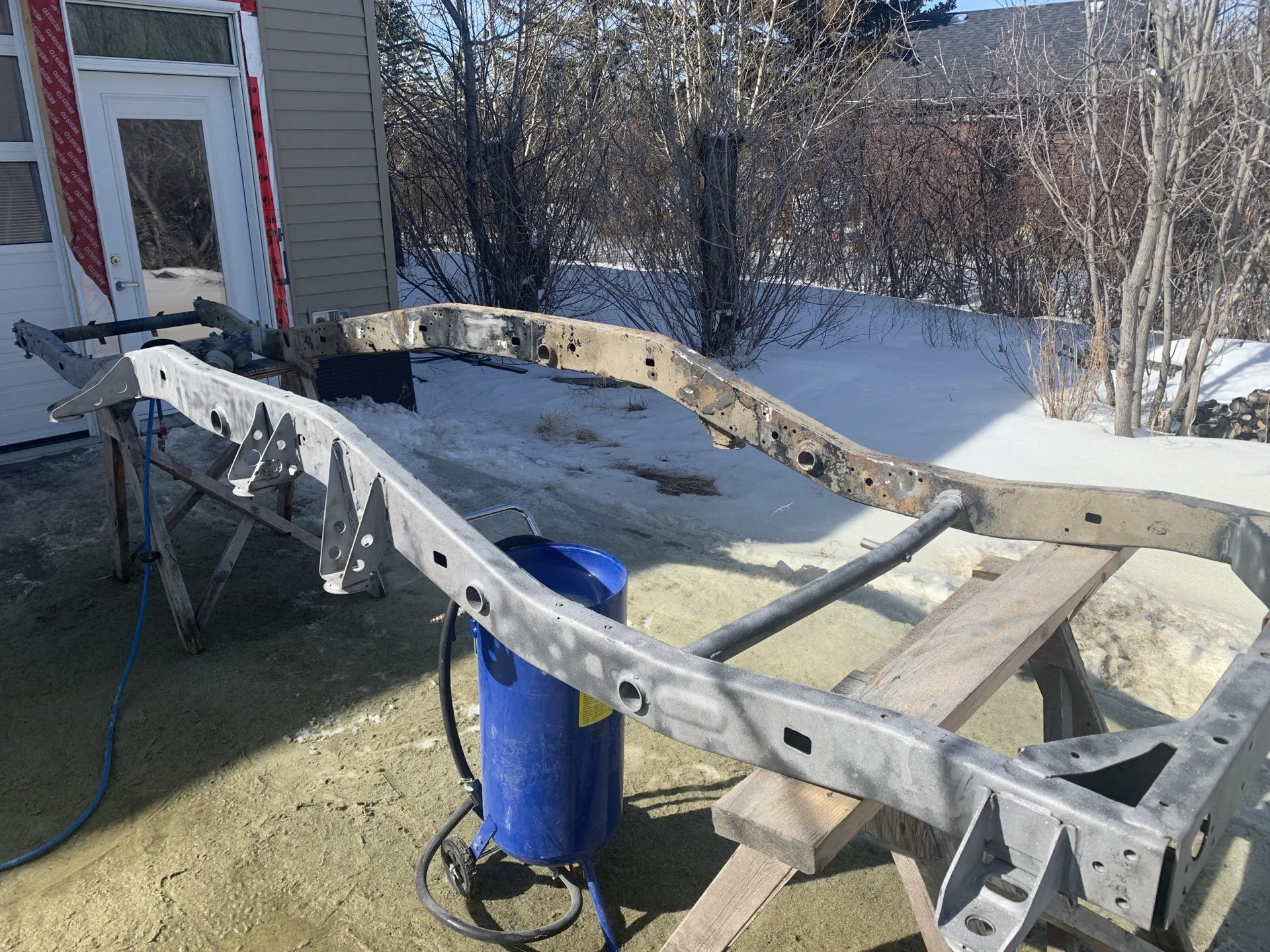

16 hours, 30 grinding wheels, 1 dead grinder, and a hell of a mess....
How to clean mud out of a Land Cruiser frame... a crane, a hammer, and a sewer snake.
Some sand blasting on my out door sand blasting pad.
And viola.... my canvas, crisp, clean, decluttered, and ready to become anything I can imagine.
That sure is a lot of work to keep a few body mounts, why not 2x4 tubing?
So excited for you Peter. Going to be rad....
