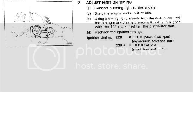

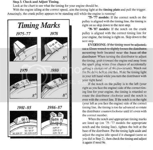

The 22re, any year, is 5°, not zero.
For the valves you can get away with .007" on the intake and it will help with the noise. Spec is .008" as was said. Same with the exhaust, spec is .012" but .011" will help with the noise.
Had to double check.......
This pos is wrong
Checked the 85 FSM and sure enough
Changing notes now :mad:
Thanks for the heads up. :cheers:

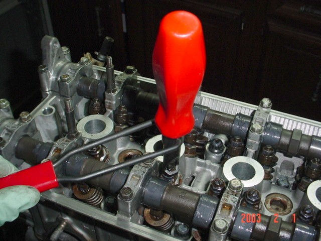

**Remember to really hold the adjuster when tightening the nut back down on the assembly as you finalize your valve adjustment. As little as a 1/4 turn equates to sometimes easily a couple thousandths.** There used to be a tool available that you'd use, that had it's own locknut, helt things in place and allowed to tighten the lock nut down and keep things in correct adjustment.
Not sure they're made anymore.. IIRC it might have been an Alltrade 648829?? Basically a pliar, with the proper tip on one part, and a split face on the other that went just around the rocker end, that you'd clamp with one hand, and use the wrench with the other hand. It gives you better leverage and positioning so the screwdriver doesn't wind up or slip off as easily.
There's also these that should still be available through a MAC or SnapOn dealer...(pardon the Honda content)
