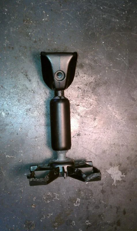

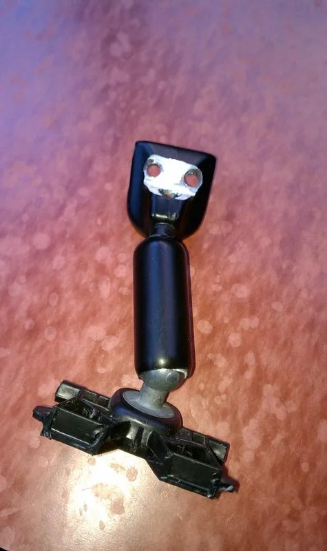

It was time to relocate the remote head to the great spot, above the rear view mirror that others are using. However, instead of using the RAM mount system, I went with a different route - rear view mirror out of a Cherokee.
The process is quite simple really.
- grab the complete mirror out of the Cherokee (grab the metal puck that's stuck on the glass too just in case)
- break the glass (So far I'm at 28 years of bad luck :doh:)
- separate the glass backing plastic from the swivel mount
- trim the swivel mount plastic using a box cutter

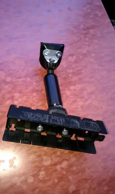

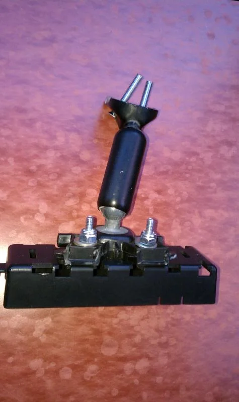

- drill two holes in the swivel mount. Not a lot of surface area for velcro.
- drill two holes in your radio remote mount holder
- use two short 8/32"pan head machine screws and nylock nuts to connect the two together. 1/2" length screws works well.

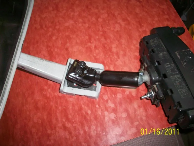

The Cherokee dual swivel mount fits nicely inside the Toyota oem rear view mirror mount. Just drill two holes into the Cherokee swivel mount, get longer metric screws, grind a little off the side of the swivel mount and voila, you're done. If you wanna get all finicky, grind a little off the top of the swivel mount so that your metric screws (non pan head) sits flat. Oh yeah, a little black touch up paint will do ya.
This entire process will take about 1/2 hour. It'll take longer for you to route the wires up the A pillar, over the head liner to your remote head.

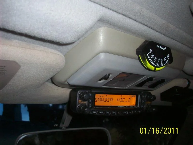

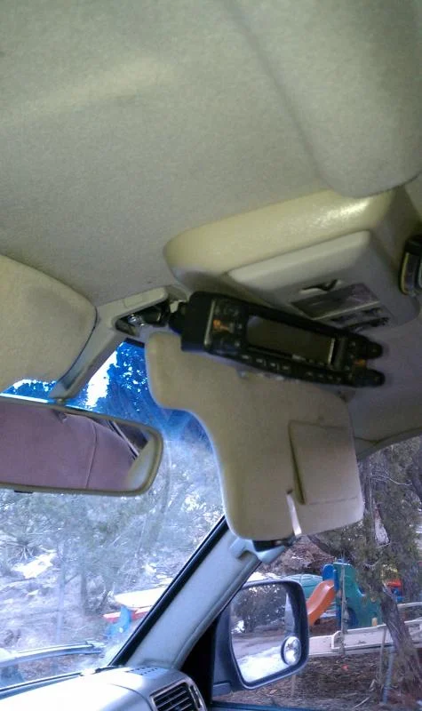

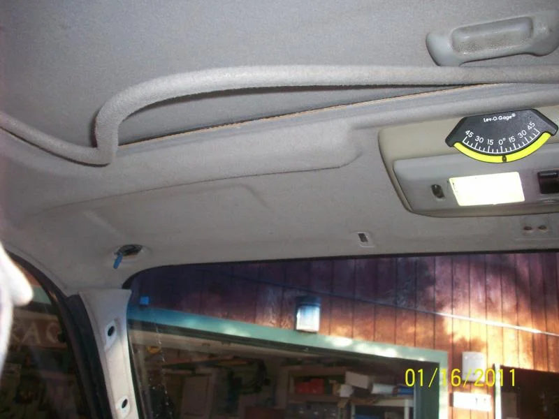

I thought about running the wires through the A pillar and then through the roof structure but that thought went away very quickly. It's too much work so I cheesed out and did it the easy way. Remove the A pillar trim piece, remove the visor, overhead console, visor support on the right side and lower the headliners just enough to do the work.

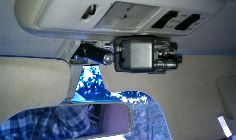

This method is very effective at supporting the remote head as the weight is similar to the rear view mirror weight of a Cherokee. The Yaesu head is easy to move around as needed and the driver side visor can be swung to the left side w/o any hassle. If you don't want to swing the visor under the remote head, you can simply move the head out of the way as needed. The friction of the Jeep two ball swivel is excellent at supporting the remote head.

Great idea and execution Ali! Do you think it will be off-road solid?
Only time will tell I guess. I should've measured the weight of the glass mirror and the remote head. I'll do that when I get a chance to see if the weight is similar. If similar weight then it stands to reason that the unit will handle just about anything we throw at it.
Both your and John's setups look great! And since you're reusing old parts, it's even "green."
Had a chance to drive on some wash boards last saturday and I'm pleased to report that the head unit didn't vibrate or move what so ever. :bounce: John drove the same washboards too and I don't think his Kenwood remote head unit moved either. Hopefully, he'll chime in with his feedback.
