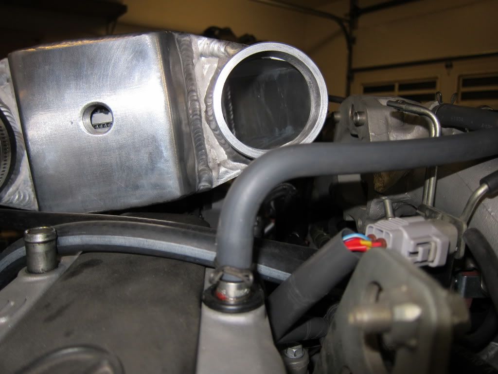

I installed the baffle on the valve cover. I used JB weld on the treads to make sure the screws do not come loose and cause problems.

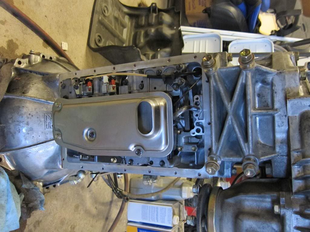

New trans screen

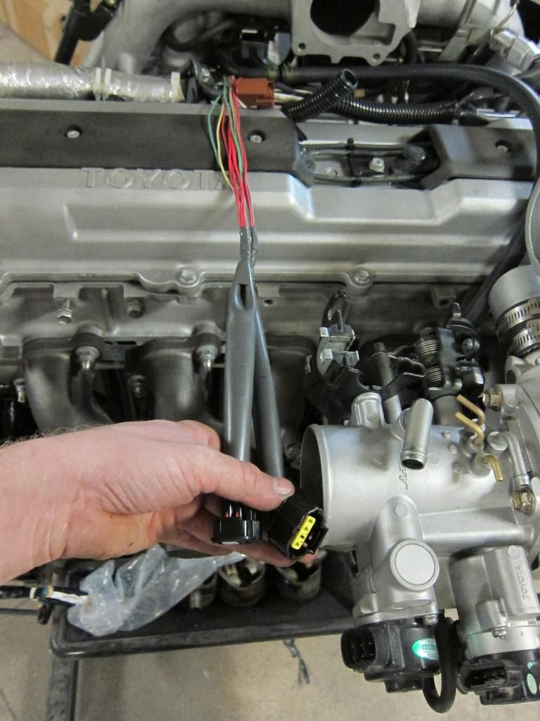

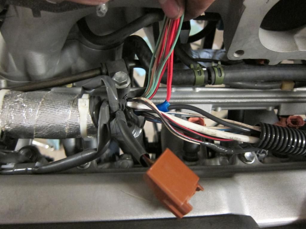

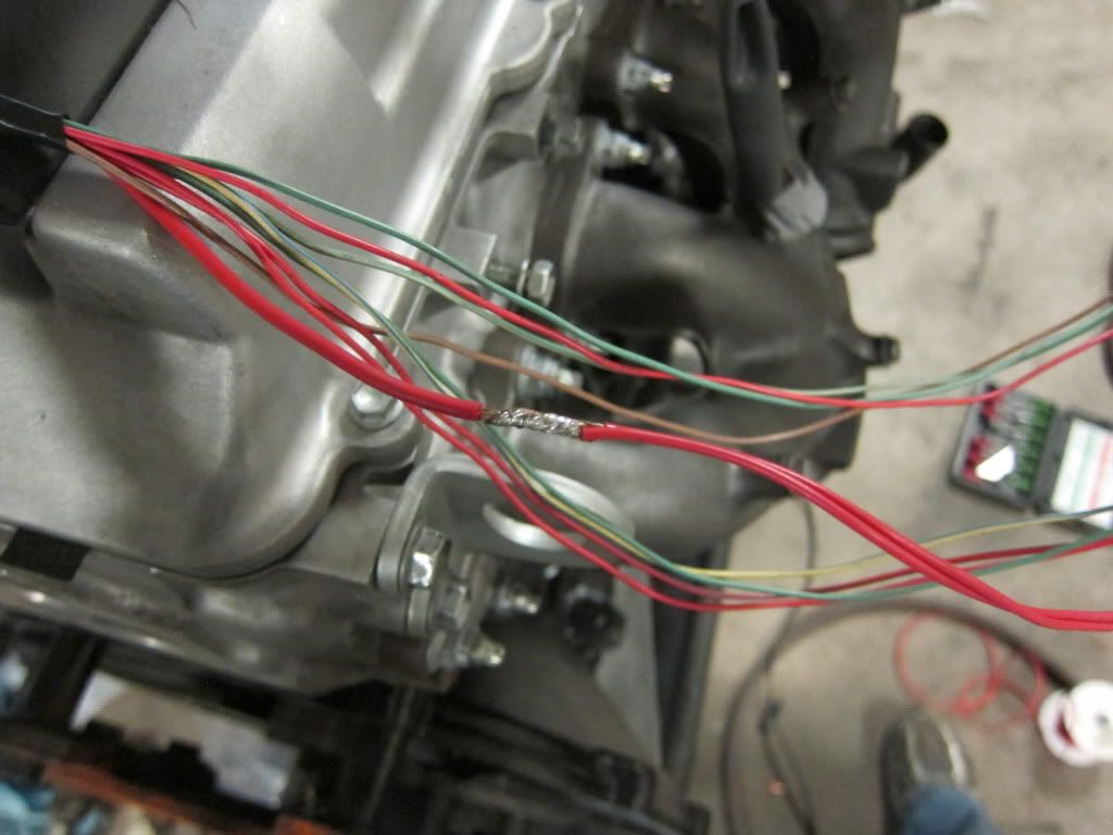

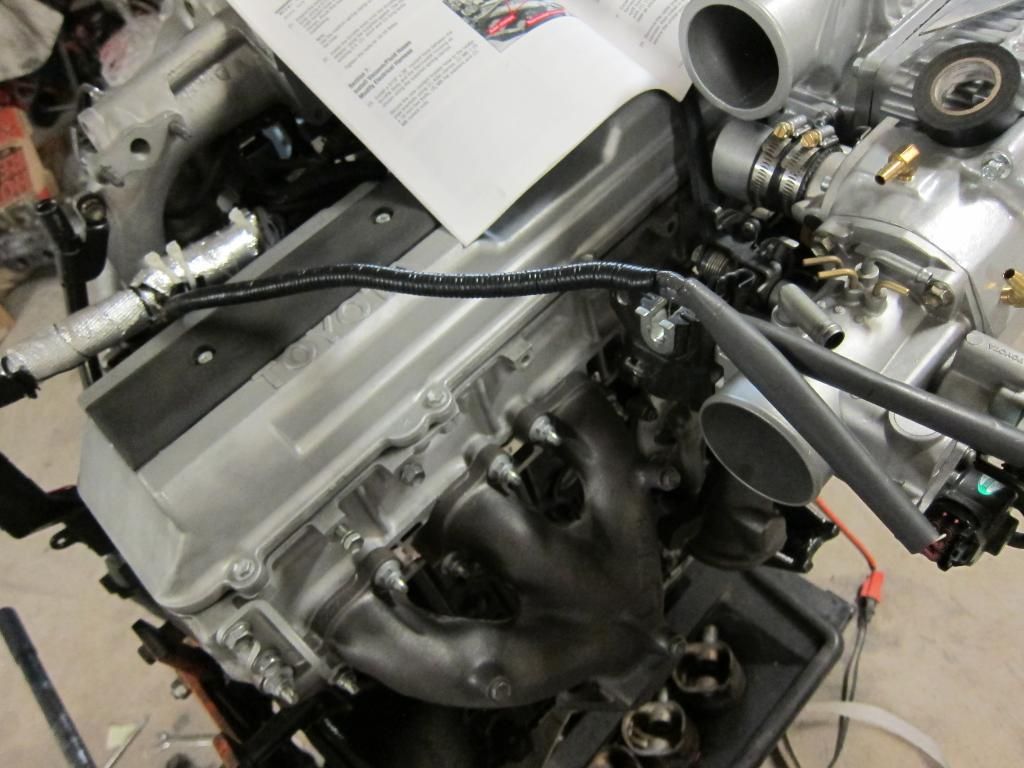

Lengthening the wiring harness to the throttle body
Ran in to some problems... the red wires are not long enough and the blue tape is a factory splice

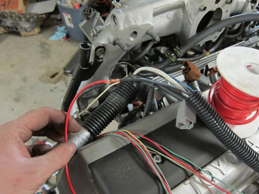

I cut out the factory splice and added my own wire to make it long enough. The wires needed to be moved back to the factory heat tape.
The correct length

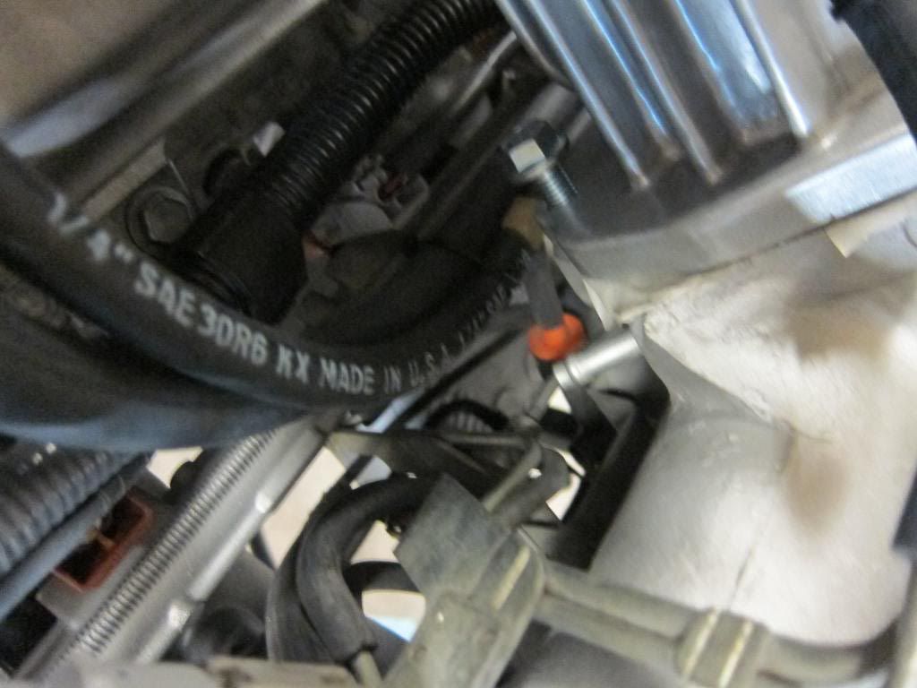

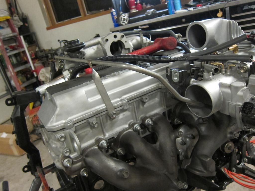

Not sure this is how this pipe is supposed to work... not overly impressed with the quality of this kit. I just bent it back into place

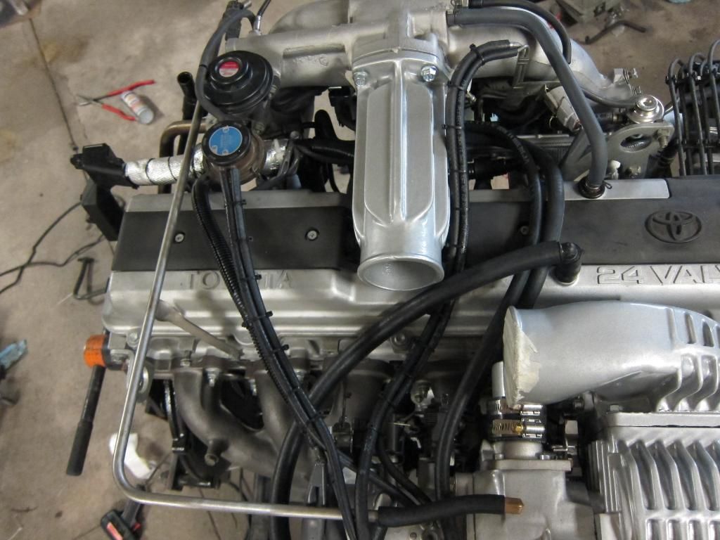

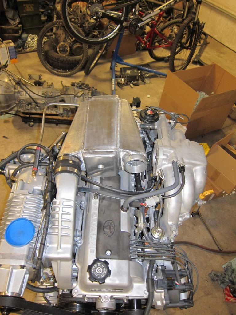

Got all the hoses fitted
It is not very clear in the TRD instructions, but the hose from the intake manifold needs to be removed and reconnected with a new hose from the yellow T to the supercharger.

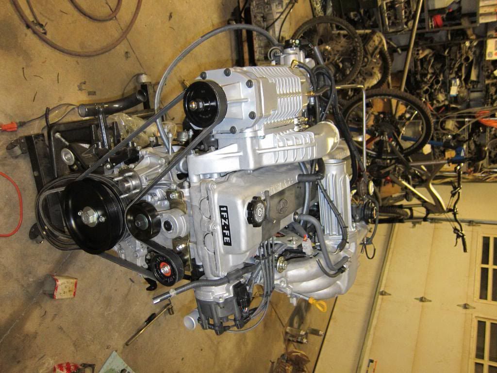

Gettng close...

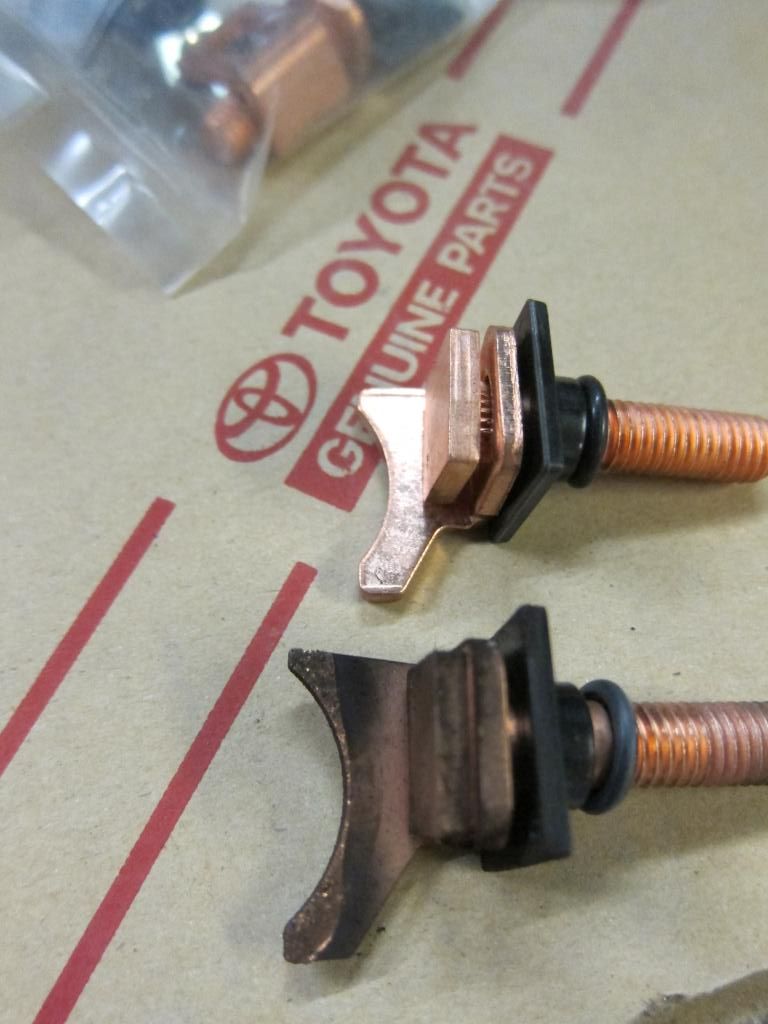

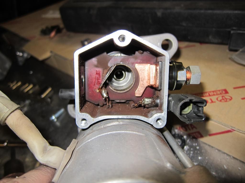

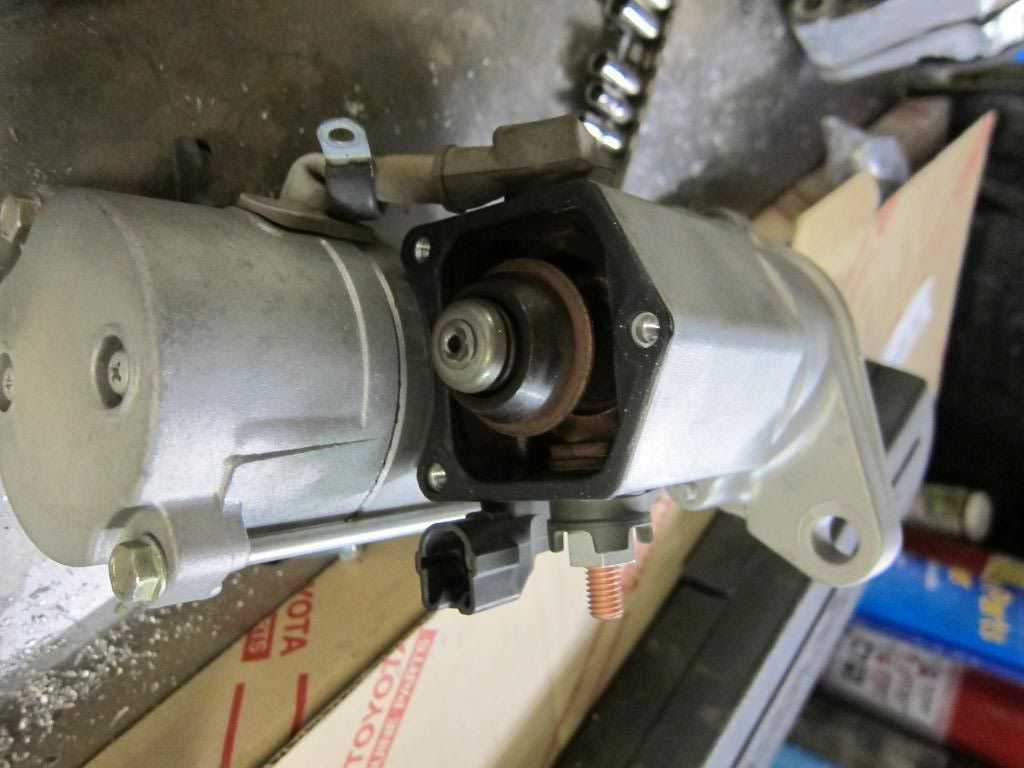

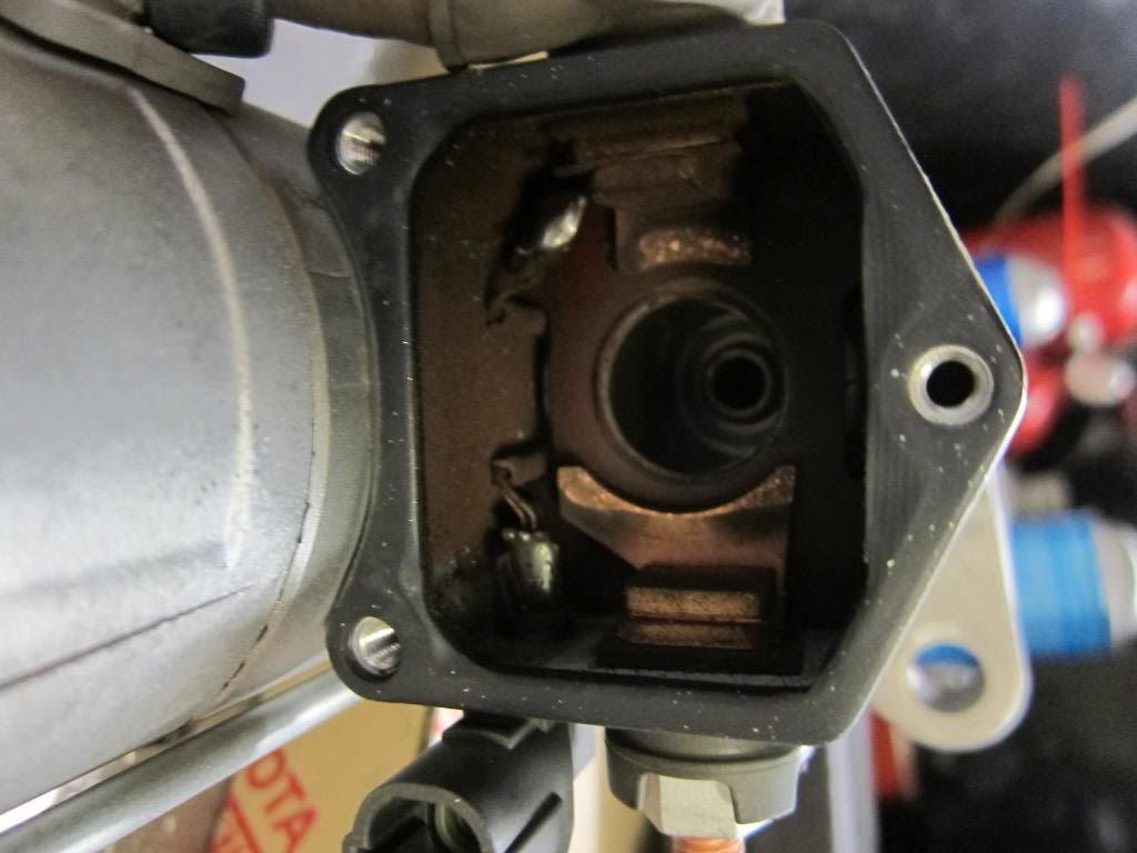

Replacing the starter contacts
They actually look pretty good, but the parts are paid for and I have it out

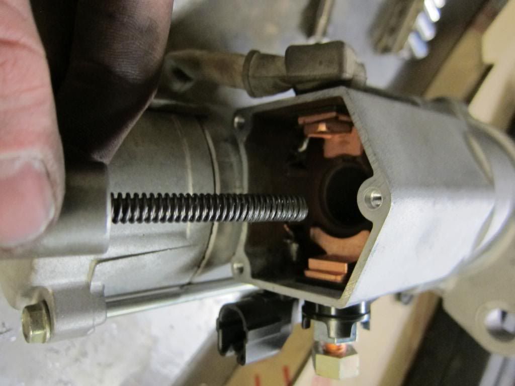

Hit this with a wire wheel
Don't forget the spring, the starter will not work... ask me how I know

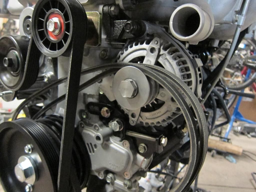

Tundra alternator

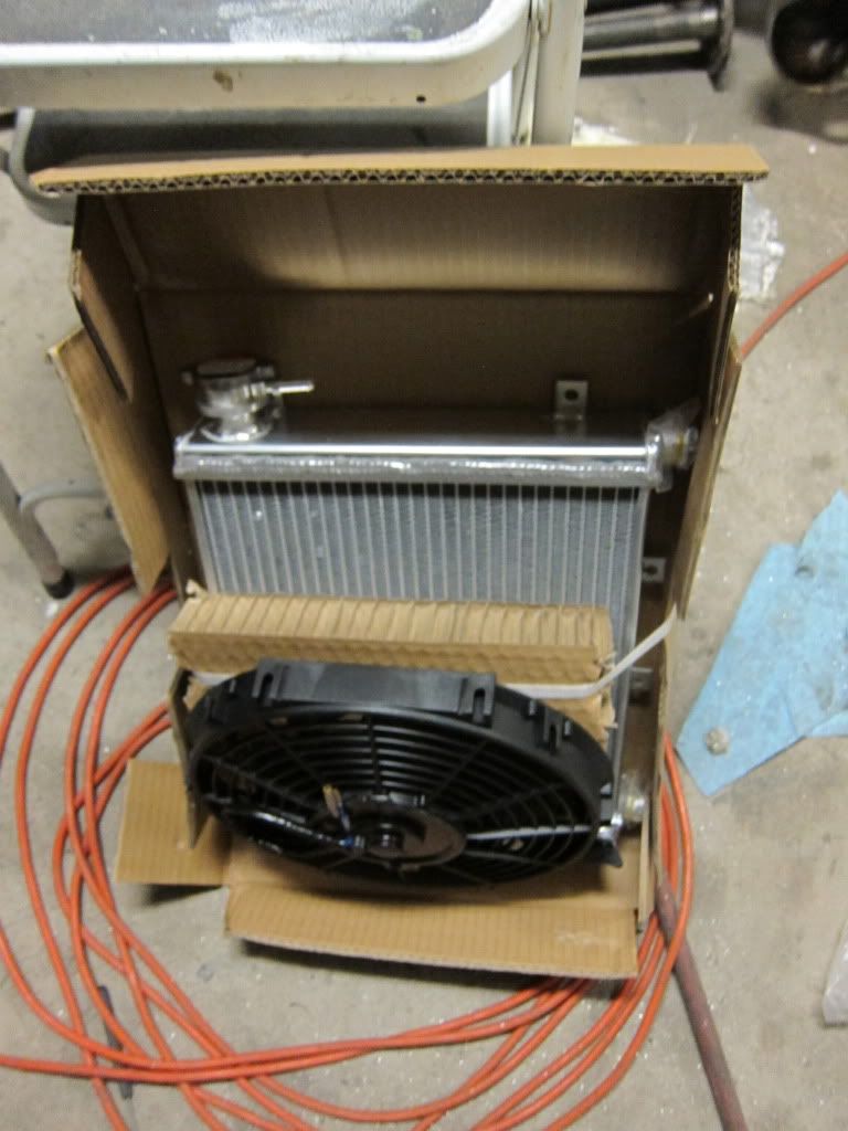

Hmmmm... ideas. I have this WTA intercooler that has been sitting in my garage for a few years that came off of a Celica st205 gt4. My original plan was to put it on my Celica st165 alltrac but I think I am going to sell the car. What do you guys think?
Great job, definitely making a lot of us jealous with your attention to detail and your now better than stock motor! Since they always say the next one should be easier let me know when you want to do mine. I will get you a 6 pack of your choice ;)
Definitely do the WTA intercooler, I think the biggest problem with the TRD supercharger is hot intake air temps leading to detonation.

Ha, well I don't have it running yet so you might change your mind.
Yeah it is too bad that TRD did not include an intercooler into their design.
pure porn !!!!
Thanks
Very nice. You planning on adding a little radiator up front to cool the WTA intercooler?
Yeah, I just go one actually.
