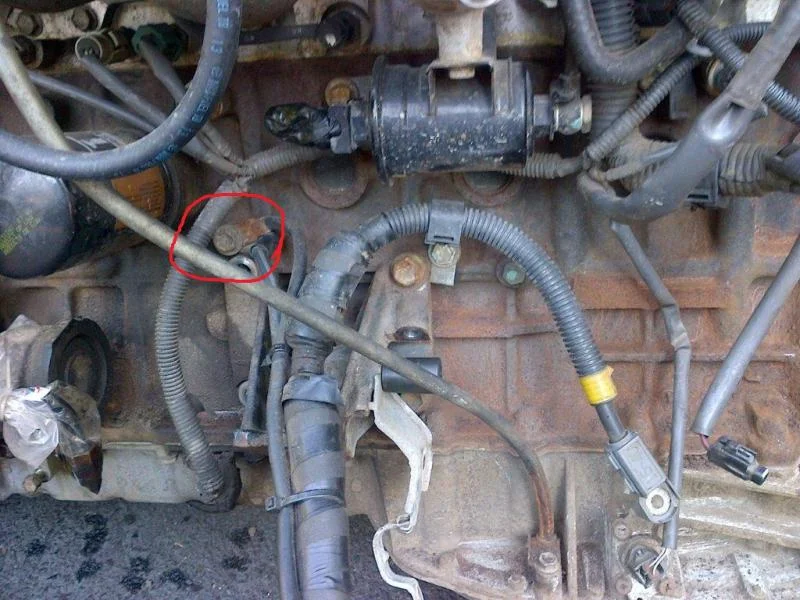

Anyone know where this ground bolts to? It has been too long since I had this thing apart and the EWD is not a lot of help. It is on the same harness as the starter power wire. Looks like it should bolt some where near the drivers side engine mount.
If i am not wrong, one side is connected to the battery (-) and the other side connected to the engine wall, just above and left of the engine support, check the picture.
Yep. Just had to locate the bolt for this on my rebuild.

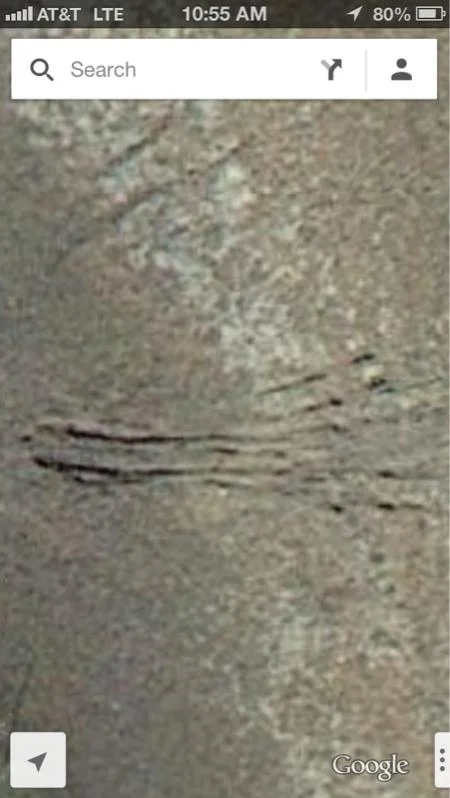

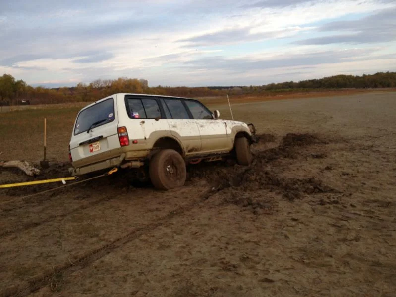

Funny that you say that
Haha, looks eerily similar. A funny thing is, my tracks have made it into google's maps! My buddies and I are both surprised and happy to see our hard work memorialized by satellite imagery. :)
Now that is awesome...
