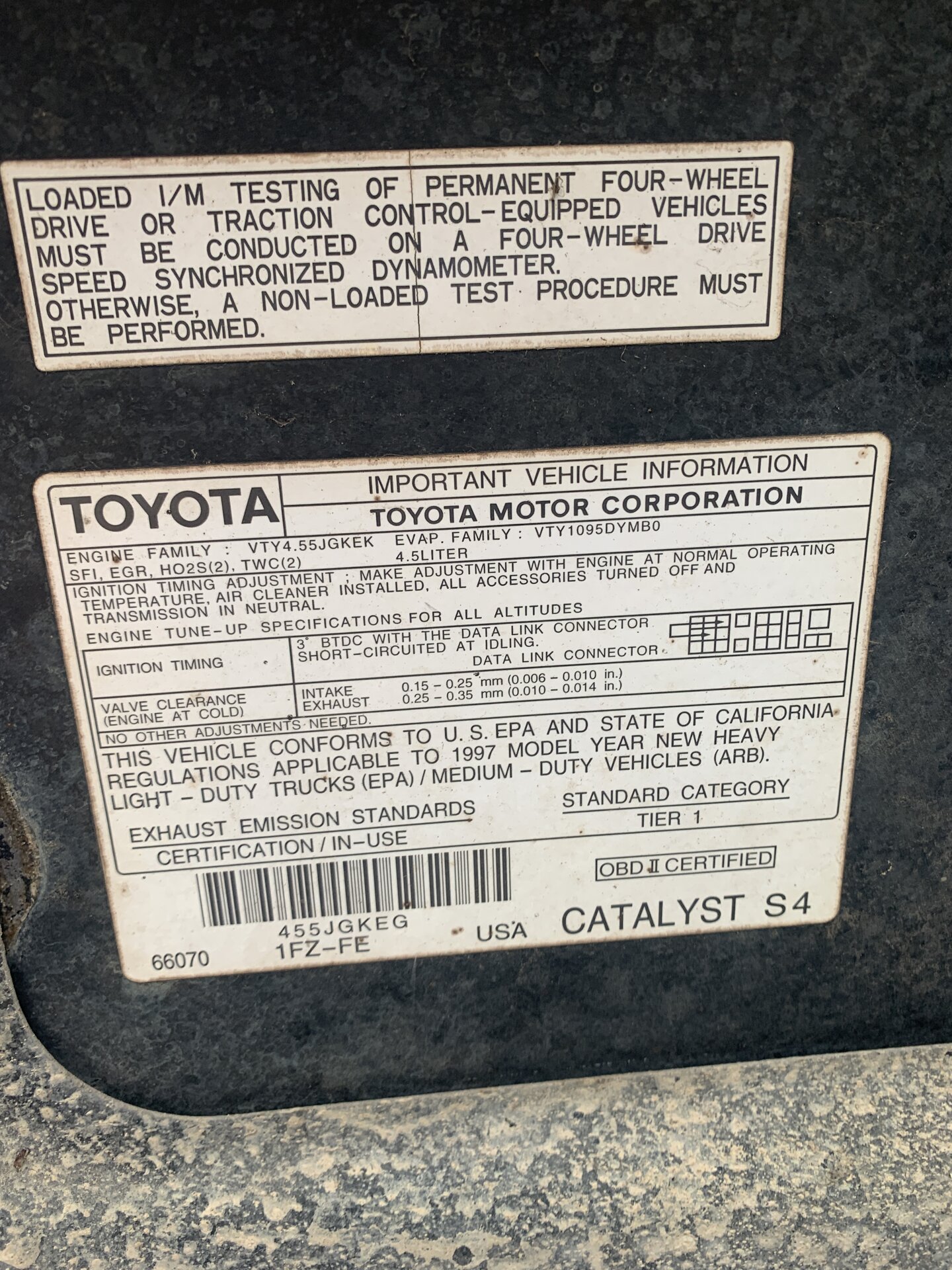

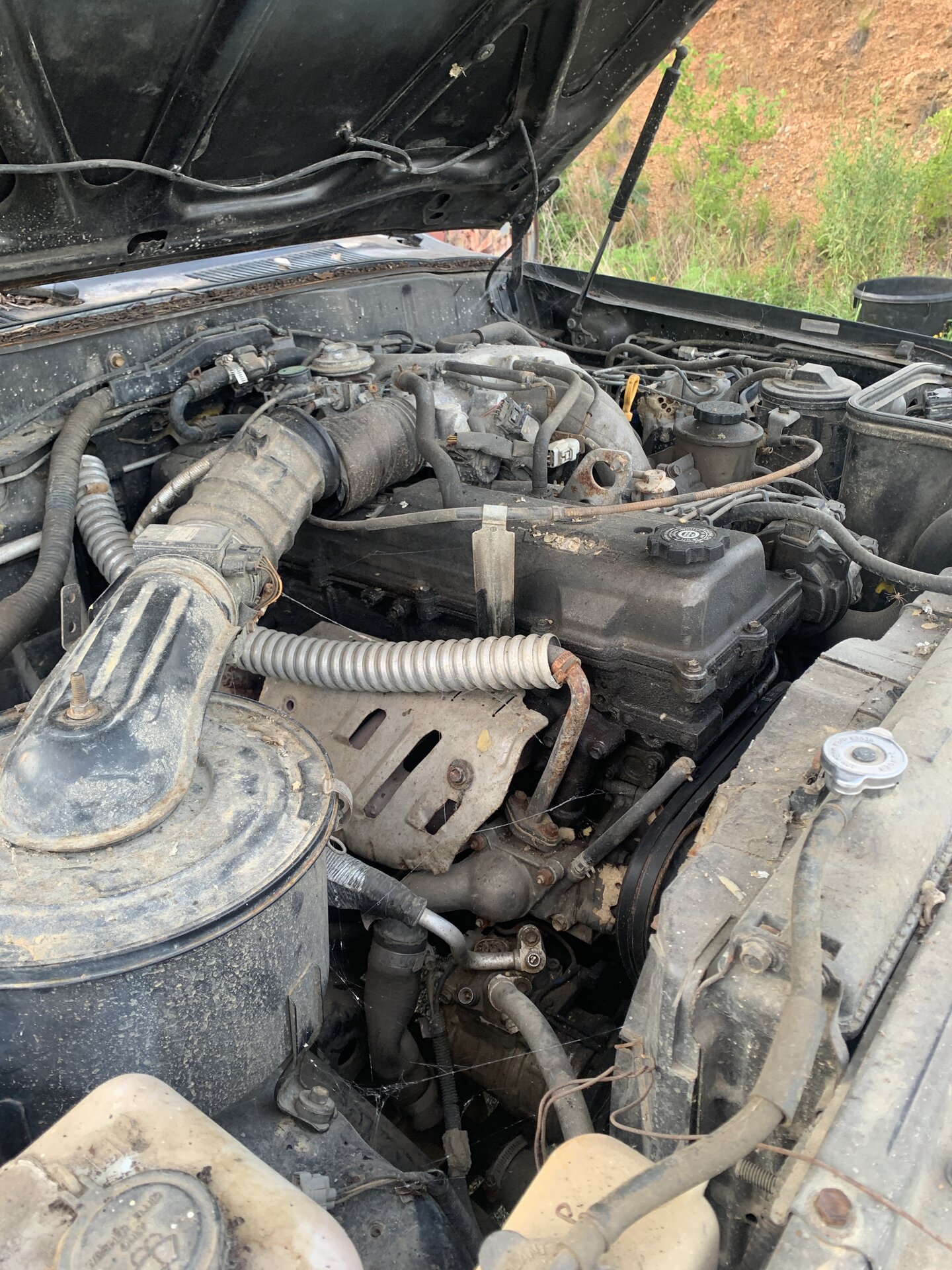

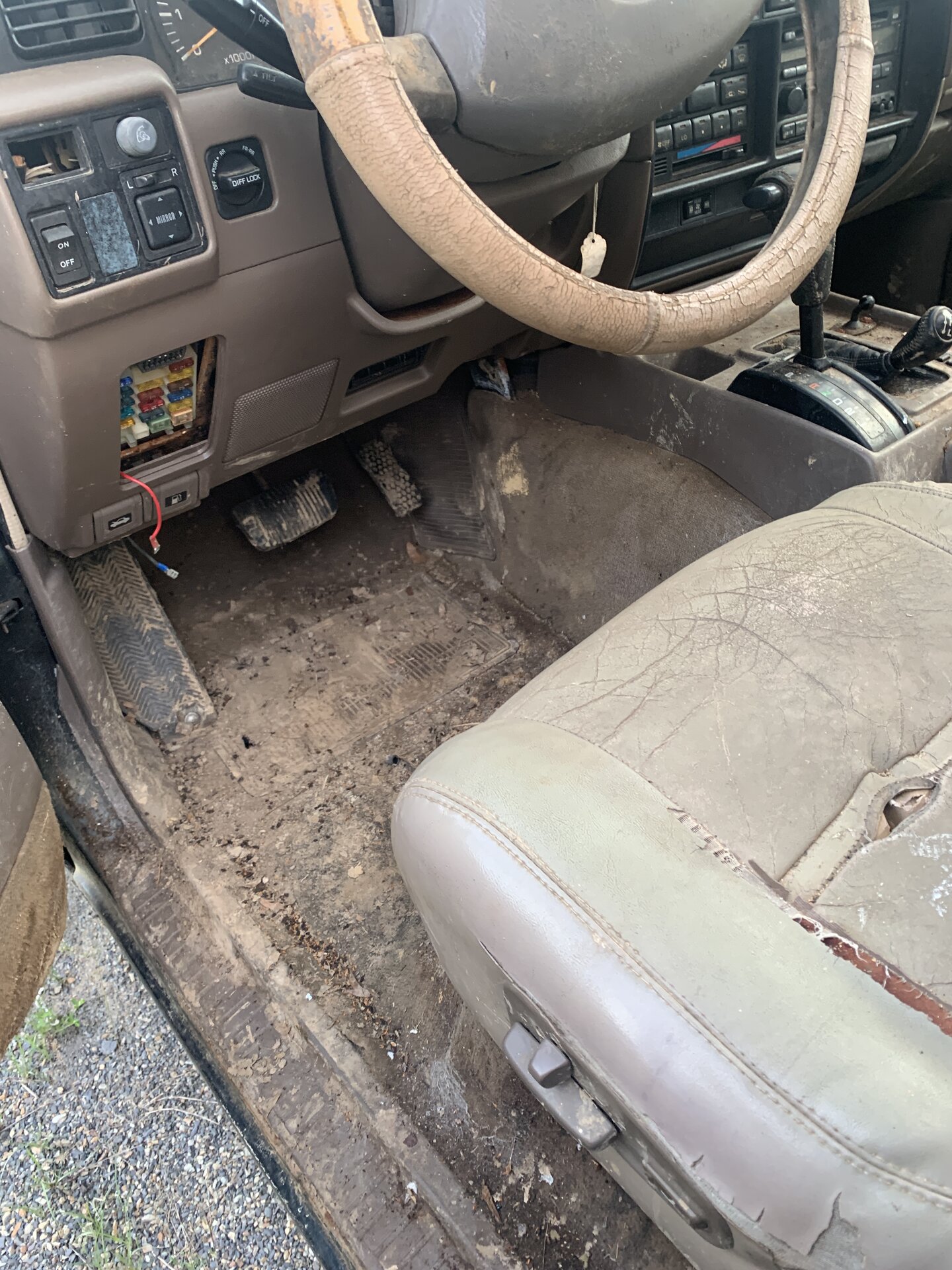

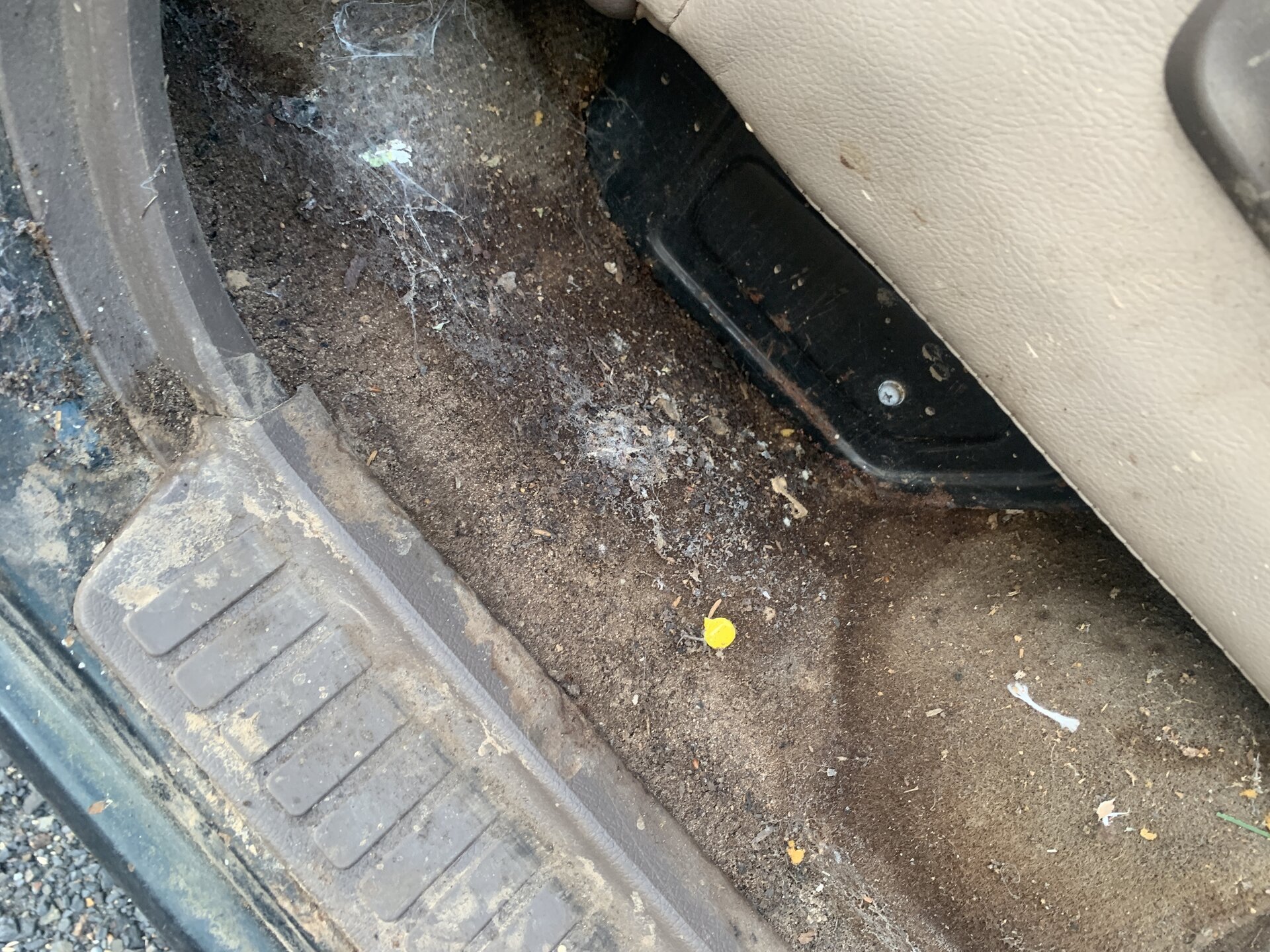

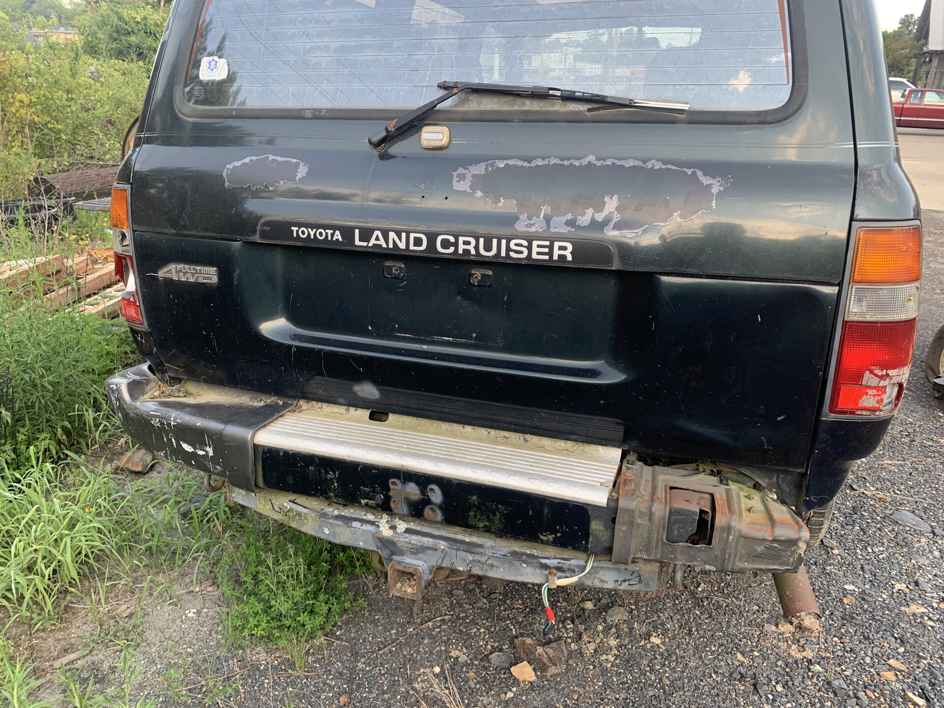

I have an opportunity to purchase this cruiser and wonder if it’s worth taking on. Not sure what it’s worth or what to pay. It’s rough, doesn’t run, paints bad, some rear body damage and needs lots of tlc. Why do you think? 1997 triple locked

He says the fuel pump might be bad.
IOW he was just tired of dealing with it and has let it sit for the last 5 years. In all likelihood it's going to be something other than the fuel pump. It may be triple locked but expect that the lockers will not engage.

Make sure the engine turns over before you buy it.
If it quit due to HG, then you may have a cylinder with coolant in it for 5 years. if that's the case then you're looking at a full rebuild.
Plan on replacing the cooling system (All hoses and radiator)
Plan on a full reseal of the engine (VC, Spark Plug Tube Seals, PCV grommet and hoses, Dizzy, Oil Pump, Front Main and all vacuum tubing)
Plan on a full front and rear axle rebuild (not necessarily differentials)
Plan on changing all fluids in trans, TC, Diffs, Engine
Plan on replacing Power steering hoses
Plan on all four calipers, 7 brake hoses, new LSPV, rotors, pads. Maybe booster and MC
Needs a new (and correct) intake hose (rubber)

The interior might not be as bad as it looks. Don't get me wrong that is currently nasty but pull the carpet and pressure wash it and you may have a salvageable carpet. While it is out clean the living sh*t out of everything else, I am sure there is a smell emanating from inside:rofl:. The steering wheel cover is trash but the stock wheel under it may be acceptable. ***If you get it, take note it is currently in 4LO currently.
As for the outside, I would clean it up and figure what "needs" to be fixed/replaced and compare that to your budget. Fix the safety things first then the nice too have things. @BILT4ME stated plan on mechanical repair and/or baselining. There are a few guys on here that part out trucks on the regular and may be a cheaper way to get it back to life.

It's gonna take a lot of work, time and money! Not gonna be a show truck but something to take down the dirt roads and hunt from. There is definitely some smell coming from it, not sure what's all in there. It will be satisfying to clean the interior and rid of the smell. Not sure why it's parked in 4LO.
