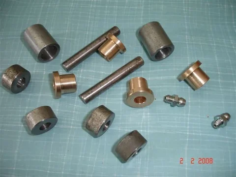

And here's the new phosphor-bronze bushes being made:
And here are some more parts I've made/assembled:

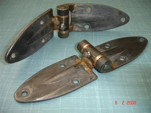

And here the completed hinges:
And here they are painted in Sky Blue: -- Daa Daaaaaa
Finally I will be able to look at my hinges and see "things of beauty" rather than "manufacturing errors".

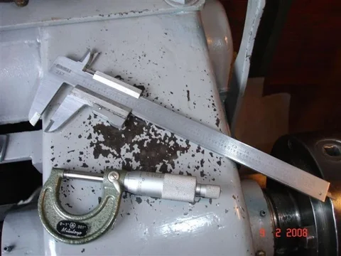

However you need accurate measuring gear like the micrometer and callipers I use:
Lucky my lathe is REALLY OLD because the dials are callibrated in "units of antiquity" - that is, inches (or thousandths of an inch to be more correct). So this would suit you people in the US of A.
Thus I selected micrometer and callipers that read in inches. (Actually the vernier callipers measures in millimetres too which is very handy for me. I often switch to and fro between the different units while tackling the same job.)

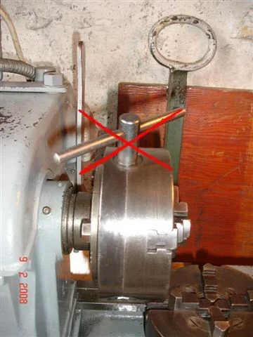

Now safety is always important. I really had to "cringe" when I took this photo:
That is an absolute NO NO.
Never ever ever ever leave the chuck key in the chuck. Unlike using a drill press (where doing so is still dangerous), a lathe places your head/eyes directly in the firing line almost ALL the time.

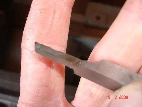

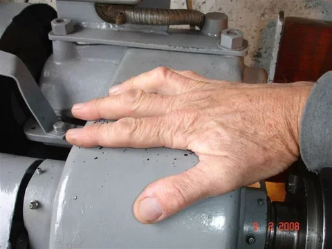

But I'm a slow learner. See my right hand here:
Well that crooked finger is the result of leaving the key in the chuck (and I was lucky).
Back in the days of horses and carts (well ALmost), I drove a 1965 series 2A diesel landrover. And I had this brilliant idea for fitting a heater. (Back in those days, REAL 4x4s never had such luxuries.) I was going to make a heat exchanger between a section of the exhaust pipe (nice HOT temperature source) and the air flow from an electric fan/blower. So I sneaked into the works factory one Sunday when no-one else was there (I had been given keys) and began turning up the parts on a MONSTROUS lathe there. But I was unfamiliar with it. I hit a lever that I thought would take the thing "out of gear" (so I could turn the chuck to a better position to turn the chuck key) but that lever "fired it up" instead. And you guessed it - the chuck key spun around - caught my wedding ring - and stalled the lathe with my finger jammed between the chuck key and the lathe bed.
Actually it didn't hurt and there was no blood. Well not at first - That came later. But I know why they say we are made up of 90% water. Some clear liquid just like water was sitting on the lathe bed near my jammed hand. Anyway, too scared to touch any other levers - I bashed the chuck backwards off my hand with a mallet that (luckily) was sitting nearby and drove myself to hospital.
I've NEVER worn a ring since. (Mind you that one ended up too flat to get anything though it.)
Ooops. Sorry for the sidetrack. But never eeeeevvvveeeerrr leave the key in the chuck!!!!!!

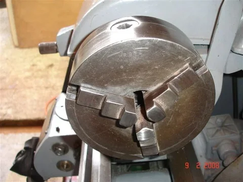

Now - carrying on here- My lathe has a 3-jaw chuck:
In this, the jaws can't be reversed (can't be turned around individually to face in the opposite direction) but I use this chuck most often (and used it for all the hinge work) because the jaws remain "centred" in all positions. (Any key-hole moves all 3 jaws in unison.)
I also have a 4-jaw chuck:
In this photo each jaw has been turned the other way around. That must be because the last piece of "work" I had been turning/drilling in that chuck must have been held more securely that way. (The "work" should NEVER be able to work loose. If it does, you're in BIG trouble!)
With the 4-jaw, each chuck-key-hole controls its own jaw --- So you can turn things "off-centre". Or if you are REALLY fussy, you can turn things even more CONCENTRICALLY TRUE than the 3 -jaw allows (because you can perform the centre-ing operation manually to perfection!).

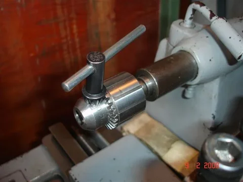

With a lathe - drilling is normally accomplished in the opposite way to a drill press. --- You spin the work instead of spinning the drill.
Here is a picture of my small drill chuck in the "tailstock"
And here is the larger one.
I don't cringe when I see these chuck keys left in place because those chucks don't spin ---- UNLESS of course the drill bit "grabs" (so I still wouldn't leave the keys in place when the lathe is in operation).

Here are the two reamers I used to make the hinges:
The far one is 3/8" parallel and the close one is tapered.
I used the parallel one to create the final bush ID and for the outer "collars" for the pin supports. ((Although I had to increase the bush ID slightly by twiddling 200 grit wet-and-dry in the hole while it was wrapped around a drill bit. This drill bit was selected to be as large as possible while still fitting through with the wet&dry paper wrapped around it.)
The tapered reamer was used to create an "interference fit" for the pins in the inner collars.
All hinge halves are labelled LF LR RH or RR to fix their on-vehicle orientation.
If ever the need arises in the future to dismantle those hinges - those pins needs to be pressed OUTWARDS. (Can't see the need arising though.) The pins would be next to IMPOSSIBLE to push out in the opposite direction.
The pins are made from 3/8 "bright steel". This is more "dimensionally perfect" than ordinary mild steel rod.
The OD of the bushes was turned as shown in an earlier picture but the intial ID (before reaming and after drilling) and the ID of the "tubes" they sit in was turned using this hand-made boring bit (made from "high speed steel" which is what ordinary drill bits are made from):
This "boring bit" requires "opposite chuck rotation" - which is OK because the lathe motor has a forward/reverse switch.
Oh yes. I bought a 300mm length of 20mm solid round section phosphor bronze ($50NZ delivered) so I have plenty for future bush manufacturing.

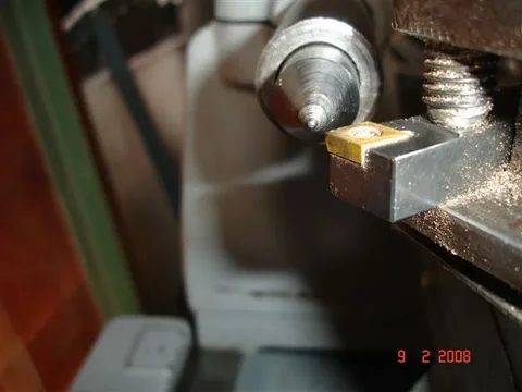

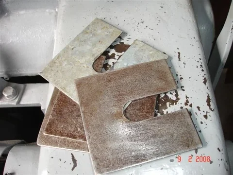

Another thing ------ You must "centre" the "cutting edge" of the "cutting tool" before you do any turning from the "toolpost". This is done by lining up that edge with the "centre" when the "centre" is in the "tailstock". (It doesn't take much thought to work out how the "centre" got its name.):
Here are the shims that you add or remove to get the height correct:
