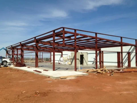

Pictorial point.
6 guys and two man lifts, the 100' liner panel on wall should've been 2 hours worth of work (no itch).
Took 8. Constant 45mph wind. At this point, I'll be running in red by Thursday of next week, the job literally taking 60% longer than it typically would.
Now, had this job been attacked with veracity by the GC in December, as it was supposed to be, wouldn't be in this situation, but hard to charge for wind, yet can't sit at home due to growing workload with deadlines and employees retention rate will suffer.
Point, in relation to this thread ( which I'm fully aware of your particular plans/situation, PA ) is, from a professional "git-er-dun" standpoint, digging trenches, Simon forming, then pumping a job this size, while expensive, would've been a two day job (IF 24hr inspections are guaranteed), and would be allowed for work to progress on the slab and framing, in a few days without freezing precipitation.

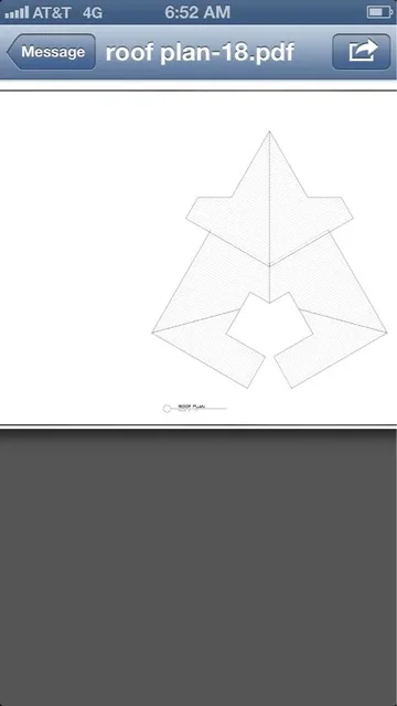

Unloading a stretch trailer ( in the cold arse rain, though 80, yesterday ) that cost $3,100 from Houston to OKC area, because of an architects failure to realize the limitations of architectural SSR.
I don't specifically market metal roofing fir post frame, since its a Pandora's Box of problems, but have done several for contractors through the years, this being the fourth for the same on a tribal medical complex.
What began as a simple 6,000sf gable, Econ-SSR morphed into the most cut up POS I've ever agreed to do, requiring a much more expensive SSR. I would've walked had GC not been a very good account.
Now 9,100sf, with less usable.
Longest run is 56'. 53' the legal limit in TX/OK.
Think there's 20 panels on the entire roof that don't cut at eave and peak, which consumes a fortune in time.
Net result. Originally, they budgeted $21k. Costing $55k and I'm hoping I come out in the black.
