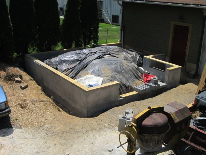

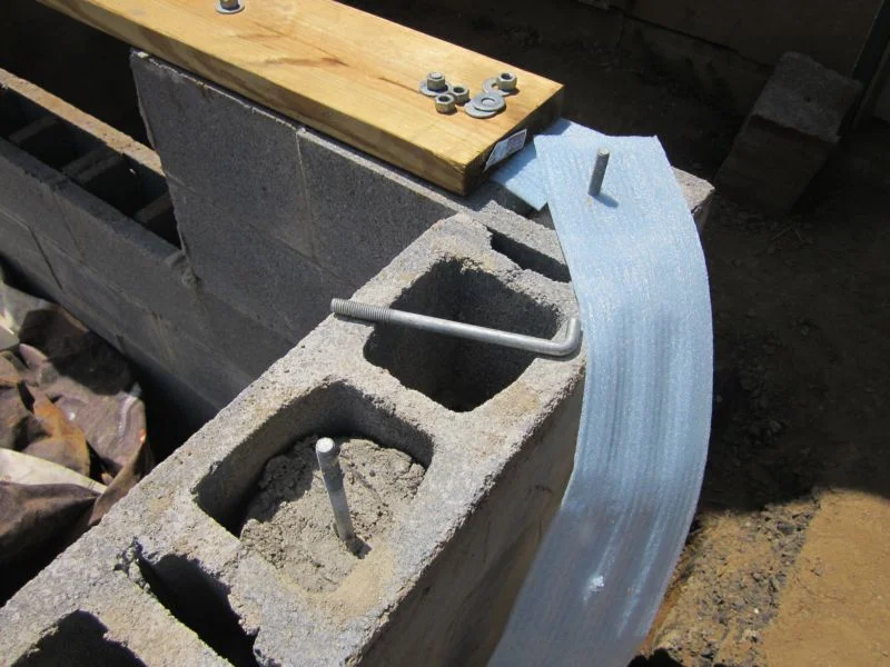

Ok, first picture is an overall of where things stand. Foundation inspection passed yesterday, L-bolts grouted in place, sill seal down, and sill plates bolted in place.
Second picture is a closeup to better show what is going on. L-bolts are grouted into the cells of the top row of blocks, sill seal is run across the tops of the blocks,*and then pressure treated sills are bolted in place.

When you say "L bolts grouted in place", are you using cement in the block holes?

I've parged the outside face of the block in preparation for an eventual stone veneer. Basically a mortar mix with an acrylic latex admixture for bonding.
Likewise, the anchor bolts are grouted with a cement/sand mix (no stone).

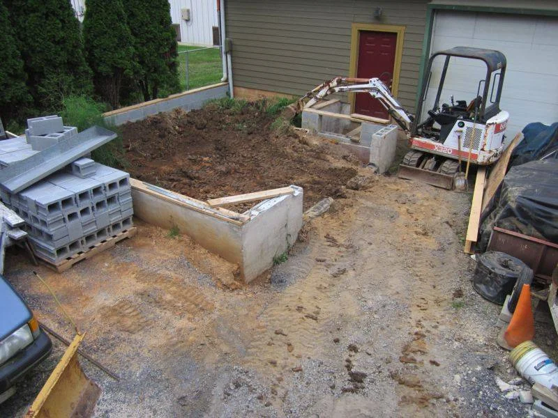

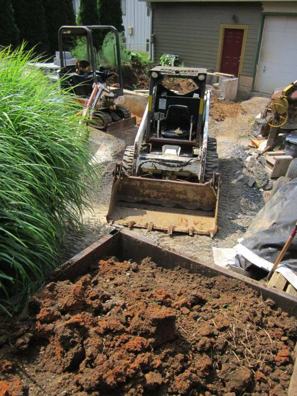

Picking up where I left off, I started off by hauling all the extra soil out to a friend’s house to fill in a low area for him.

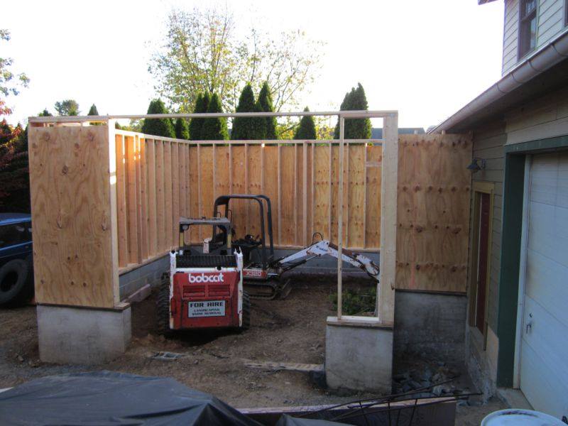

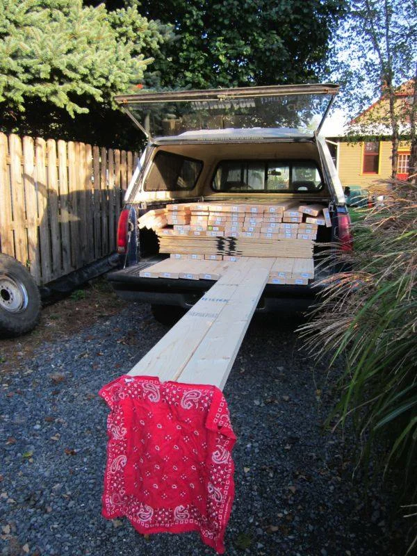

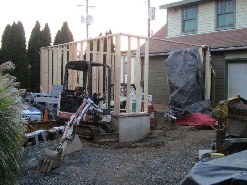

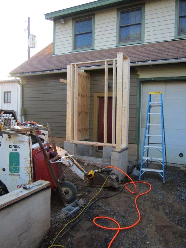

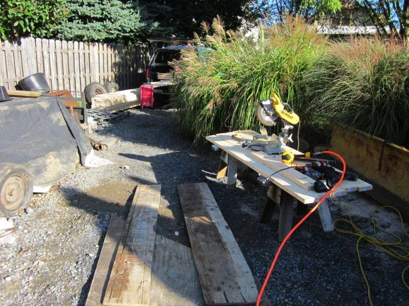

From there, I picked up a load of lumber, set up a station for the miter saw, and got to work framing up the walls.

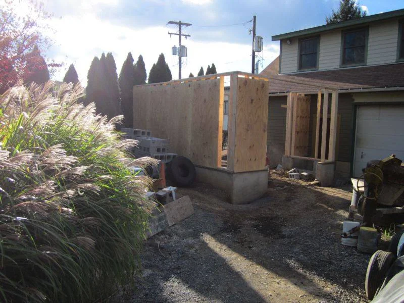

From there, it was just a matter of working my way around with the wall framing and then sheathing.

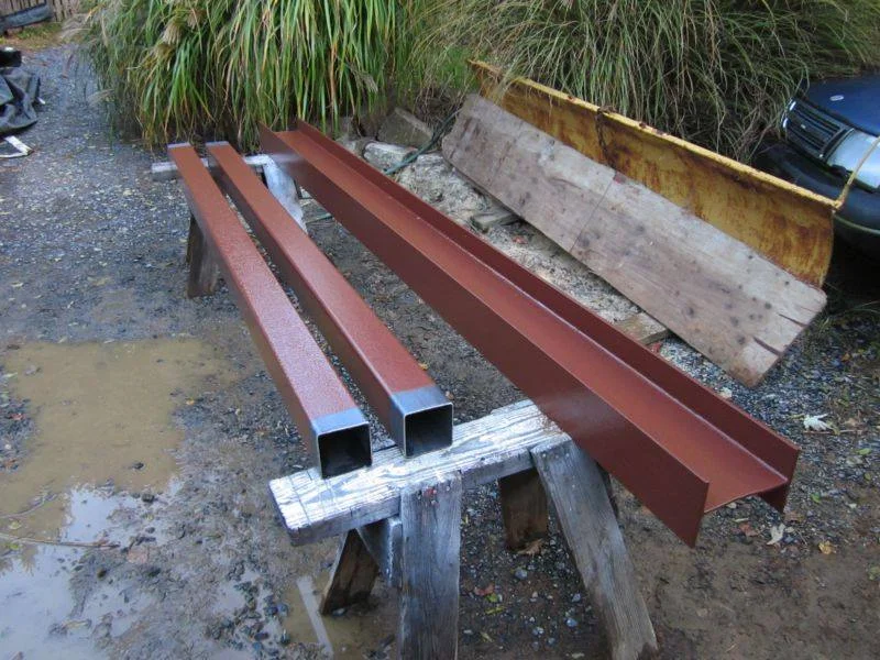

I was doing my best to keep space above the door fairly tight, so I used a steel beam and tube columns for the overhead door lintel.
