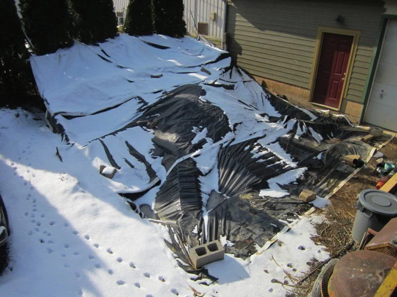

Well, the weather is slowly turning more favorable. This past weekend had nighttime temperatures above freezing for a couple days. Unfortunately, the first step was cleaning out the dirt that had fallen down into the trench on top of the footings. I had really wanted to get one course of block laid the whole way around and then cover that so that I wouldn't have that problem. Mother Nature didn't quite cooperate with that, though.
So I now have the back side corner set, one course set along the back wall, the front side corner set, and one course set along the side wall. Next possible warm weather is in a week, so I want to get the rest of the trenches cleaned out by then so that I can just concentrate on laying block.
With the corners set and the first courses laid out, things should go quicker to just fill in between corners.
You know, it'd be very helpful if you could just set a video camera on a tripod and give us a time lapse video! Just kidding.
Well, for the past two months it would have pretty much looked like this - just add snow, watch it melt, watch it rain, watch it dry off, add some more snow... :D
attachment.php
Well, they had been saying that this weekend would have overnight temperatures above freezing. Then it moved back to next week, then later next week, then next weekend... Now it is looking like the first week of April will have overnight temperatures above freezing...
