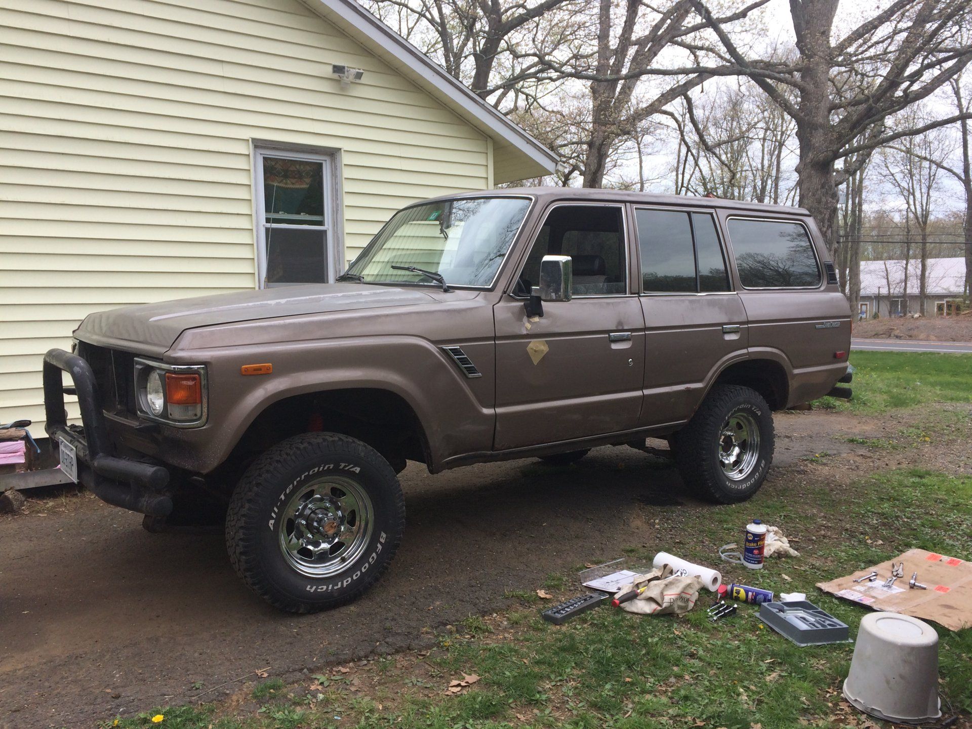

Welp I might as well step up for worlds biggest loser.
The guy sold these as 31’s and I clearly didn’t look closely.
Bet he had a good chuckle.
They will work great with stock gearing. Use them until they wear out and then go to 31s. You’re only looking at 1/2 inch height difference.
And you have new stock wheels.
Cool thanks guys. Still annoyed w/ myself. Swore he had them listed as 31’s. Clearly he found the right sucker.
It may be a blessing in disguise. It will feel really normal with those tires and stock gears. If you want 33s, honestly, it feels more normal with 4.11s. I very transiently ran 33s, stock 3.70 gearing and did not like the way it pulled away from a light or went uphill.
With the smaller tires it accelerates better, brakes better, steers better. It will be fine.
She’s rolling and has working brakes again! Thanks so much to a local club member who accepted my first time ‘hey can you...’ email via Facebook. Bleeding brakes is hard work. My legs are clearly not as strong as I’d like to think! We took a short spin and she feels good!

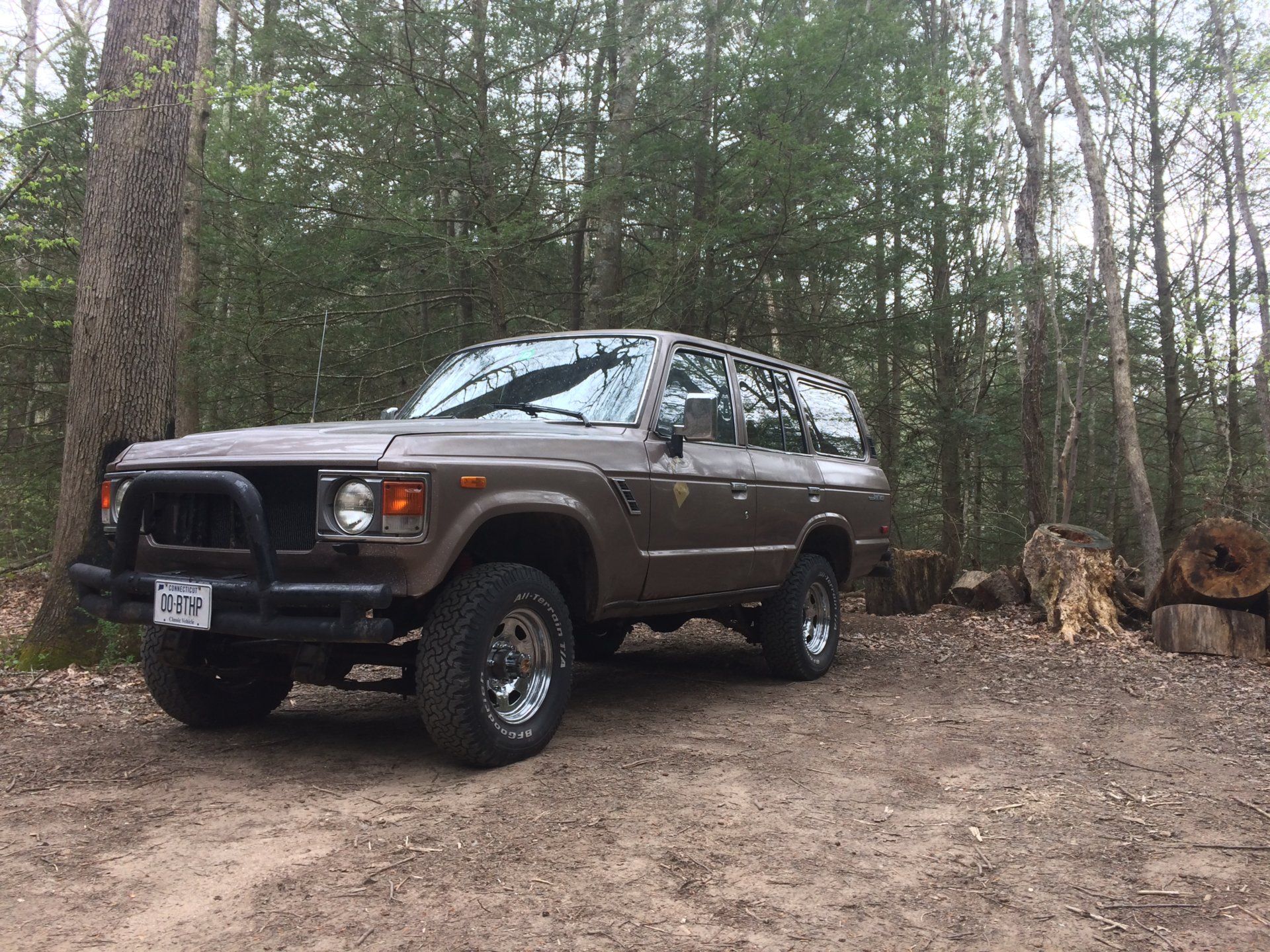

Think I’ll take a break now from wrenching and just drive it a bit before tackling the leaky TREs. While we were driving all I was thinking about was the brakes and suddenly I remembered the new knuckles!!! Woot! Felt nice and smooth like butta’!
Riding nice and smooth. No leaks, no chatter, no squeals. Goes 65 easily.
Yeah I’ve fallen in love again. I’m really happy.

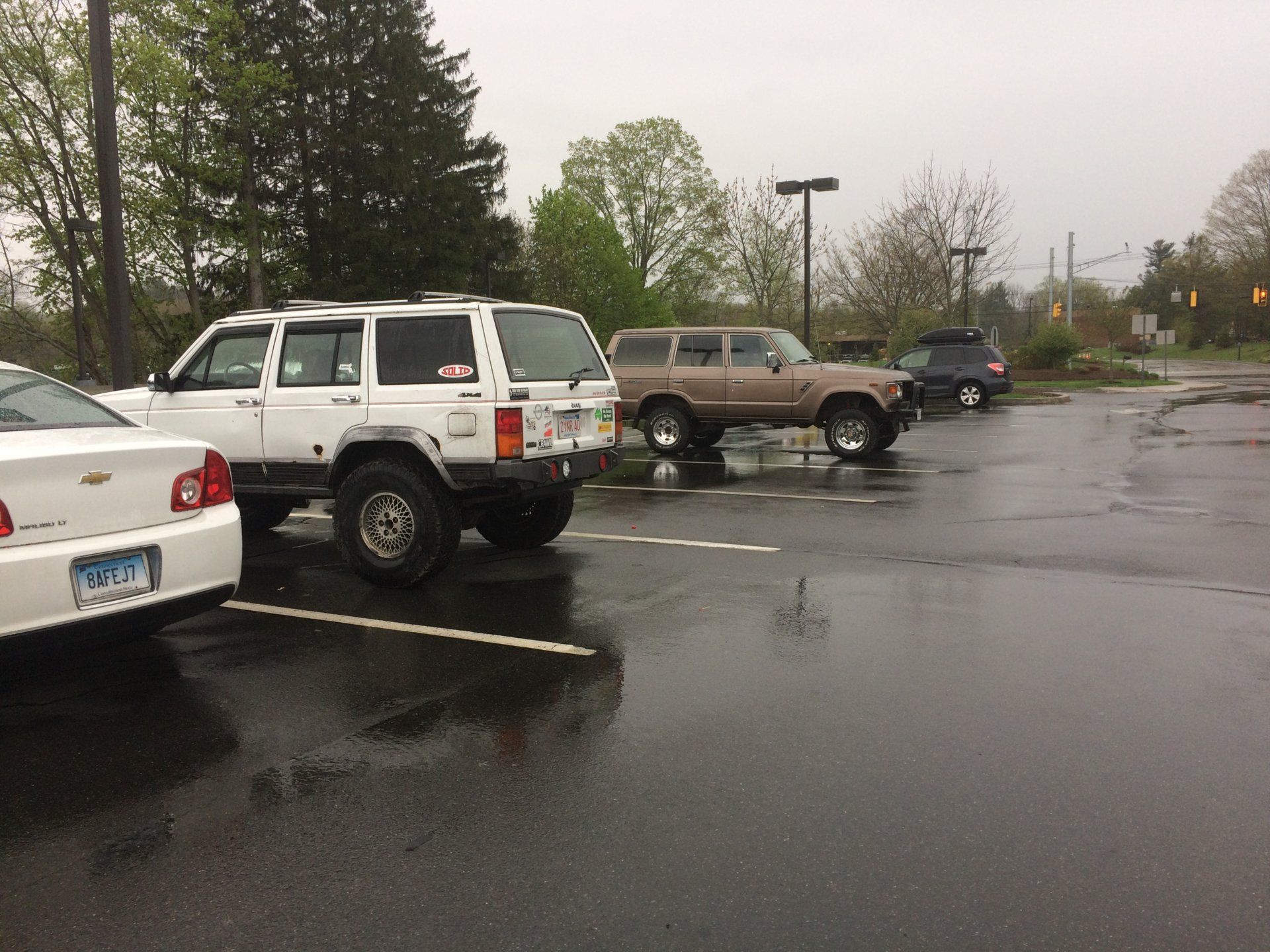

Mines way better but I do like those aluminum rims on that Jeep which had Rausch Creek stickers on it plus many others. Appeared to be a chick driving it. Raining so I tried rolling down my passenger window but it chose to go down slightly sideways and I got sheepish.
And spoke to this Toyota owner at length when I went to Tractor Supply for chicken food... 87 4Runner w/ the removable top. His college sons’ but he won’t let him take it off cuz its never been off ever even by the PO. In super nice shape. I shoulda got out of my truck but I was being lazy.
