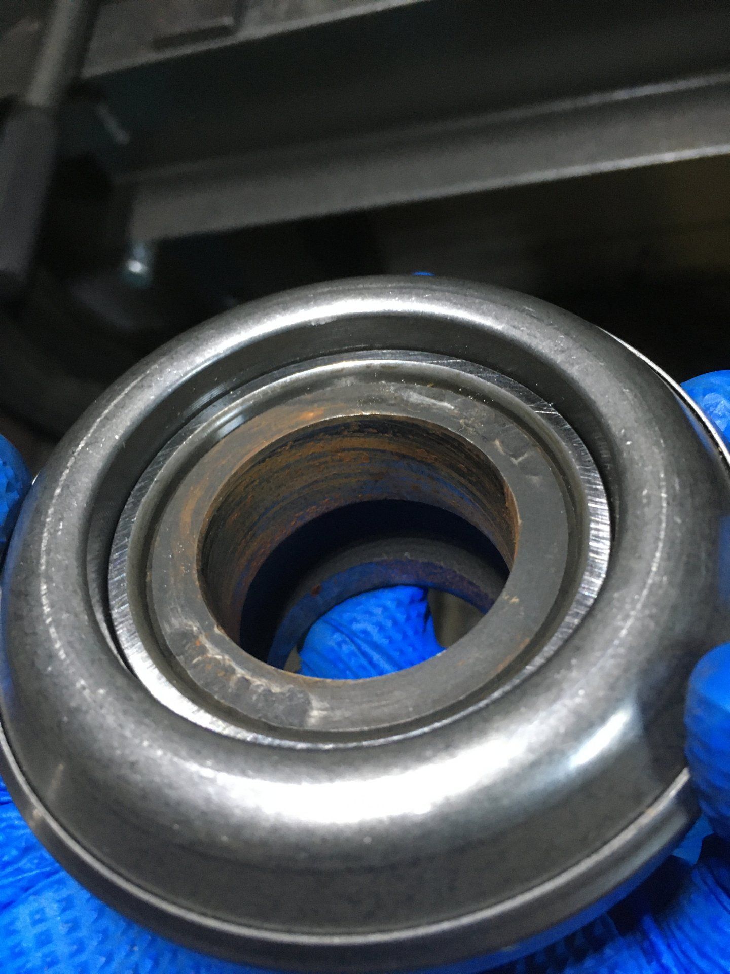

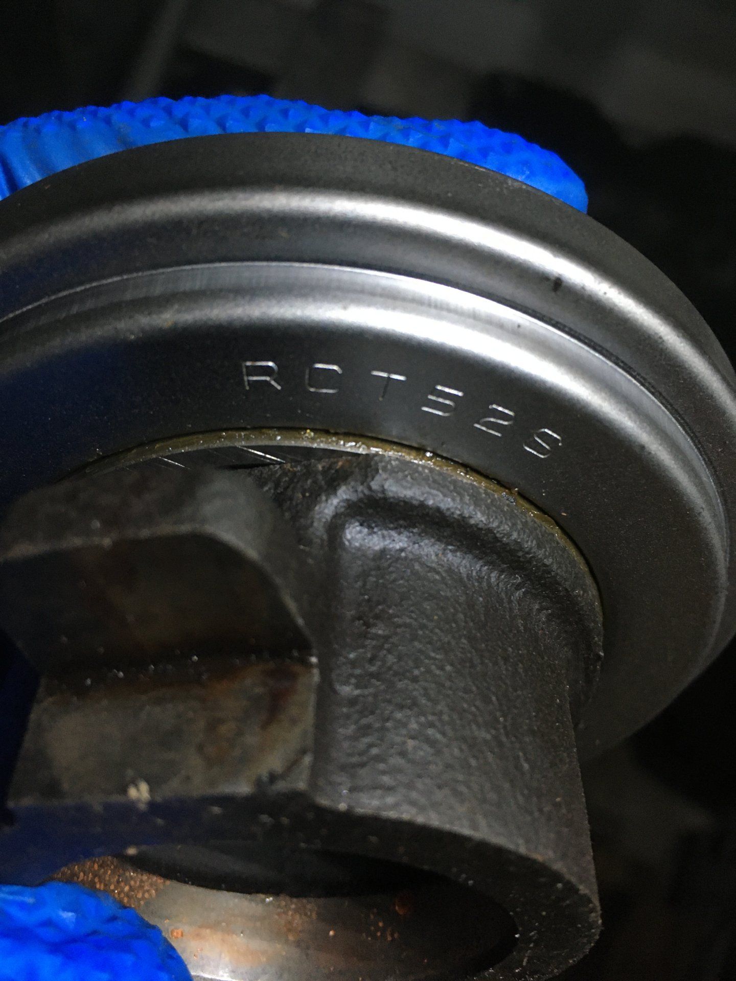

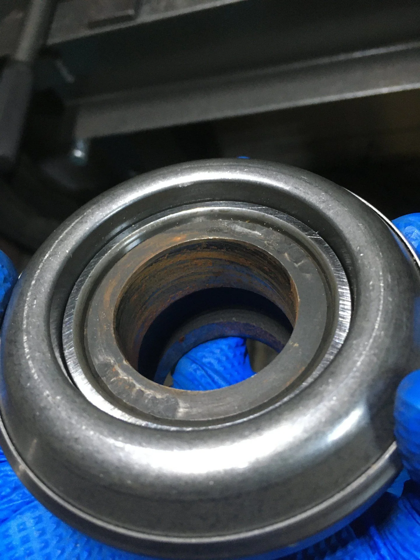

Throwout and it’s new bearing are now close friends.
Really red? 🤮lol
She’s not bad! She’s unique like her wrench monkey. Loud and clear, she’s been f’d with, no getting around it but it’s on the drivers terms. Haha!

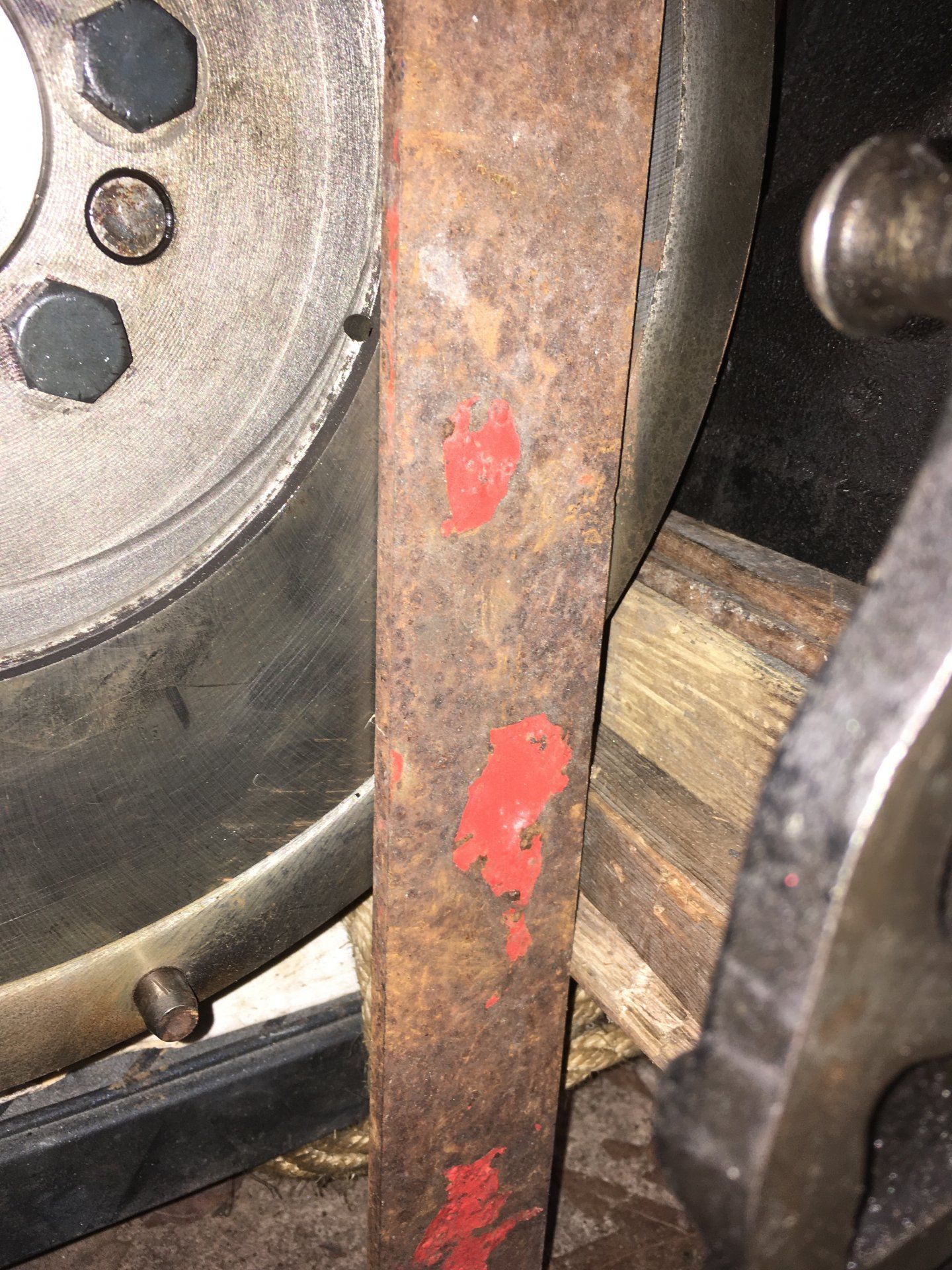

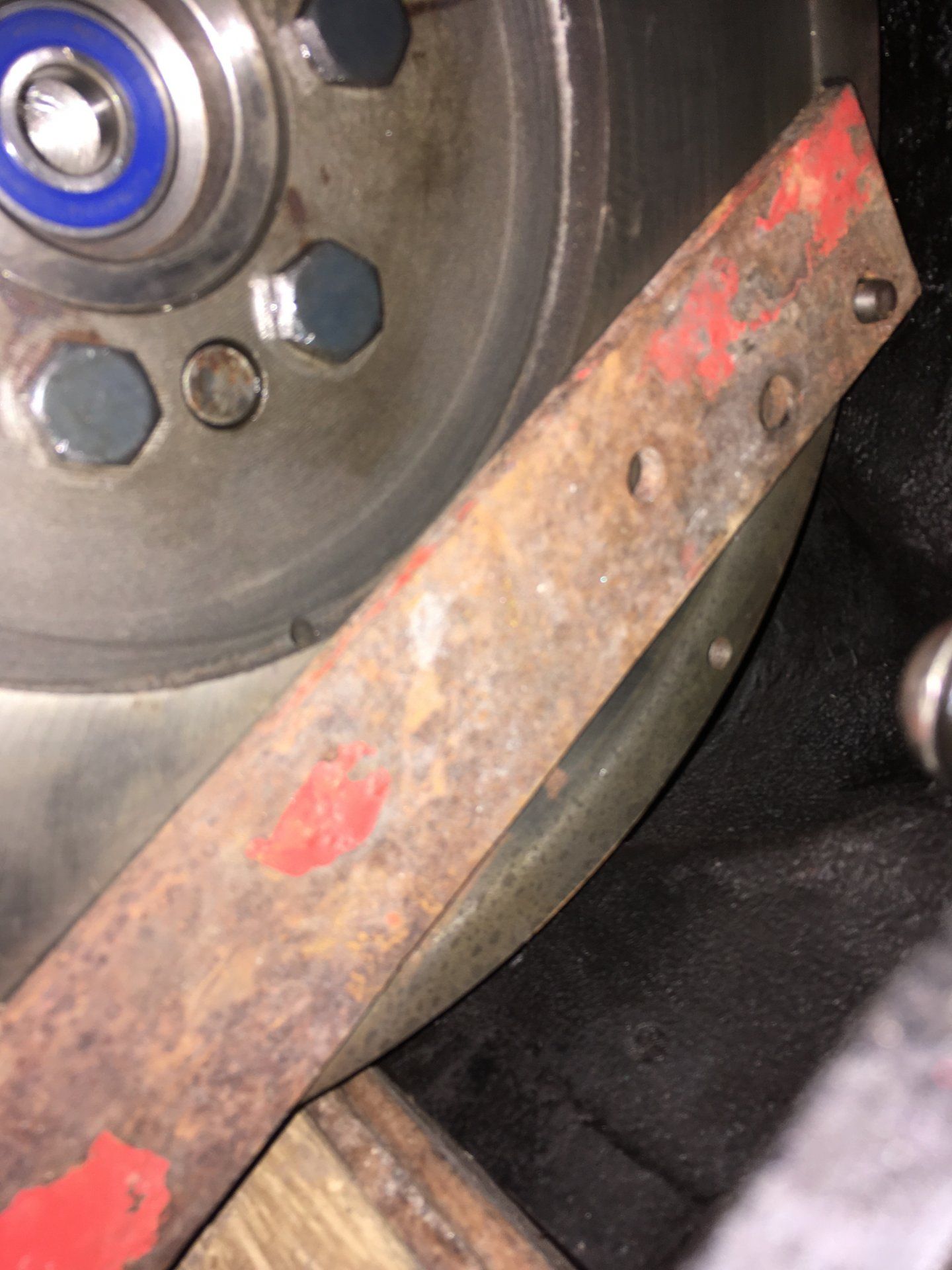

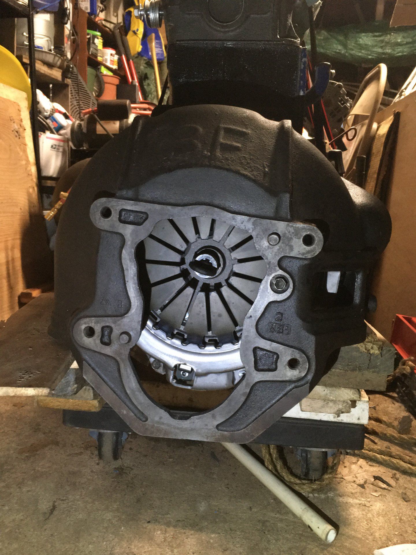

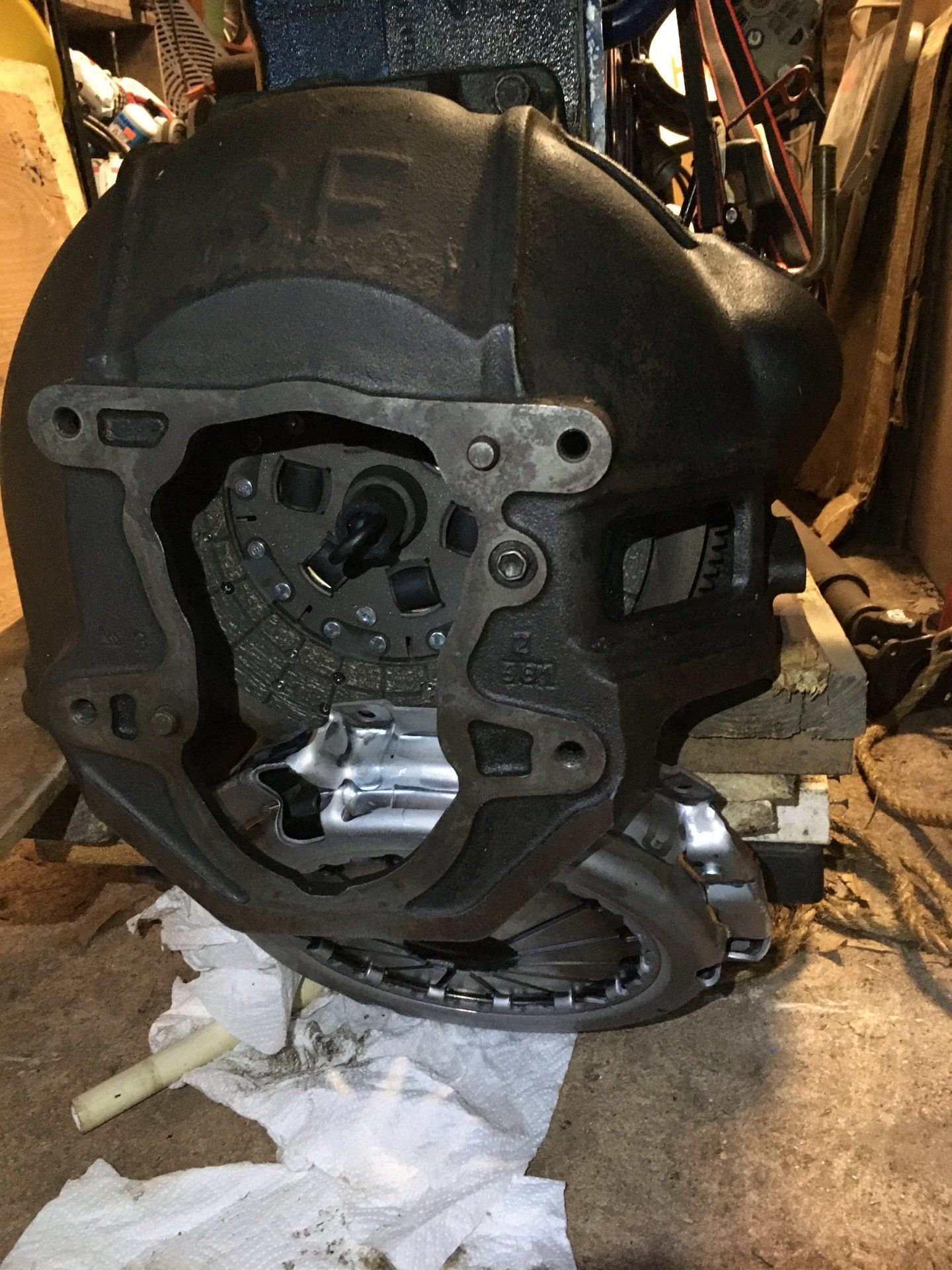

Flywheel is tight. Got lucky and had a perfect stretch of metal w/ a hole perfect for hooking over the alignment dowel and wedged it against the dolly to keep it from turning while I torqued.
Then the clutch disc and it’s cover. That was a joy. Engine is held up by sections of wood under the edge of the BH on top of a dolly. I initially couldn’t fit the cover under so I just started tapping the wood pieces forward till I could wedge of cover under the BH edge and over the disc. And then getting the cover to the right places for the dowels and get a few bolts in place?! Dang, I ended up laying on my back holding it w/ my left as I turned it w/ my right. I’ll feel that tmrw in my arm!
But it’s on.
That second to last picture seems funny.
Seems?! It’s absurd. Grease on my lips from holding my flashlight cuz my headlamp is who knows where. See me in 10 years when I’ve got cancer from ingesting all the grease and grim!
But it’s on.

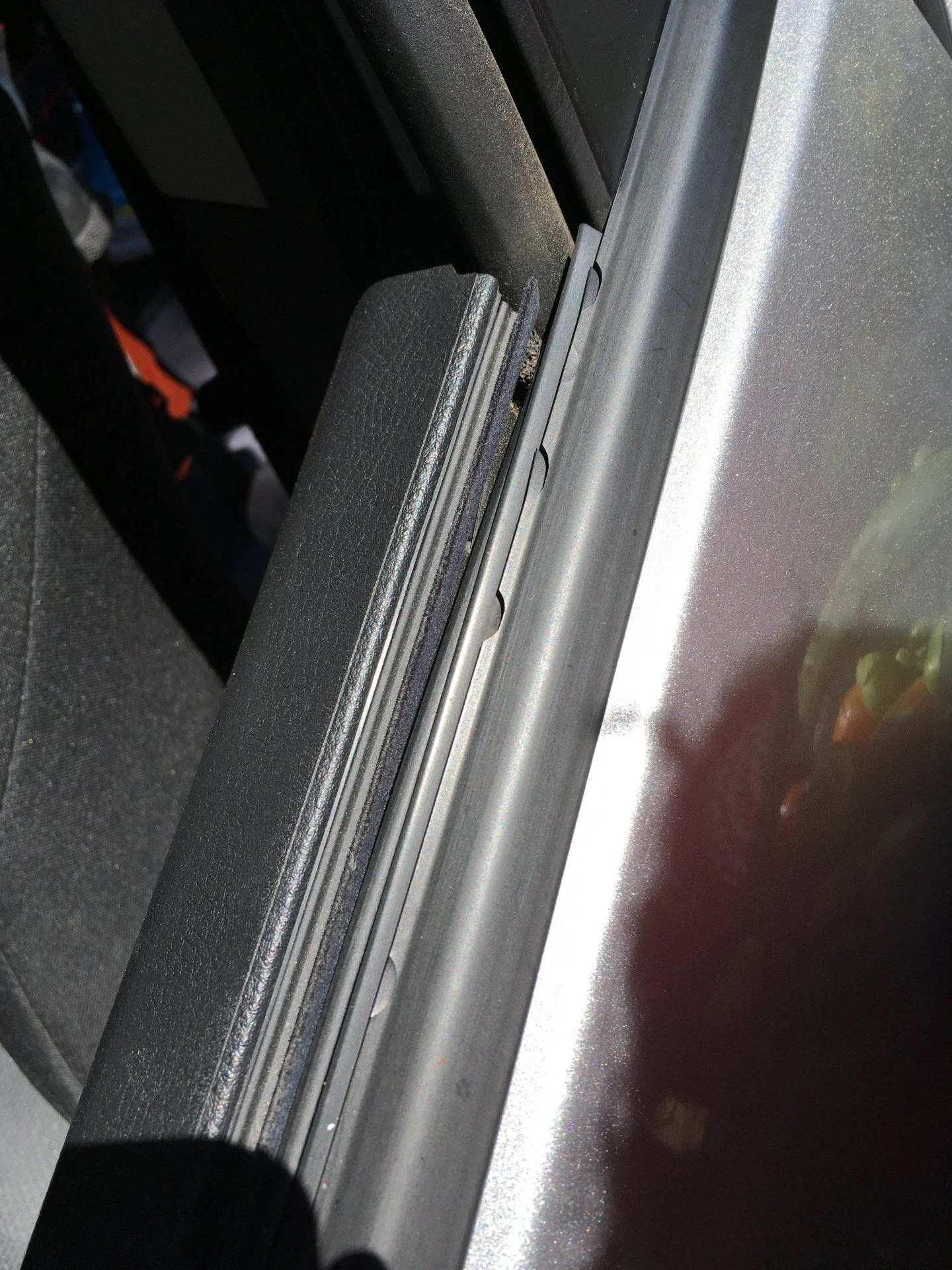

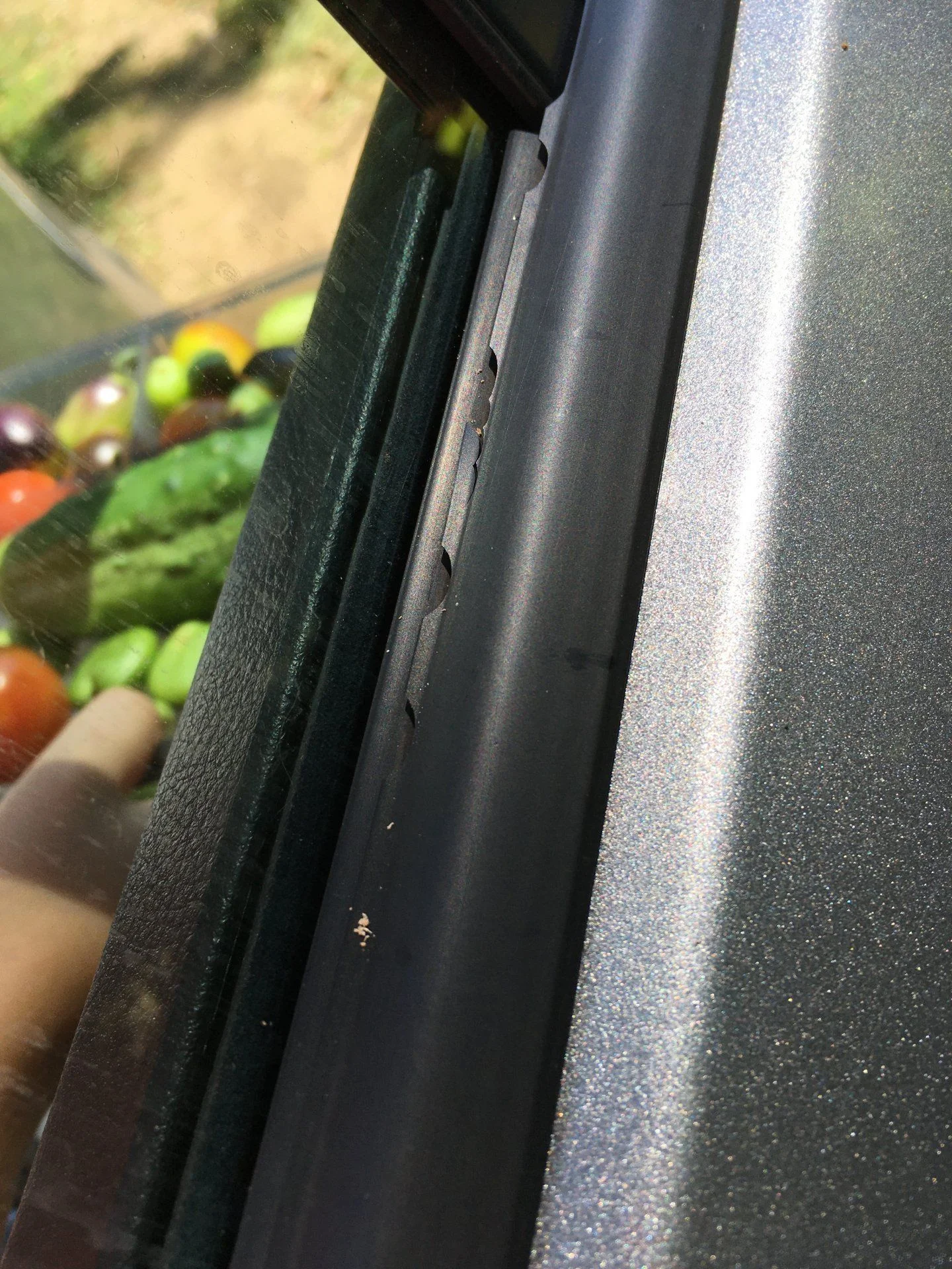

My pumpkin vines took a good beating as well (they’re not producing anyhow, too much shade) and on the Mazda window whatever they’re called. And the Tacoma took a number of dents to its roof.

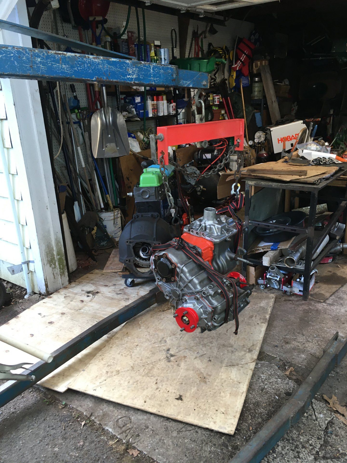

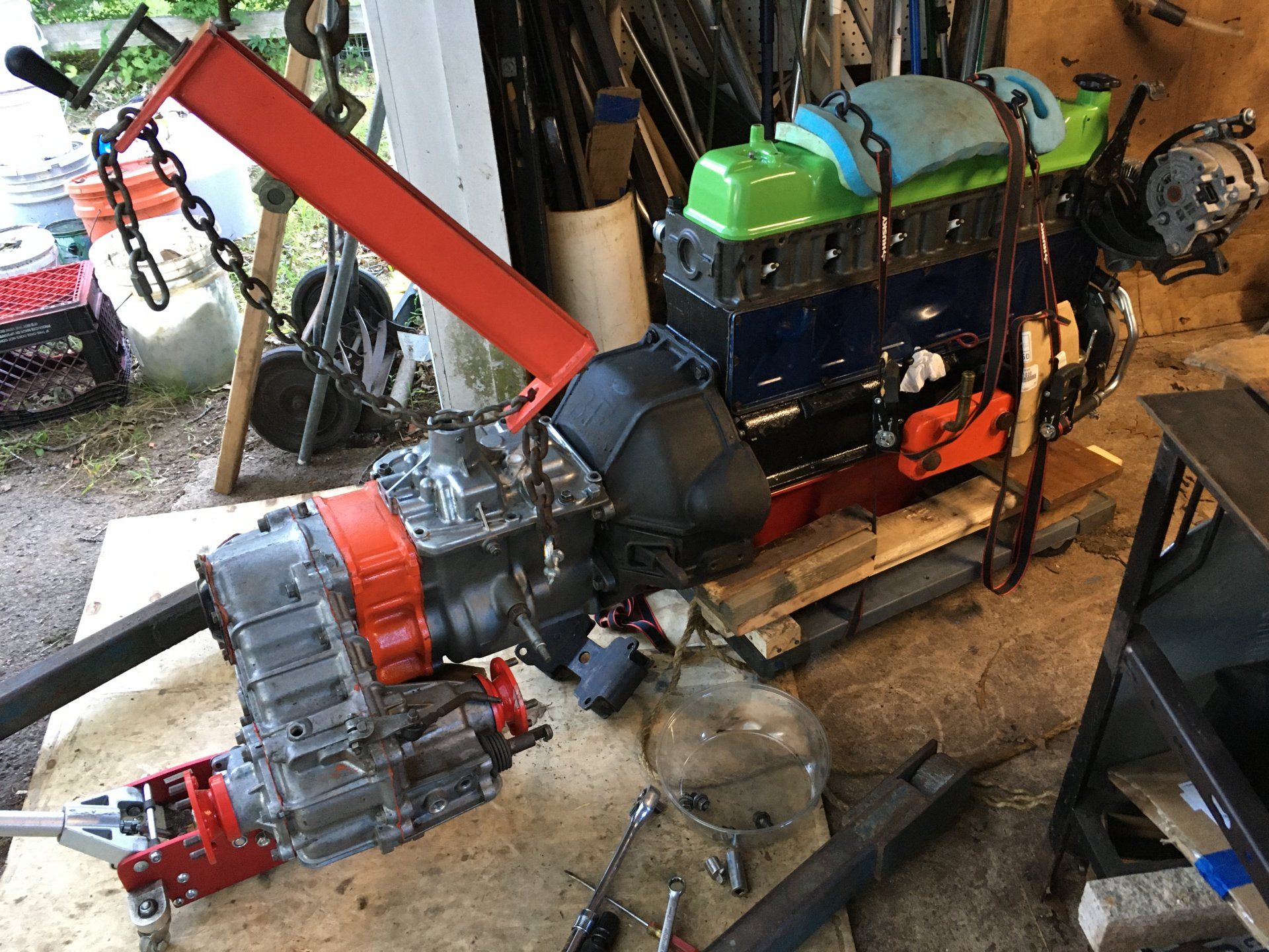

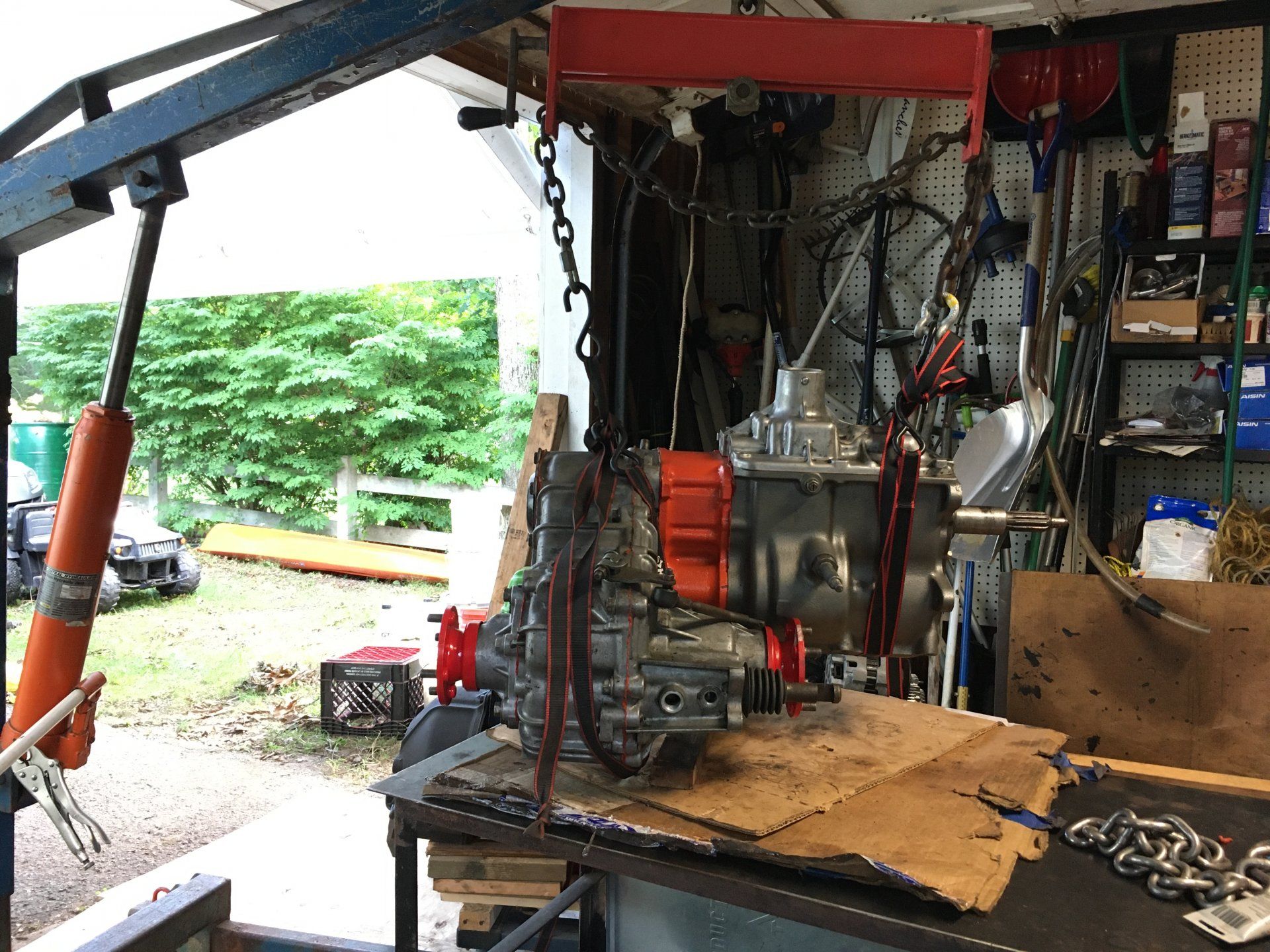

Well they are now one. Wasn’t too tough. Hardest part was maneuvering that fing beast of a hoist.
Wrapped for protection. 🤣
