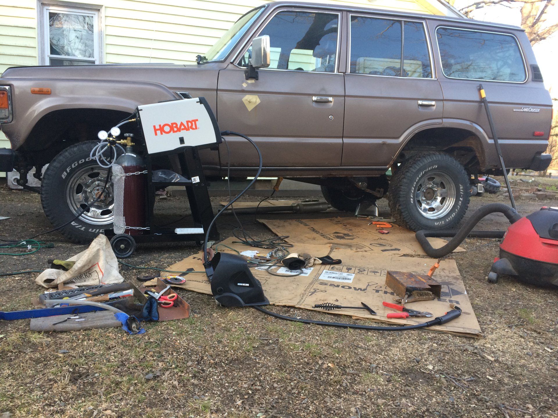

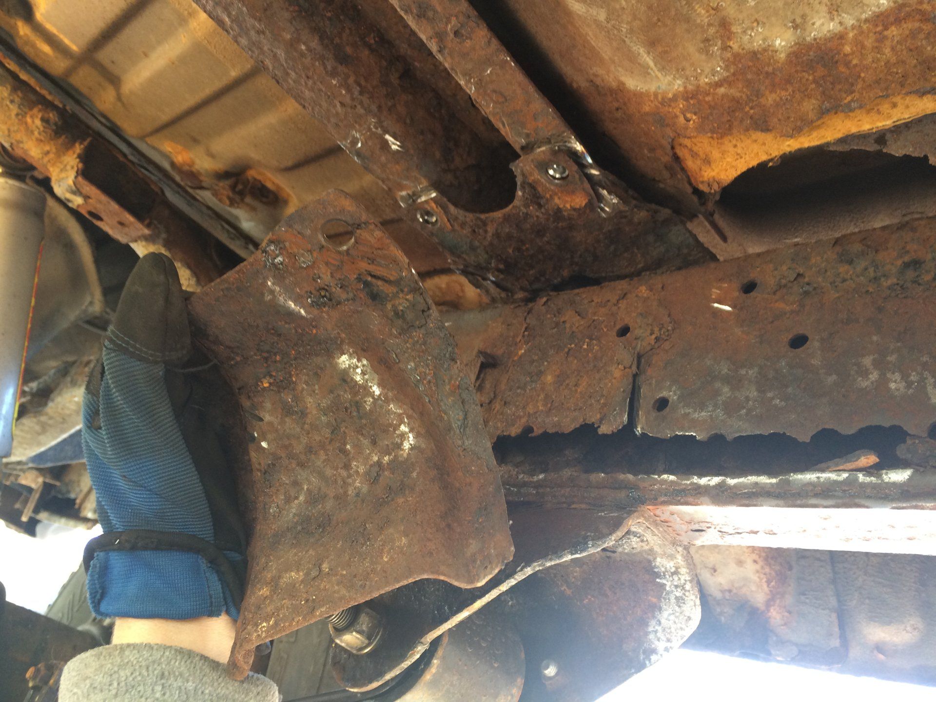

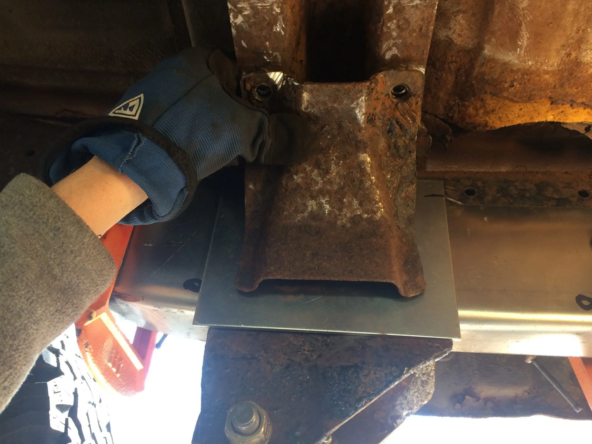

Big stuff happening here for this female cruiser owner.... cut, clean, make patches, test run the Hobart 140 (my first time w/ my own MiG welder), practice beads, anxiety.

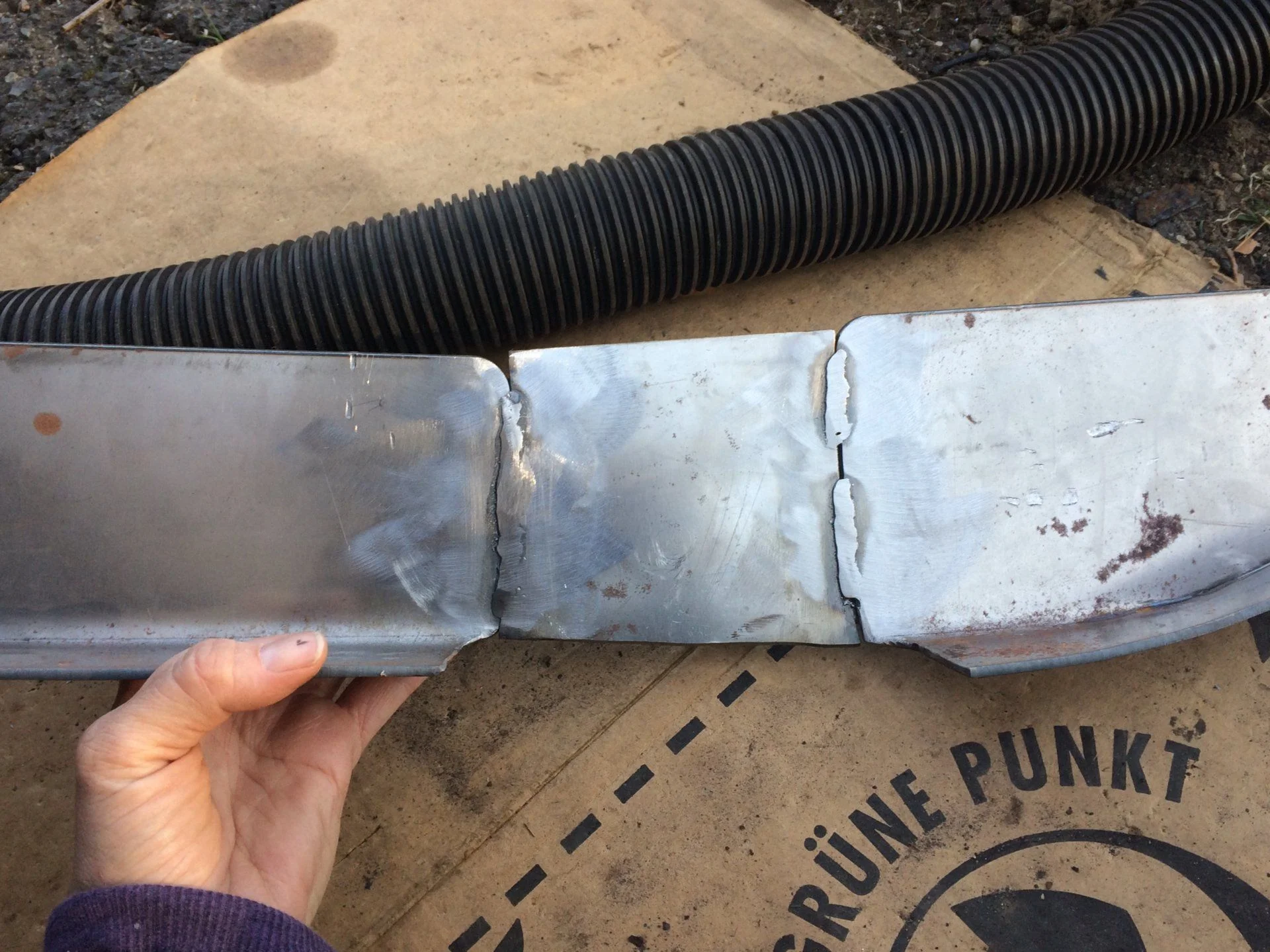

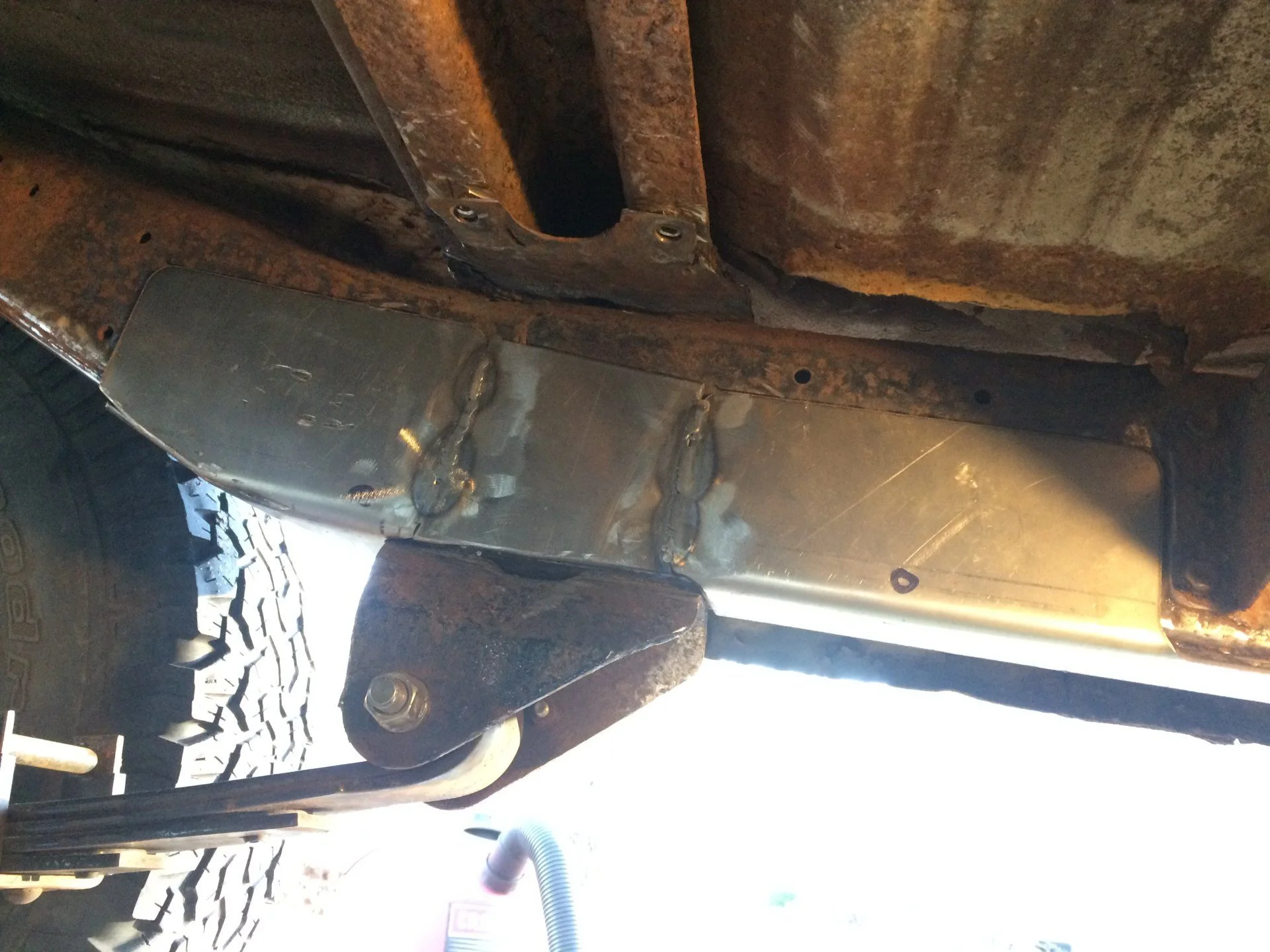

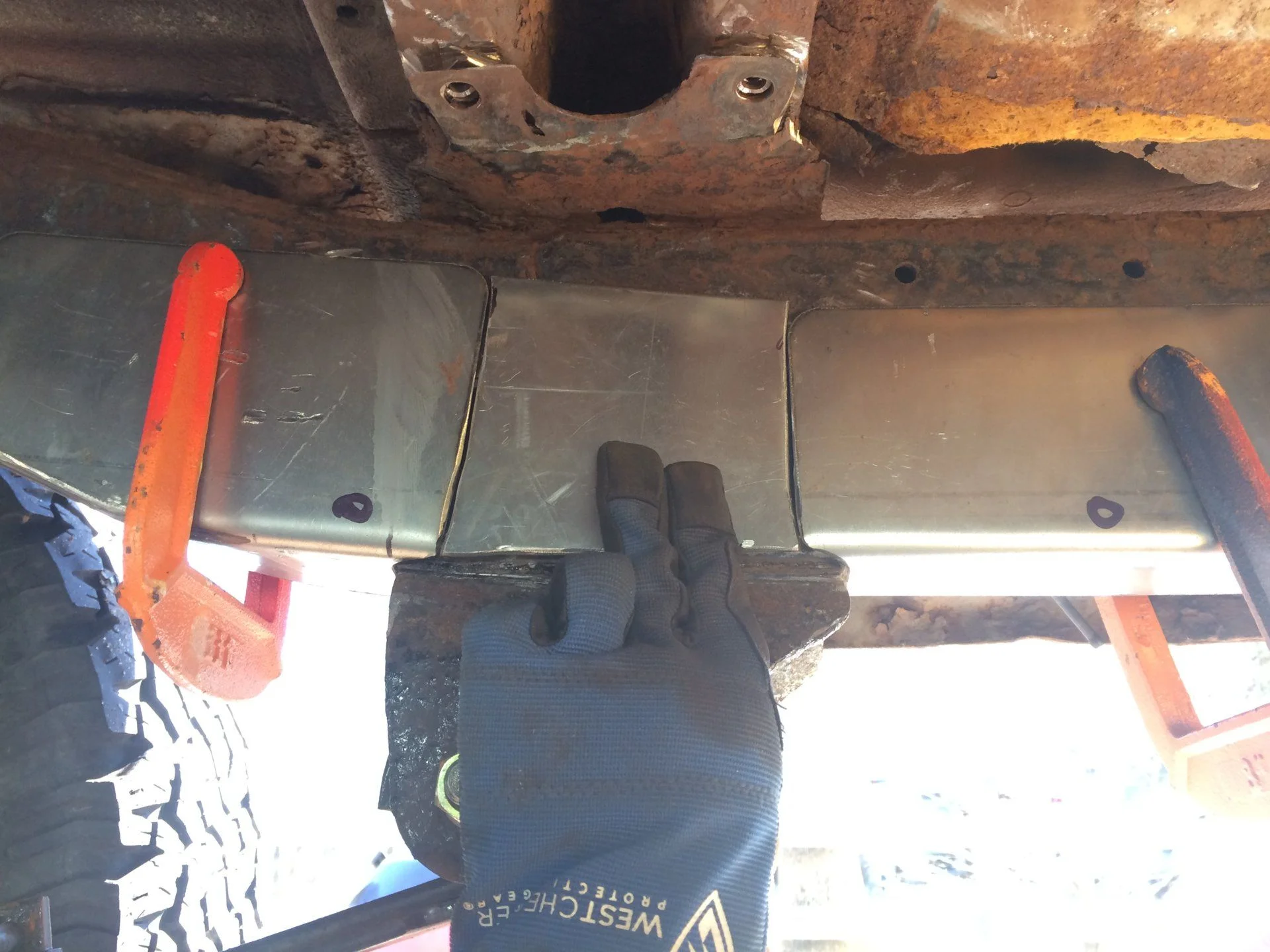

Patch is made, gotta clean up the rail some more before I attach it. Gonna still drain holes in the patch. Welds aren’t amazing but the patch fits up nice and tight. Stopping for the night. Worked hard all day in almost 60 degree weather. Now I’m just sore, cold, gritty and hungry!

Good work. Keep at it one bit at a time. That’s some nice thick patch material.
Funny that you ground the welds. Inside of the frame rail where only you will see it...
The bracket almost sits exactly where the welds are. I was going to overlap the middle section but decided to try my hand cutting and making it fit. So I ground the welds so the bracket will sit flush.

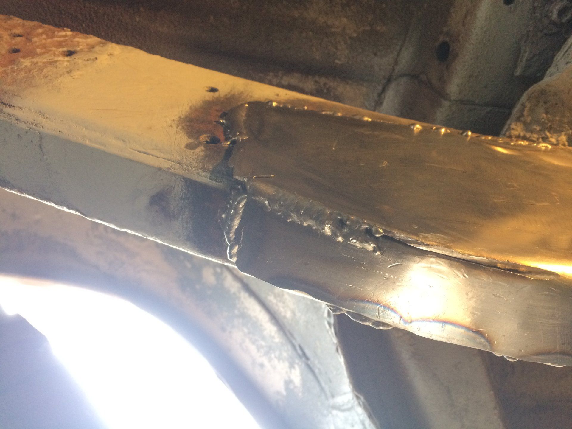

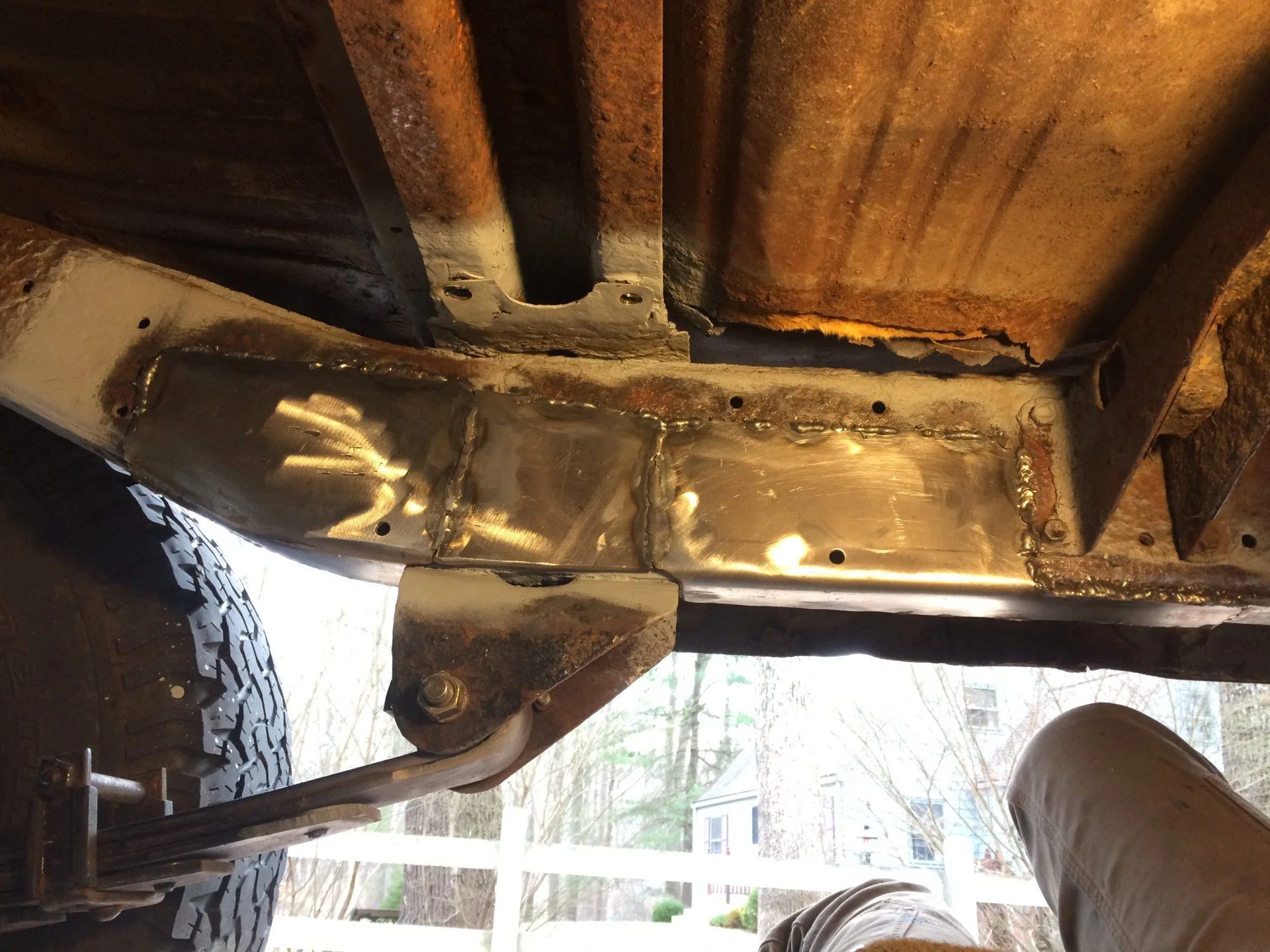

Learning as I go. Turned up the voltage w/ the wire speed at 3 and beads were better. Overhead, horizontal and vertical are an extra challenge for someone who really has never welded or had any real training!
Here’s my ugly. They’ll be prettier after I grind them down!
