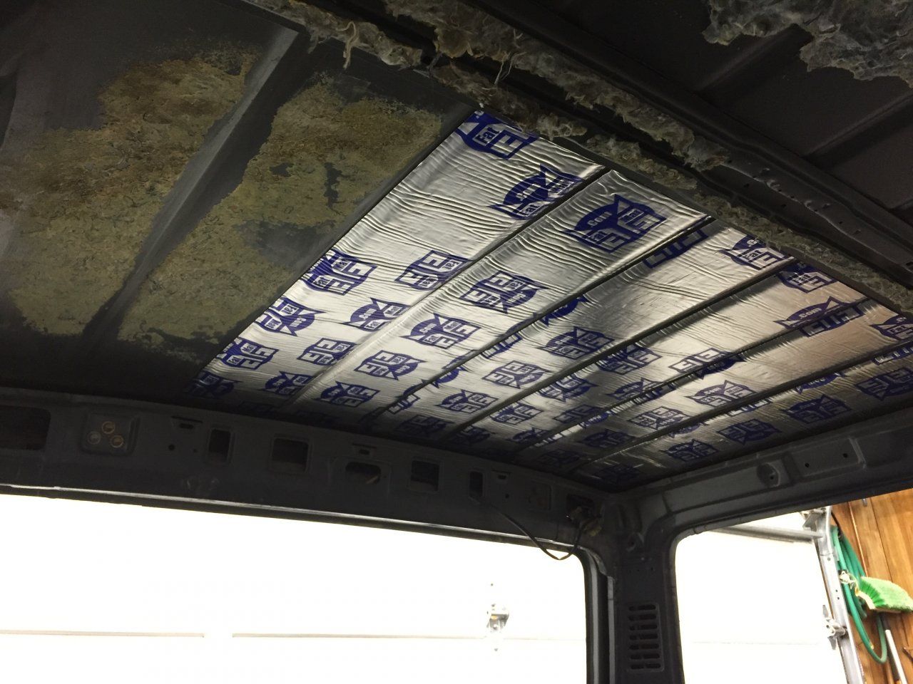

Ok, able to post pictures now. Here is the quick progress shot. The old jute is a major PITA. What you see left of the finished panels is close to what I am gluing the FatMat onto, there is just no way to scrap this off. At first I was concerned, but the old glue is actually providing a porous surface that the black tar on the FatMat sticks to like nothing I've seen. Half is also just stuck to metal. We shall see how this all works out, but I'm looking forward to having this part finished.
