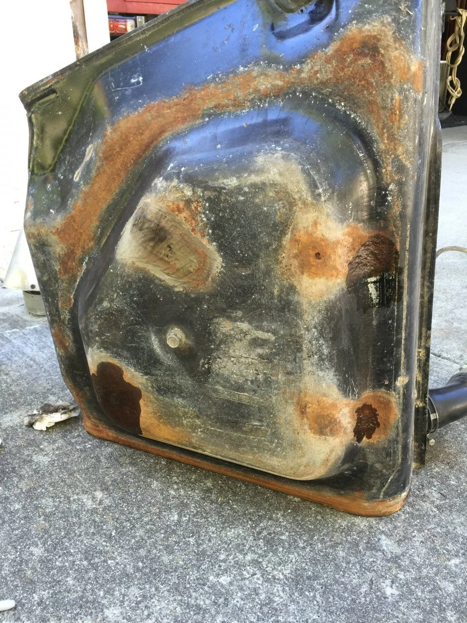

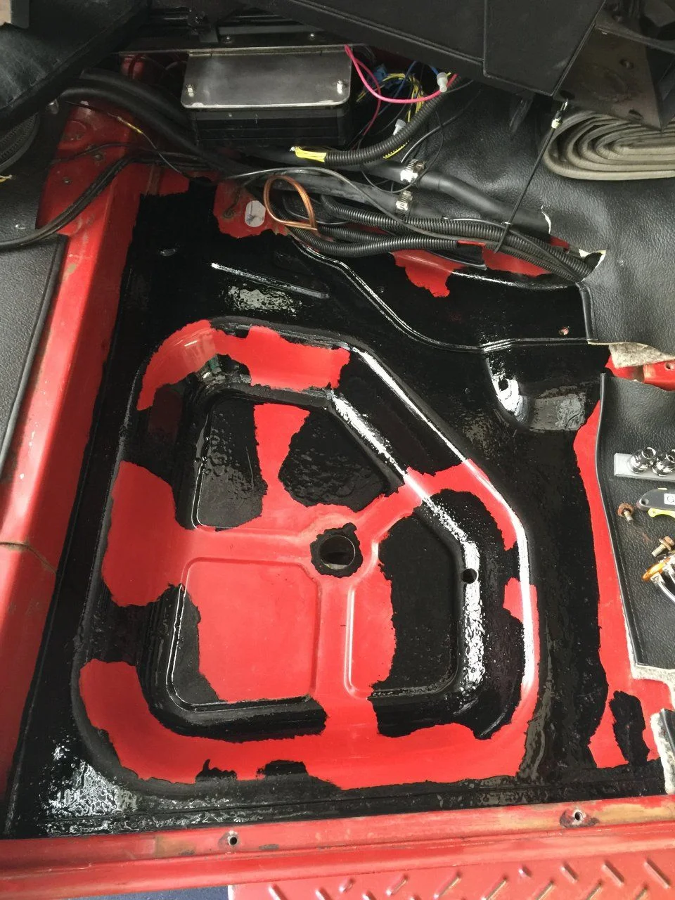

Decided to open another can of worms... Have swapped out the fuel lines under the hood so figured I better do the same for the lines to the tank. Well thought it would be good to investigate under the tank while I was at it and glad I did. Huge mess under there and classic rust. Tank looks pretty good I will rust treat it however and treat the tub too. Any thoughts on simply using a rust converter on the rusty spots or maybe POR15 the entire tub where the gas tank sits?
I actually have a new one on the way which was going to go in the 75 as I hoard parts here and there. But now I will use to replace. I won't toss this one though and may try to repair.
Has anyone tried this: POR-15® Fuel Tank Repair Kit

Oh and it looks like the tank already had one repair so adding three more seems like I may just be asking for trouble in the future.

After thinking more about this I should've used the stuff I just found that I forgot I have - Mastercoat. Since POR15 doesn't adhere well to painted surfaces but Mastercoat does after roughening it up some, that would've been better in this application. Leave it to me to do things at least twice.
So tomorrow I'll sand it down - the POR15 will stick nicely to the rusted spots but should sand pretty easily(?) where it covers paint. Then I'll hit up the entire thing with that Mastercoat.
Yep, it's the price we pay for learning things 'the hard way.'. Have to do it twice :bang:
Well that little POR15 experiment was fun... :bang:
Probably added 2 hours to the job but glad I went back and took it all off. More rust hiding under there than I thought. Now I will treat the raw metal with metal prep and the hit it all up with that Mastercoat stuff!

Okay this looks only slightly better than the tiger stripe lol. Dang that MasterCoat is some strong stuff. Respirator worthy!
