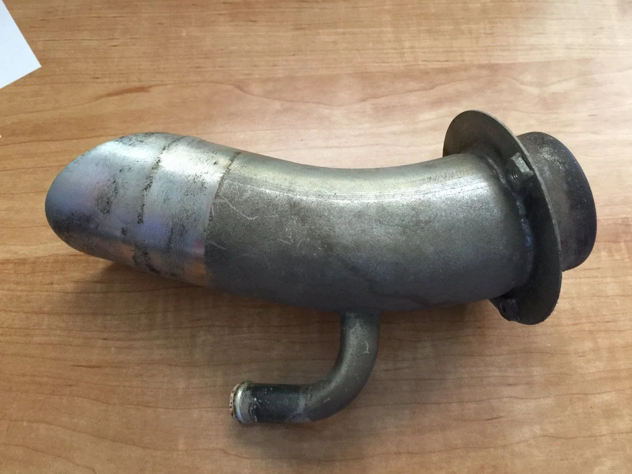

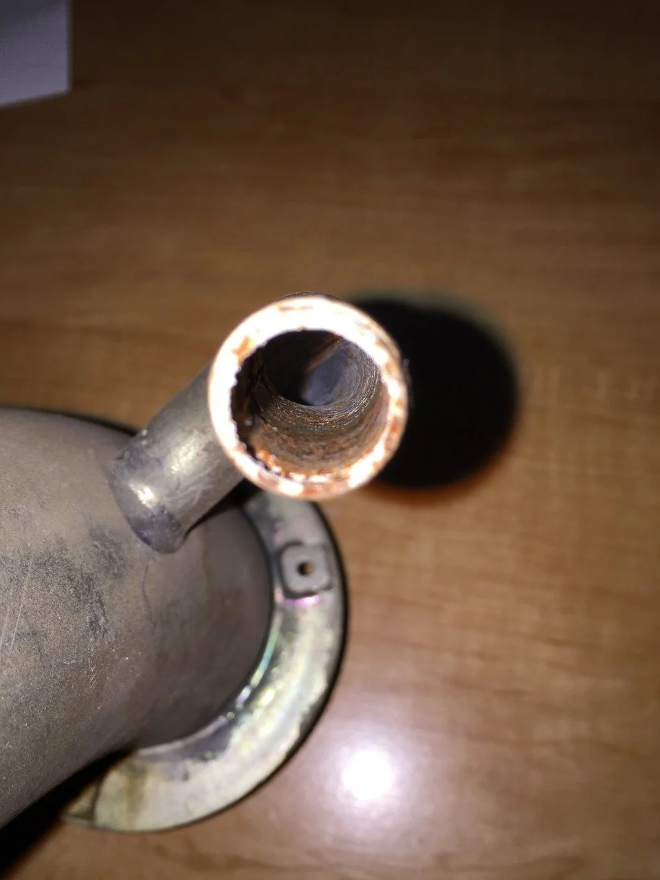

Here is the filler neck - it has some minor rust on it. Should I worry about that? I can blast it clean but then it will have no protective coating (what's left of the zinc coating). I can paint the outside no problem but what about the inside?

Wow $50 to zinc plate this item. I think I'll pass... Spray paint on the outside and "maybe" I try to soda blast the rust off the inside.

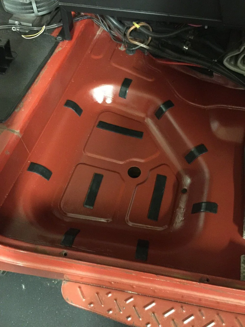

Got the new tank installed! Note that I did not route the wire for the fuel sending unit as pictured - it was installed on the cover. Of course I left one bolt off the tranny cover and it is buried deep. I'm hoping that it will be easy to see and install once I lift up my Tuffy case.
I forgot to take a picture of the gas filler neck post soda blast - looked really good just hit it up lightly to remove the rust and film that had built up on it. Decided to install without any other coatings. I think it will be just fine.

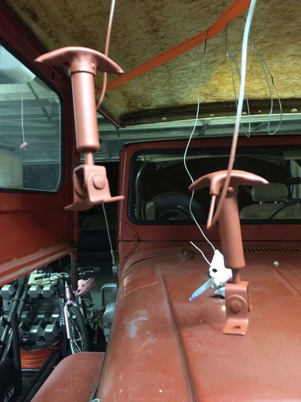

Got the wiper assembly all rebuilt! Turned out great and no leftover parts!!! And installed the mirror arm. Going to plastic paint the mirror head and install soon. Only issue is I only have one speed on the wipers. See video below. I think that is low speed correct? I seem to remember I only had one speed prior to the rebuild but am not 100% certain since I rarely drove it in the rain. Will clean up the contacts and try to check the switch. Are there any tests I can do before tearing into the dash?
