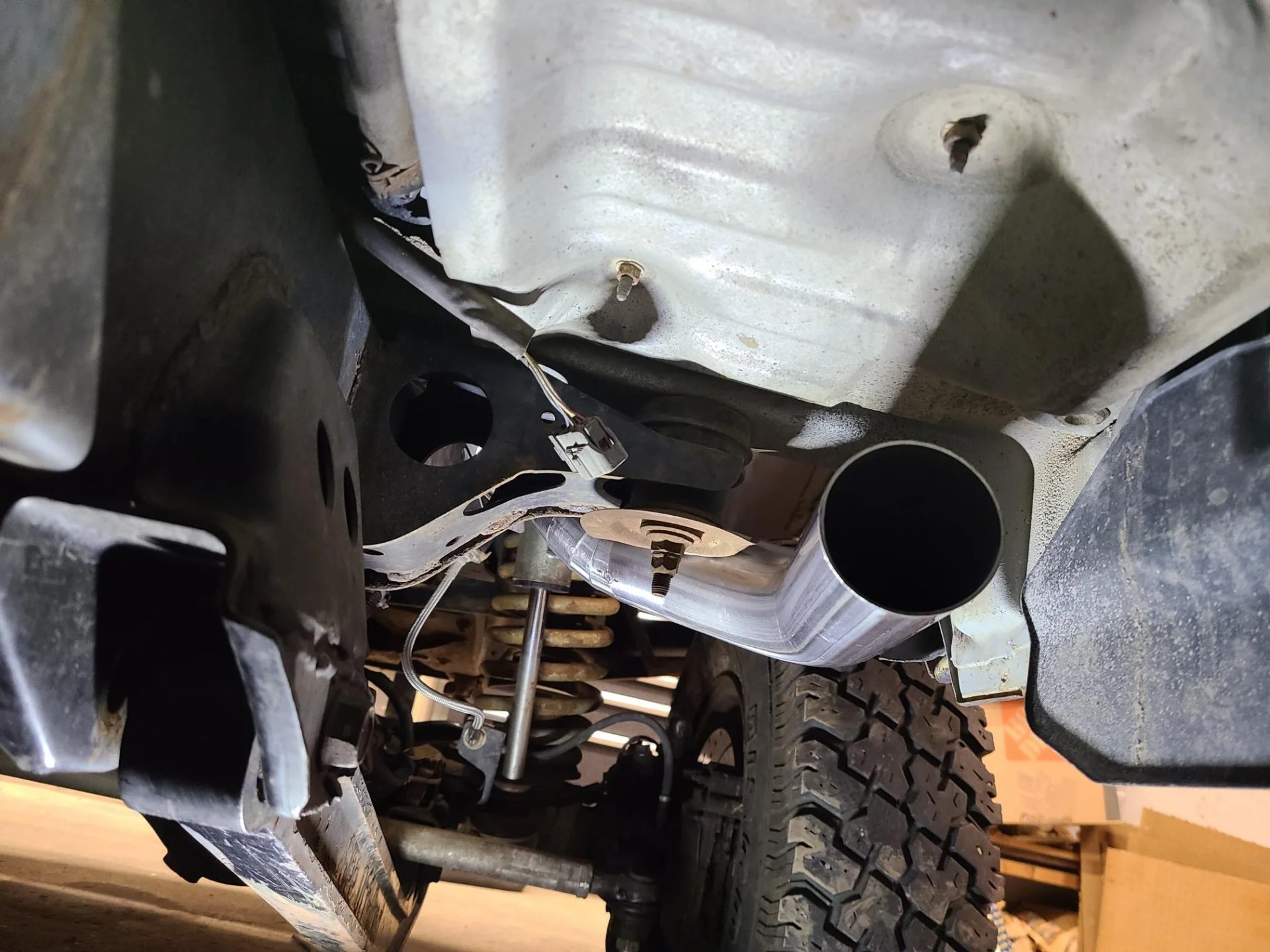

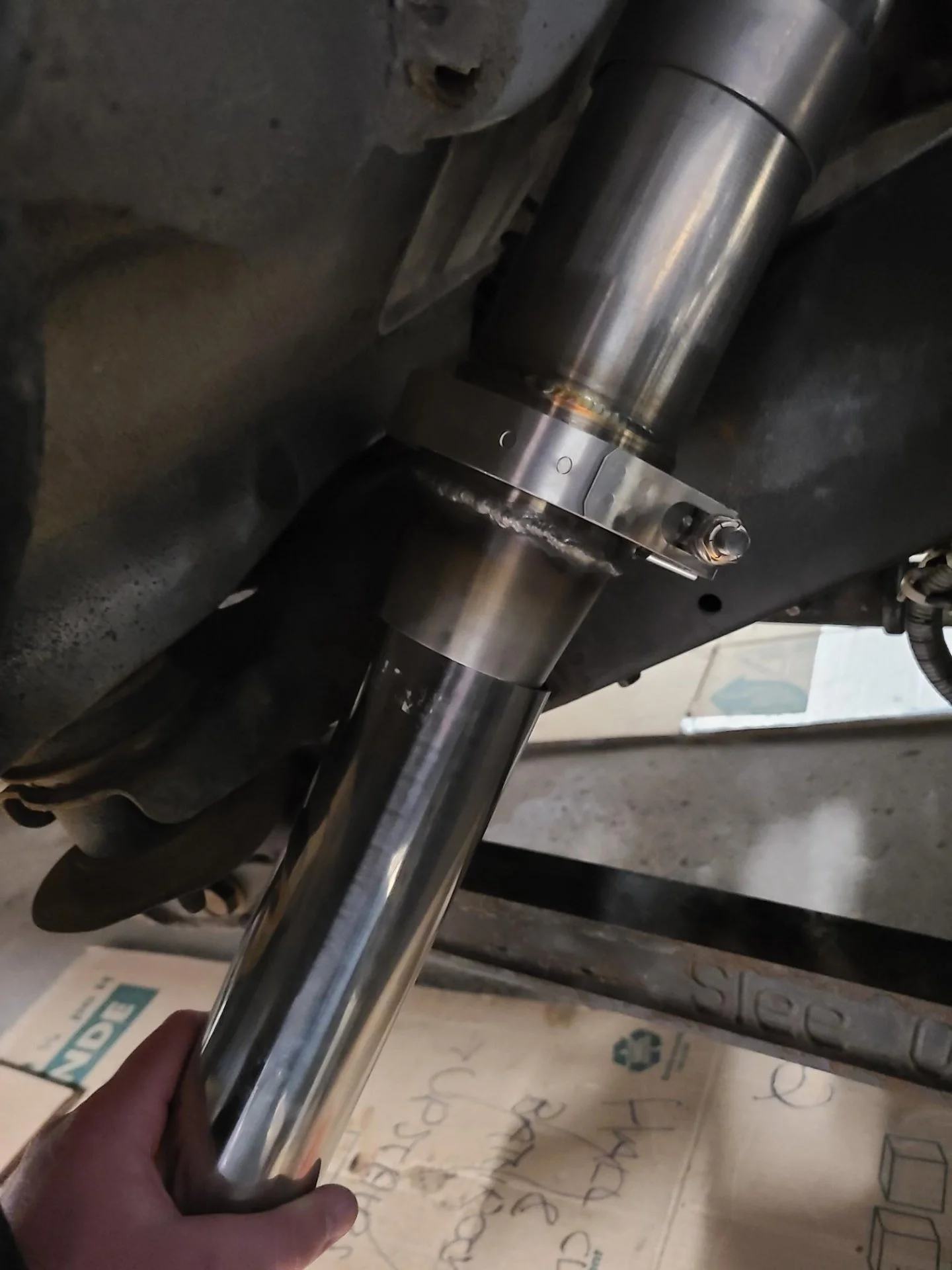

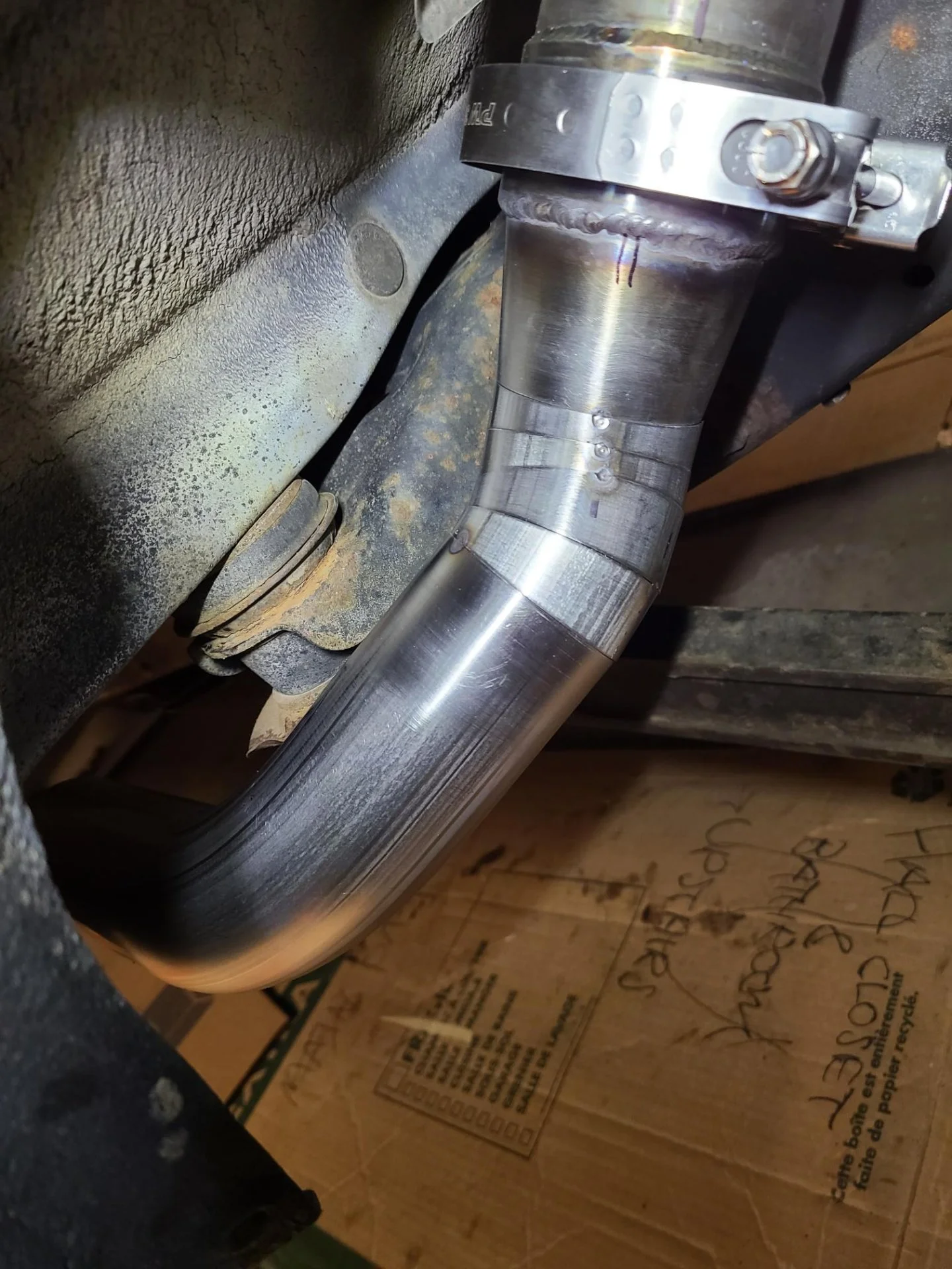

I dont have a factory exhaust to align with so I am curious if my downpipe is in the right spot or similar to the rest of you? As you can see in the pictures the new pipe is going to be very close to the body mount and I will have to bend the tab out of the way. Everything bolted up nicely between the turbo and wastegate. I still have to pull everything off again to install the blanket and oil lines so its is not a big deal to readjust. Building the exhaust now so want the placement to be correct from the get go. I feel like the old exhaust went around the body mount but this wants to go under. Appreciate your thoughts.
That looks about accurate. As long as you're seeing an even flange<->turbo connection and the downpipe has the bellhousing support bracket on, I would feel good about it. There are likely minor deviations in our kits and/or vehicles.
If I remember correctly, @spyduh swapped that washer on the body mount for a smaller one to give more space.
good to know. I picked up some pie cuts and an assortment of 45 and 60 degree elbows so I might try to swing it more around and keep it tucked up higher. everything is bolted up nicely but the support bracket is pretty close to the downpipe so didnt need to make much room on the slider plate.
I had to trim the large body mount washer for my 2.5" exhaust pipe so your experience is normal.
Yup I replaced my oem body mount washer with a random one from another Toyota. I just grabbed one on the floor at my buddies shop. I'm guessing it's from an early 85-95 mini truck. Don't what it actually came off. Could also be from 96+ taco or 4r. Any washer would work as long as it covers the rubber.
