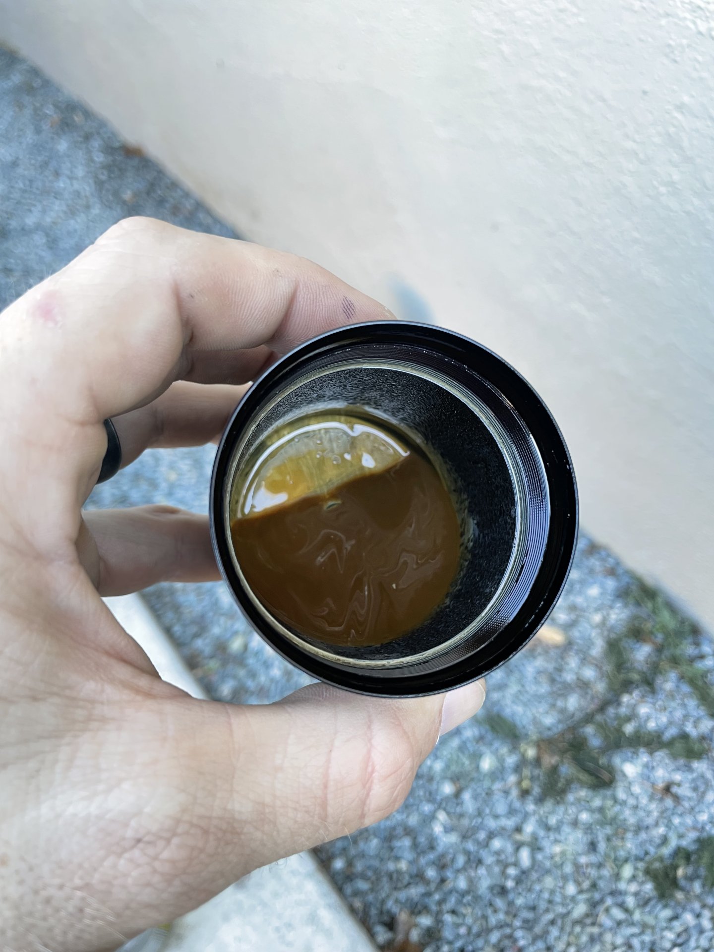

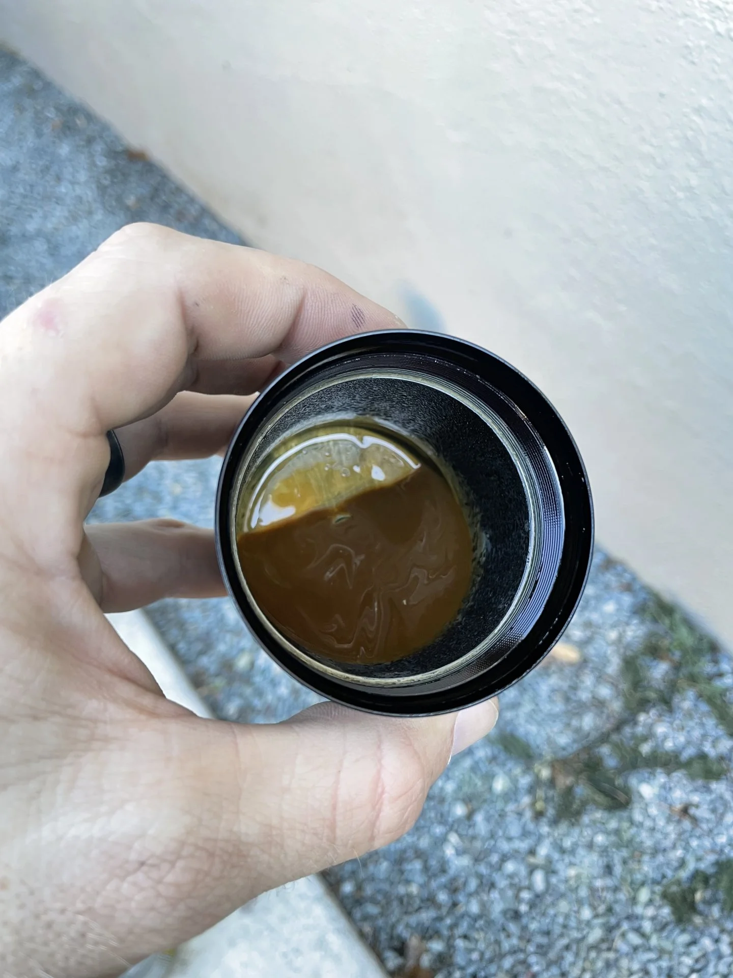

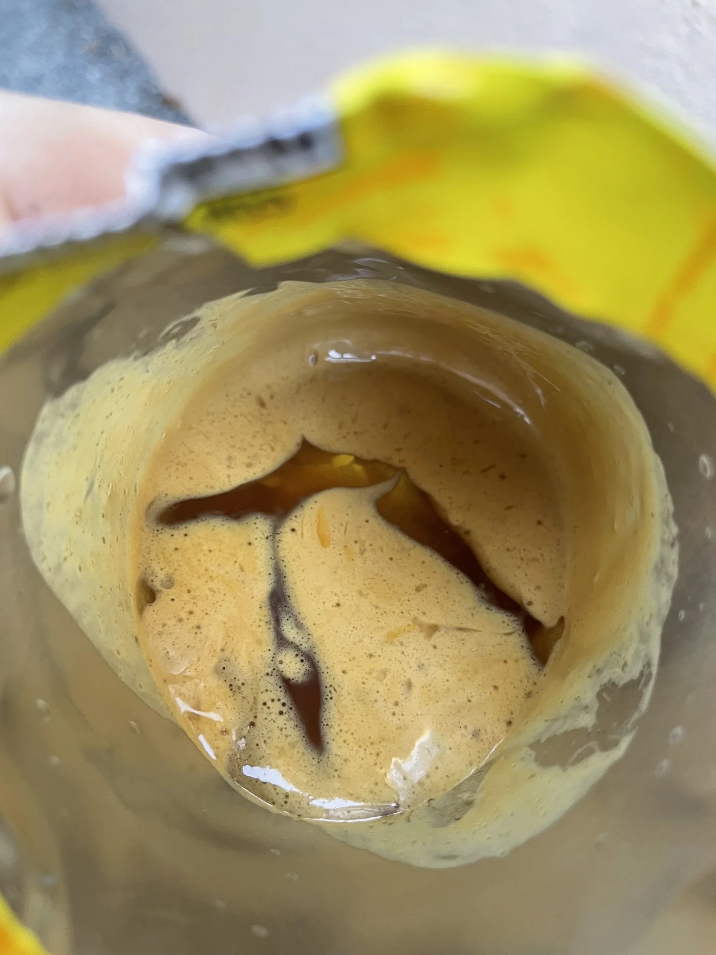

Finally got around to checking how much junk my oil catch can system is capturing after ~1200 miles on 184K motor, all original
Valve Cover and Air Intake Catch Can // ~4 oz of oily, foamy slurry
Valve Cover - Intake Manifold Catch can (PCV-side) // ~1.5 oz of darker fluid crap
