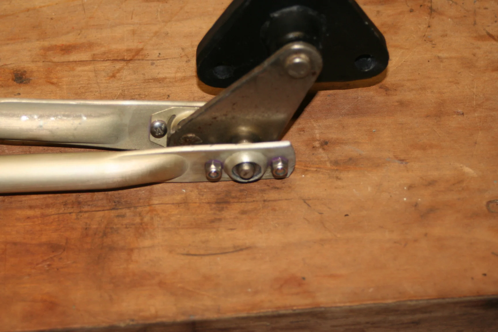

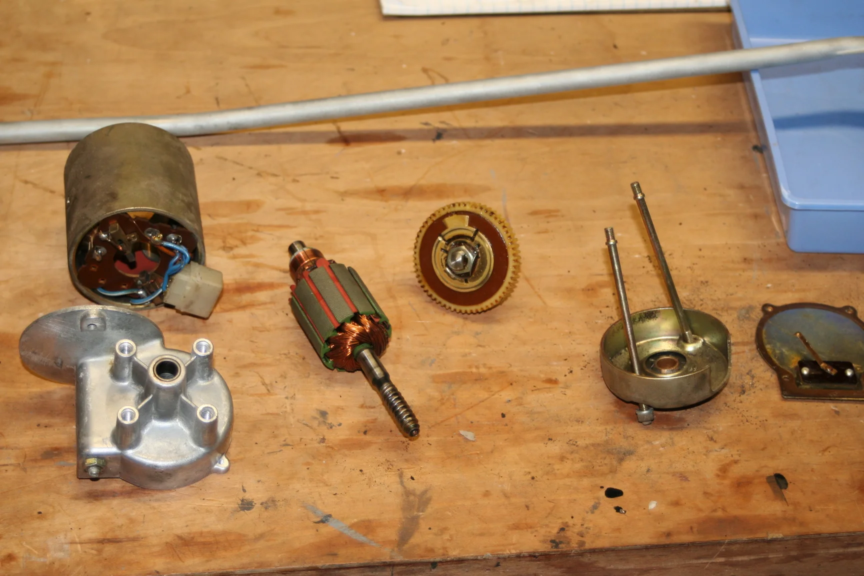

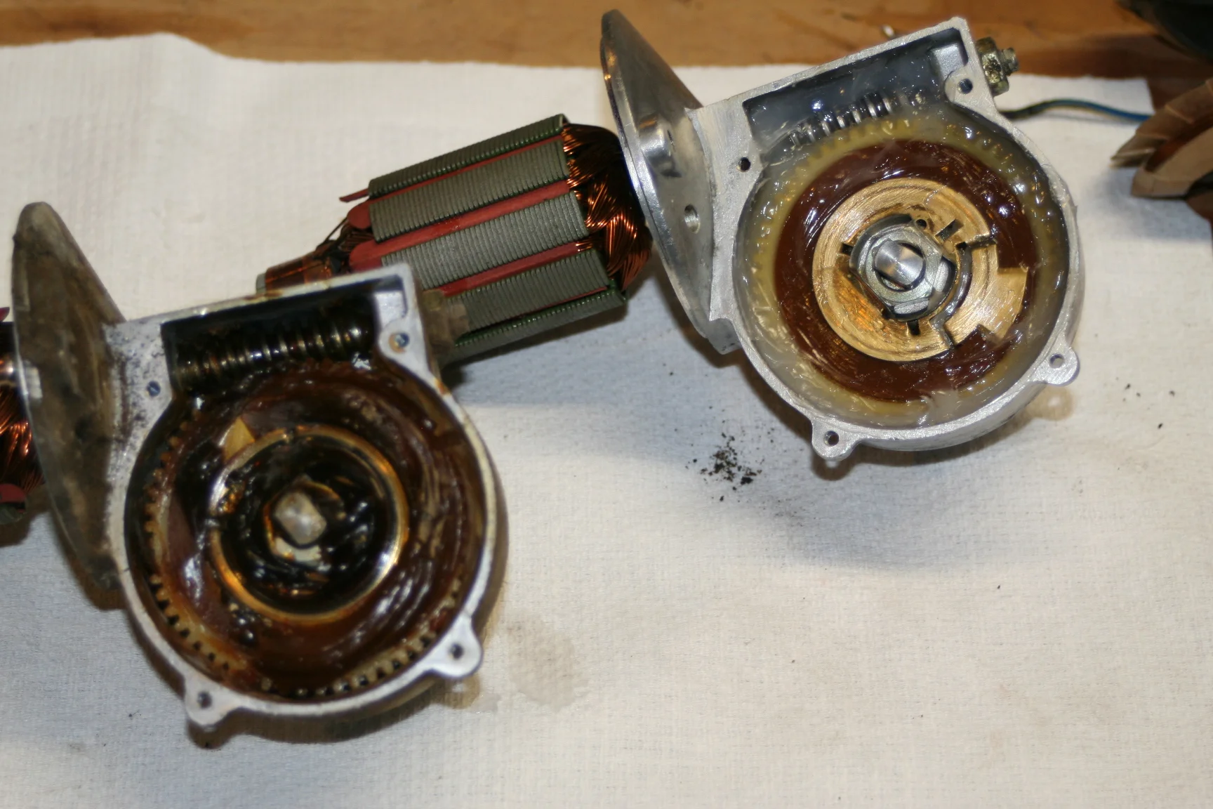

Yeah, there is plenty you can do for the wipers, but it is involved a bit. All the arms have small bushings that get corroded. Take them apart and clean/lube them. The motor is similar to the tailgate motor, the grease gets old and caked, so clean and relube. By the way it also has a plastic gear. maybe your switch is corroded or shot, I'd replace with a new one.

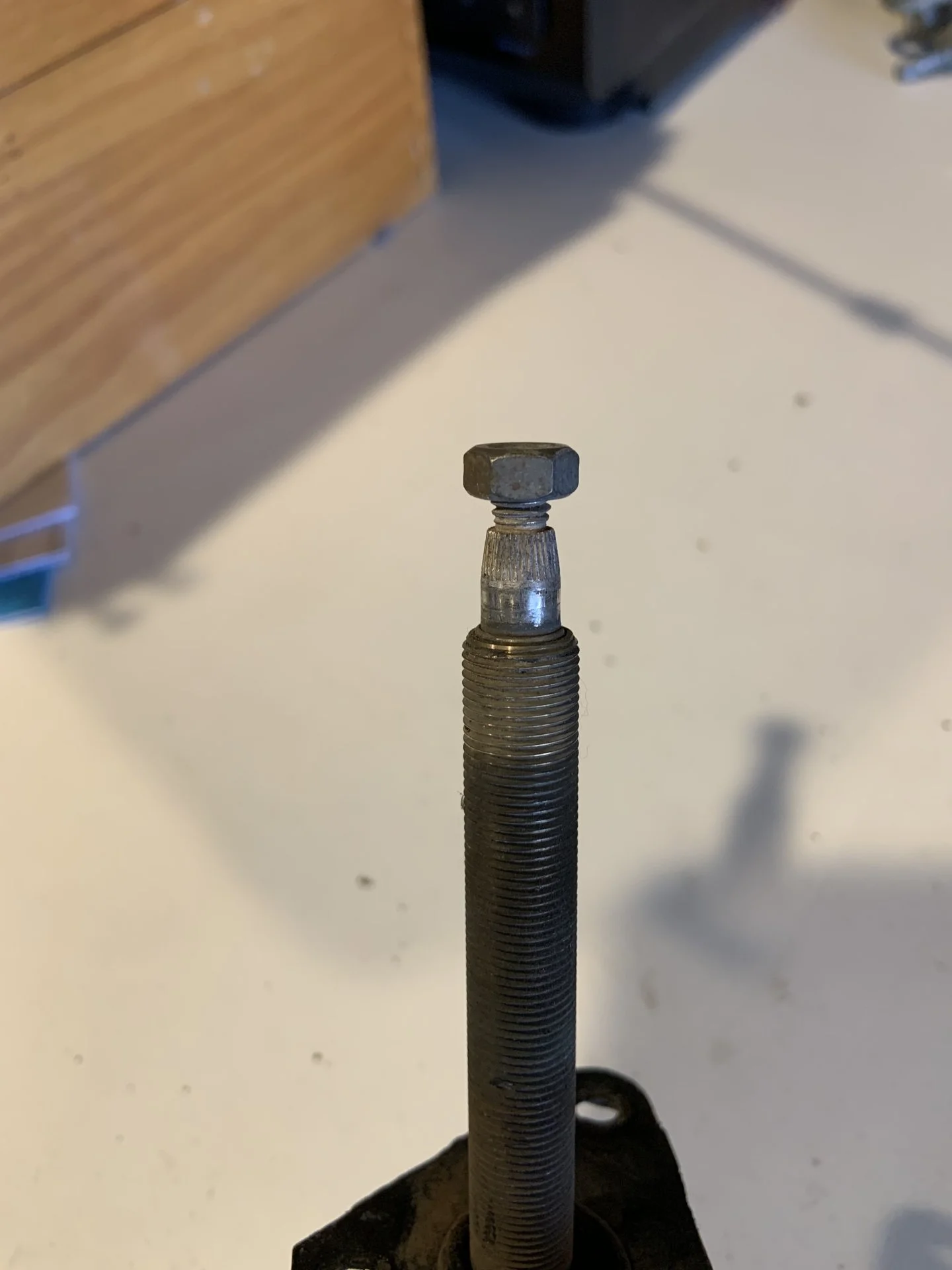

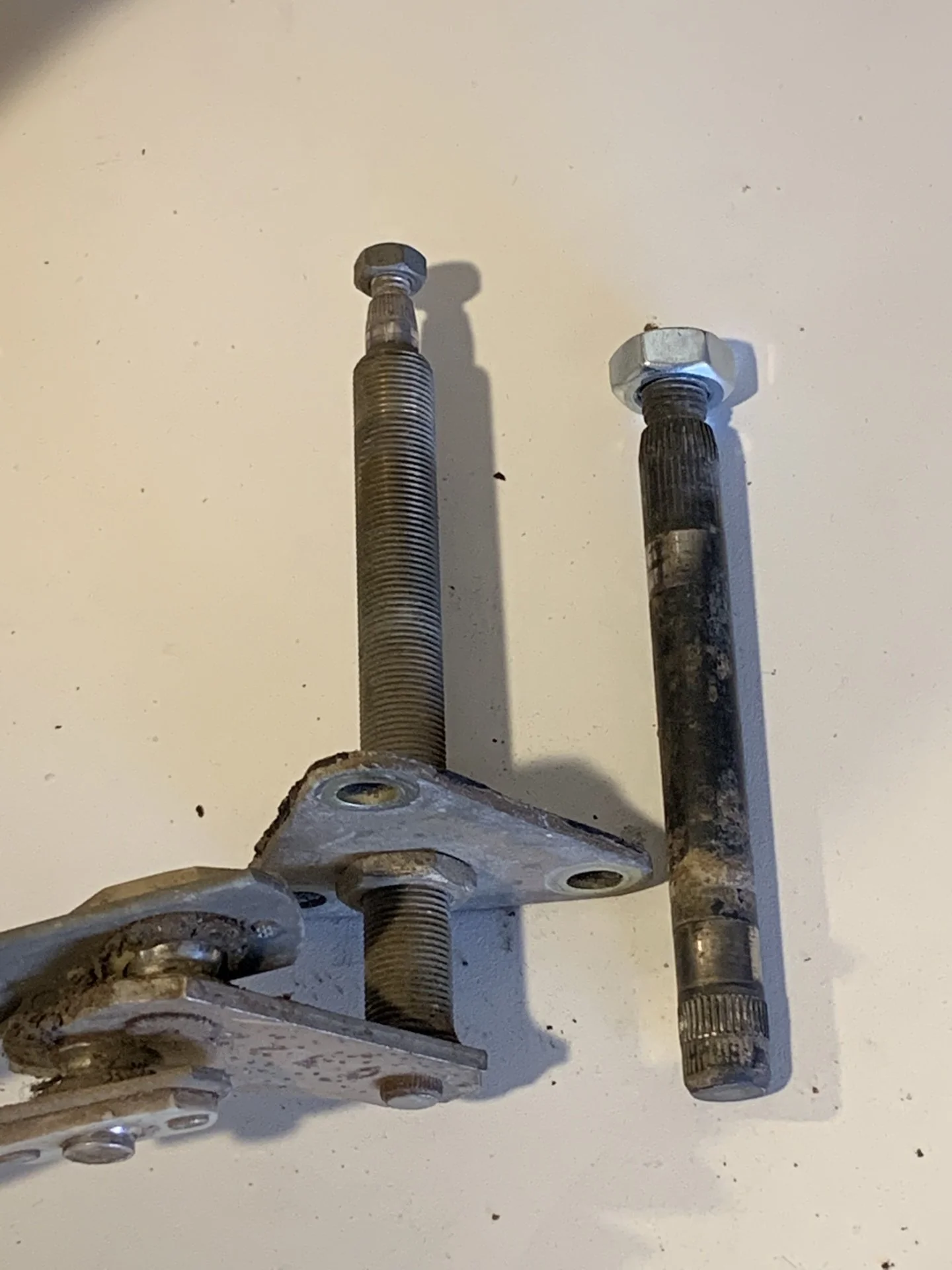

I’ve been trying to find some pieces that work together to run a larger wiper-arm drive shafts. The OEM 55 pieces are super small in diameter but long, and the splines on the end are getting smooth after all these years. Later model GM pickup wiper arm driveshafts are almost as long as the 55’s (about a 1/2” shorter), but probably double the diameter. It would just be a matter of finding an outer hub/shaft threaded for adjustment and then being able to have the corresponding splined (or maybe softer metal but smooth) female insert on the wiper arm side that would work with the stock arm (or one of similar length).
I think the 3-bolt plate could be drilled out easily enough to accept a larger outer shaft.
I see where you’re going. Cut the end of the larger GM shaft, drill or turn out a bit on the cut side, fit it over the LC shaft and weld it.(?) That could work, not sure if it would become a weak spot with the possibility of it breaking there (or just below). I also don’t know if you’d be able to remove the inner shaft from the outer if you ever needed to since the bottom is splined (not sure if that end would fit through the outer shaft?).

What grease did you go with Ron?
