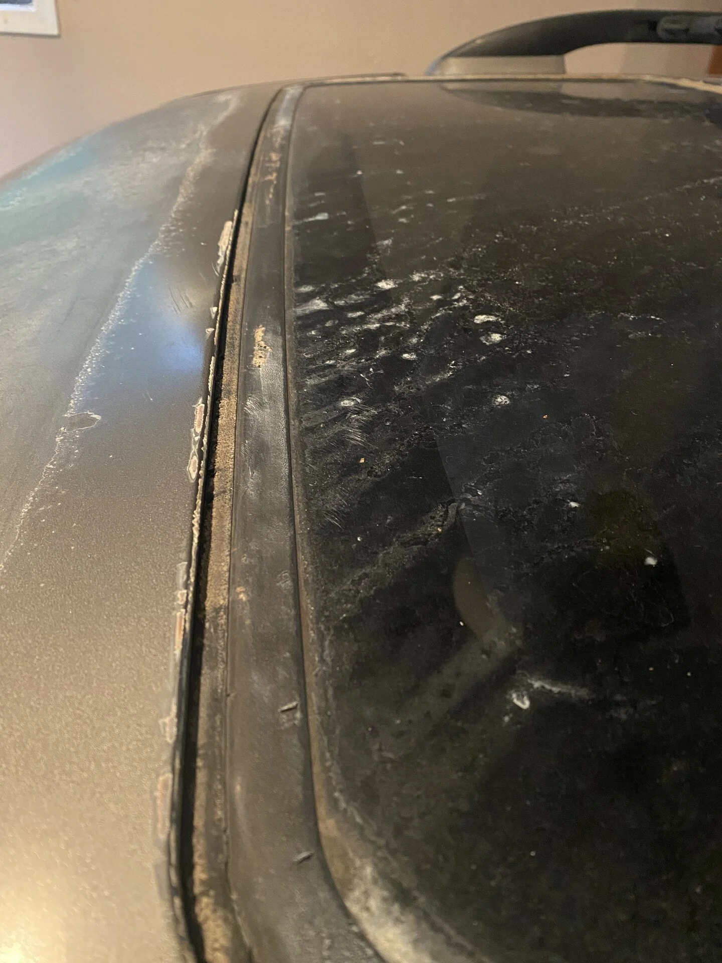

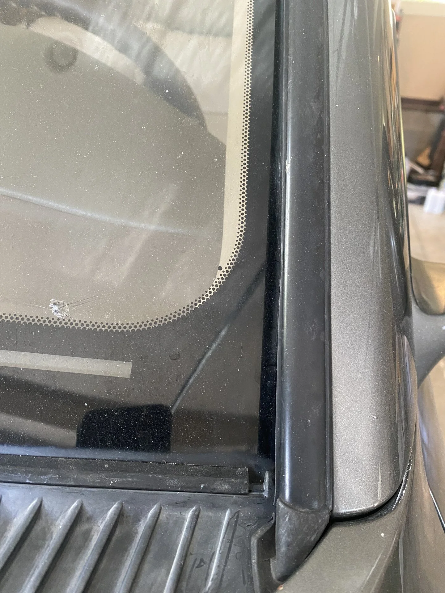

I finally purchased my first Land Cruiser. Got a 2000 LC that has all the service records, very mechanically sound, and base-lined (all though I am still going to change out fluids). In my hyper diligence in making sure to check for rust and making sure mechanically this was the one for me, I neglected to look at some cosmetic issues, water ingress issues.
I had always heard these were pretty quiet inside and was kinda surprised on my 2.5hr drive home that it was not as quiet as I expected. Chalked it up to coming from a much newer "luxury" vehicle. I turned radio off and it was a very distinct sound coming from windshield. Also noticed a musty smell when I got in it after work, but not any dampness (lots of rain the week before, but hot and dry when I bought.. felt no dampness in vehicle). Upon investigation I noticed that its completely missing the rubber that covers the rivets going down the molding of the driver side. Both moldings are sticking up a bit on the roof area (which I know is just glued in there). I also noticed that it was missing three of the rivets, with only the top one holding it in. This has got to be where moisture and wind noise is coming in. BUT when I was looking at the holes before I got new rivets I realized they don't go all the way through. There is something behind them. So my question is whats the best way to get top rivet out (drill?) and then does that piece pop off or is it most likely going to damage the part? Its not moving at all even with just one rivet in. I do have a chip in the windshield and that may need to be replaced so this stuff has to come off anyway I guess. Really hard to see in the pictures, but can see how its sticking up a bit.

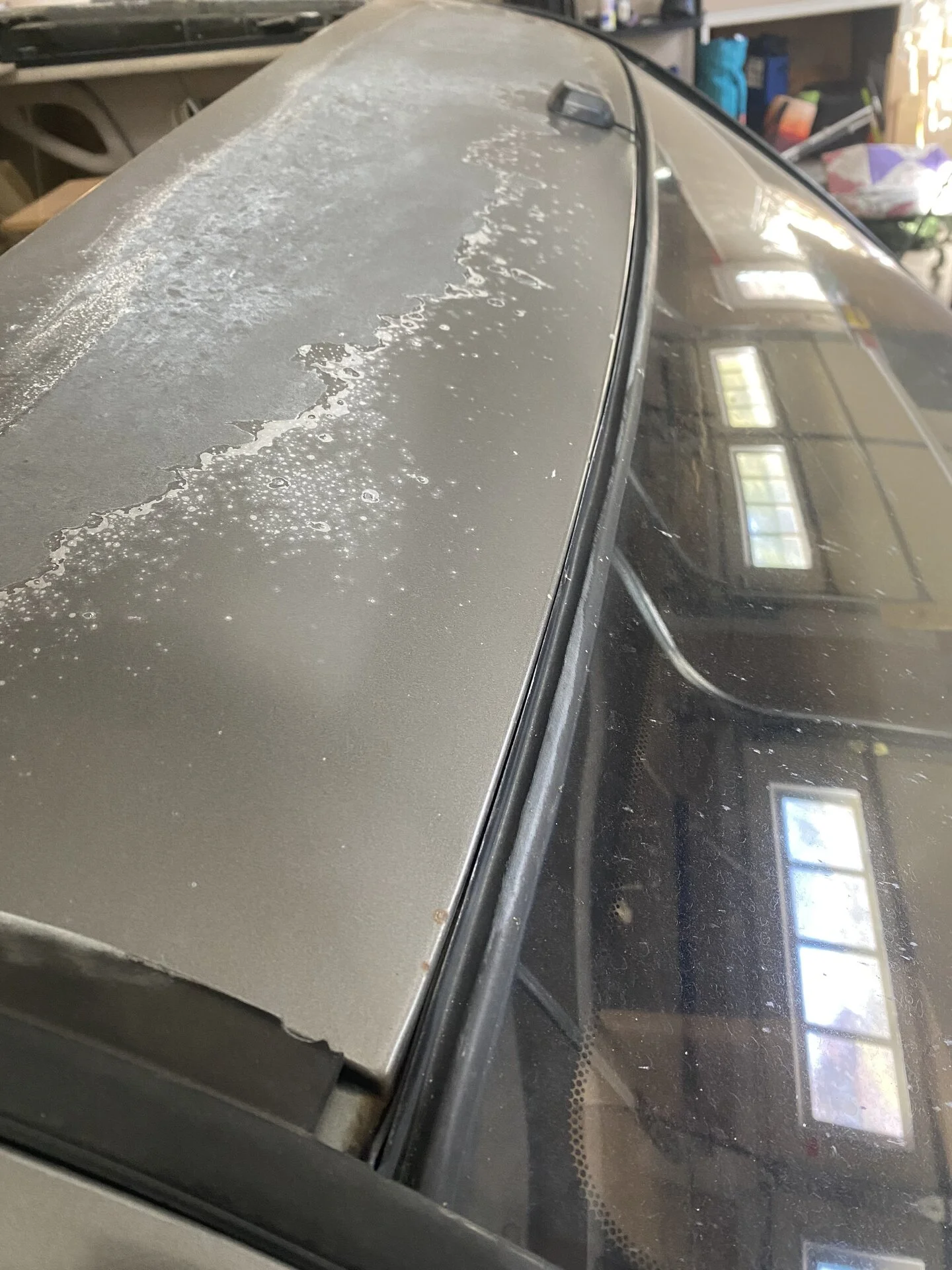

Sunroof - I know this is a point of contention. I knew it didn't work and thought I would worry about it later. It wasn't leaking so I could live with it being closed for time being (I do like a sunroof, but not a top priority thing) The top of this cruiser has the clear coat failing and it looked like someone tried to wax it leaving wax residue all over the top and looked like all over the sunroof when I looked at it. Like I said I was more focused on other areas and was told not leaking so didn't think much about that area on top. Well when I got home I noticed the sunroof sits lower than it should and there is evidence someone tried to close it up or something at some point. Also noticed that its missing all the plastic trim inside that covers the mechanisms and someone had put pink rigid insulation on the passenger side (what I now believe to be an attempt to keep sunroof up. Motor is dead best I can tell so far before I get into it. My main question is how do I now get the sunroof to seat back up to its factory closed setting?

I'm out the door so short reply here, but the trim is glued in place. It's possible to remove it without bending it, but it's more often bent up upon removal.
Yes, you would have to drill out the rivets. Be sure to use the same plastic coated rivets when reassembling.
Yeah I have the plastic Toyota ones in my cart on Toyota Parts Deal.. hopefully the glue has given up enough that I wont bend them. Though I may just order new ones as the plan is to restore. Just don't want to spend the money on that right now haha. Maybe they will clean up well. Need to get them out to figure out why the holes aren't going all the way through first.
The first thing I would do is spray super sudsy soap or shaving cream around the outside perimeter of the windshield and then use compressed air gun on the inside and check for air leaks around the windshield.
The only way to move the glass is to use the motor. There is a screwdriver slot on the underside of the drive that is supposedly there to turn the drive, but if the cables are crusty, and the motor won't move the glass, a screwdriver won't either.
Windshield as advised. On sunroof, motor is likely fine, cables are rusted in to guide tube and seized up, which requires headliner removal to repair properly. Check the screws holding glass to the track, there is some adjustment available there that may help close the gap some, it looks like there was tape or something on it before leaving the residue.
If the color of your cruiser is smoky topaz mica (same as mine and a great color BTW) there was a QC issue with that particular paint from the factory and all of them will fail if they haven't been repainted prior. Lexus did foot the bill for repaints early on and mine was thankfully resprayed as part of that. If yours hasn't and is smoky topaz, try to keep a really good sealant on there and out of the sun as much as possible.

I believe its the Galactic Grey. I know hood and bumpers were painted. Not sure why roof wasn't done. Only really up there, door handles, and mirrors are noticable and its only noticable from a distance on the roof. Bothers me though so going to have to get that fixed after sunroof is fixed.

The sunroof motors are usually fine, the pinch protection saves them when the cables get too stiff to move, they just lock out. Good news as they aren't cheap. But in all the sunroof threads including my own experience, I've yet to see or hear of a bad motor.
See this post from my big sunroof thread on the glass height adjustments available: How To: Stuck Sunroof Repair - https://forum.ih8mud.com/threads/how-to-stuck-sunroof-repair.1263070/post-14755415

I second @hoser’s suggestion for the sudsy water.

If you are repainting the roof, I'd consider removing the sunroof altogether. Try your local body to weld in a fill panel.

Still trying to asses this windshield. Looks to me the weather stripping is all out of wack. I know the weather stripping in the rain gutters that meats the windshield needs to be replaced both sides. The molding that goes up the windshield to roof I think are still good as long as I don't bend when I remove to fix the roof weather stripping. Of course it needs new double sided tape to sit down and flush with roof. The weather striping on my cowl has spots not covered.. is this how it is on others or is this incorrect on mine? Also the PO had a XM antennae on top.. shouldn't all of this weather stripping be sitting on body so not let water in?
