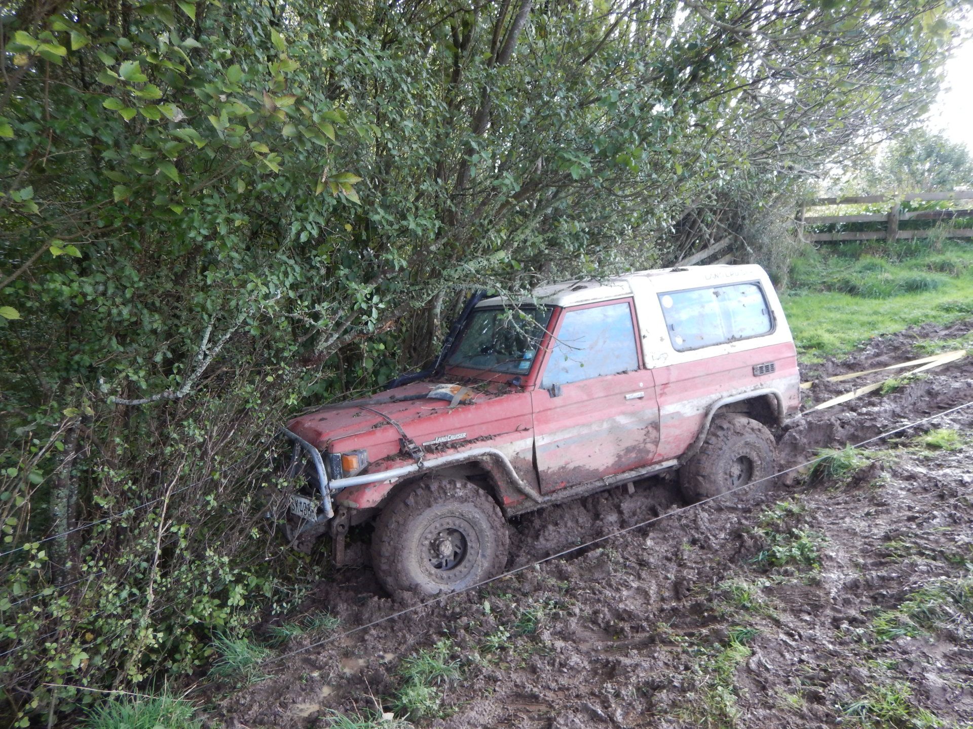

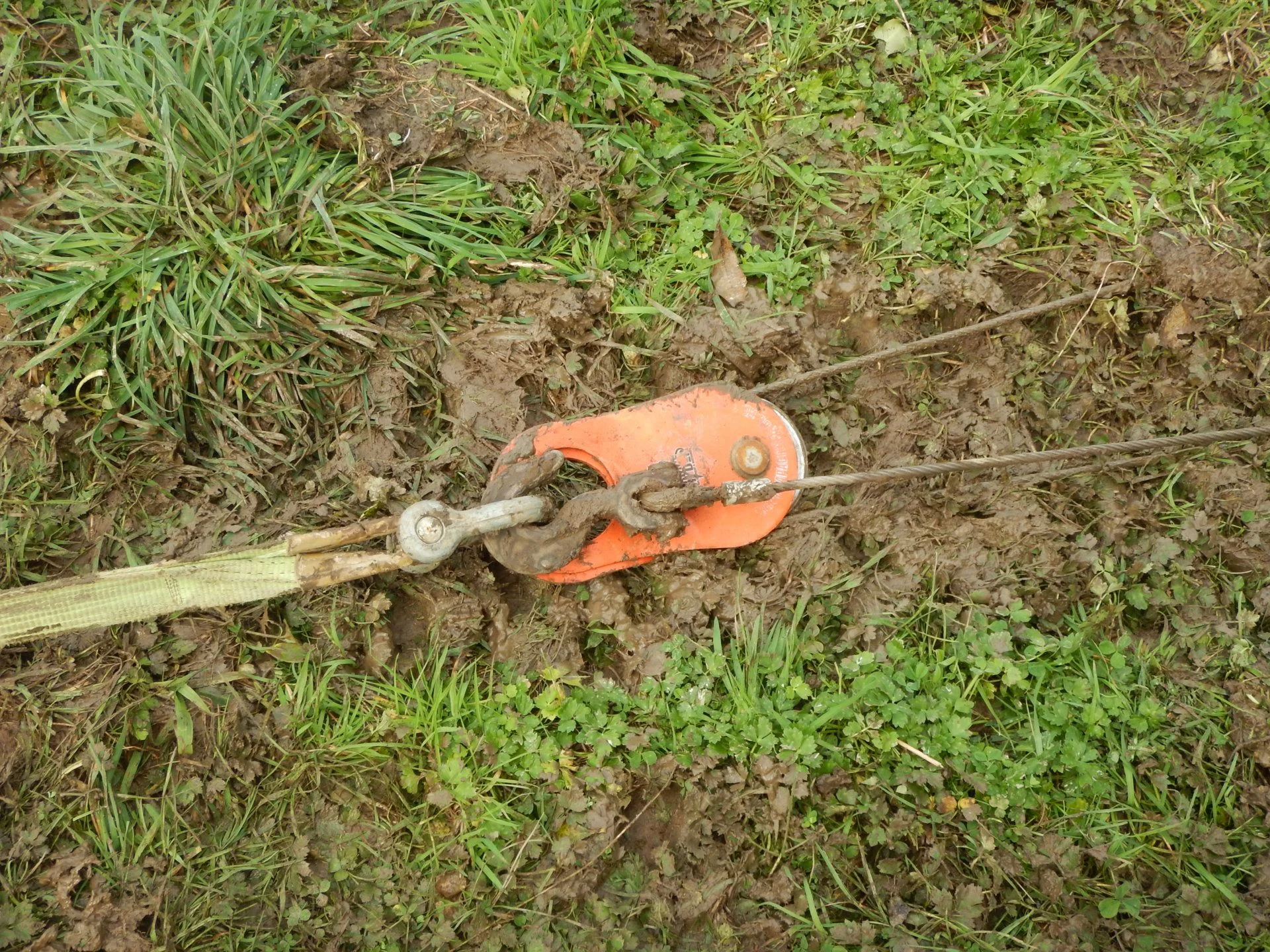

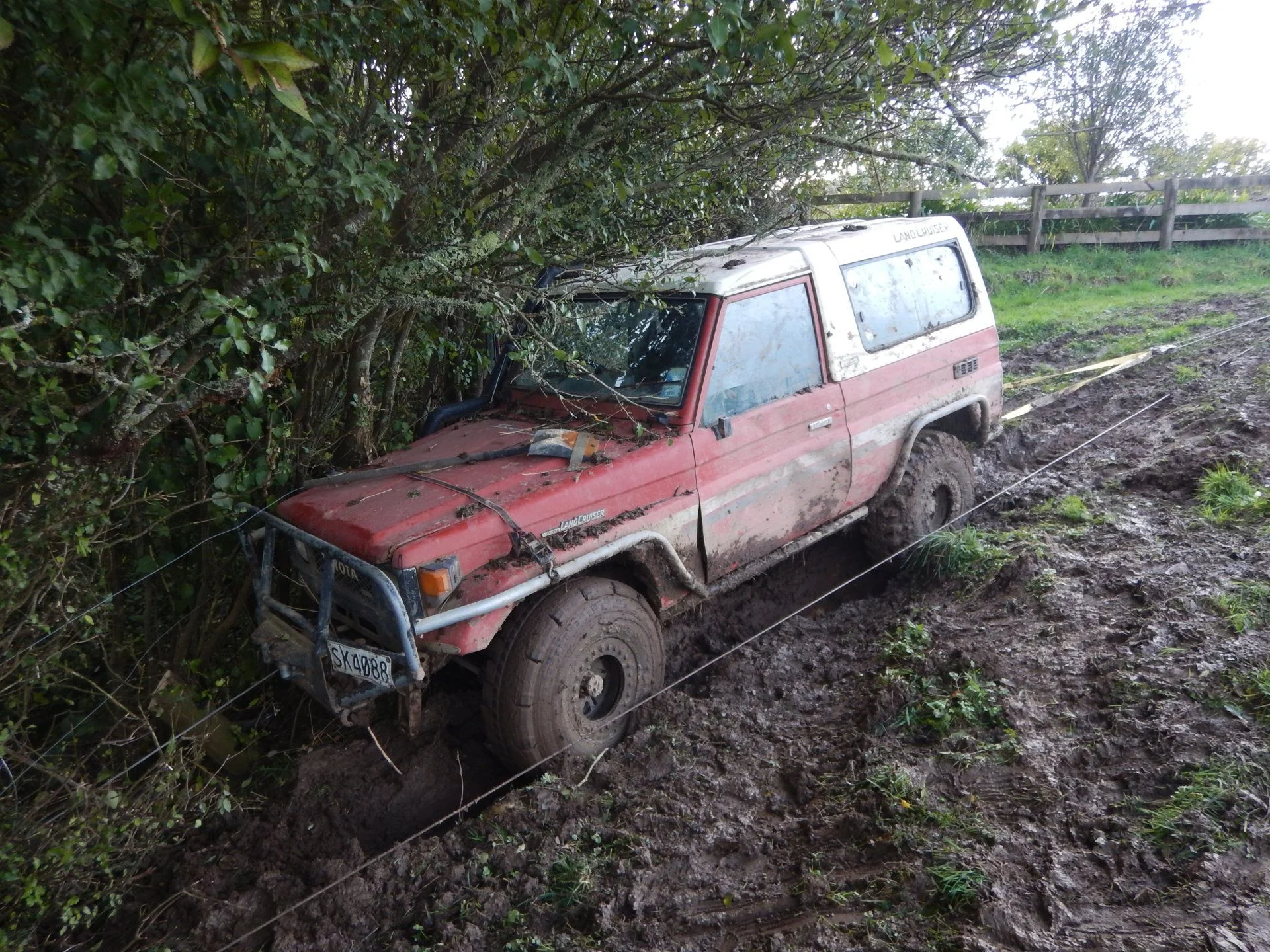

I was being an idiot again, and i got stuck with no one to pull me out backwards, so i tried winching backwards with pulleys. Too see if it actually works, or is it just a story people tell when their drunk.

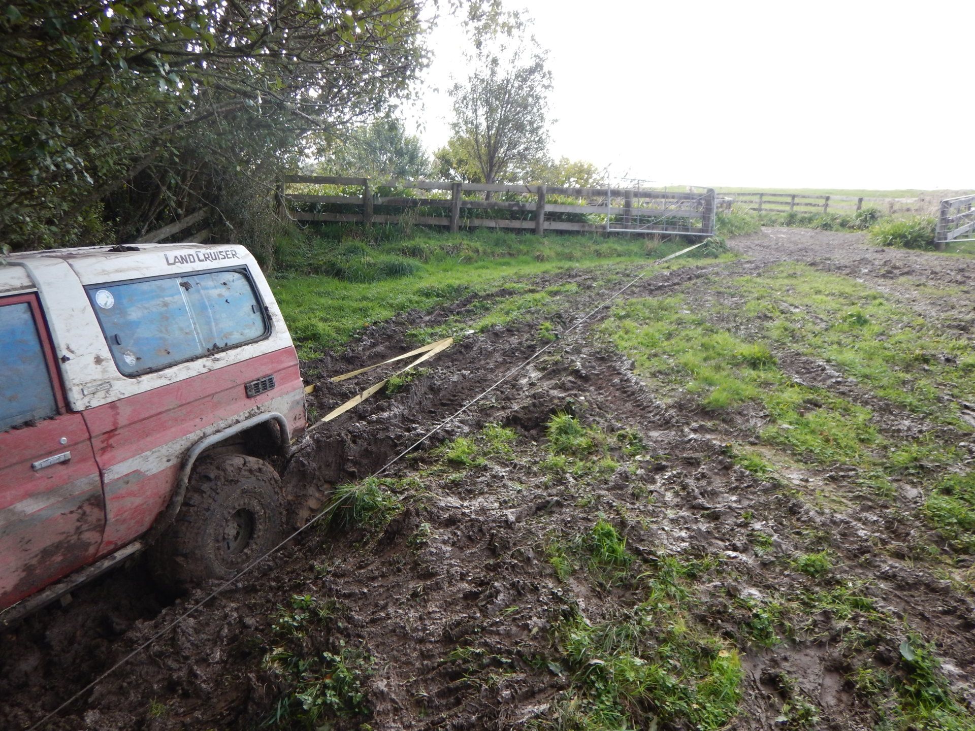

This is how i rigged up my winch rope;
I didn't want to break anything, so i took the weight with the PTO winch and then cained it in reverse, and moved back a few hundred mm's.

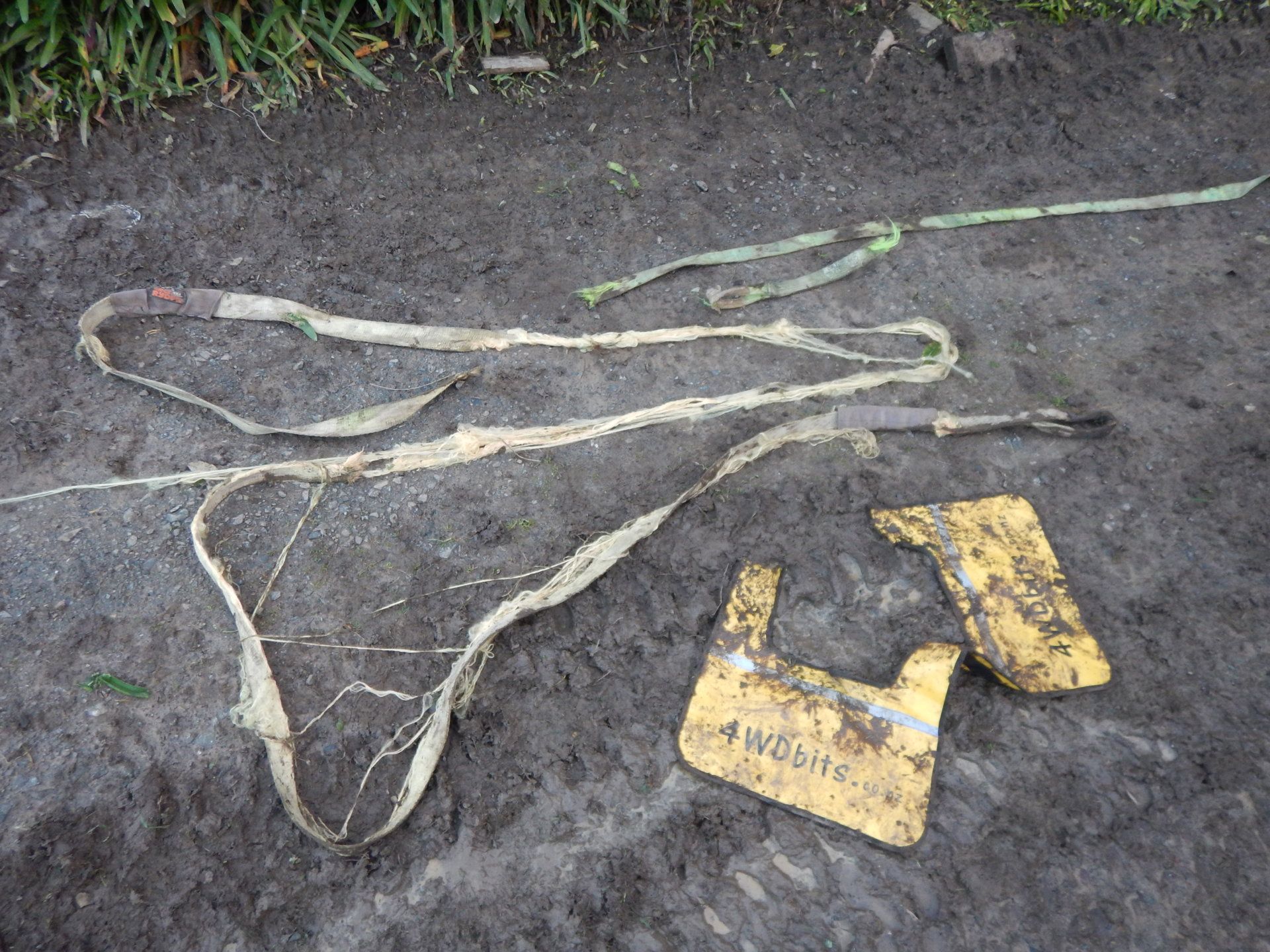

I did this a few times, got a lot of tension on the winch and drove backwards. I got about a meter and the strop around the fence post snapped. I thought, well its an old strop and i had chocked it around the post, which is half as strong as if i had looped it.
So i tried again with a better strop looped around the post, i got a bit further, but the new strop snapped and this time the pulley and winch hook smashed into the back of my truck and made a huge smashing noise, And ripped my winch dampener
Winching backwards defiantly works, but sh*t its hard on gear
Because it has to be a pulley on the back of the truck its putting twice and much strain on every thing.
Im sure you could add a few more pulleys and reduce the strain, with a cleaver block and tackle setup. But my winch rope isnt long enught for that. I eventualy got out by winching forward, added a few more dents.

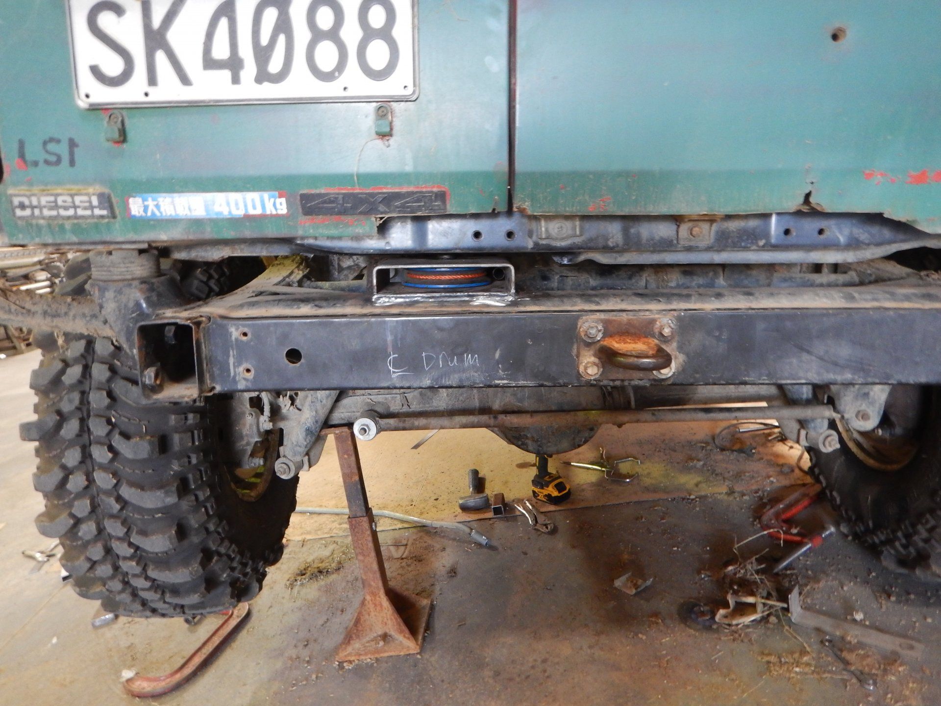

That’s also why I have a 11500 Runva on the back of my 60.

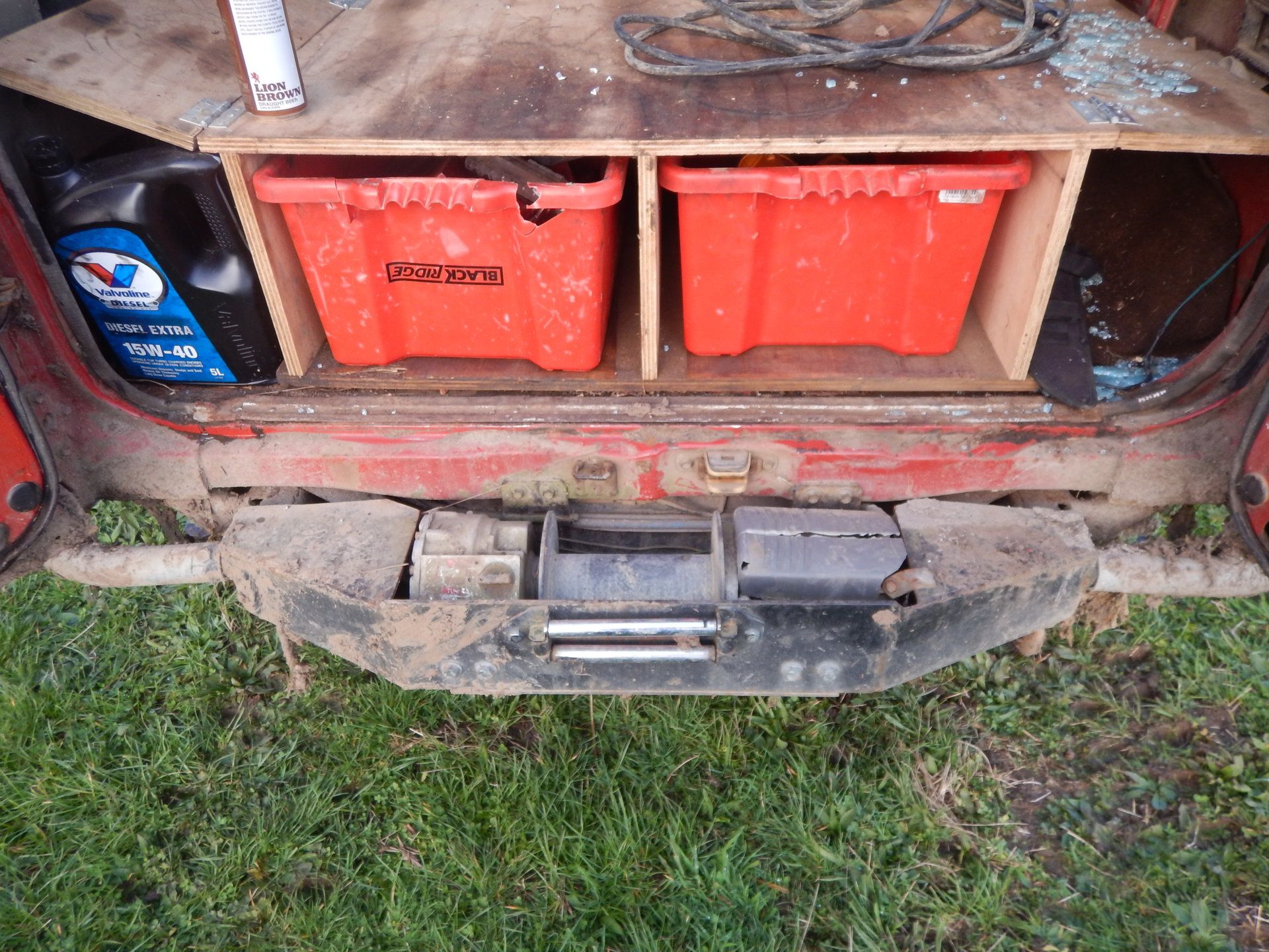

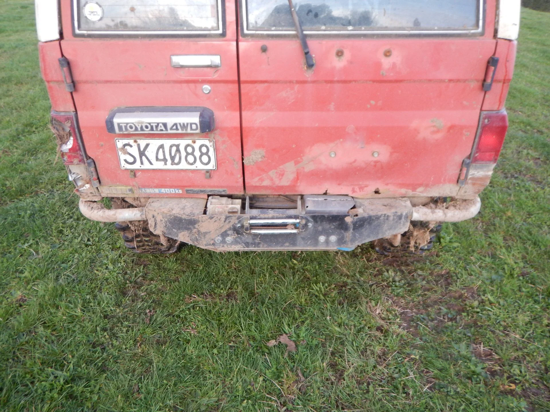

I’d be grateful if you posted up some closer pics of that rear winch set up, especially the model and size of winch.
Also how the whole bracket holding the winch is made. I’ve got a bumper fabbed up for the rear of my BJ74.
But sure looks like I could put a winch there too! Are you 12V or 24V in that truck?

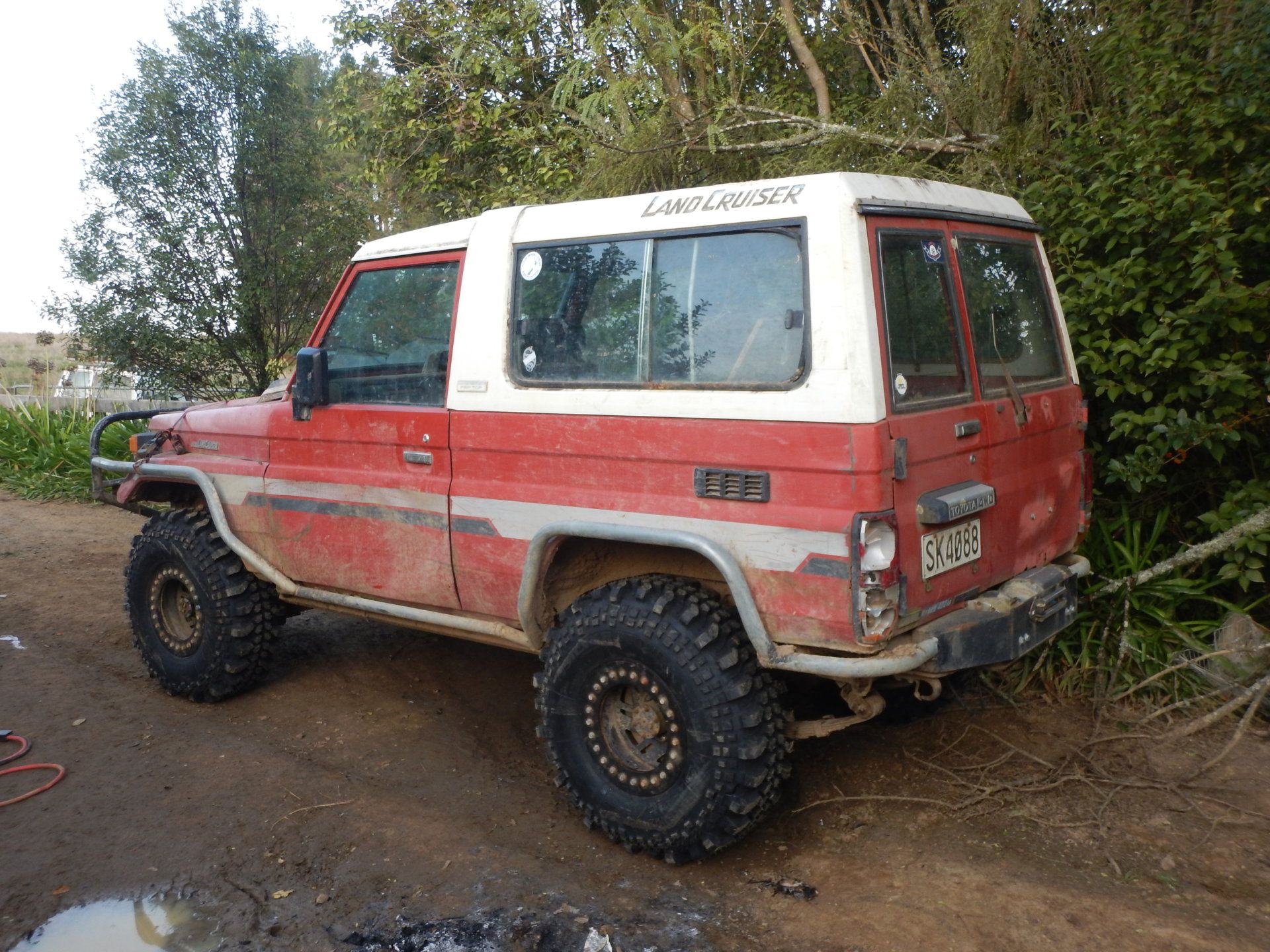

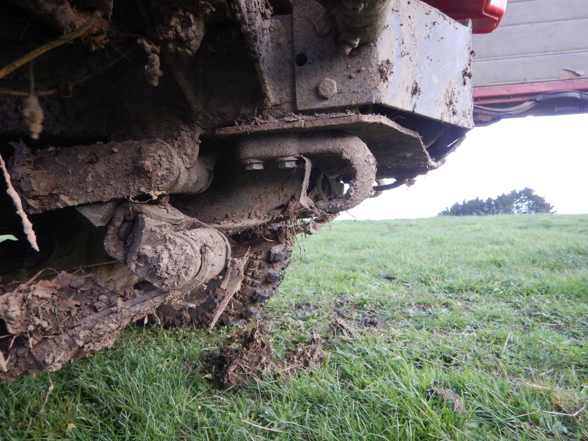

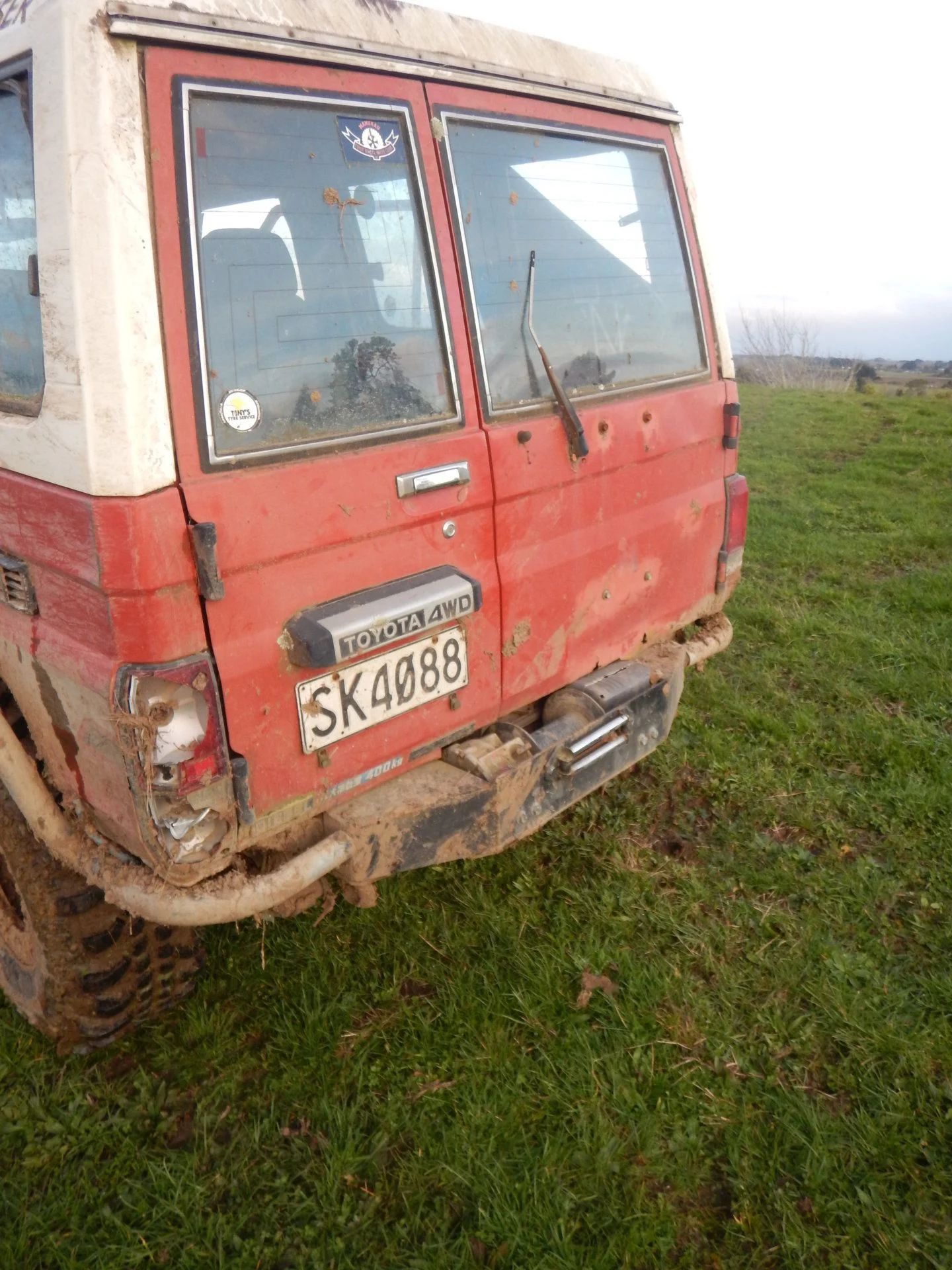

The winch is from an 80 series, I have moved the solenoids from on top of the winch, and will mount them somewhere in the cab.
I didn't want it to stick out too far and knacker the departure angle. so to tuck it in close, I cut away the rear chassis cross member, and had the winch as high as i could, so i had to trim a little bit out of the doors
Shes a trailer queen, so i don't have to worry about being road legal
The blue cable is an air hose
Its bolted to a bit of 6mm plate which i bent to lower the winch. This isn't as strong as if i bolted it to a flat plate but i think its good enough
Its quite good having this, because you tend to land on it instead of the tank
Shes 24v at the moment, but it desperately needs more power. Ive been working on a 40 series that im putting an LS1 in. I reckon ill put that engine and gearbox into this truck
Cheers

I think your right, Now that ive thaught about it, it should be half the strain as regular winching because its a double line pull. or maybe because the winch is moving backwads with the truck, they equal each other out. I dunno
The strops that failed weren't stretchy, static. Maybe they were getting a bit old and tired.

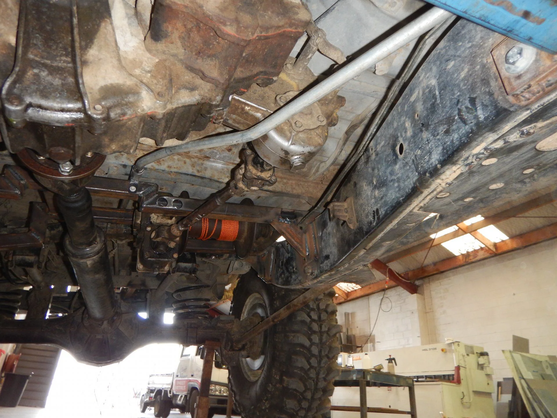

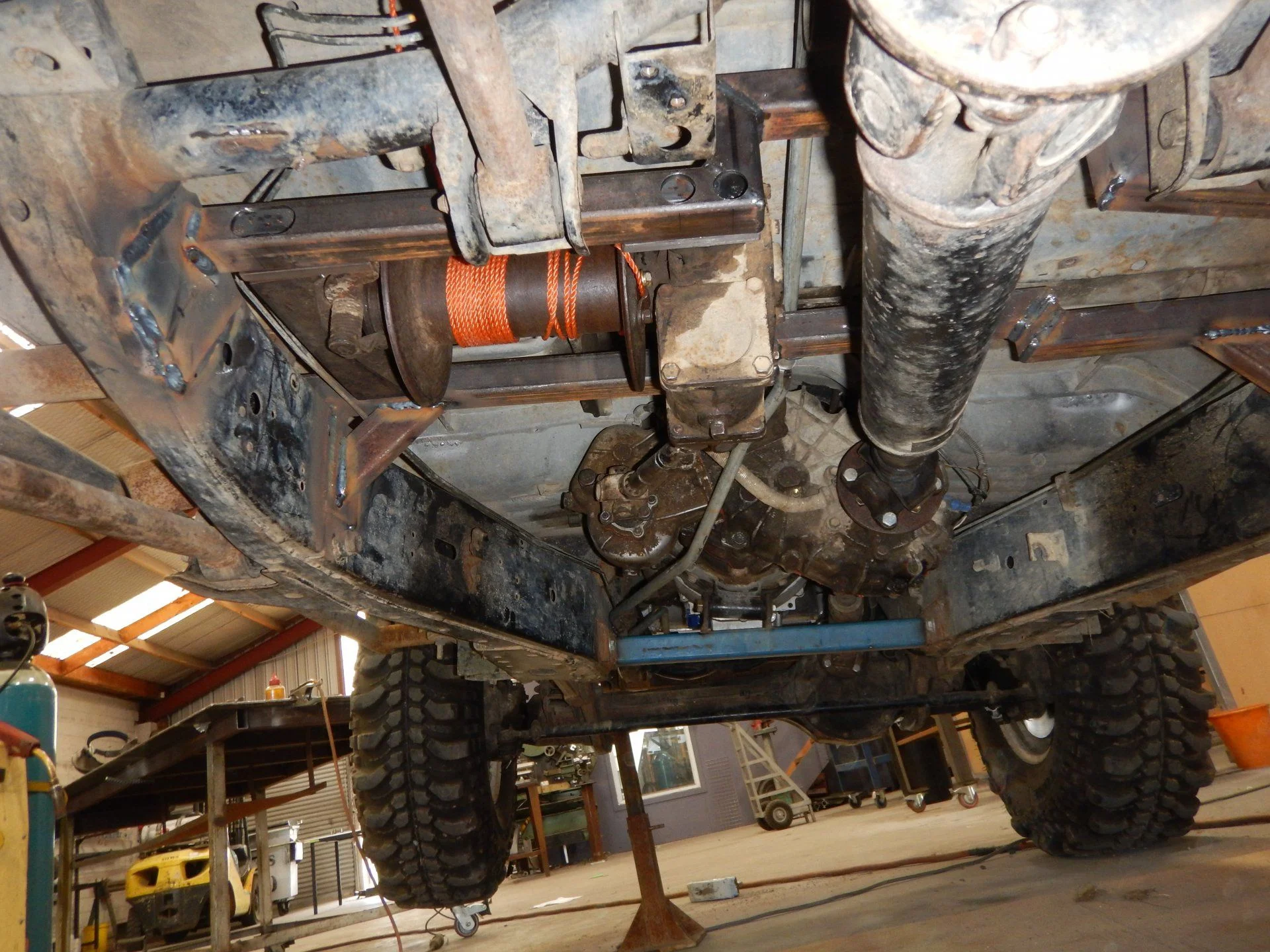

A better solution. Mid mount winch

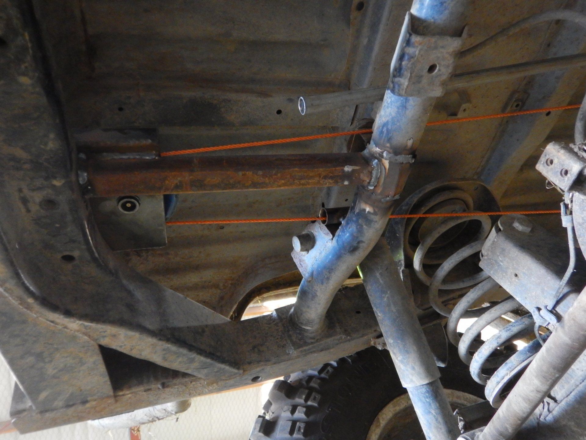

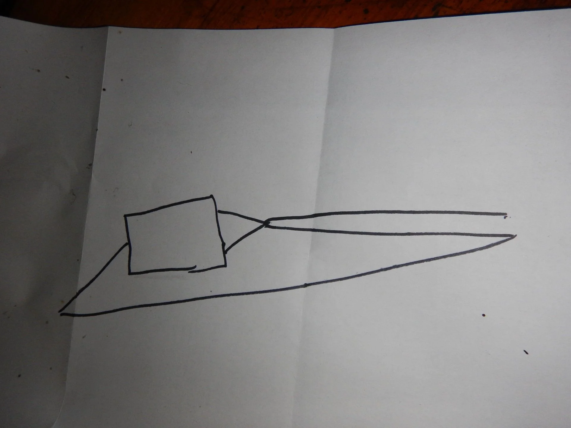

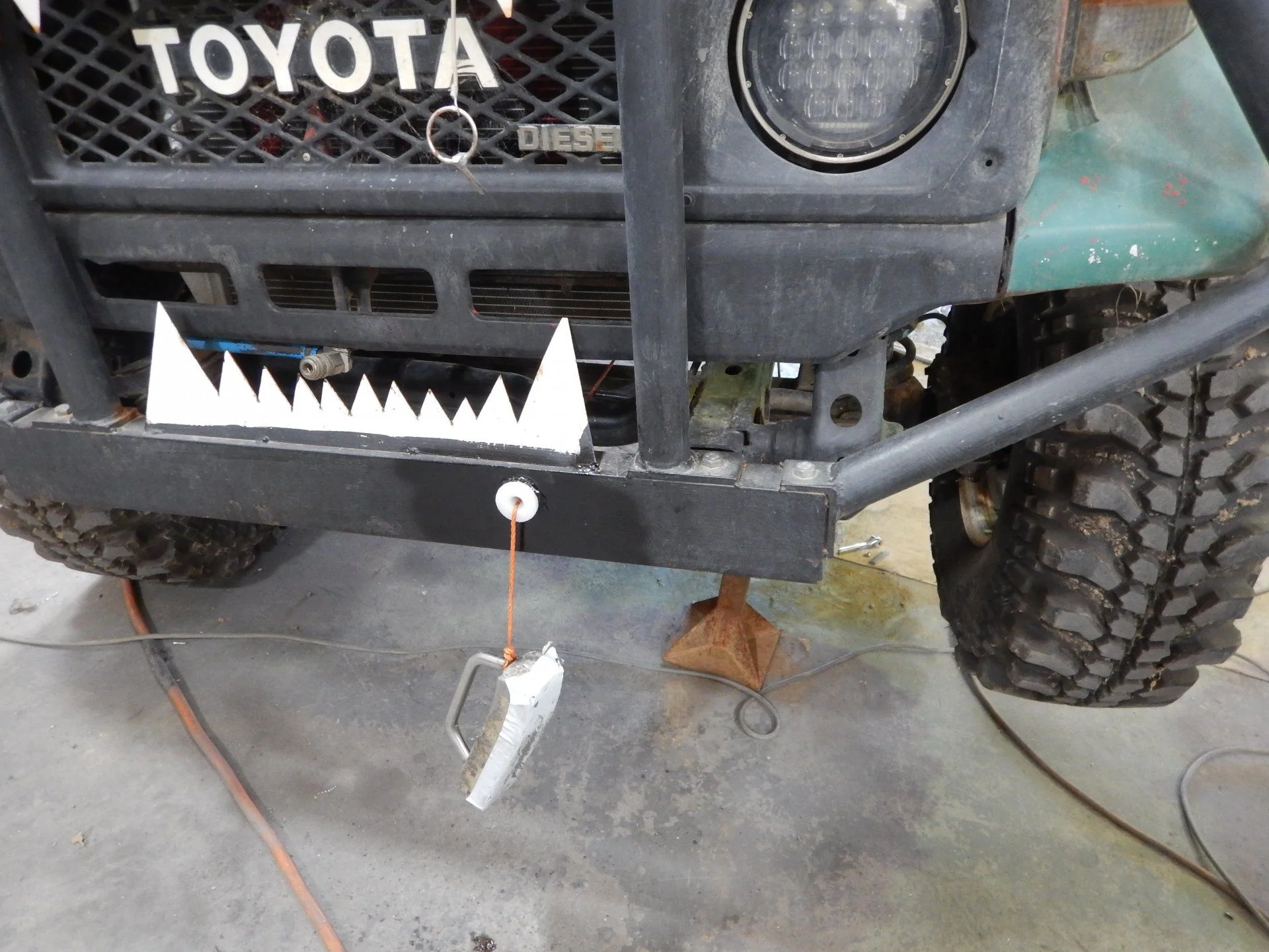

Ive mounted a Toyota PTO winch just behind the transfer case of my bush truck. The rope goes back to the rear cross member around a pulley and then out the front through a tube. So if i need to pull backwards i pull the rope out the back and around a snatch block.
So far this is all untested, but i copied it off some who knew what he was doing.
View attachment 2546247View attachment 2546248
Cheers
I've always like the idea of a midbody winch.
What line are you using, it looks, um, petite?
