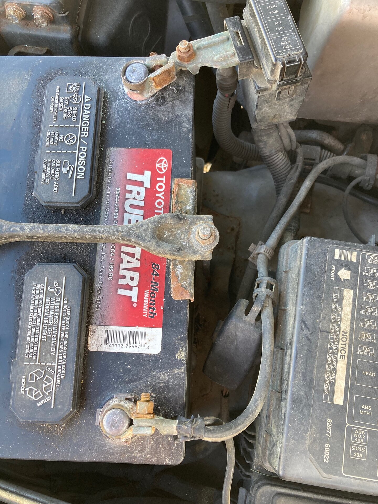

Took the battery out to replace the headlight bulb and now nothing happens when I turn the key.Battery meter on the dash looks good.
Any ideas or suggestions.Battery is 3 years old from Toyota dealer.

Weird coincidence though. My gut says it’s a battery connection issue based on what you just did.

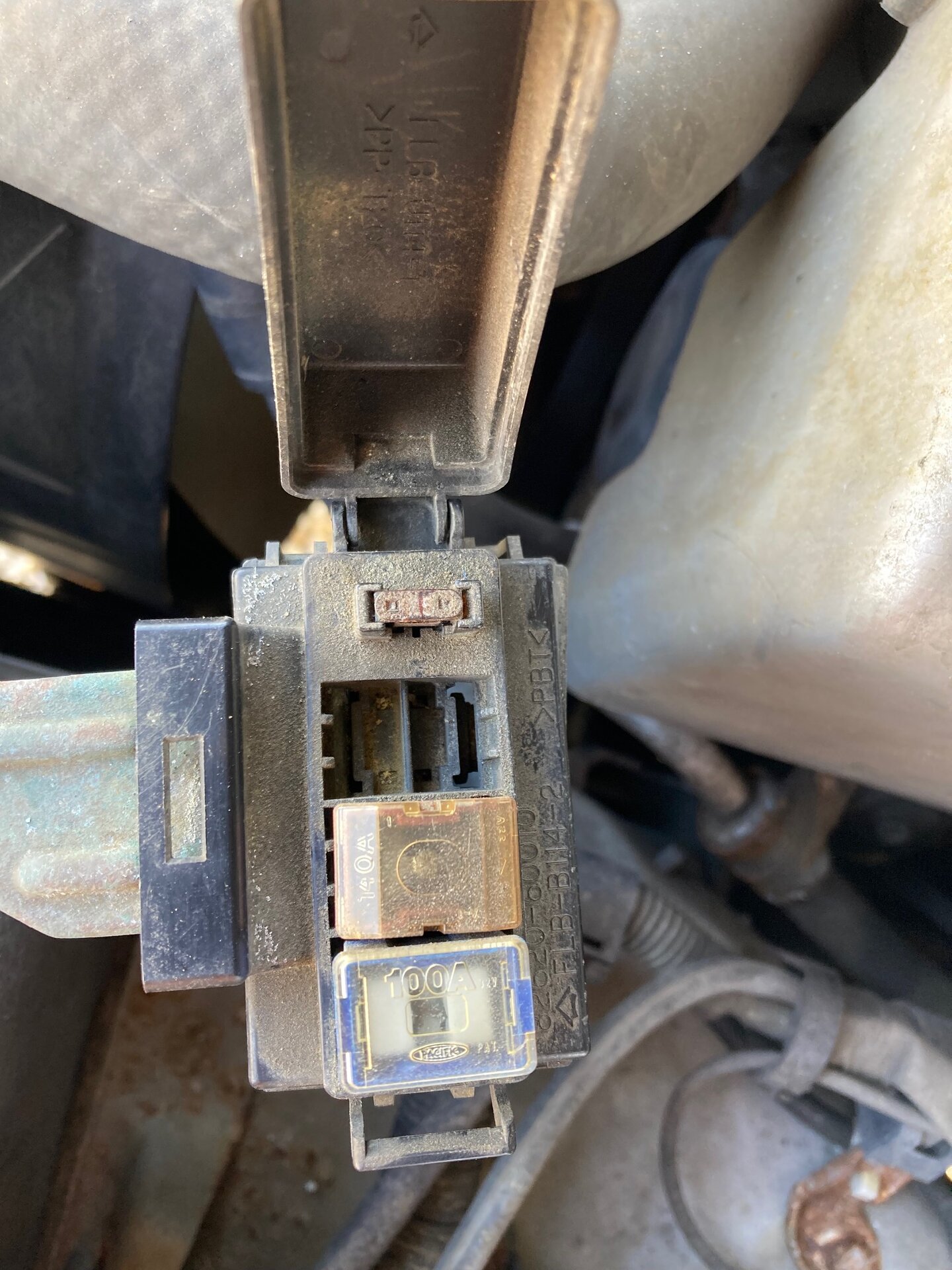

Check the Fusible link. When you disconnected the battery and/or reconnected it could have been damaged or blown from shorting somehow. The blown link prevents starting power but should allow a certain amount by which can run accessories

Not fun. Whole intake manifold needs to come off. Might as well do all heater hoses, valve cover gasket, spark plugs, tube seals, etc at that point. It sounds like it could be fusible link.

I would focus more on the fact that it all worked fine and then you took out the battery and now it doesn't work. I don't think your starter just failed without any warning. A jump start not helping anything is strange but I'm still focused on your current battery install.
Post a pic maybe? Are the connections tight? Fusible link blown?
Although I may lose it, my money is also on battery connection.
I hope you are right.I will post some pics tomorrow,I hope you guys see something I dont.

You've a good idea to fully charge battery. You'll want 12.7V or better for this test.
  • Make sure battery post and cable clamps clean of oxidation on fully charged battery.
  • Attach and "Sung" down positive battery clamp first. Just sung until you can not rotate clamp on post. Over tightening damage clamp. Then do same to negative side.
