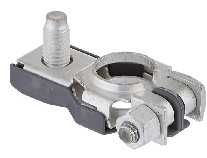

Lets see a picture of the terminal you just installed.

New battery terminal doesn't look tight to me.
Right ?...compared to the negative side which visually is fully clamped down .
@Gavone1976 if you grab the positive side and just wiggle it, is it loose at all ?
Get an OEM terminal.
