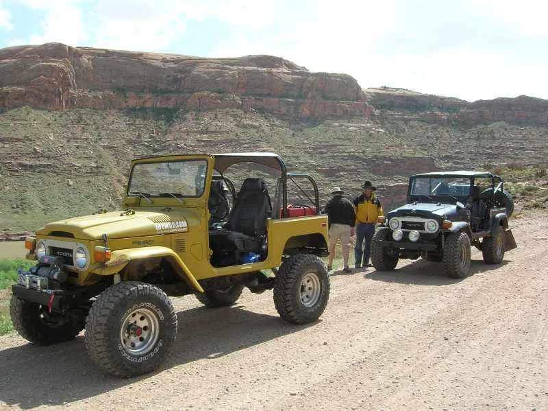

James, Glad to see your building up that Sucker, Had a Blast with you on Poison Spider, too bad my steering blew up!
