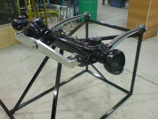

Radius arm
You can see that the link is only attatched to the frame at a single point. But fully captures the axle and stopps it from being twisted. Arms are identical on both sides. A panhard bar is also necessary to locate the axle laterally.
"Wristed" Radius arm
The arms are basically the same as the above units but one side (typically the side without the DS) can rotate. During articulation the axle needs to have some sort of differential between the left and right side or binding occurs. the "wristed" side solves this issue. It also adds a bunch of complications due to odd torque shifting and some fairly interesting braking habits. It is not the same a removing a sway bar. The effects are considerably more noticable.

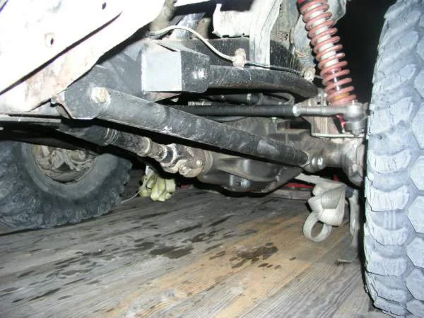

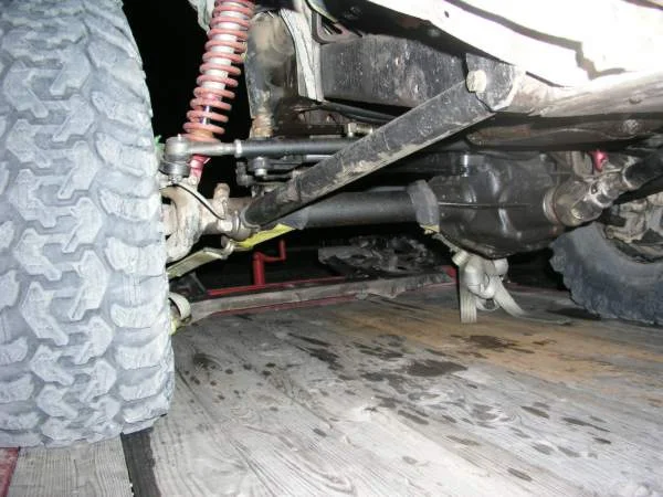

A typical three link has a single link on one side (typically the opposite side of the DS) and two seperate links on the other side. My FJ40 front suspension is a 3 link with a panhard bar to locate the axle laterally.
Passenger side

Driver side.
