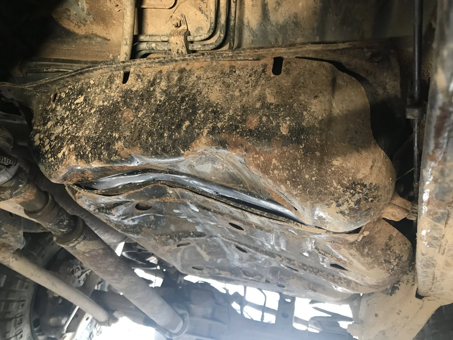

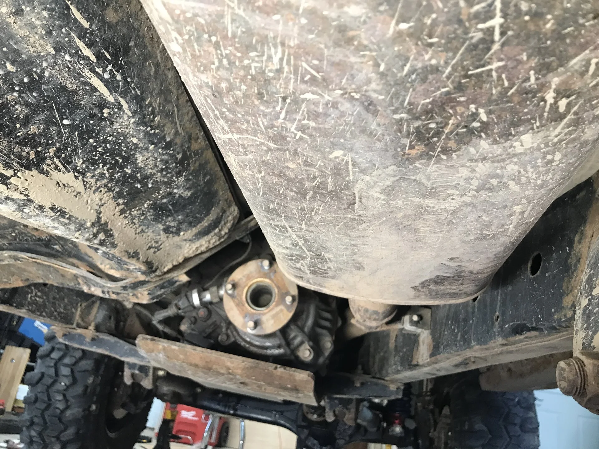

So I smashed my tank in on the rubicon and I am trying to think of a way to pull it back down any ideas? My float is stuck at half tank also but the low level light still works
I smashed one worse than that directly beneath the pump/sending unit and all worked well until decided to swap the tank with a spare I had a couple years later. Then I dented that tank about like your photo and it works well. Yours doesn’t appear from the photos to be bad enough to affect the sending unit arm or to even be concerned about.
I didn’t think so either but on my way home the gas gage won’t is till right above half tank then it’s stuck .
Sounds like you will have to drain the tank, pull the pump and get a look at what’s going on inside.
I've done this many times, usually when smashed up it will deflect the baffles which interferes with the sender. Easiest way to fix is pull the sender and bend the baffles through the sender hole. If your feel like it you can also get creative and press the tank bottom down through the hole.
Don't have to drain the tank to do it either.
Pull the pump from inside, then reach in and push the tank down.
Remove the cover from the bottom and pound it straight separately from the tank.
Pull the pump from the second row then get a wood stick like a clothing rod & pound it out.

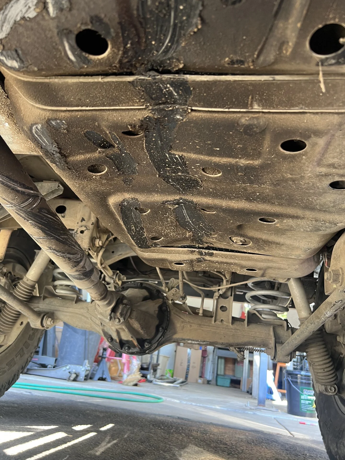

Mine is smashed in the rear from a rock on Dusy, lost about 2 gallons of capacity from it, but my gauge still works though...

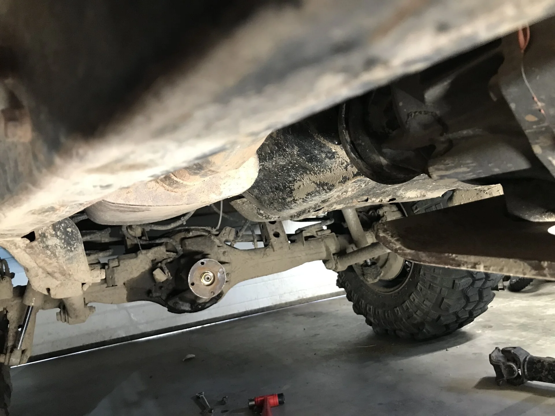

Man your driveshaft is really candy-caned, is it still ok?

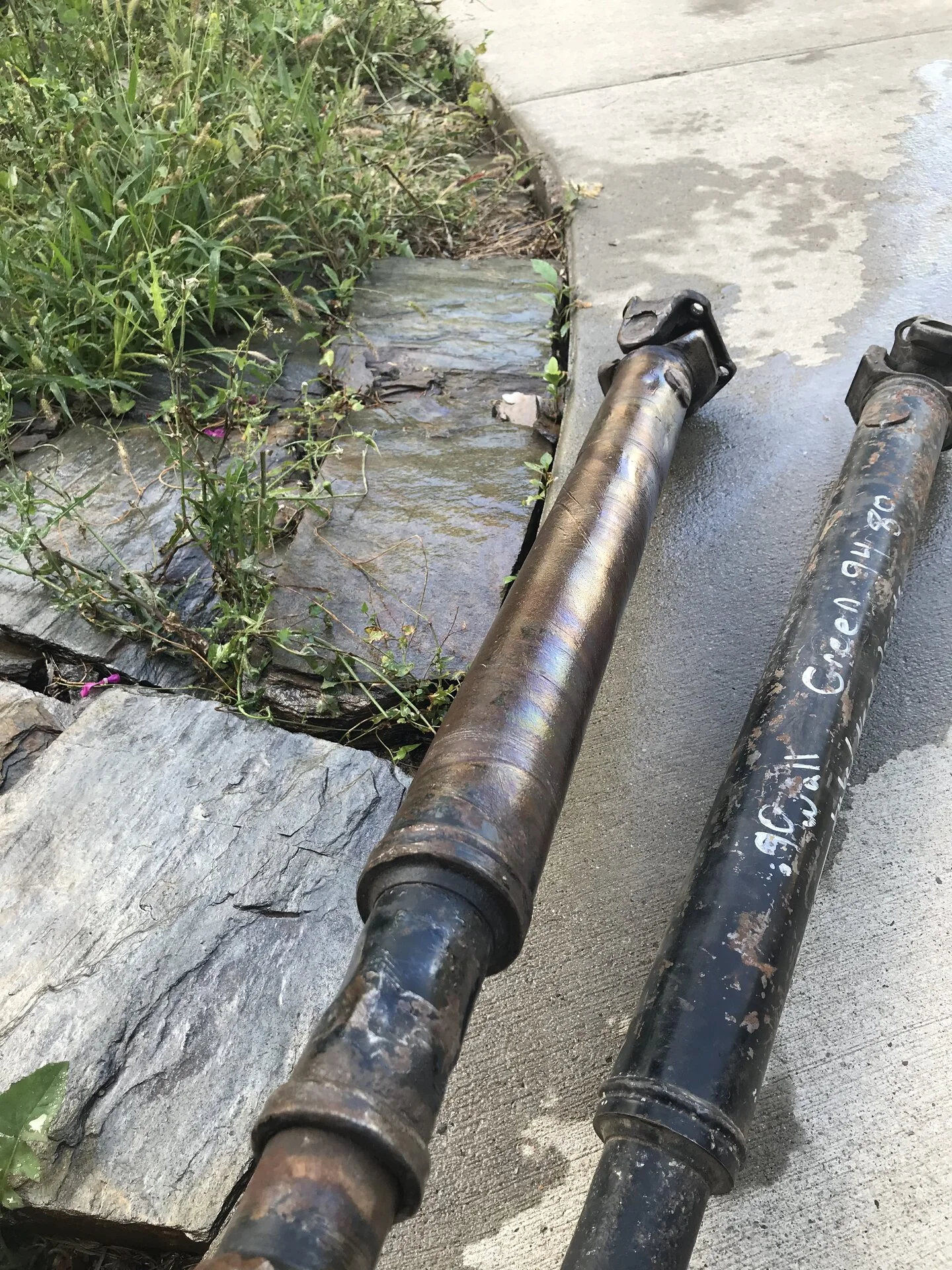

Swapping in my new spare driveshaft today. Going wheelin this weekend.. It’s beat . 😂 even the slip yoke has a dent.

I have been swapping drive shaft also.
#1) really nice highway only
#2) beater for the trail
#3) really beat trail spare I keep in the trailer just in case or to share with someone else to get them off the trail.
