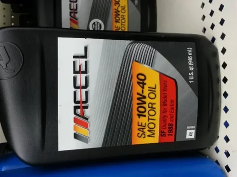

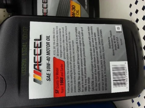

Anyone ever used this? Supposed to be made for cars made before 1988
