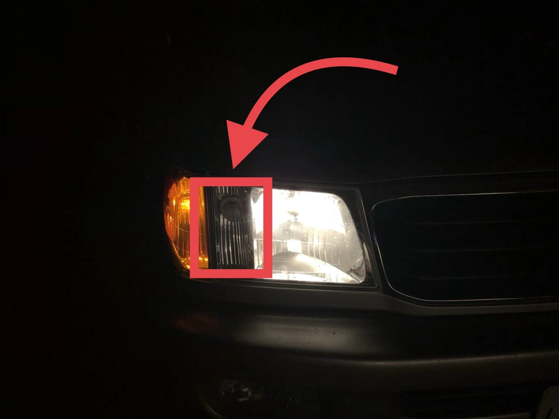

I'm not sure which bulb is out but I'm after a little researching, I think it's the parking light (size# 168).
Am I wrong, if I am, which bulb is this?

Yep, that's the size. Just replaced that exact bulb last week. Easy to get to on that side with no battery in the way.
I got the wiring harness out but cant seem to figure out how to get the actually bulb and connector out of the light bucket. How did you do it?
Shouldn't have to take the wiring harness out, just on the back of the light housing where the bulb is, turn that portion like a headlight bulb to release the connector. Bulb will come out with it, just pops out of the clip, pop the new one in.

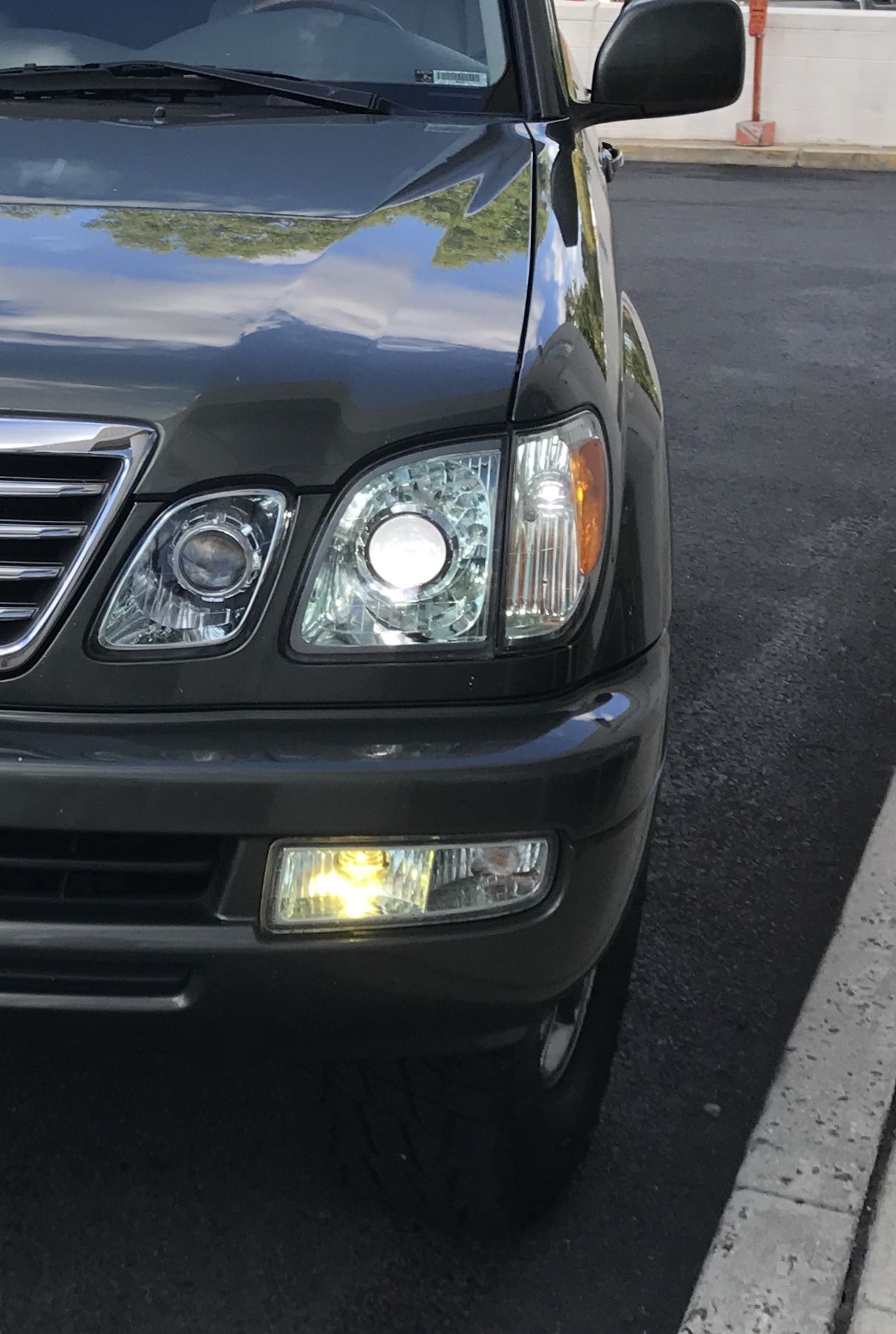

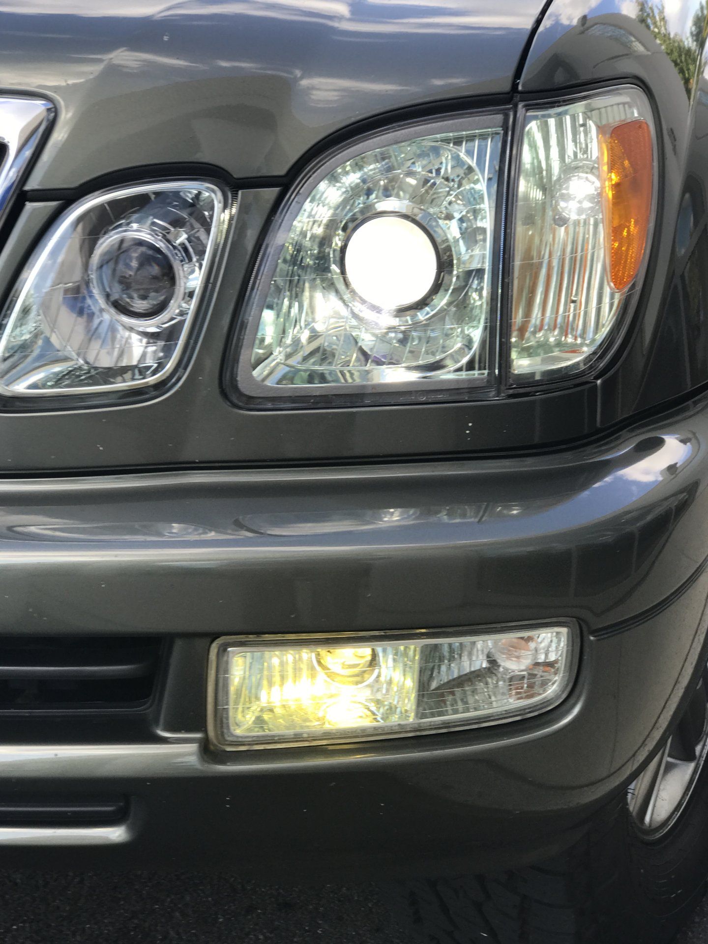

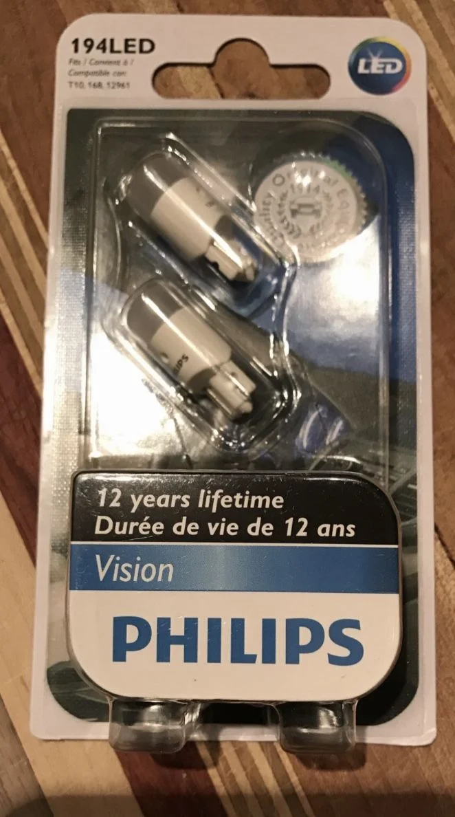

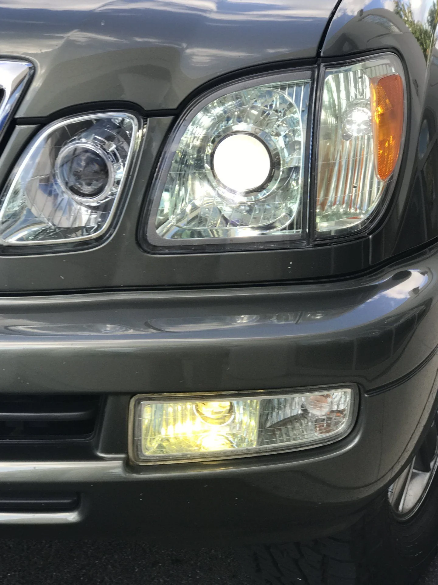

Replace it with LEDs! Looks sick
Agree with @YoungStingy I️ used this Led as a parking light and it complements my HID retrofitted headlights and foglights nicely
