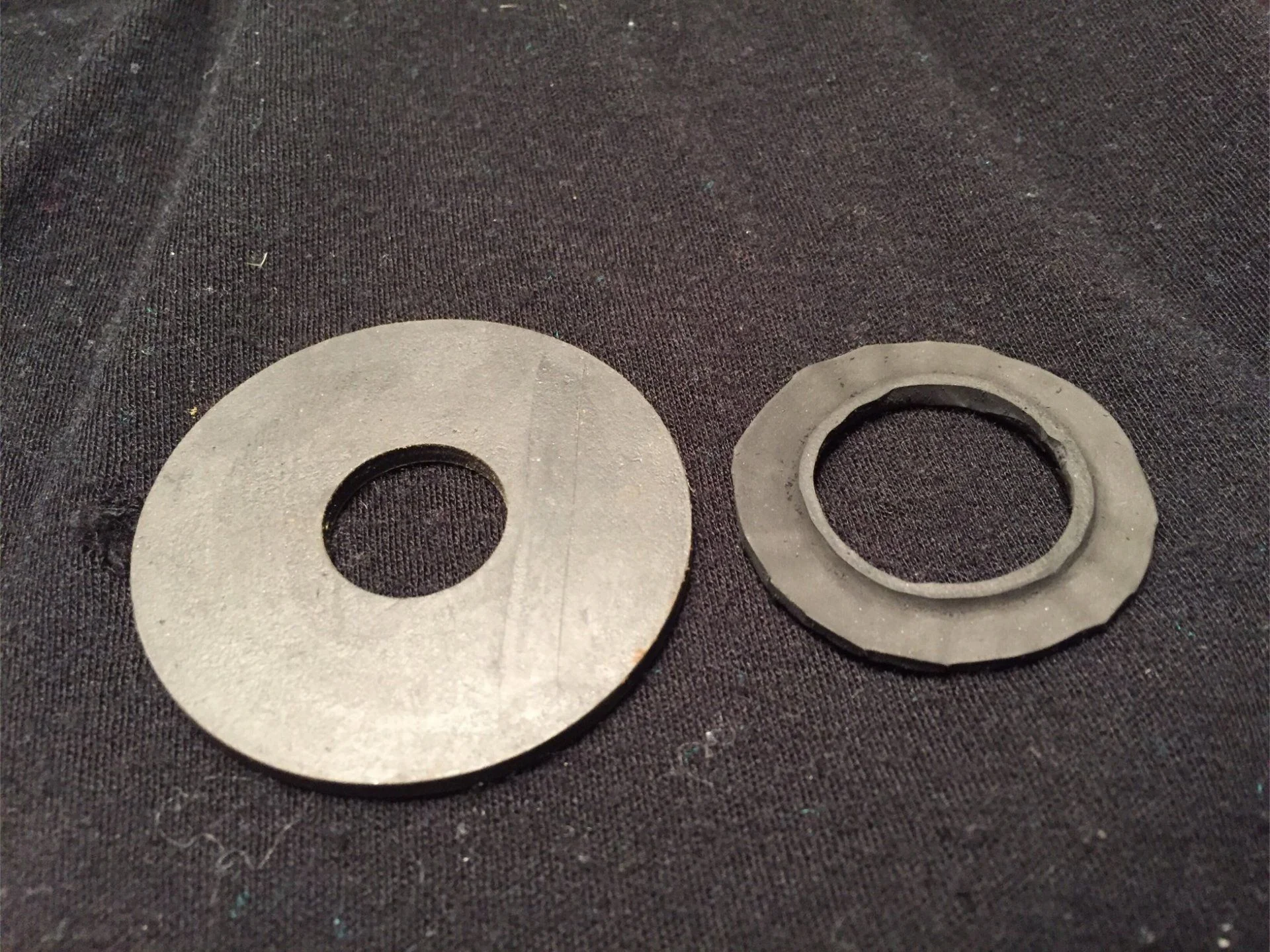

I grabbed a few large rubber washers at a Ace hardware. Used 1 for a horn contact seat insulator. Here’s what they look like. I can dig one out tomorrow and take a measurement.
What’s the diameter of your base?

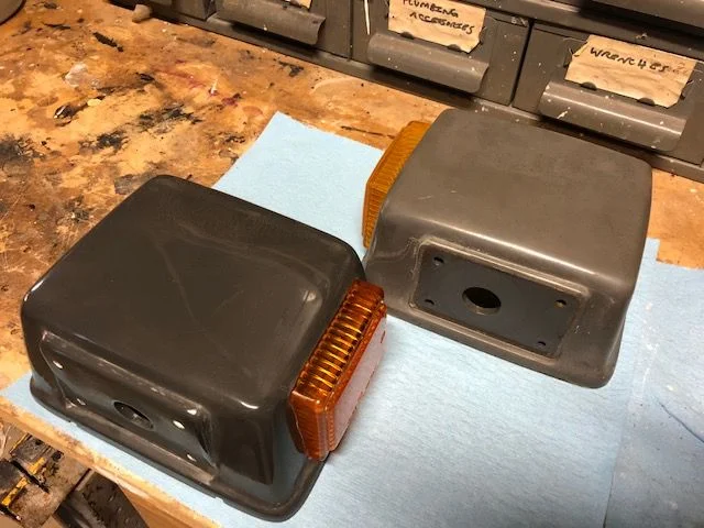

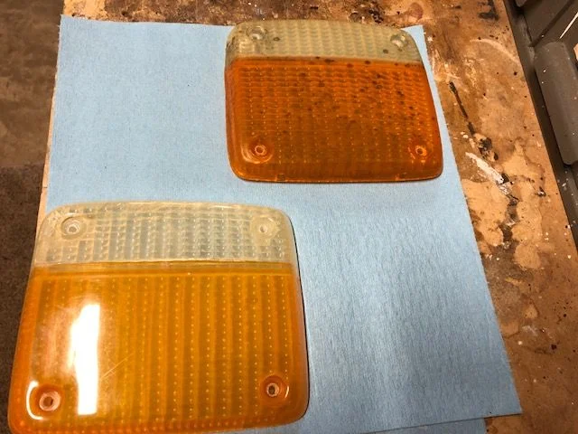

Thanks to everyone for the great advice and leads. Sharing a couple pictures of the progress.
Images below show a before and after. The left signal is done - used a series of wet sanding and plastic polish.
Signal body
Signal lens

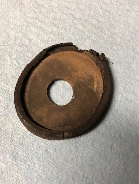

The offending front gasket

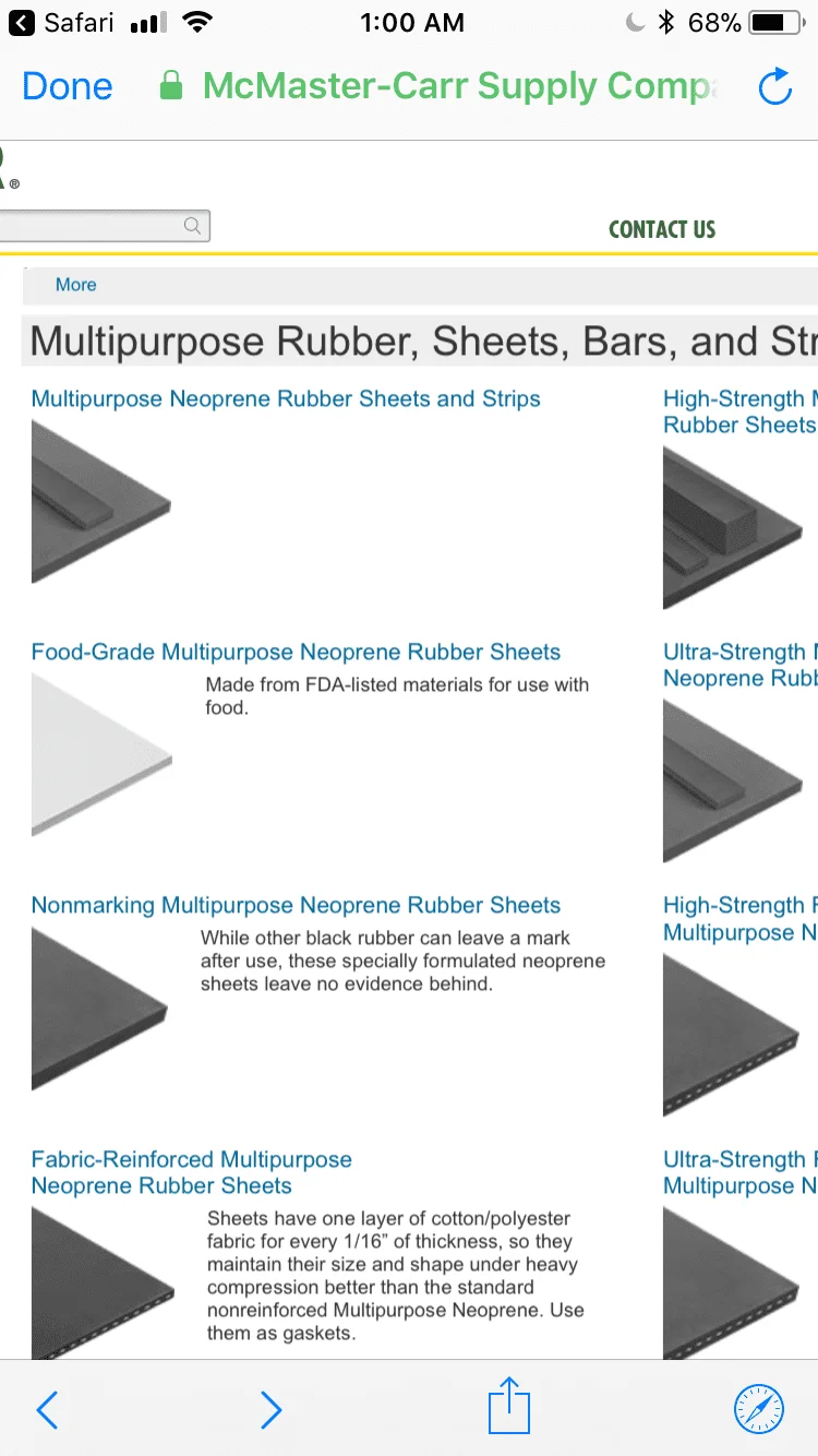

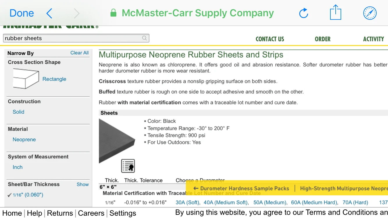

PM me your address and I will send you a couple of the grommets (Cruiser Karma) that go in the hole and surround the wire that go through the fender under the base of the light. They are not the flat rubber with the raised edge. I second the suggestion to use some flat rubber sheet and trim to size.
I will post the McMaster Carr part number tomorrow when I get back in the shop.

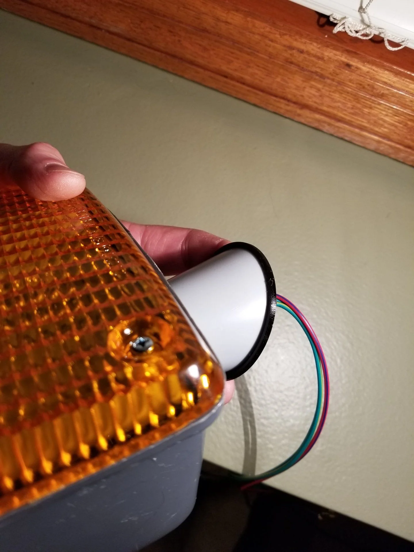

I'm confused. It seems like this would prevent the 2 nubs on the side of the base from seating into their respective holes adjacent to the main one the post threads through. Was this a stock gasket or just homemade?
Also; fair warning to the masses, if you're an idiot like me, don't twist on the light to "align" it once those nubs are already snugged in or you'll crack the plastic base...:bang:

Thanks. The Grommet that came off was there from the PO. Not sure if it was stock or homemade at this point. Main goal is to protect the paint from the direct metal to metal contact once the pedestals and lights are ready to put back on.

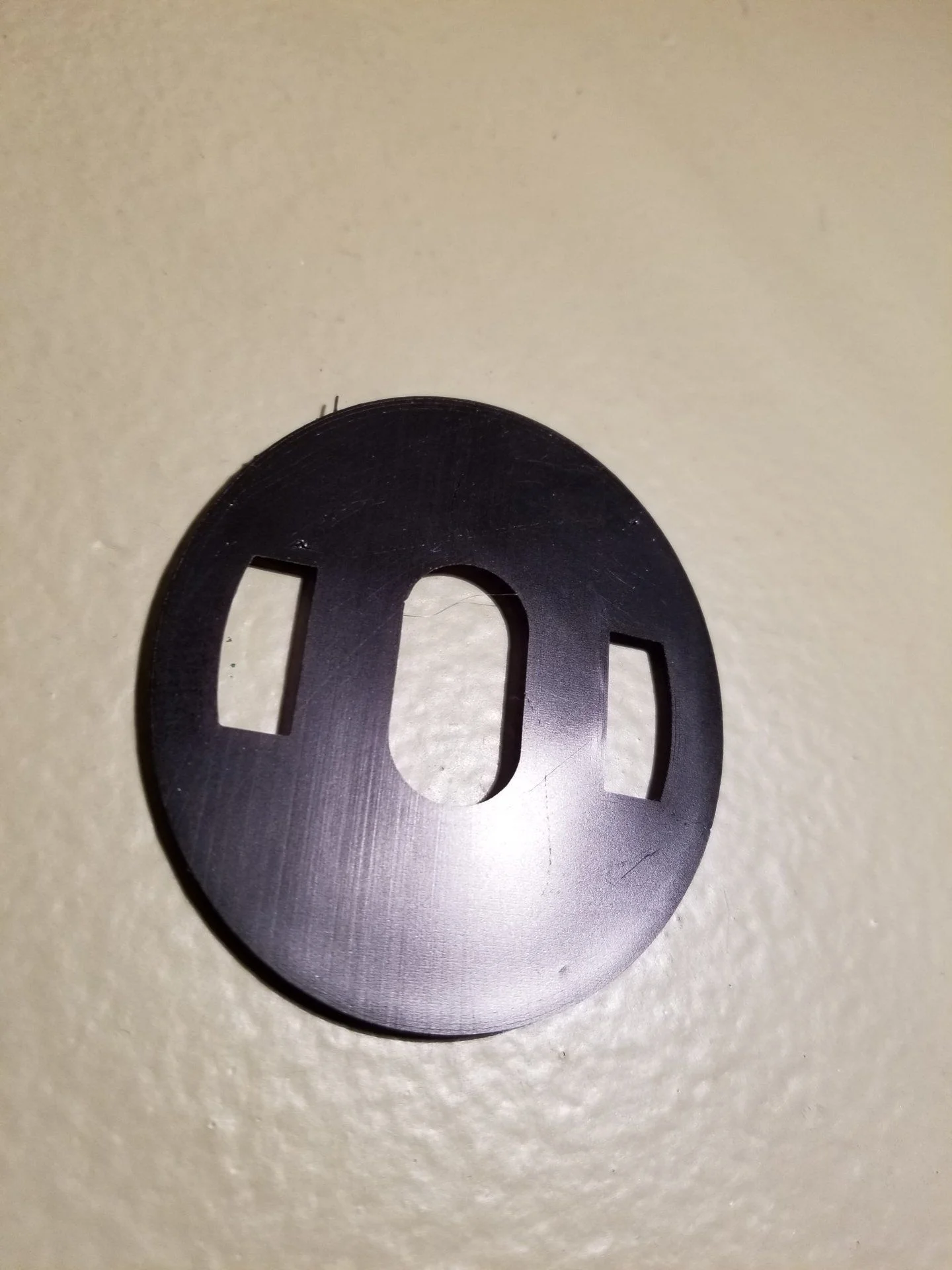

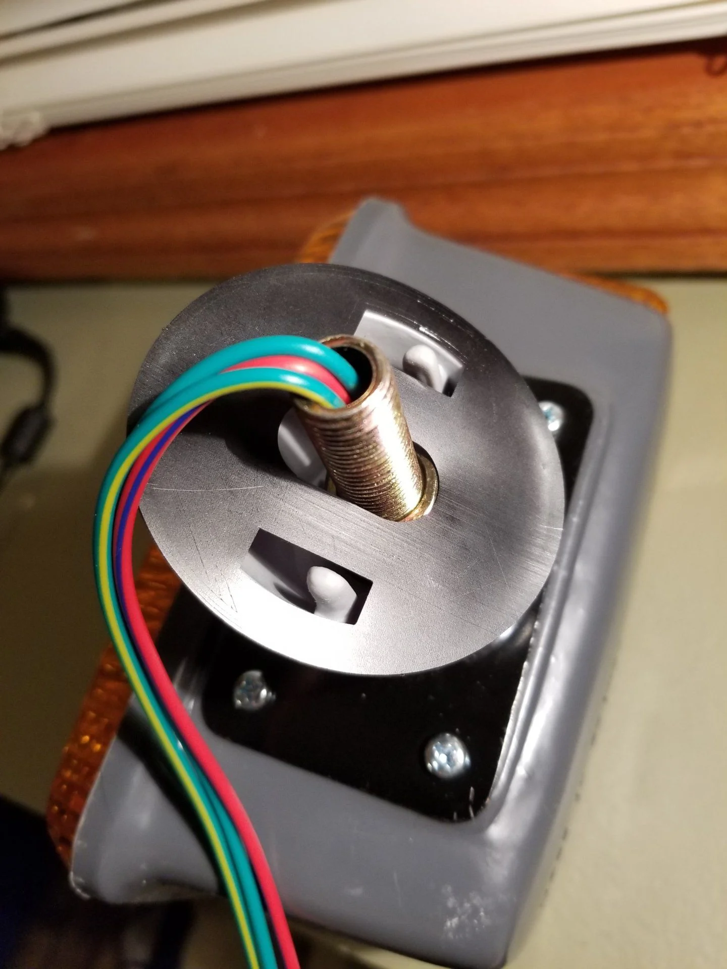

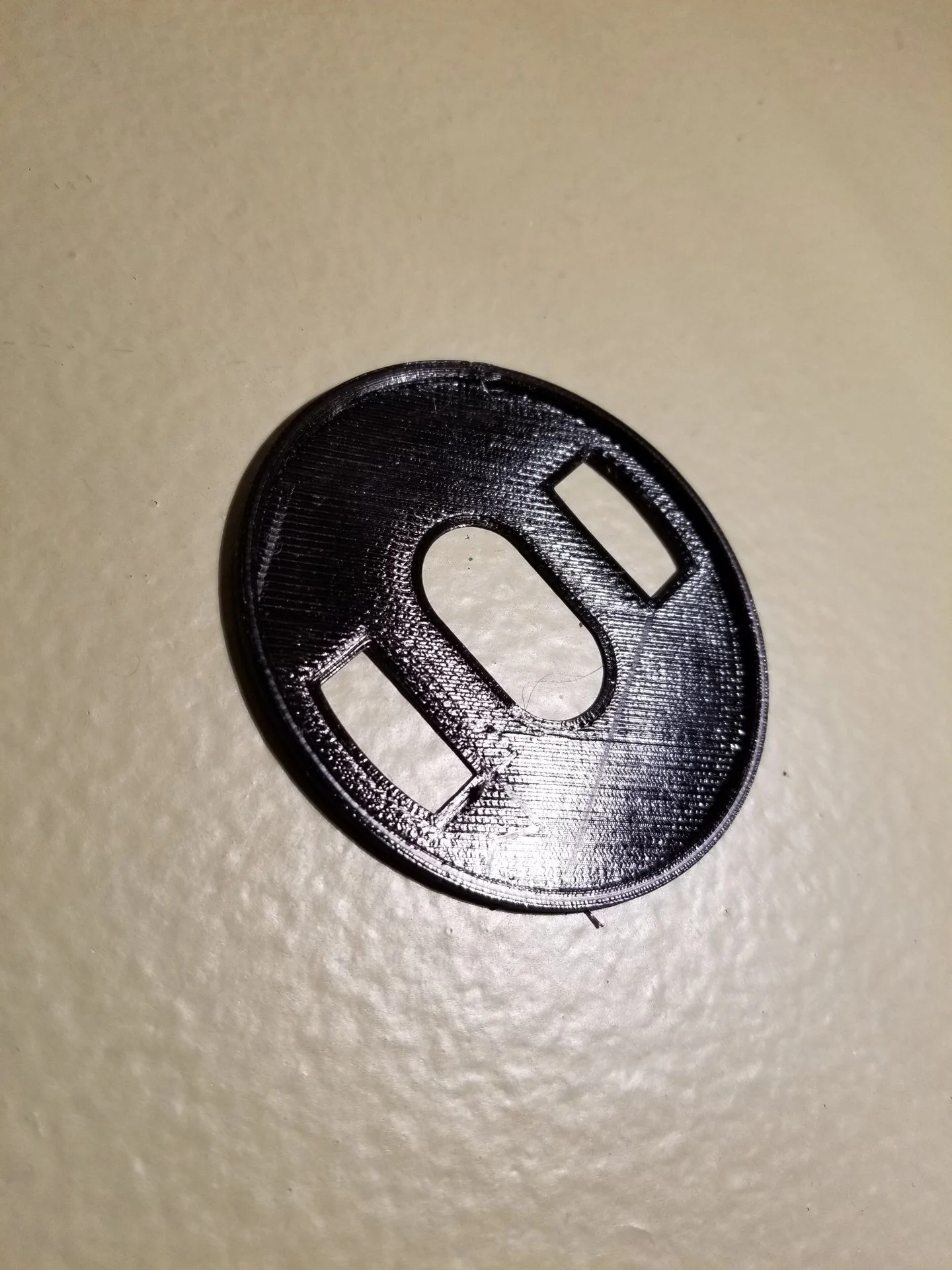

I am doing a Gozzard transplant on to a 82' FJ40. To get the fit, finish, and finer details the way I wanted I took a detour and got into 3d printing. Here is my solution to the same problem. It is printed out of flexible TPU (not as soft as rubber but it has similar characteristics). If there was interest from the group I could probably recreate more.
Lo Tec’s doppelgänger! Very nice. I wonder if the pre-69 turn signals are the same diameter? There’s quite a few folks looking for those too.
Wow! 3D printing to the rescue!!! Very nice solution to the problem :cheers:
I am interested in a set of the pedestal gaskets.
