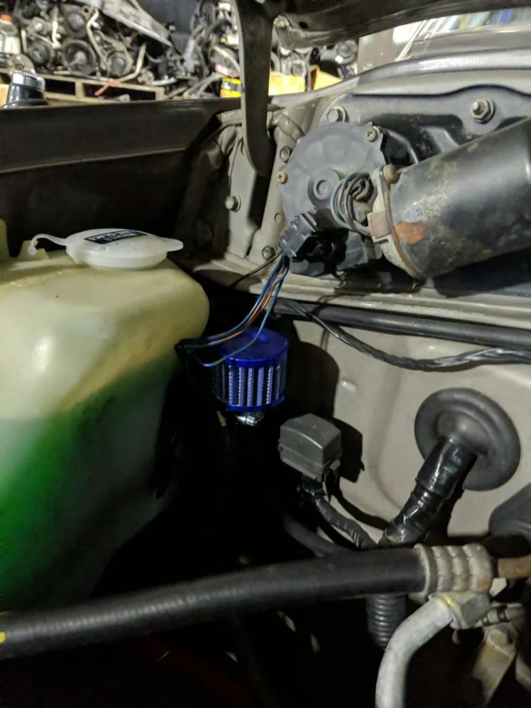

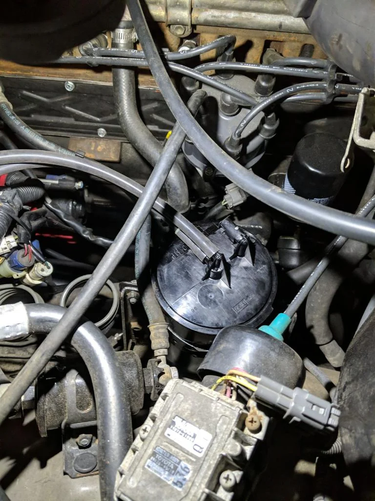

First off, next step in getting rid of the woosh was replacing the charcoal canister with the AC Delco unit everyone talks about.
Also had a random breather from the old canister on the top of it that we moved outta the way..

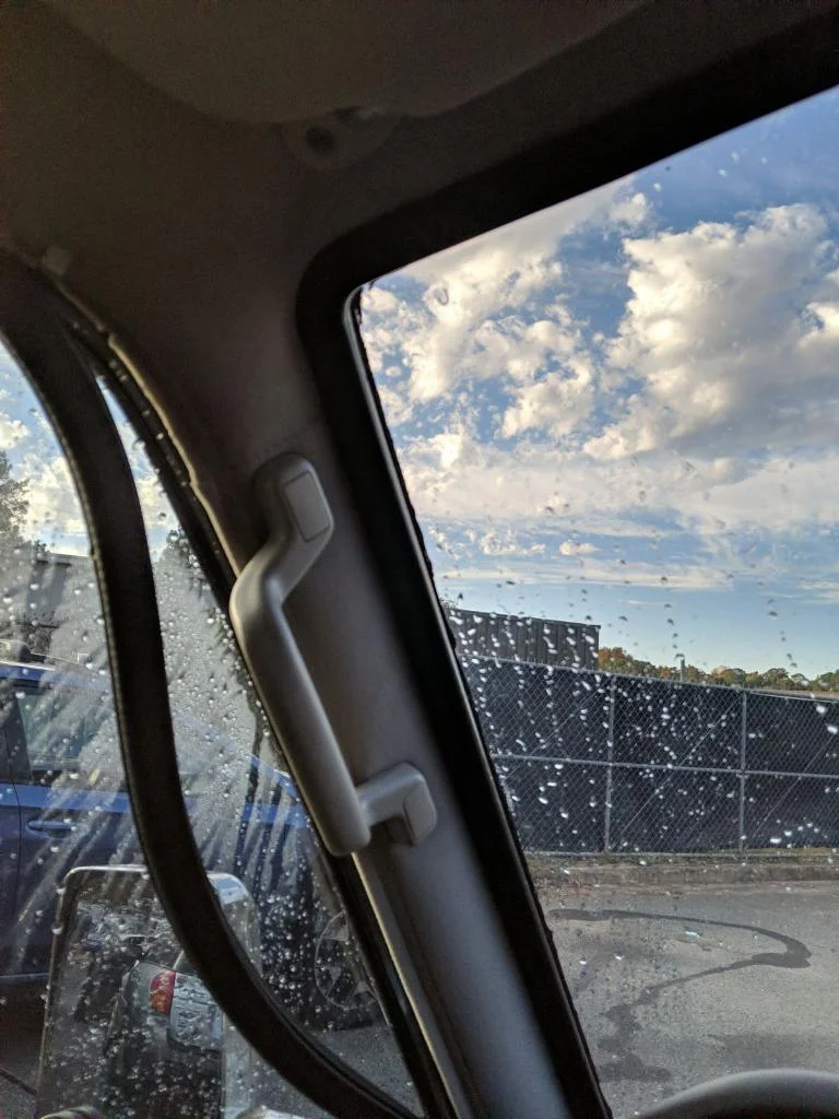

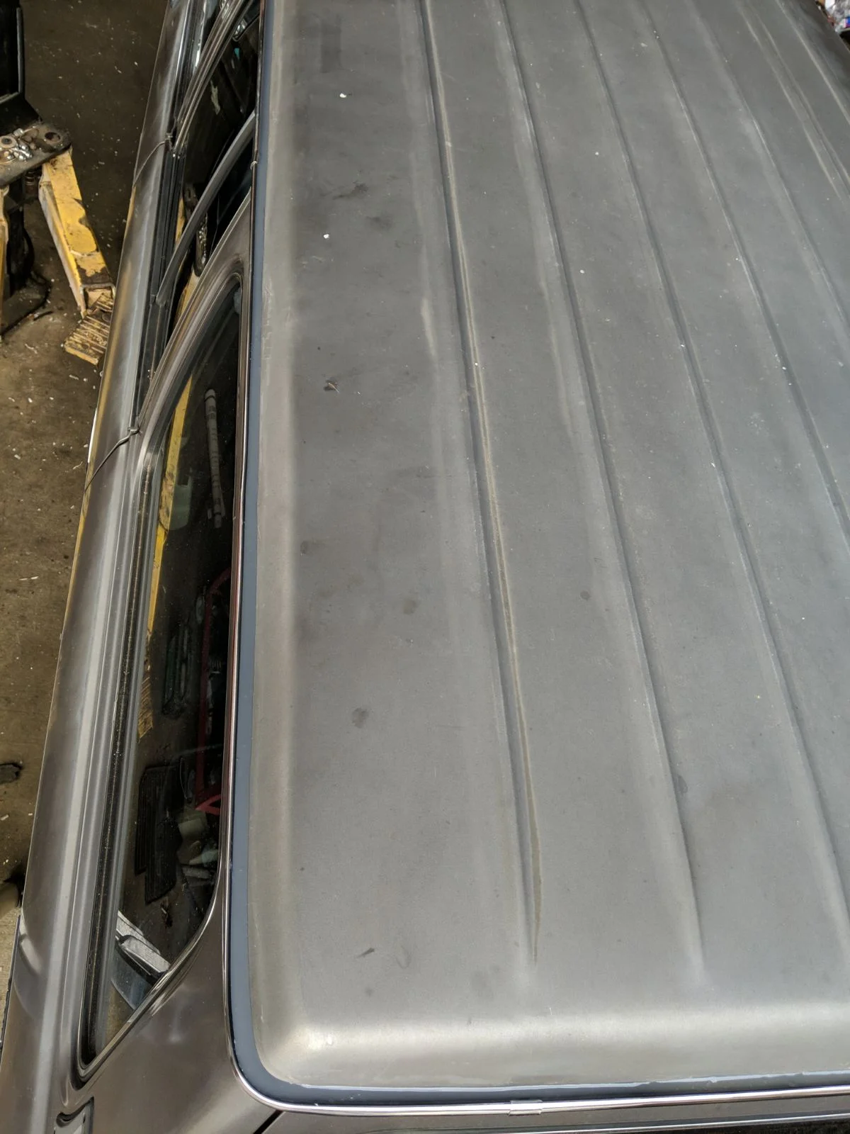

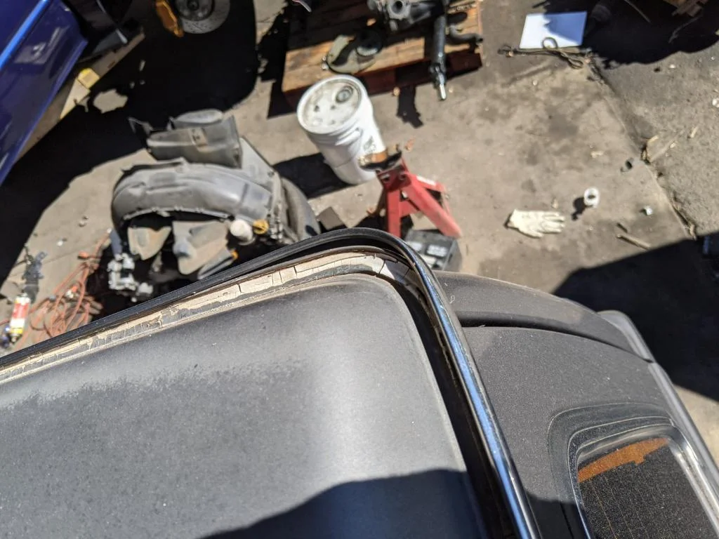

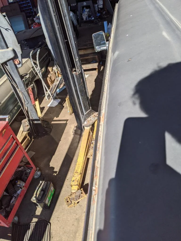

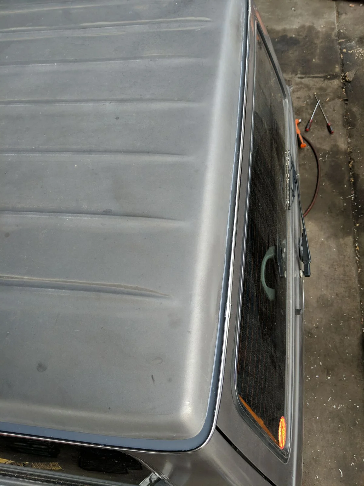

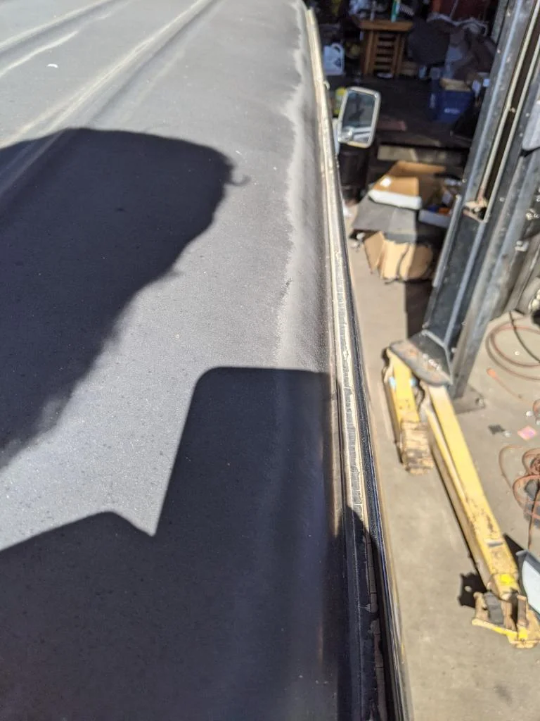

Also still having some water coming in from behind the oh-s***-handle on the A-pillars soooo while I have some door seals I’ll be replacing, the rain gutters don’t look great.
So we’re gonna knock that out too.

Which charcoal canister is everyone talking about?

I was just looking at the chrome gutter trim and wondering if that is a scab I should pick at. I’m not a chrome fan at all, never have been, and these just seem like a perfect place for corrosion to set up shop.

AC Delco 215-153

I think the rain gutters just need to be done eventually and why not now when I’m trying to figure out this dumb A-pillar leak 🤷🏾‍♂️

The chrome on this 62 is in great shape too, I just feel like the gutter trim is superfluous and serves no positive purpose.

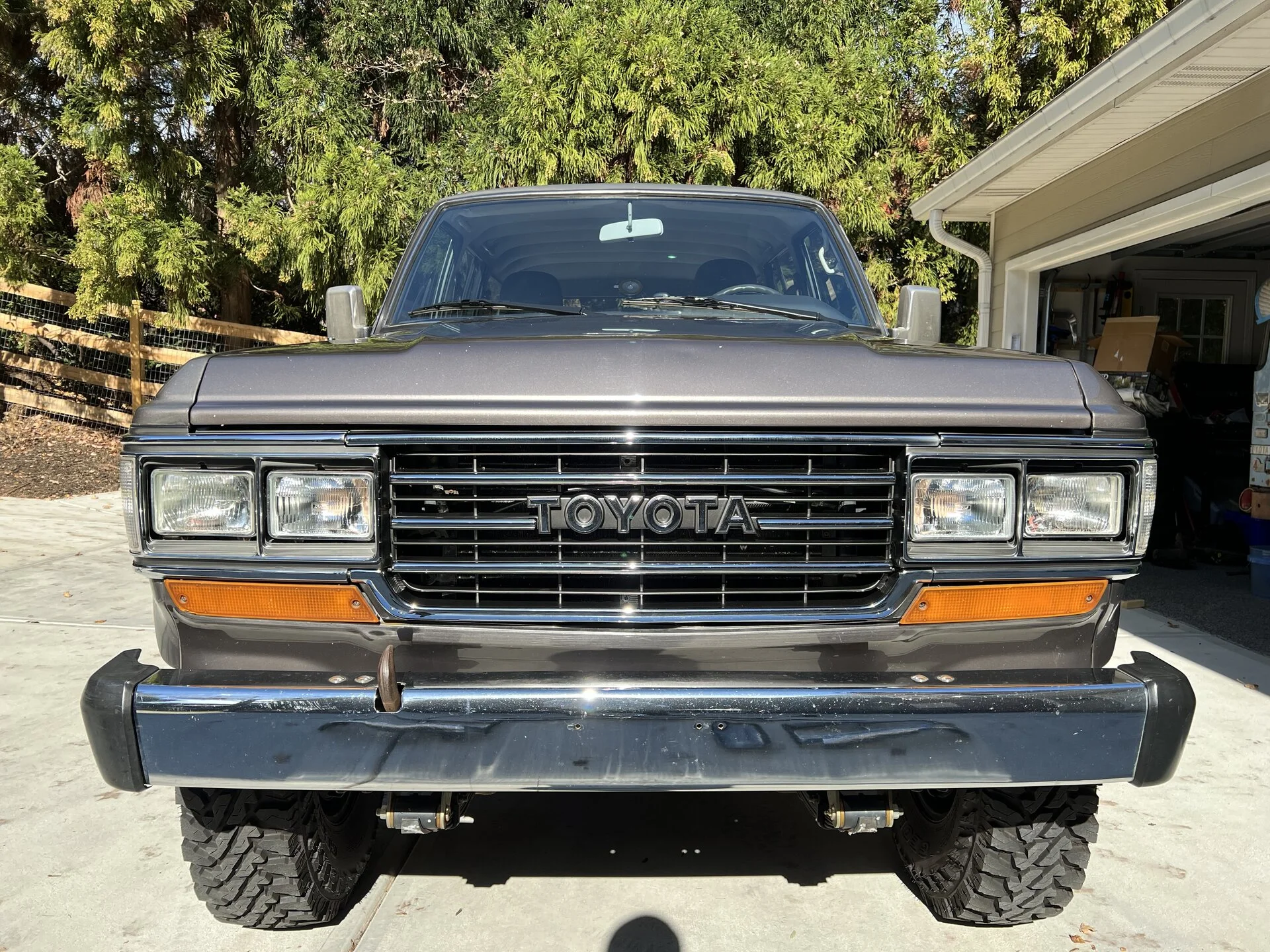

I just replaced the chrome monolithic slab of a front bumper with an ARB variant and I gotta say, she’s a whole different truck. If she had the oem bumper I wouldn’t have changed a thing, but that beast was hideous.
✅ Rain gutters

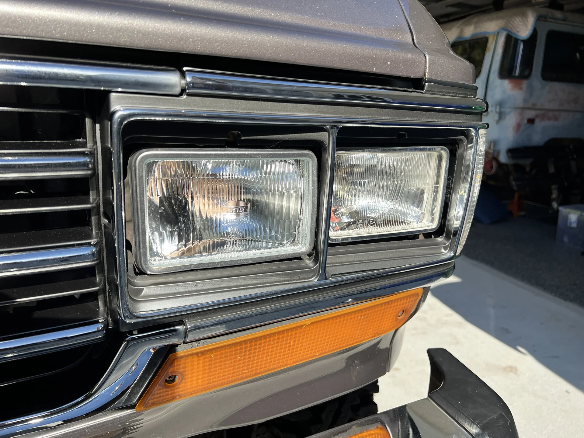

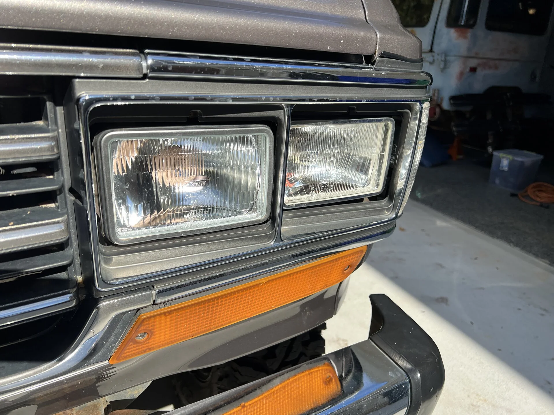

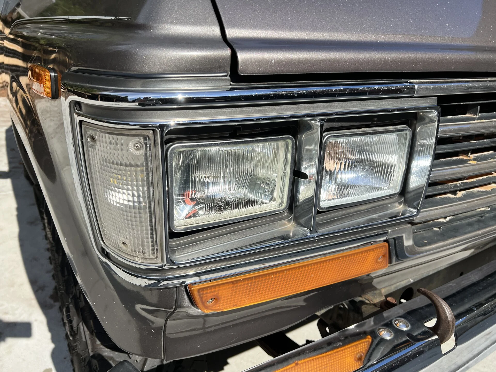

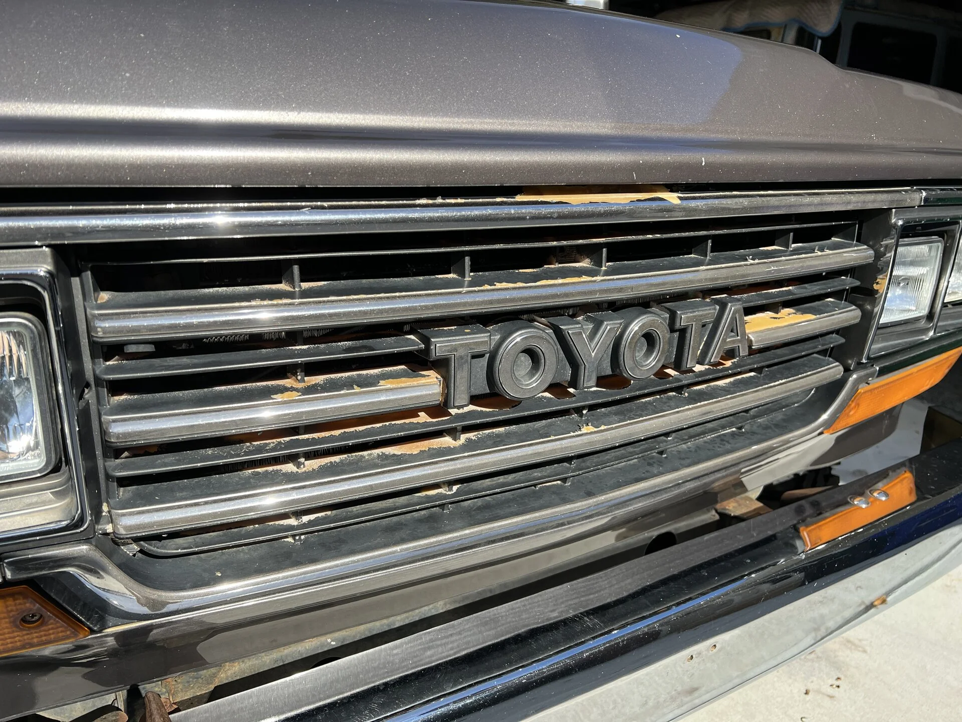

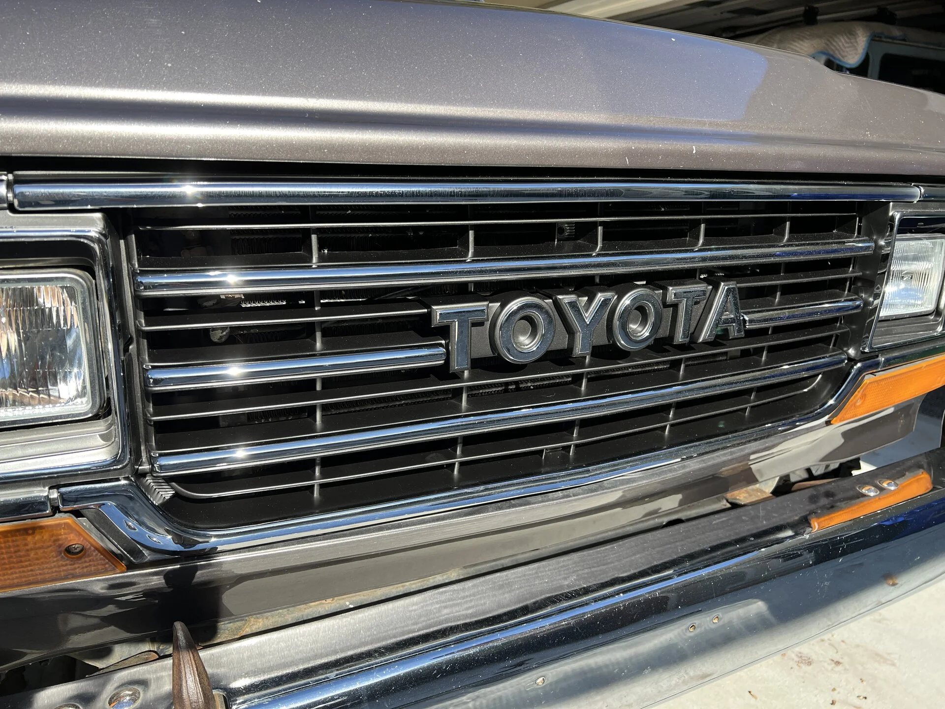

Got my aftermarket grill from Relic Garage… it’s not OEM, but it looks good. Realized that my headlight bezels were already aftermarket once I got to installing the new stuff.
Old stuff for reference:
And the new…
I will say with regard to the Relic Garage aftermarket grill… fitment was fantastic, but as mentioned in other posts, the bottom plastic clip actually didn’t align with any hole. Didn’t have to cut it off, the grill just isn’t secured at the bottom middle, but is secured with the 4 other clips on the sides.

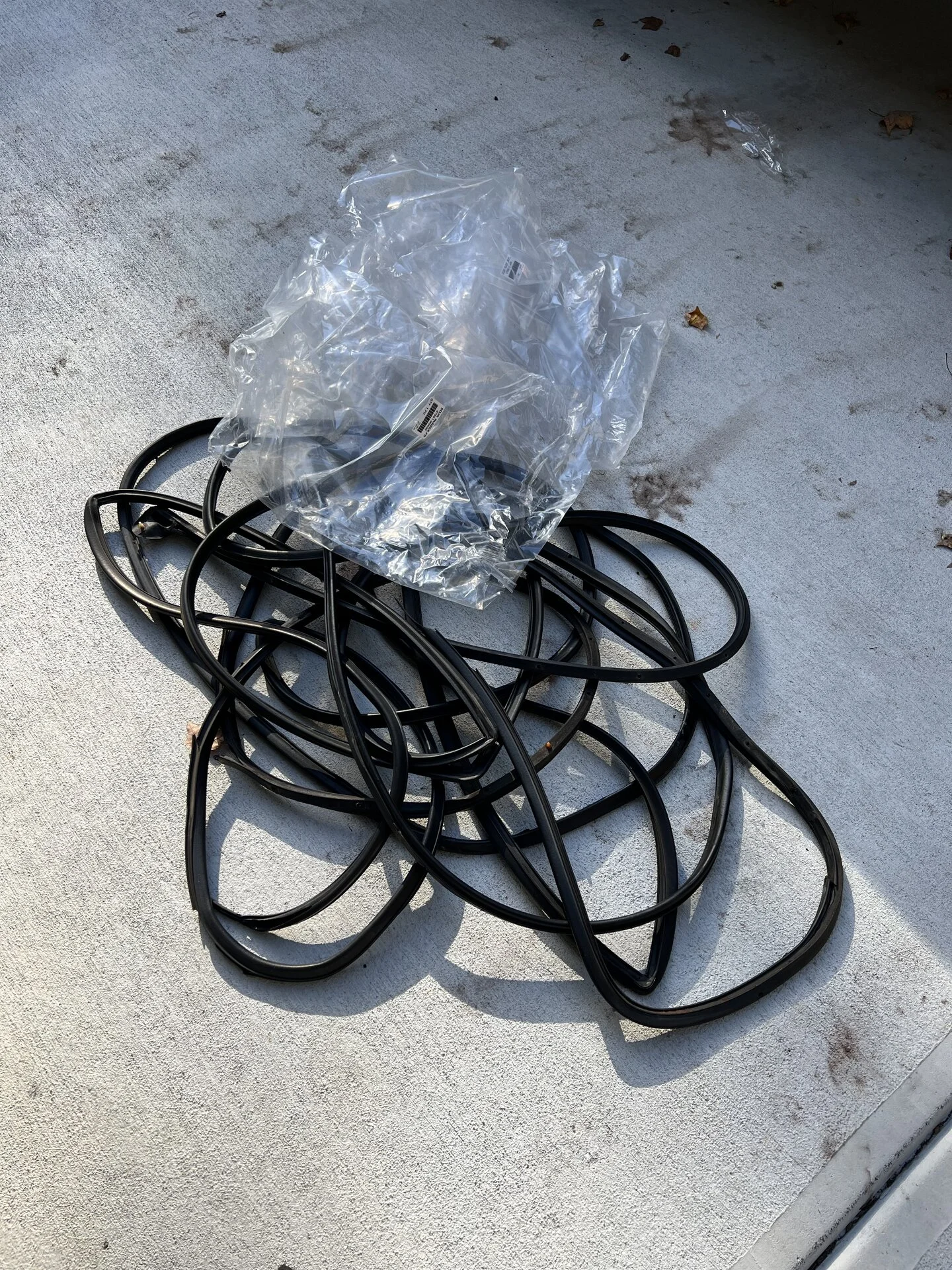

And for good measure, got the City Racer door rubber off the the and spent about an hour replacing that too…
Aside from some mislabeled bags, everything went off without a hitch.

Just following up on this... I drove the 62 for an extended period yesterday and needed to get gas (as usual) and with the new Charcoal Canister, there is ZERO woosh when the gas cap comes off and I haven't noticed any "bubbling" sounds after stopping the truck... so maybe that problem is no longer a problem...
Radical. I reversed lines for now and that seemed to help. Still chasing vacuum leaks as I’m only pulling around 14-15. Replaced about 90% of the hoses but I may have a manifold leak.

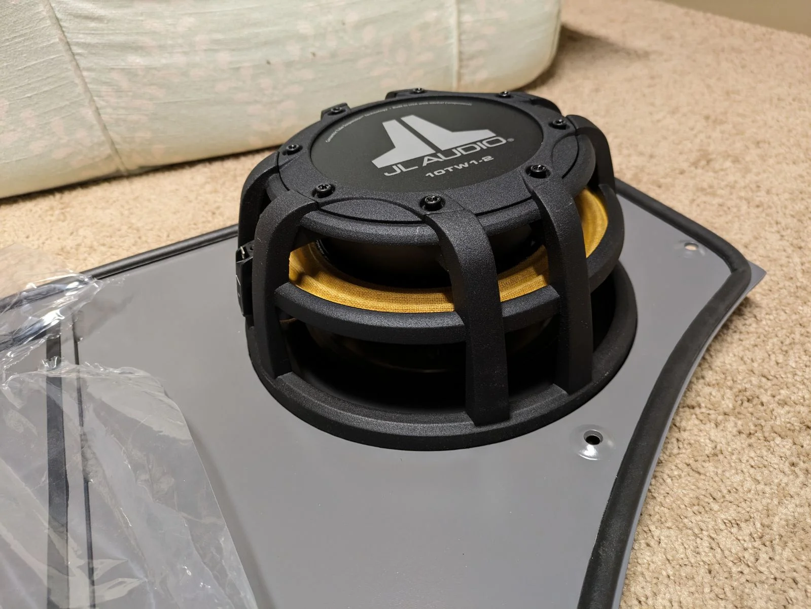

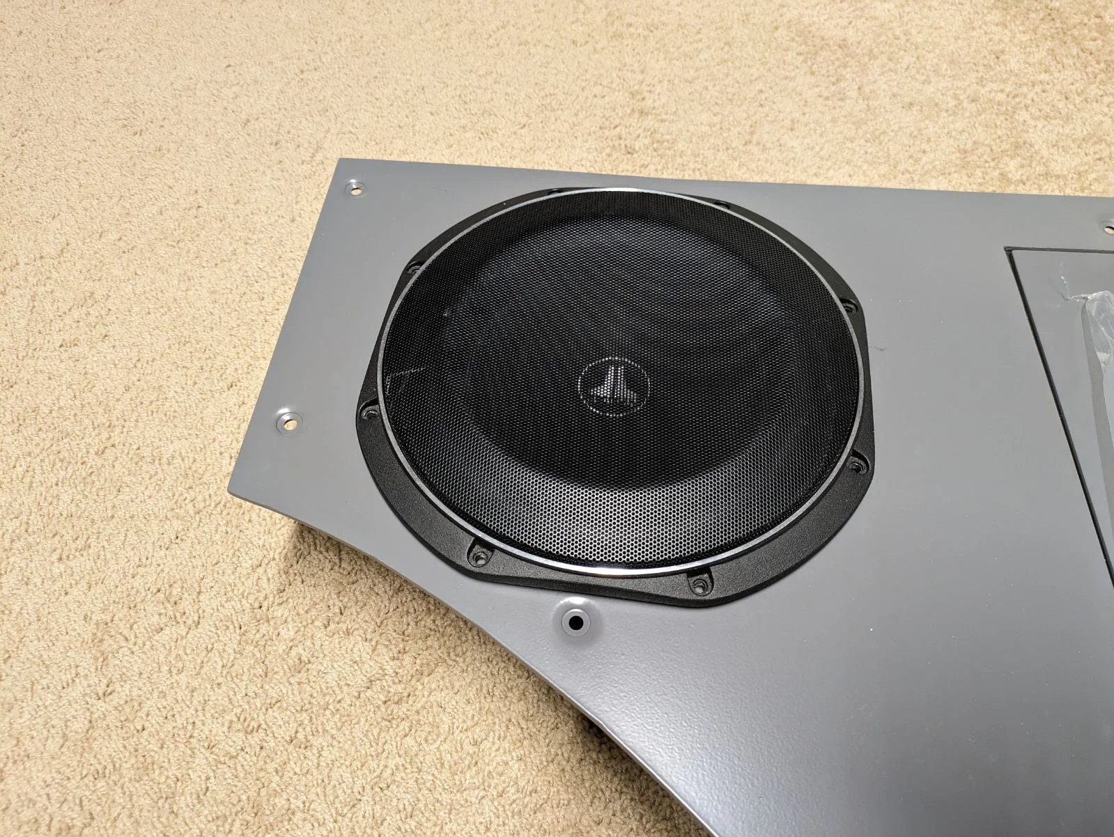

Forst is fitting the shallow JL sub in the rear so I get away from using my kicker sub box that’s currently in use…
