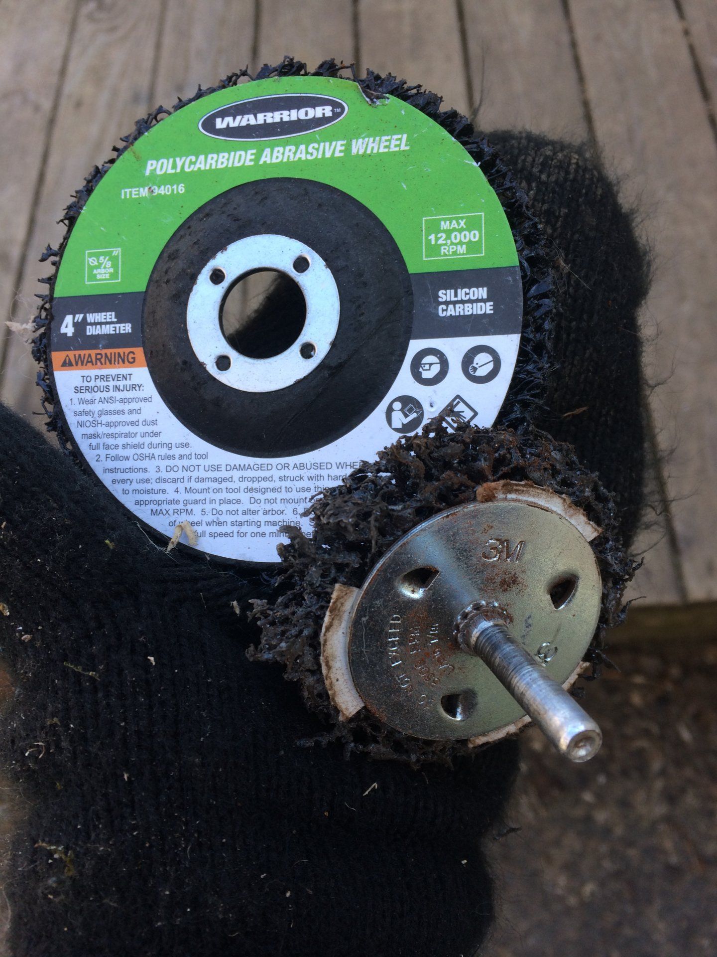

Flap discs are the way to go. Use an angle grinder like he mentioned, I have a Milwaukee which I love. I ditched the handle fast and have learned wellhow to move the guard around. I’ve removed it a few times but it’s really not wise because not only does it protect you incase the disc breaks, it helps slow and catch bits that fly off your object. Buy the larger discs so you have more overlap to get into that little gap. There’s also another funky disc, polycarbide, you can buy that looks like a really hard black sponge. They are supposed to only remove paint and rust. Love those! They come for a drill or angle grinder. As well as you can also use sand paper wrapped around a narrow strip of wood, metal rod or a paint brush handle or something like that. Over time you’ll learn to get creative.

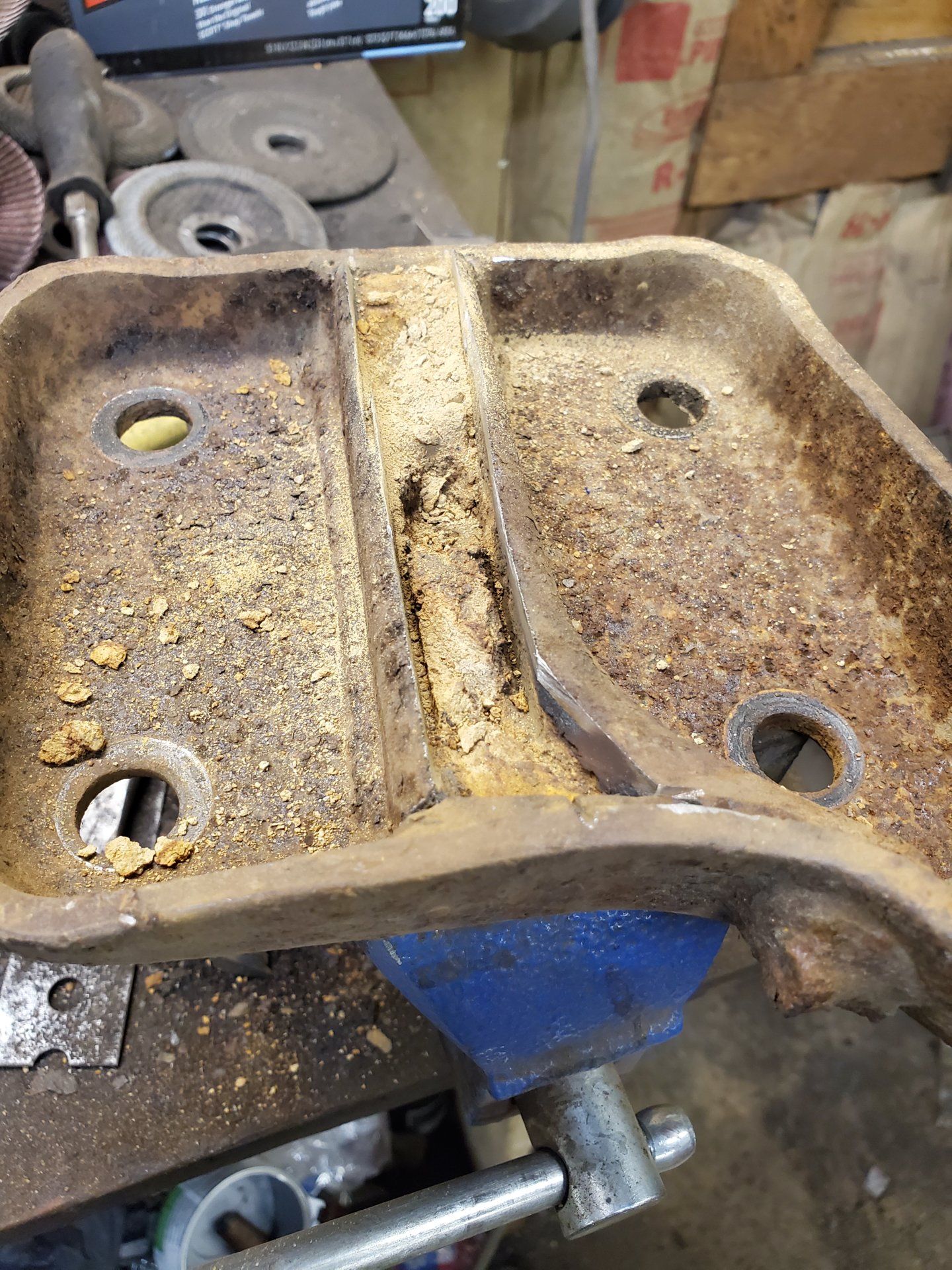

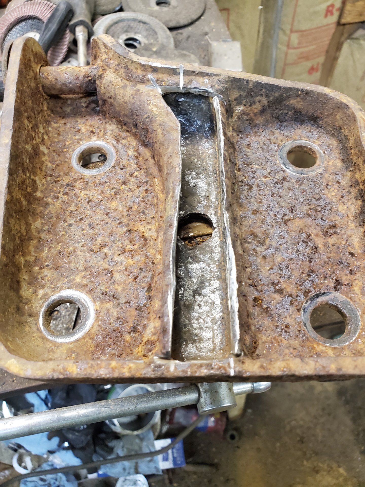

While I wait for the kit to show up I'm wrapping up the frame resto. One of the things that need attention are the spring mounts. I've found that the front and rear are practically designed to rust. They have a cavity on the bottom that will trap dirt and grime and rust from the I side out. I didn't take a photo of the rears, but here's a pic of one of the fronts I'm fixing. I cut open the cavity, clean it out, get rid of all dirt and rust scale, rust proof it and weld it back up. I'll add a photo later after I weld it up.

I’m blanking... this a 62? Those spring perches are STOUT. Mine on my 60 don’t have the channels but very heavy chunk of metal. I dipped both of mine in Evaporust, wire brushed and coated in a mix of rustoleum and linseed.

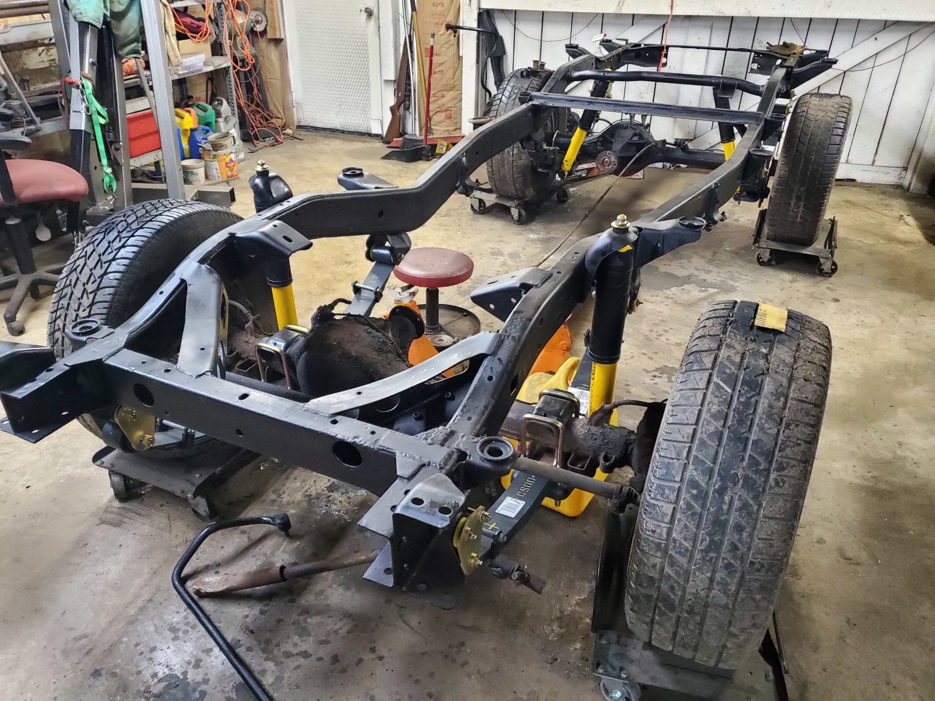

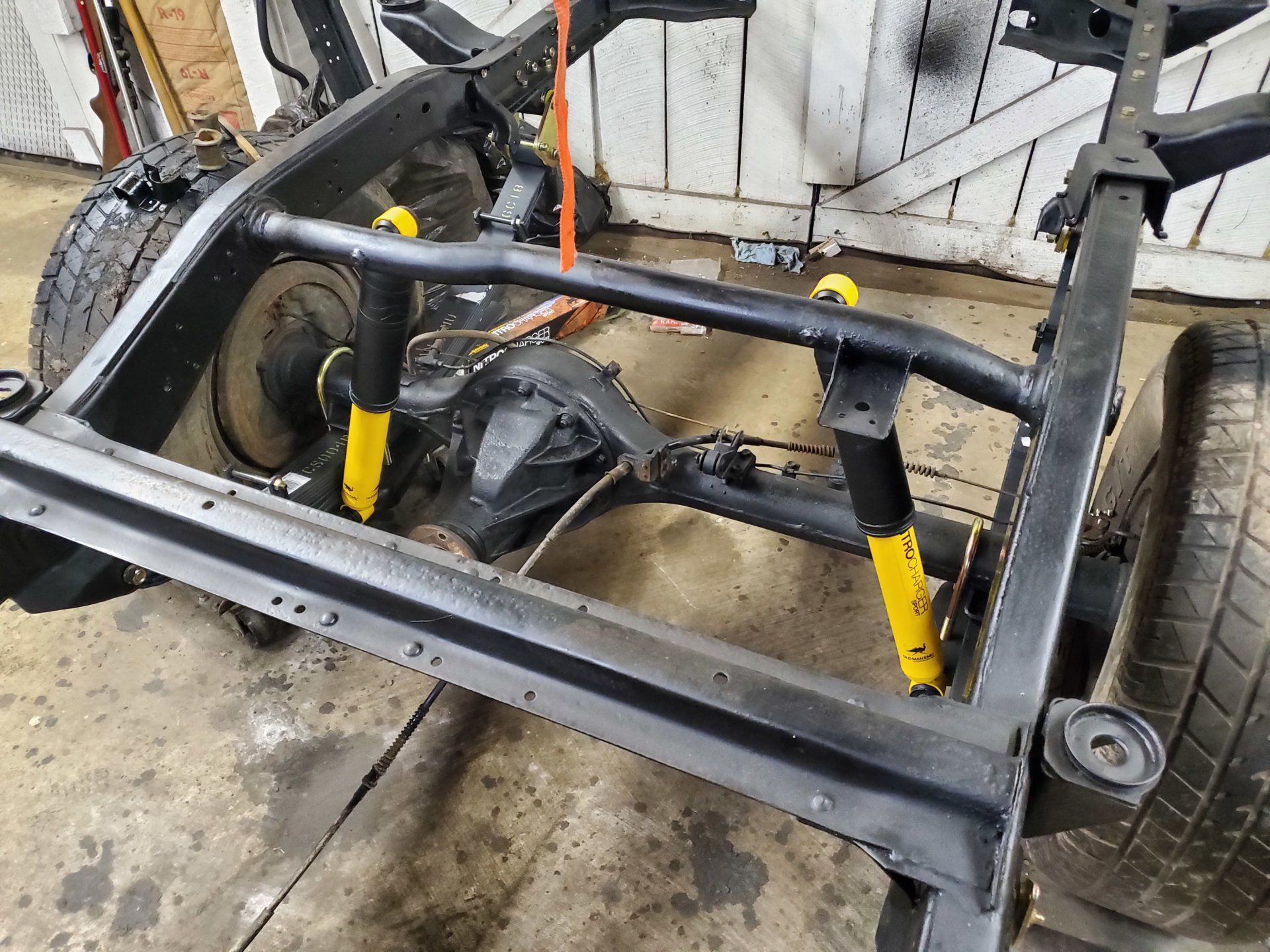

Small update just to let you know I haven't bailed on the project. Its riding weather now and I'm planning a big bike trip way up into Canada/Alaska in about 10 days. So that's taking most of my spare time. But I've gotten the axles mounted again and all the new suspension bits on the frame. The front axle will be power washed and painted the new seals put in when I get back to devoting more time to the project.
