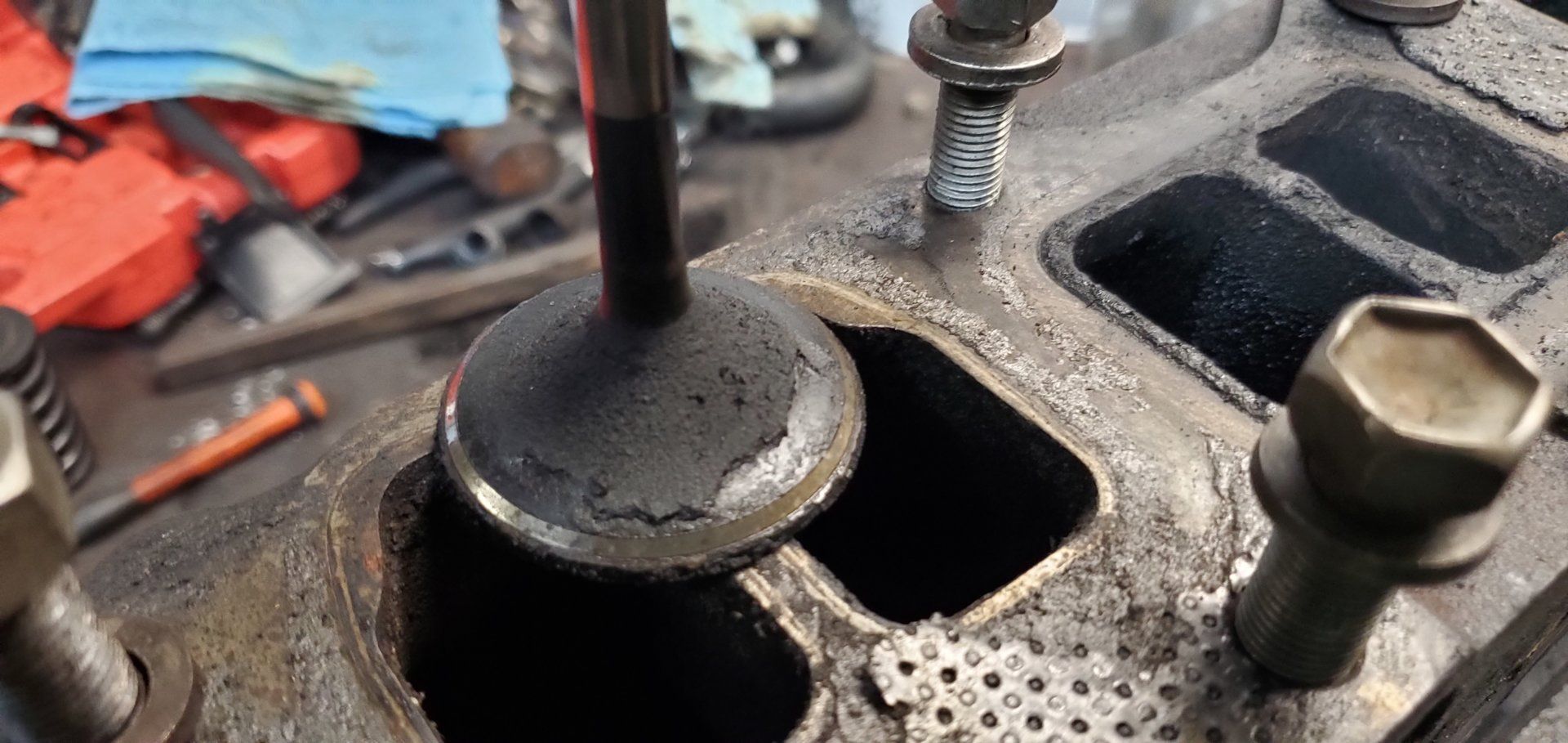

New valve guide seals and cleaned a wee bit of carbon buildup off the valves. I'm betting the carbon was from the rock hard valve guide seals seeping oil

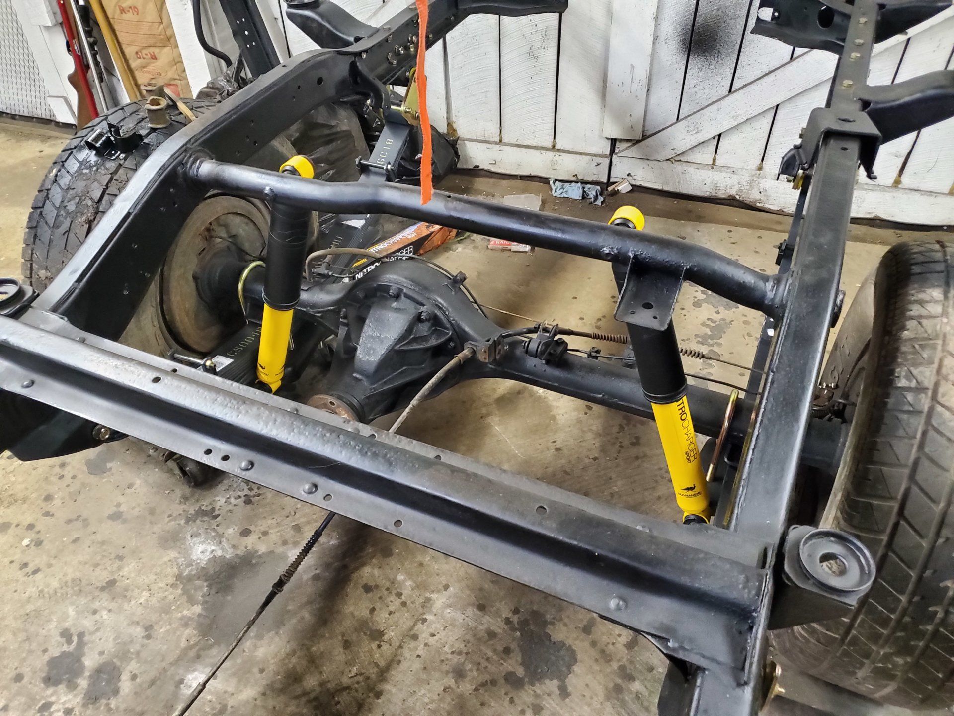

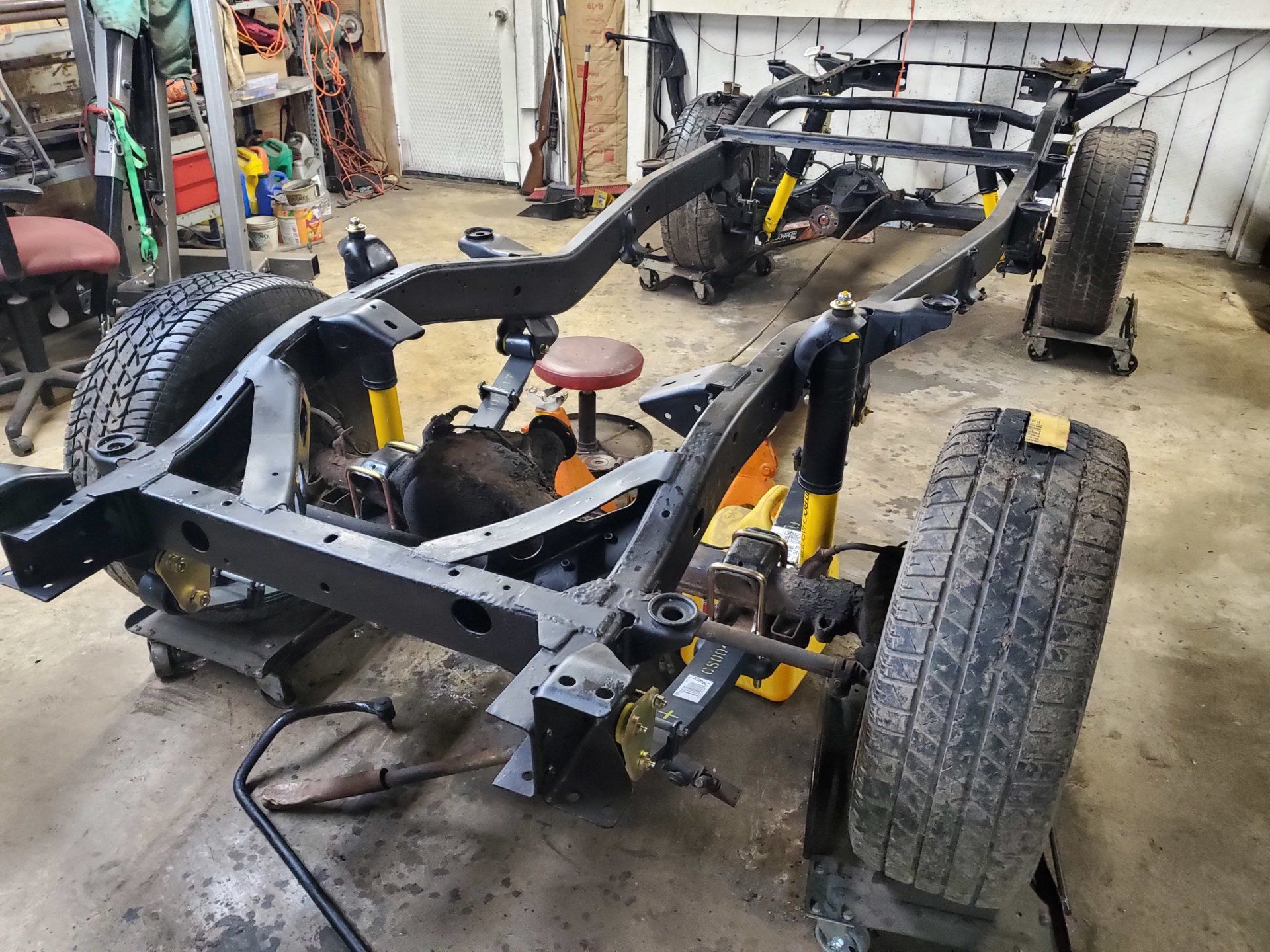

So I got all the suspension and steering bits buttoned up. Also got the driveshafts back in and welded up the last of the frame repairs. For the frame repair I used 3/16ths plate cut to fit the gap where I had some rust the needed to be cut out. Now the frame is fully skookum.
Next I'll get the exhaust sorted before I put the tub back on the frame. Oh,almost forgot, I replaced the rear main seal. Waaaaaaay easier now than later.
Small update just to let you know I haven't bailed on the project. Its riding weather now and I'm planning a big bike trip way up into Canada/Alaska in about 10 days. So that's taking most of my spare time. But I've gotten the axles mounted again and all the new suspension bits on the frame. The front axle will be power washed and painted the new seals put in when I get back to devoting more time to the project.

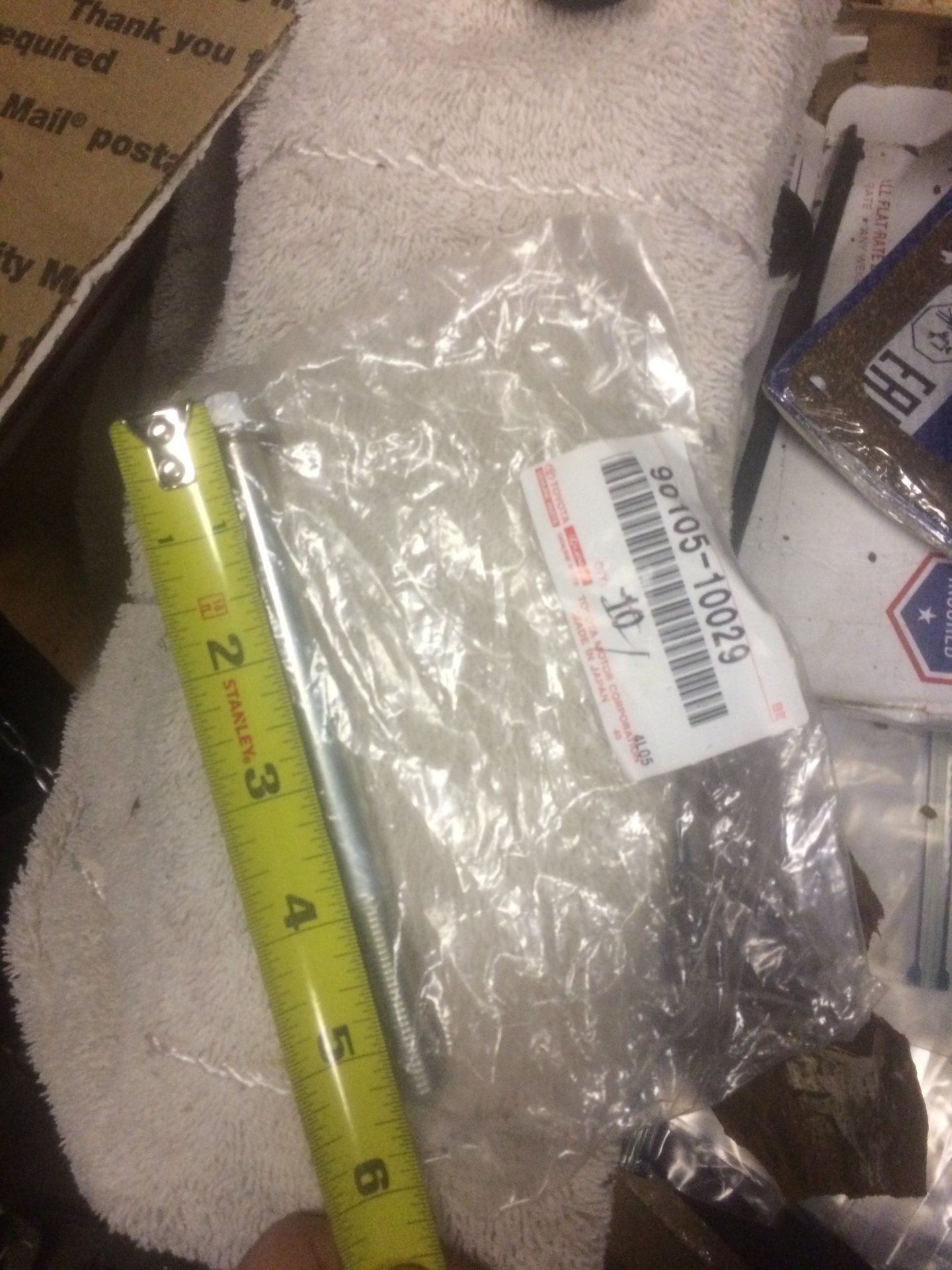

Being able to walk around in my shop again is a glorious thing. I do have a slight problem though; I bought new poly bushings and 1" body lift pucks from 4x4labs, but I'm not entirely sure I got the right hardware. The picture below is the longest of the original bolts next to the longest of the new and a tape measure, the new ones are actually slightly shorter than the old ones. Whiskey Tango Foxtrot over? What say the horde?

Regarding the body mount hardware. That little 1/4" difference from the longer new one to the stock isn't a big deal. I definitely wouldn't use the much shorter ones.
So I emailed 4x4Labs last night and got a prompt reply that confuses me a bit. I asked if I did the install wrong or needed to have ordered another hardware set for the kit I ordered:
This is because the factory bolts have extra long thread while commonly available bolts have much short threaded portion. If the bolts were as long as stock, you would run into the problem that the nuts would bottom out where the threading stops. And with the poly bushings, having a shorter bottom portion than the OEM rubber bushings, this bottom out would be the case. Thus we do ship a slightly shorter bolt with the poly bushing kits to account for that issue. It appears you have the proper length bolts 5" and 4" that we typically supply for the 1" w/ poly kits on the FJ62.
That being said, it's not uncommon for a vehicle to use a slightly different set of bolt lengths that what we designed the kit for and have been supplying parts for (our FJ62 base model had working bolt lengths of 3.5" and 4.5". Usually pops up once every year or two that some vehicle comes along that has extra long bolts from the factory because of some change in the way the bolts pass through the floor of the body or the frame bracket or something like that. If that's the case, its not an issue to swap out bolts with something longer:

So is he saying not all bodies/frames are same from the factory?
Maybe he means other brands... :) is just point blank tell him you got the wrong size and include the photo.
Have you tried installing one to see if it will work?
