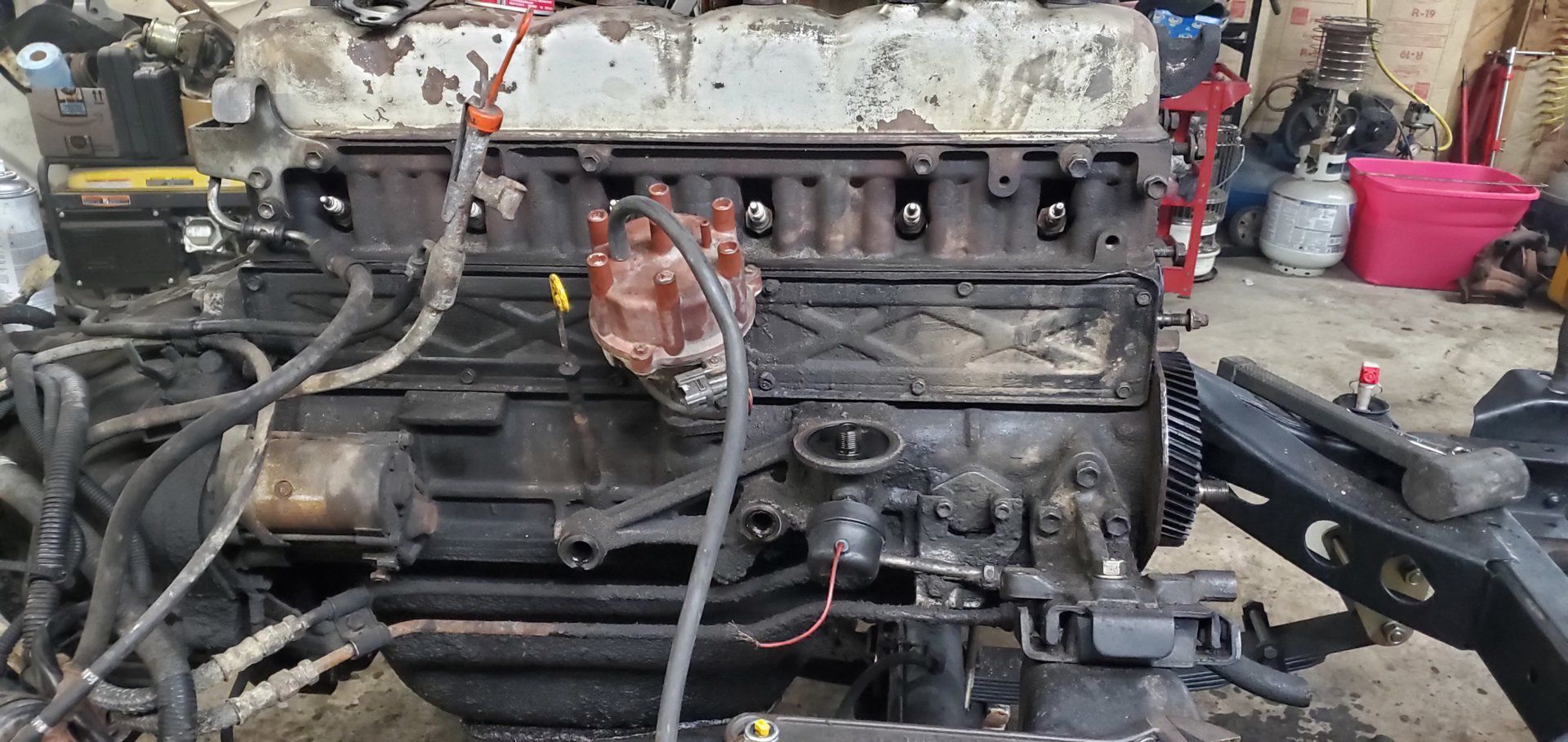

Started the process of stripping down the engine to get it cleaned up. Removed the intake so I can remove the smog tube and plug the holes with some metric stainless bolts like I've done one other vehicles when I found some highend redneck enginerding. If you ain't got no harness clamps, Romex'll do.

The engine is a greasy dirty mess, and appears to be seeping oil from a couple areas. Looks like I need to get a gasket set and swap some of these out. Anyone recommend a particular set? I don't need a head gasket, but if it's part of a set that's fine.

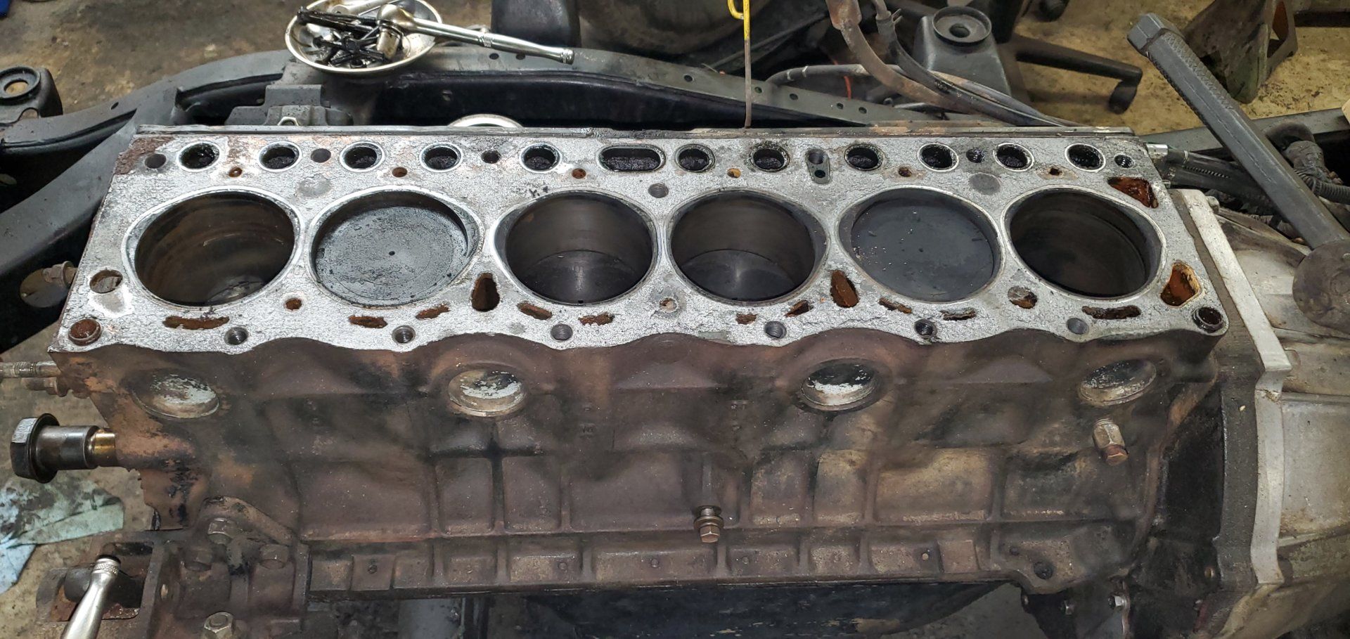

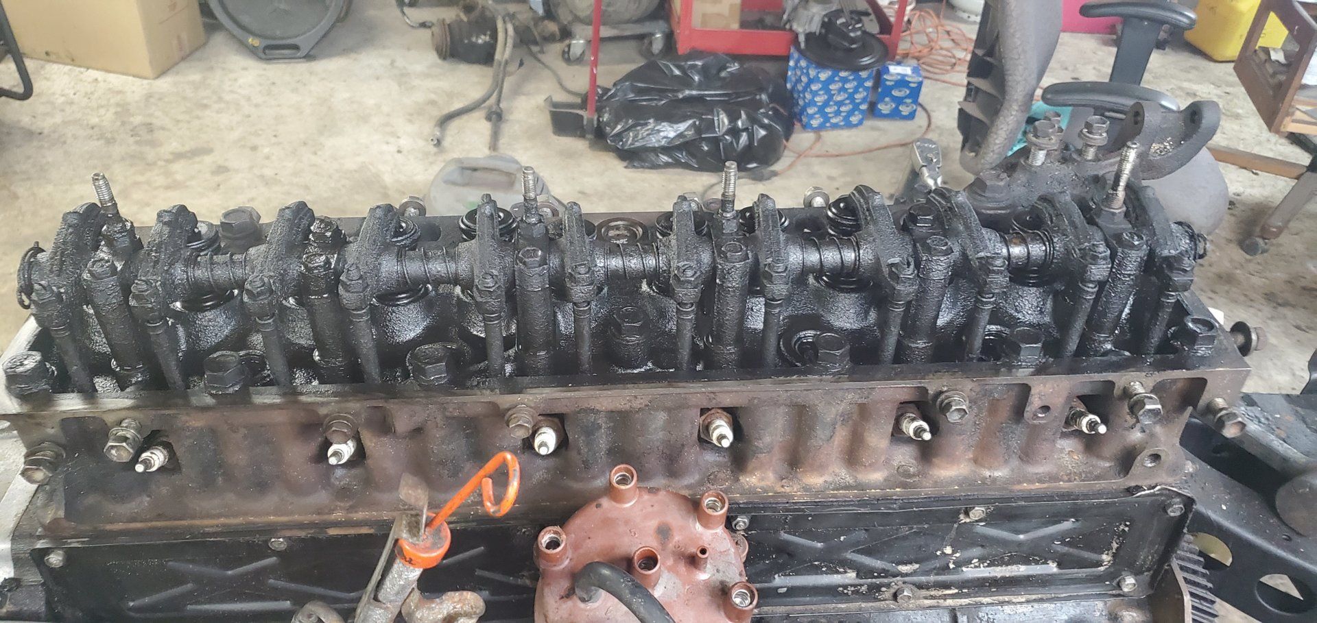

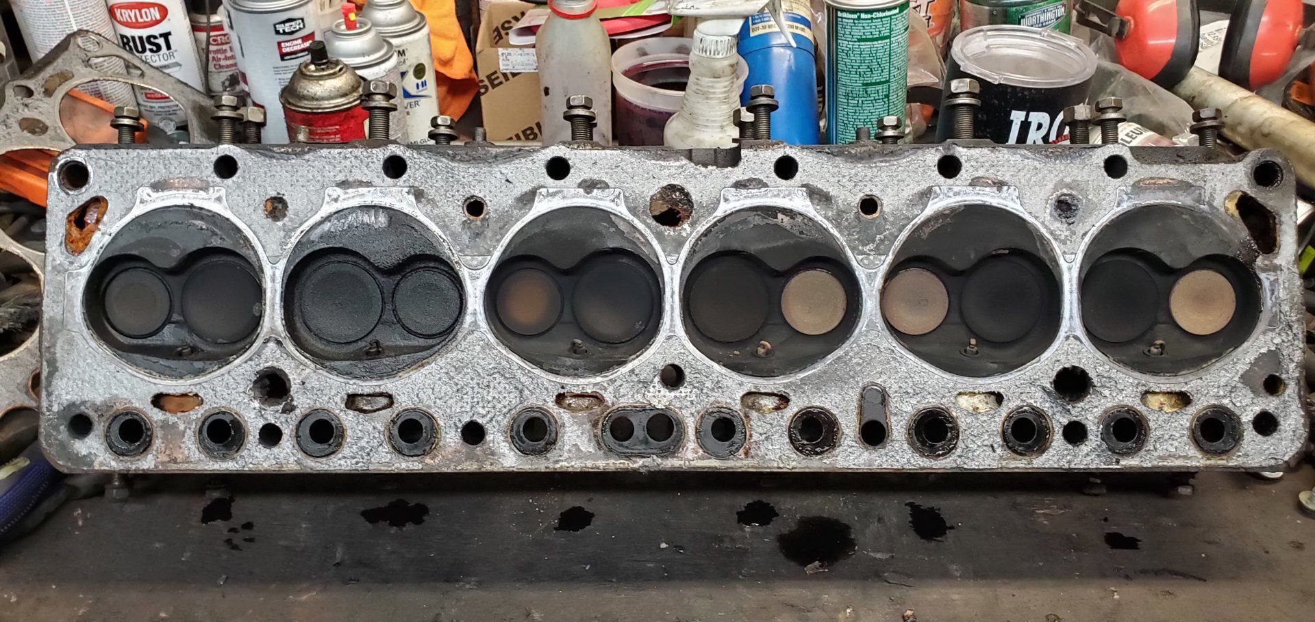

What a greasy mess! I thought all this was from a leaky valve cover gasket, but it looks like the front main seal was bad. All the rubber is hard, so a total teardown is on hand. It took a couple days of scrubbing to get through the 1/2" of muck in places to even find the bolts to disassemble. Now I've got it all the way down to the head being off. The bores looks good with #2 showing it was burning a little oil. Probably a valve guide seal if I had to guess. I'll be swapping them too. I'll also pull the transmission and replace the rear main. Don't want to have to do that one down the road. This feels more and more like I'm still falling down that rabbit hole. I'd like to hit bottom so I can starting climbing out!

I don't think you have hit bottom yet gotta ways to go but the climb out shouldn't take long lol keep it up man

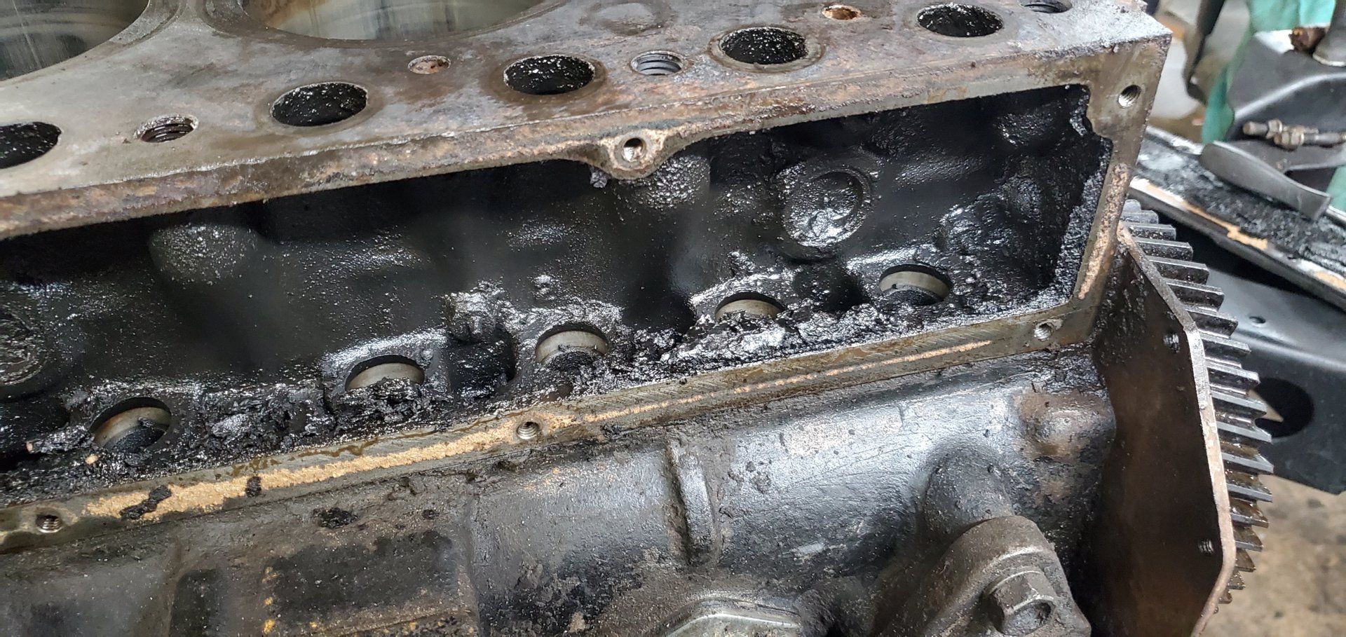

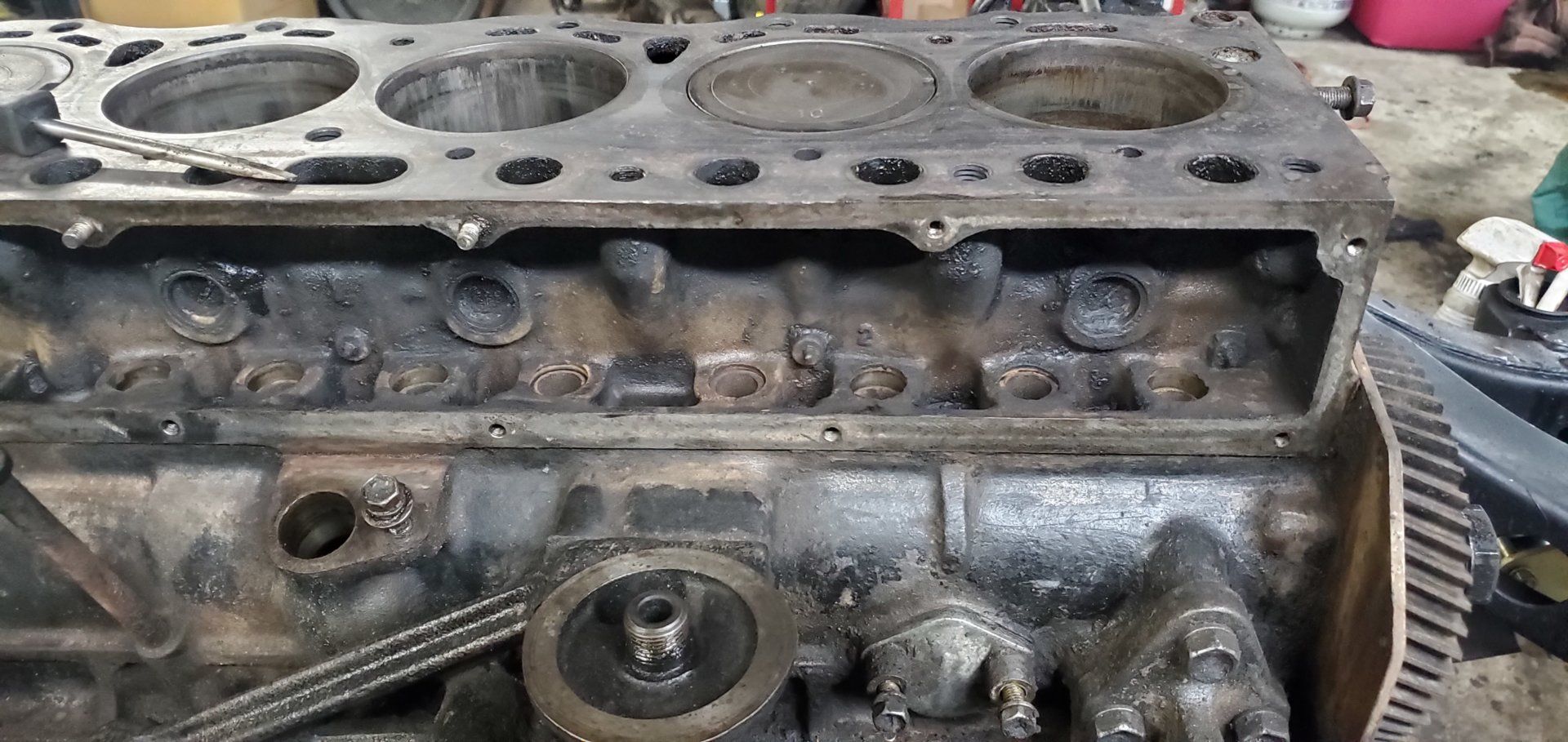

Still cleaning and tearing down. The pushrod cover was crazy dirty. More oil buildup than I've ever seen.
A shopvac, brake cleaner and a wire brush does wonders though.

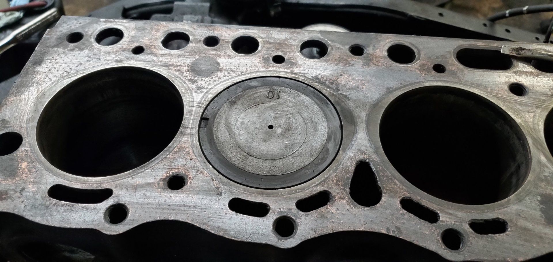

I've got the deck and piston tops clean. I'm wondering if the 10 on the Pistons are stock, or if these are oversized?
It definitely looks like the head has been off once at least.
Did you pull the lifters out? With that much scraping, I definitely would, and wash the lifter bores down into the pan.
Thats a bit nasty looking. My BJ74 with 300k miles wasn't even close to that dirty/oil sludged. It looked more like your after picture.
Probably one of those we never changed oil, we just added it deals.
Yeah, it was leaking out the front main and valve cover gasket they figured they didn't need to? It's not like this truck was the epitome of maintenance elsewhere though....
@GLTHFJ60 When you say clean the lifters, am I right in assuming you mean clean out the pushrod buckets? Because removing them looks like a real bitch.
Pushrod buckets? do you mean the lifters?
