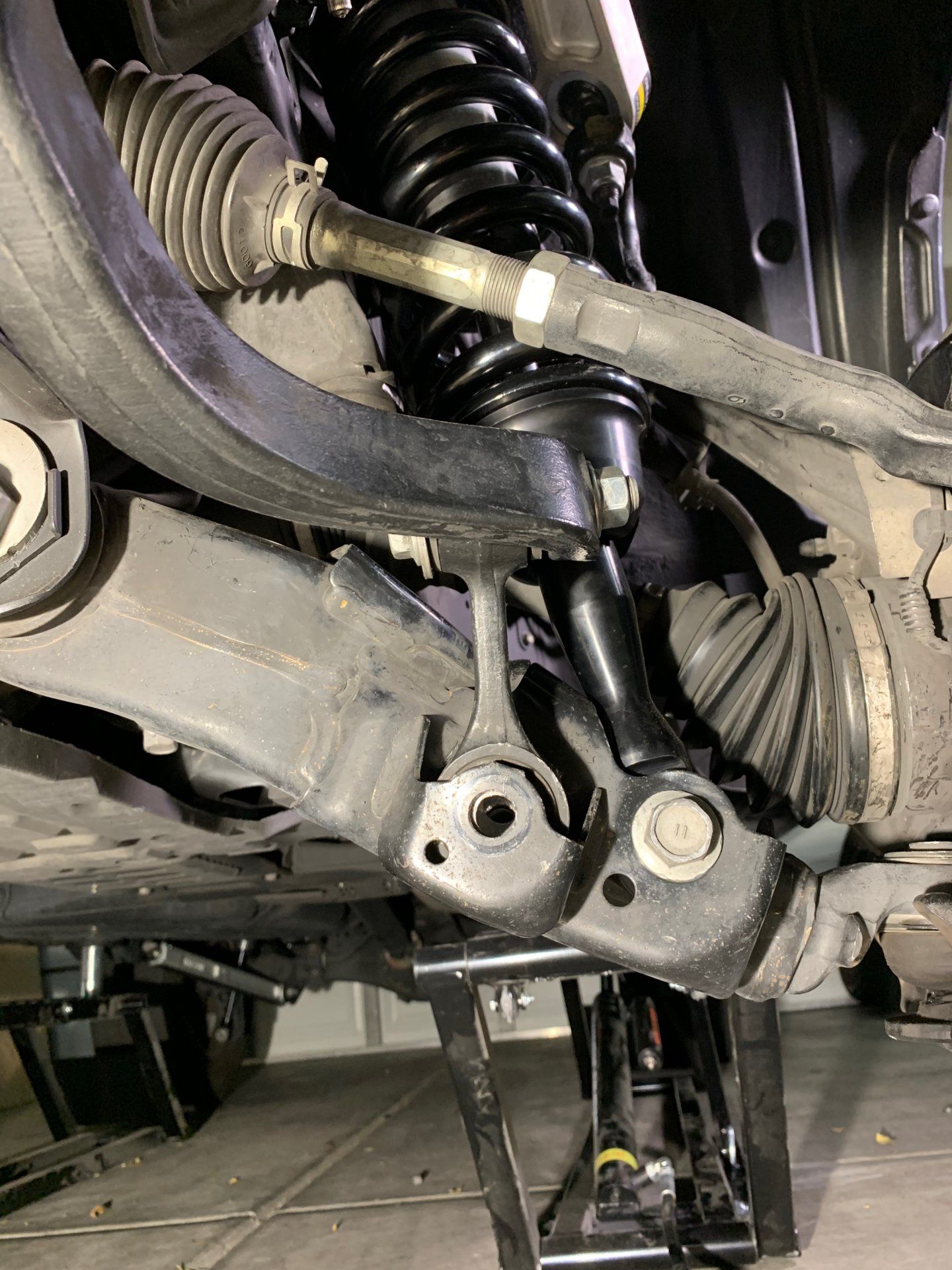

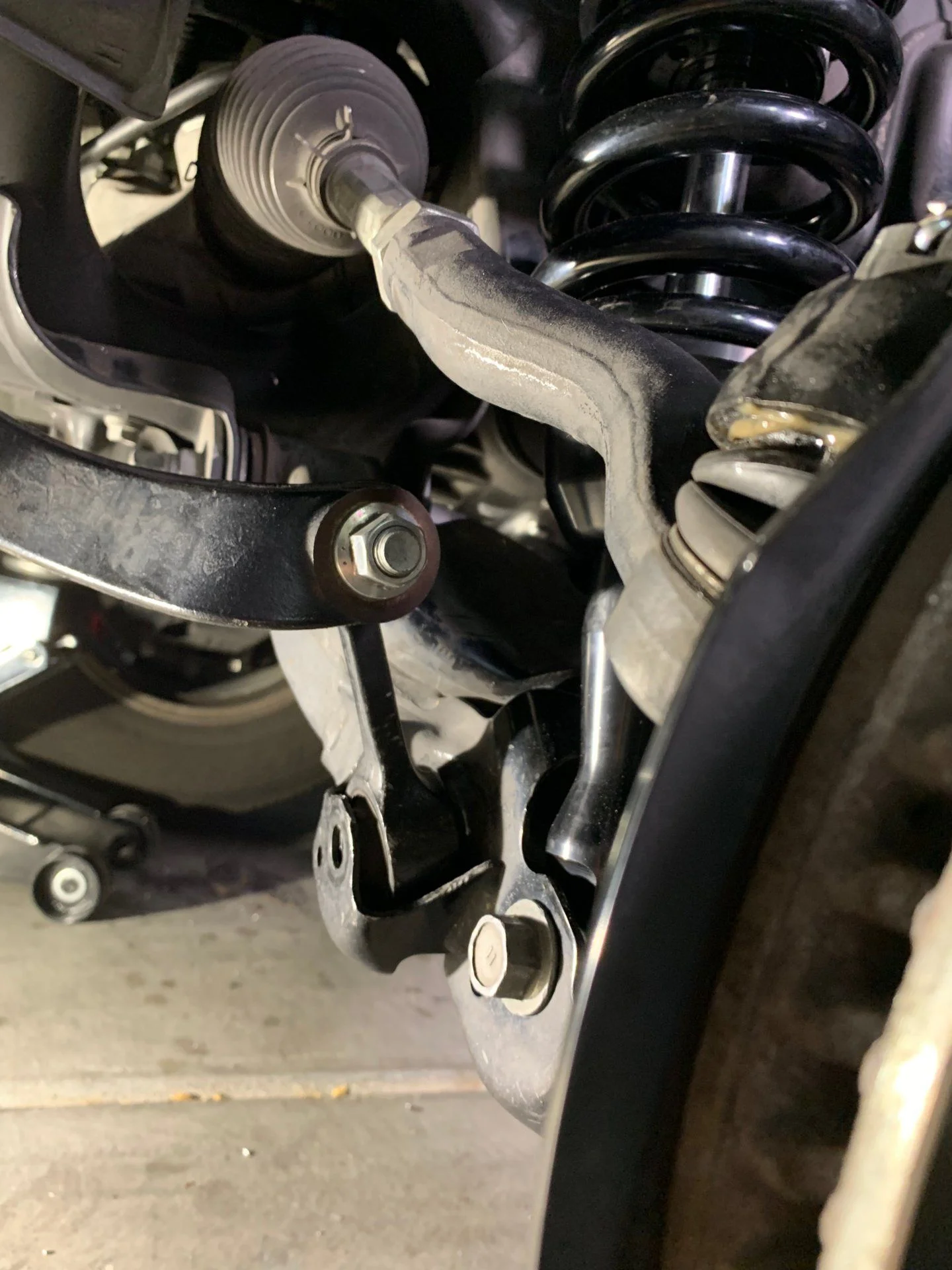

Unfortunately, the holes are still not aligned. I can get the front of the holes to line up but the back of the holes don't.
This is the angle of the link and what I'm dealing with.

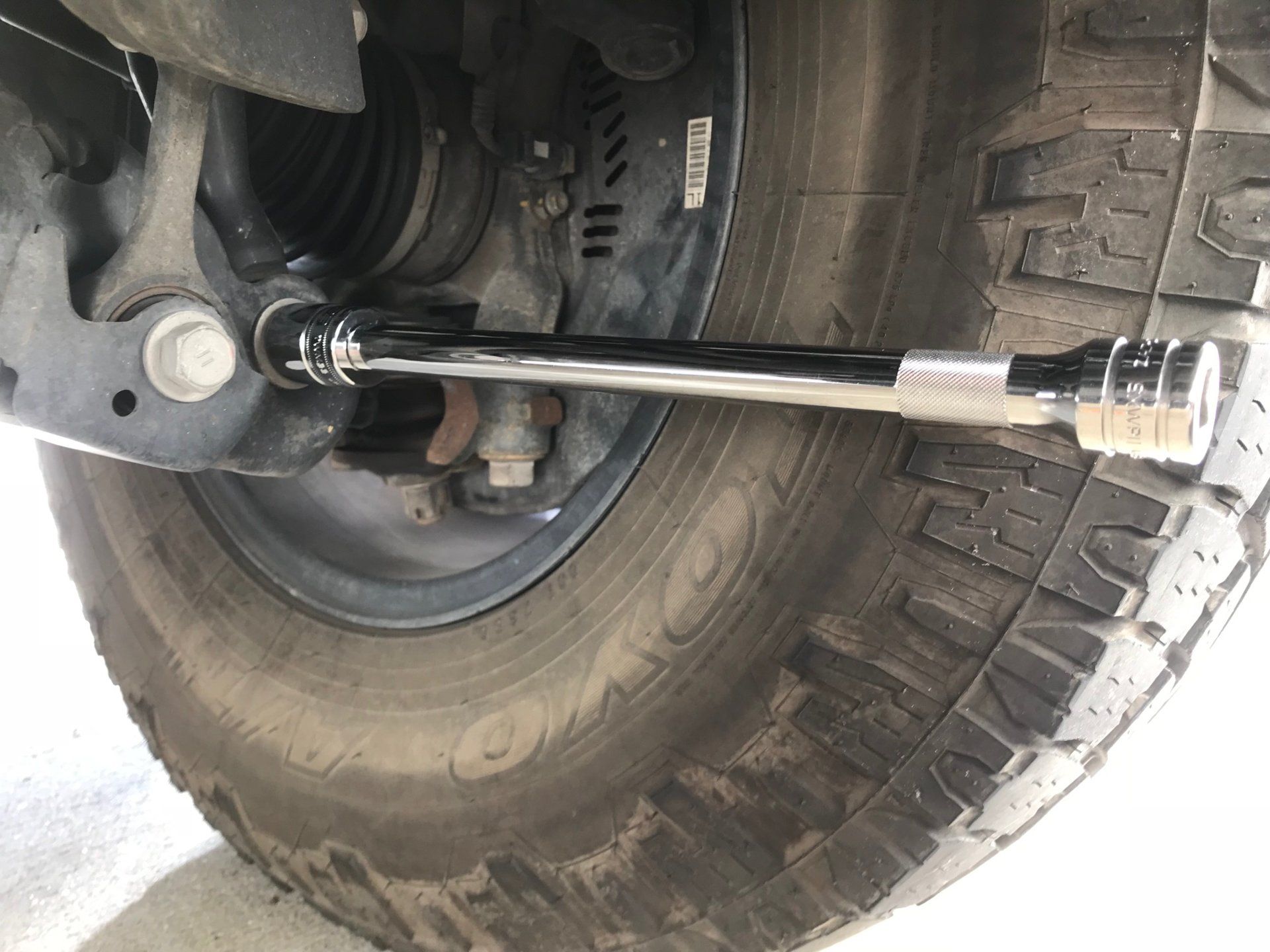

That's a rubber bushing; it'll probably never realign on it's own. Using the pic as an example, I'd use a 1/2" 6 point socket and long extension to leverage the factory bolt once you've got it pushed up against the surface where the threads start. Then use the ratchet to turn the factory bolt.
You can get a lot of leverage on a big bolt like that by hand. Basically aim using the extension by hand and turn with a ratchet.
Pic is just for example using the strut/coilover bolt since I don't have any smaller sockets on me right now:rolleyes:...
