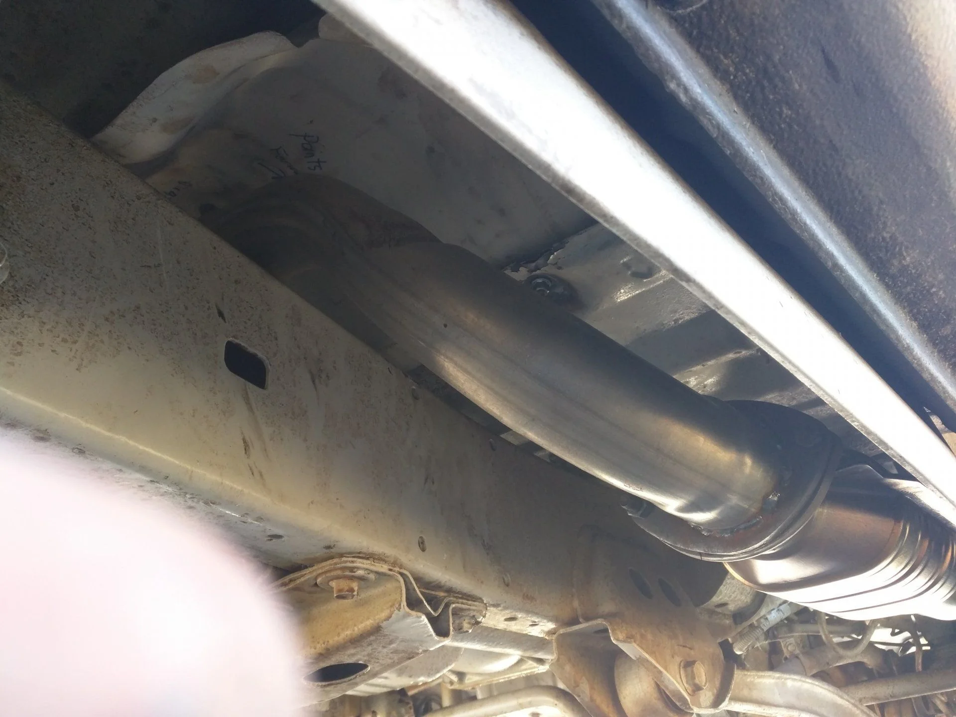

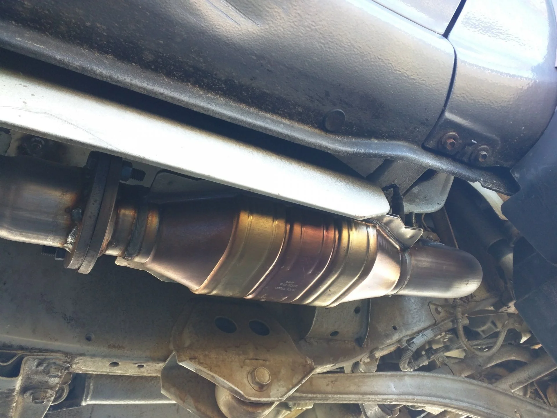

Here are pix of mine. Generic "hotrod" cat from a Ma n Pa muffler shop. I have run it for several years with no problems. It is really short and makes it easier to shape the curved section over the frame. Rig gits wheeled hard and often, so rarely clean sniff to see my custom double heat shields. Greatly reduces heat in passenger floor.
Here's the pix

Pretty much the same thing I have but my generic was probably a bit cheaper. Don't remember what I paid for the whole setup including a new noisy muffler but I think it was under $300. If ever get mine as clean as yours I will try to get pix of my double heat shield setup. It really helps keep the co driver cool on long hot climbs. I also have my laptop stand bolted to the 2 front seat bolts on that side and it also stays much cooler. That's right above the newly positioned crossover pipe. John

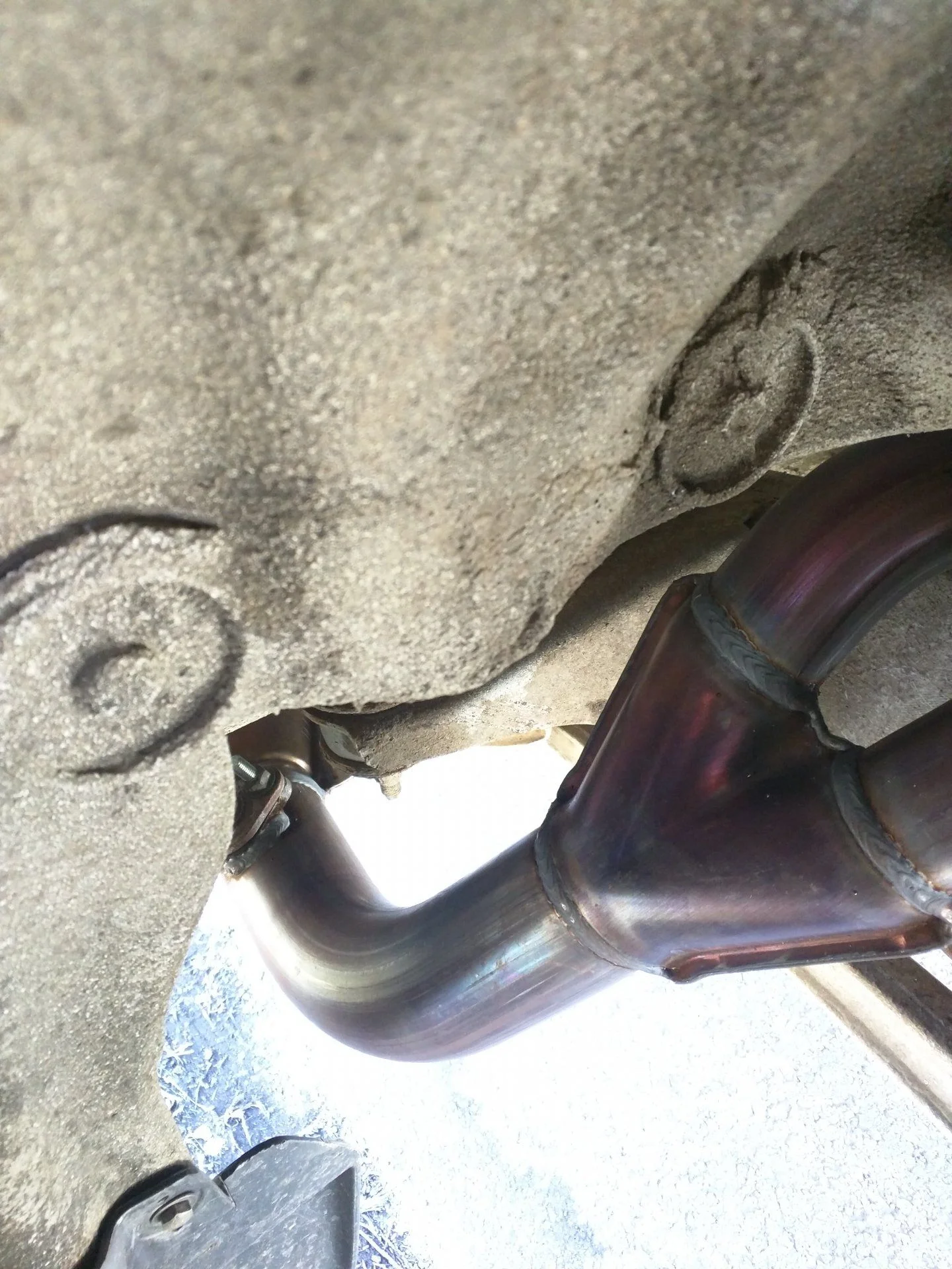

also more pics on the Y pipe going up to the headers - was that welded as it connects up?
My Y pipe is all original. Pix show where cat was spliced in just before the slider cat protection. Double heat shields is just that. I added a second layer of OEM SHIELD in the first two positions.
so on the Y-Pipe connection ; the connector Y 'part' comes from the vendor and then is welded at the top (two pipes) to the original coming down from the headers?
