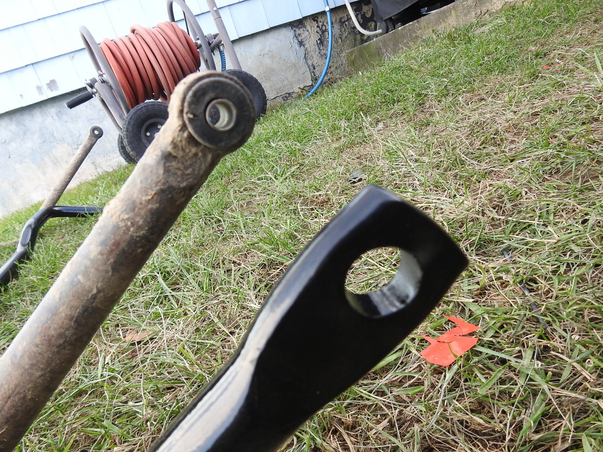

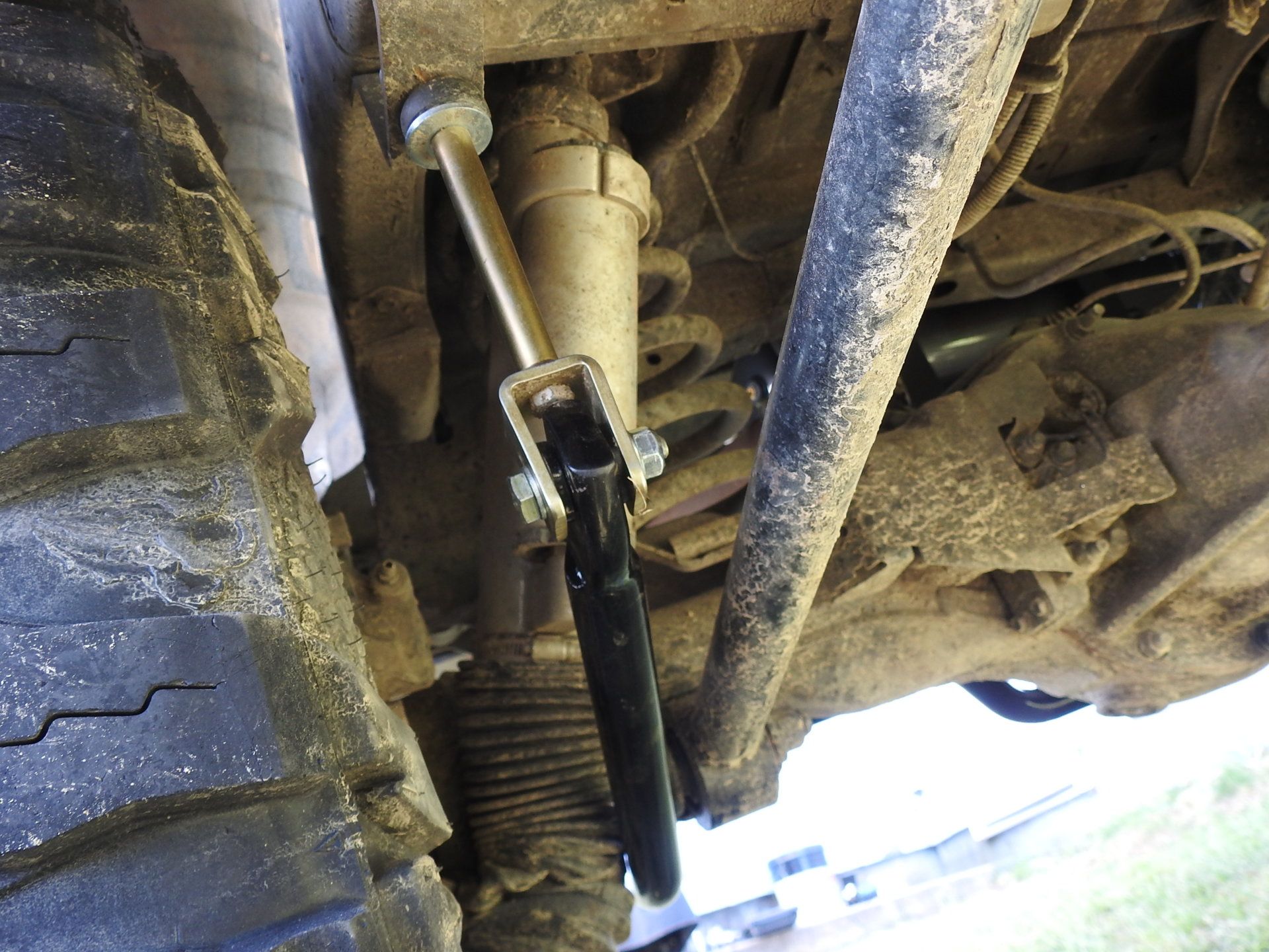

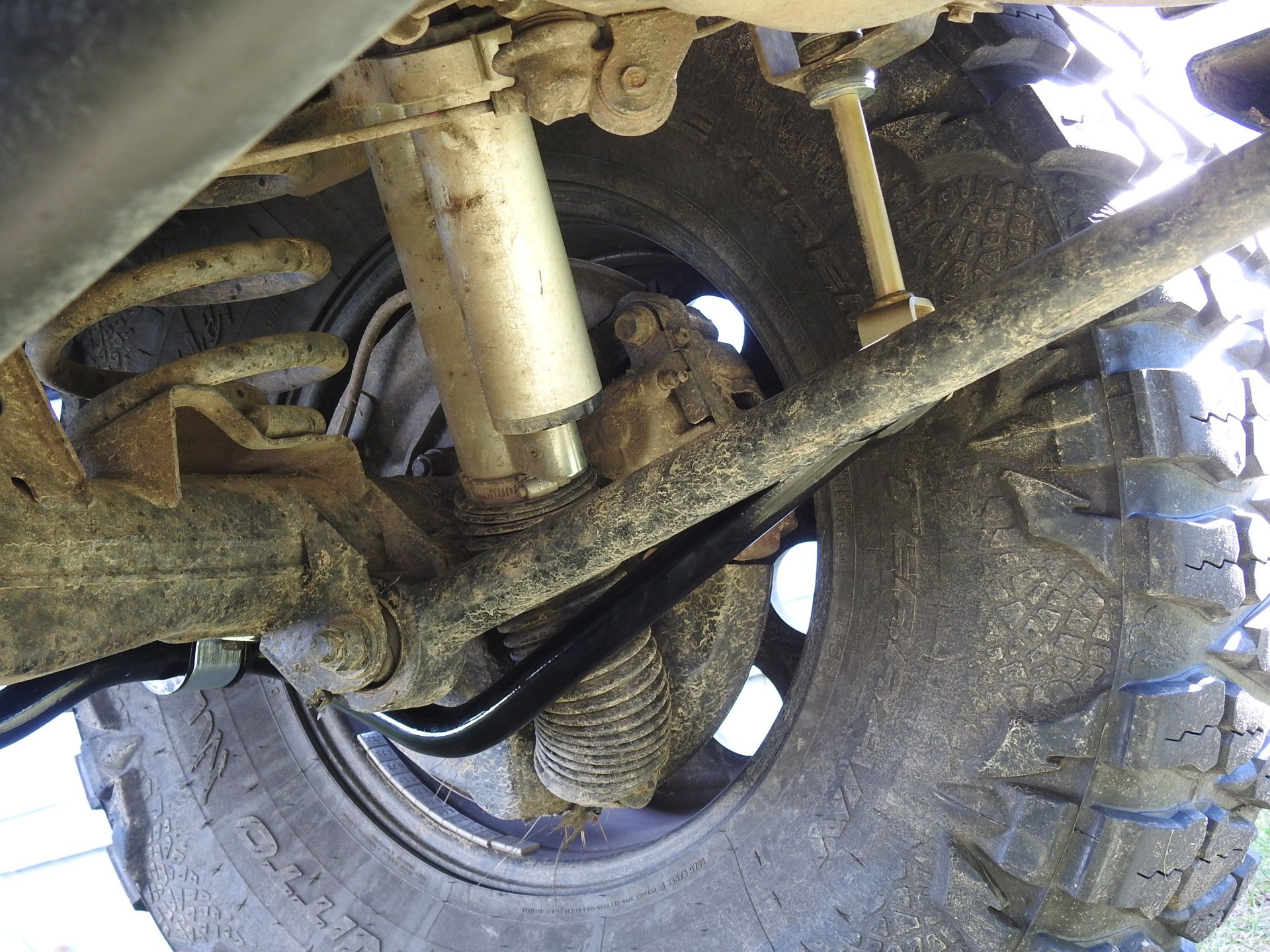

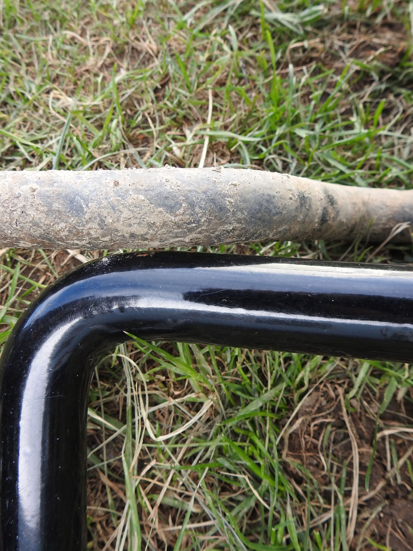

heres a pic of whiteline versus stock and landtank links its MUCH thicker and stiffer. (and yes, yes it is what she said)
I'm more curious if there is any difference between Blackhawk and Whiteline or whtiehawk and blackline this is getting confusing :rofl:
Highly doubt it! Given the low volume of these things I won’t be surprised they all made at the same factory.
Those look like they are the same diameter.
They are not the same diameter, those pics above just aren't good pics for showing the difference. I attempted to use a new set of OEM rubber bushings with my black hawk sway bar and it was a big nope. Had to use the bushings that came with the bar to fit it.
