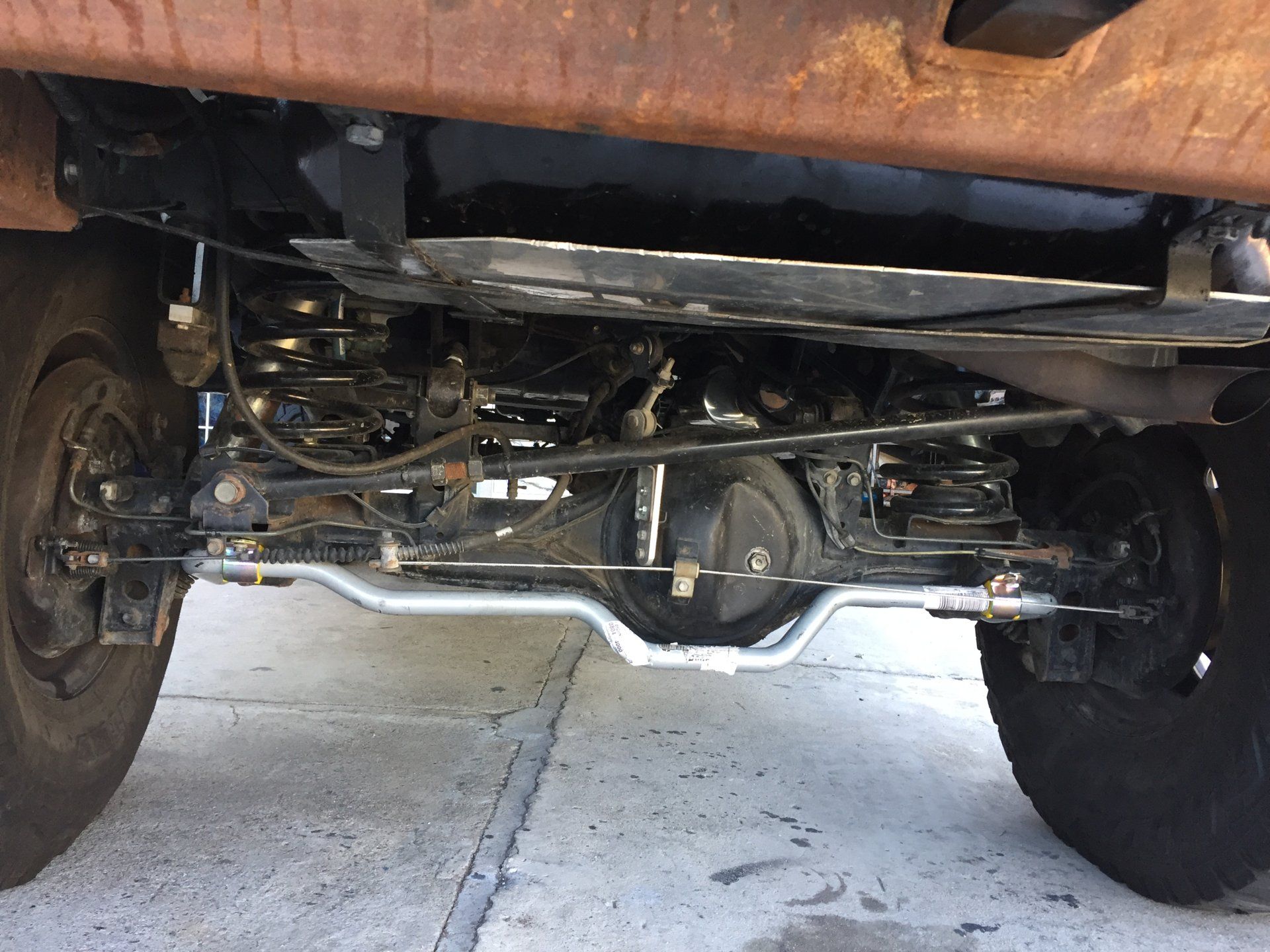

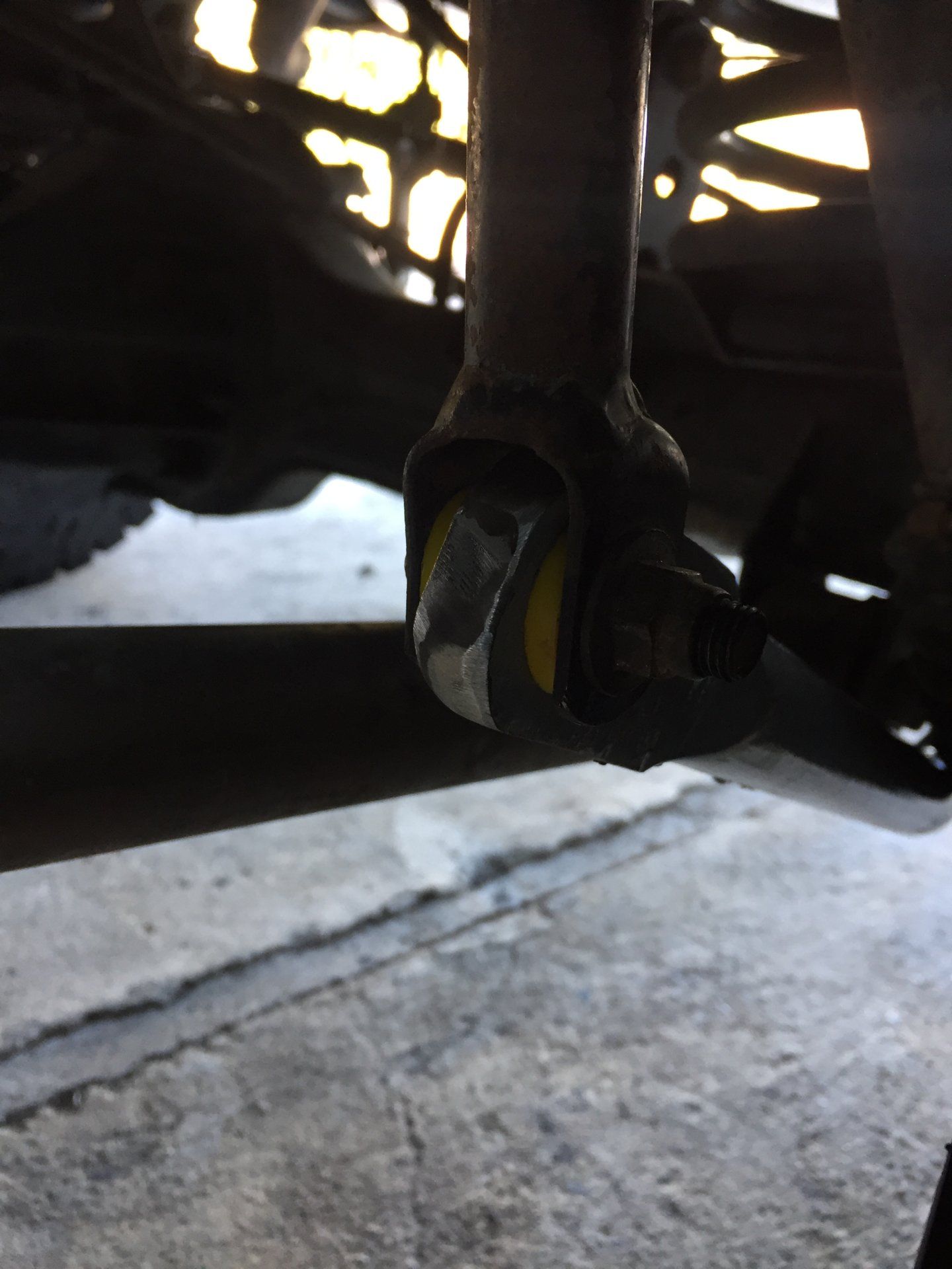

I received the TJM rear bar yesterday and installed it last night. I had to grind the ends round to allow movement with the end links. Big improvement on those twisty roads, much less body roll.
Sexy. Adds a little bling. Wish i had a sub tank like you to go with it! Might want to paint that bumper though, at least be up on your tetanus shot!
I wonder how long it'll last if you keep flexing it out like that
