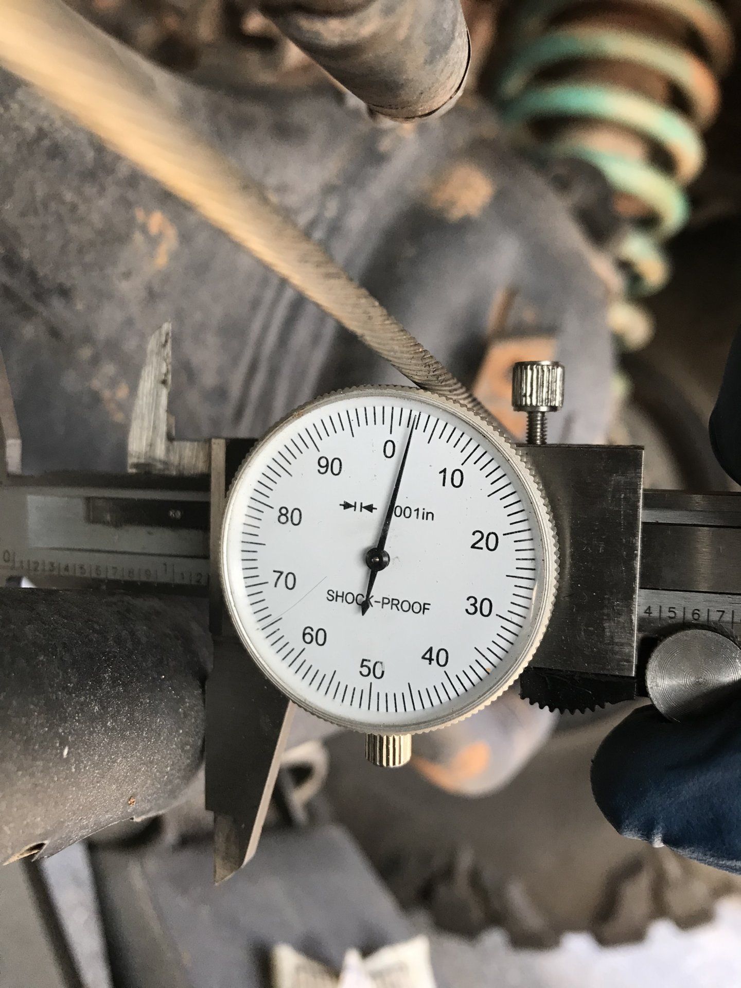

Whiteline 30mm rear
Stock front
Swaybar links optimized
Works great for my set up and weight
With the front disconnected the stiff rear bar tends to push the front end side to side to the point of I dont like the feeling. With that said I really like the feel and the performance of slow speed off road with the front disconnect even when its not technical.

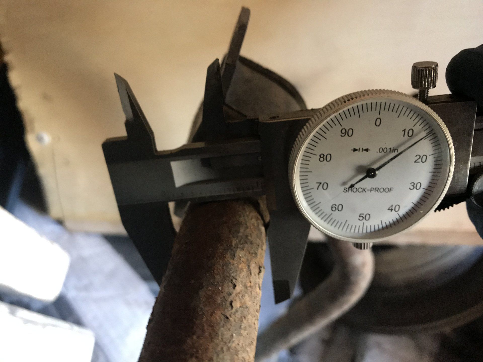

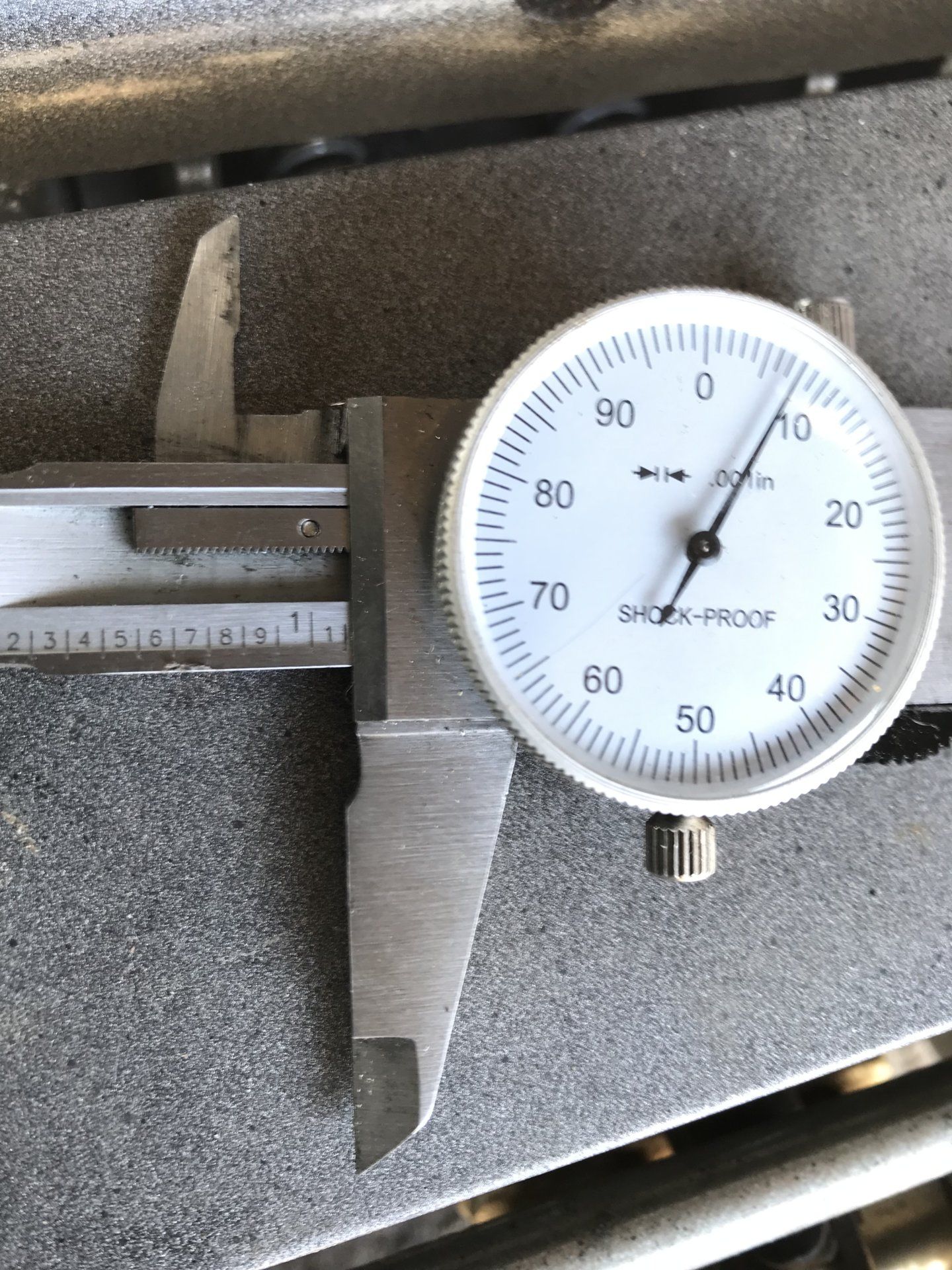

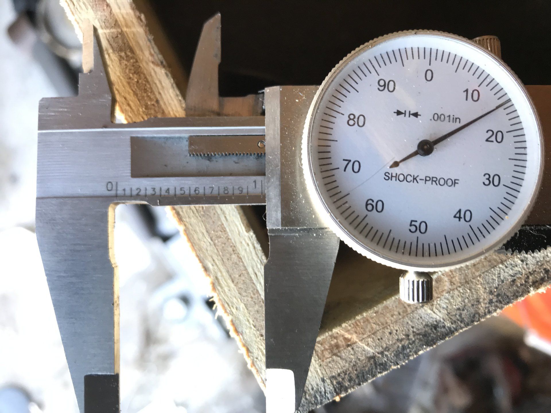

first Two pics white line in rear
Second two OEM SWAYBAR
Ok uploaded first time from mobile here it is corrected
Whiteline 30mm rear
Stock front
Describe what you mean by “pushing the front end side to side”. I haven’t noticed anything like that with the Blackhawk.

I only notice it on the tarmac. More like when the rear swaybar is working it transfer energy to the light disconnected front making it twitchy only going straight. Where as with the front connected it has a much more even straight line and center feel. Normally with my caster at a solid 4° it steers great very flat with no more body roll. With f&R connect because Im 2wd a super hard turn will spin the inside tire rear tire because it become so light weighted. Never before until the HD Whiteline rear. All in all the HD Whiteline for my setup makes road travel much easier and enjoyable.
