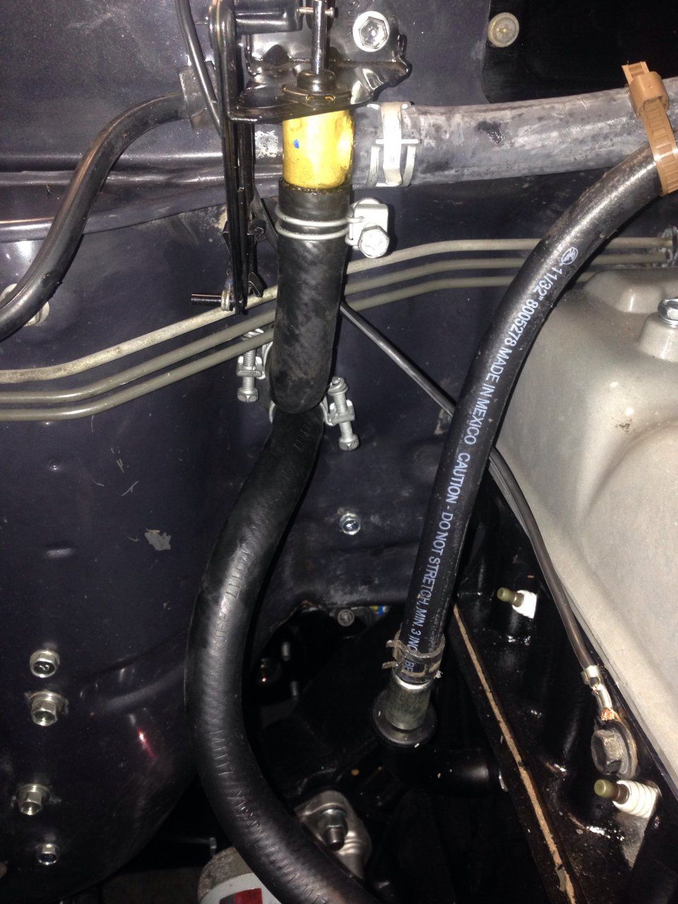

Water flow system done:

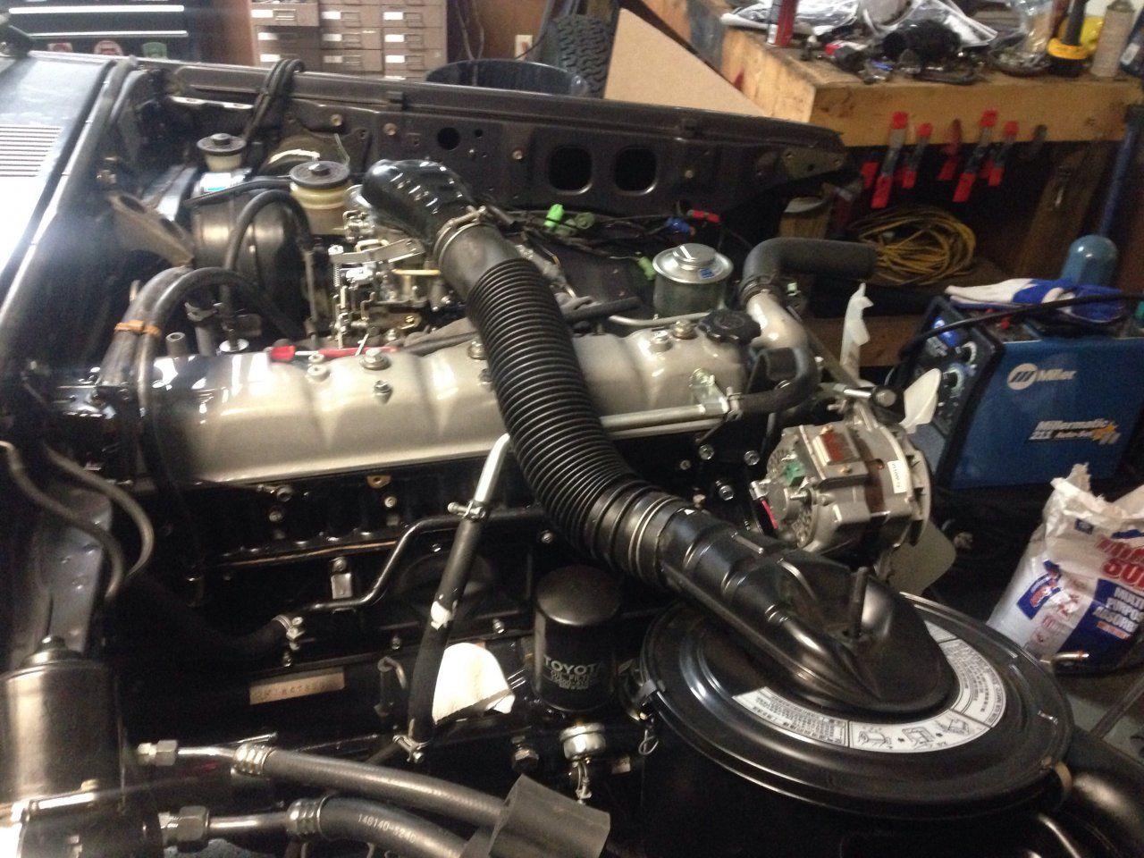

Air cleaner system to Carby installed:
Refrech me... Is that valve cover painted or powder coated?
Air cleaner:
Ironically, was able to use the FJ60 air hose and chop off the ends to make it work using FZJ80 intake hose clamps. That said, it sits right on VC. Might be a heat issue. Planning on fabbing a bracket to lift it off.
PS system done:
And fuel system plumbed. No charcoal canister. The vent line will vent to atmosphere via hose.
