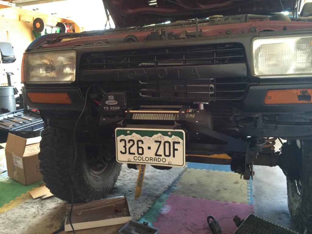

Finished the new winch plate and got everything installed this morning. Actually wasn't too bad, and I should have gone this way from the get go.

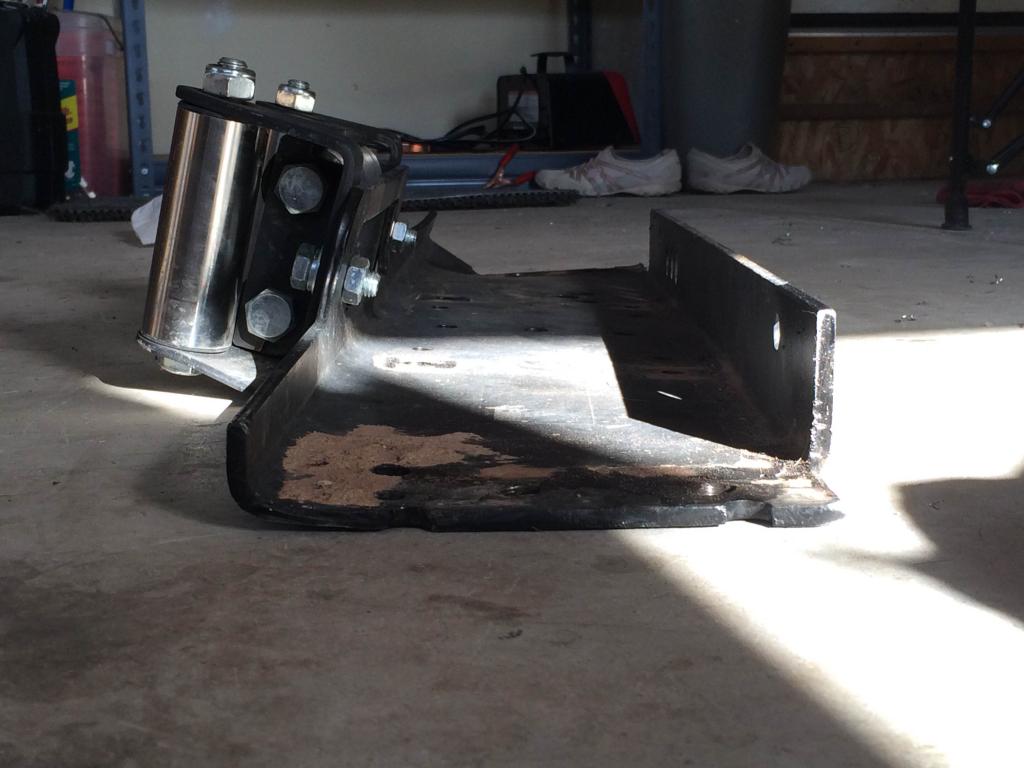

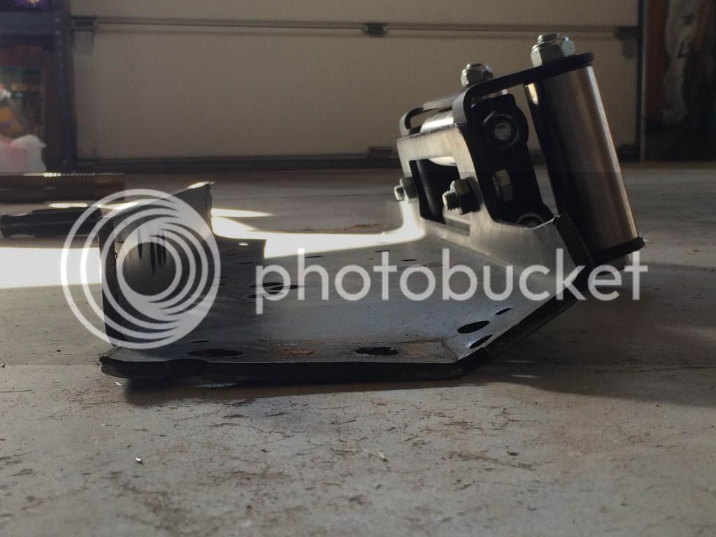

Those of you that went on the Chinaman run may remember me smashing up the roller fairlead and winch plate. I also managed to put some hurt on it on Kane Creek in Moab. Here's what she looked like after I took it off....

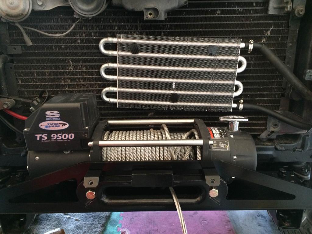

I wanted to get the new mount above the frame rails, as well as tuck it back as far as I could. And most of all, I wanted to get rid of that stupid roller fairlead. The one thing that prevented it from going above the frame rail was the trans cooler. So I picked up a different cooler that I could mount higher. It is rater for a higher GVWR than I need, so I hope it does the job that's intended.

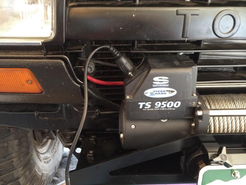

Also needed to make room for the box and to be able to plug in the controller (even though I have in-cab controls). So I had to modify the grill a bit. Not too difficult and I think it turned out pretty well.
I'm really happy with how it turned out. I've gained about 3" of height over the previous set up, and it protrudes about 2" less (most of the is due to the hawse fairlead). I also highly recommend the winch plate from Barnes 4WD. It's a dual pull plate, which is more suited for buggies so they compress the front suspension. But it looks great, and it doesn't have any holes in it other than to mount the winch. I found it a lot easier to drill the holes and not have to compete with the pre-drilled holes on the HF winch plate. Well worth the extra $$, and it looks much better too.

Cool looking winch plate. I also like how far you got that winch tucked in. Very nice.
Looks like a really nice setup. Great improvement in approach angle.
I asked about running a hawse fairlead with wire rope at 4wheel parts, and the guys there looked at me like I was crazy. Is your fairlead steel?
Yup. It's steel. It's a Warn unit I picked up off of Amazon. No issues with using a hawse with wire rope, as long as it's steel. Steel wire will chew through the aluminum ones. But those are made for synthetic ropes really anyways.
