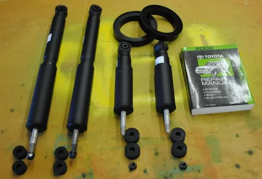

The first of what I'm sure will be many...
I've got everything I need to put in my sooper-dooper ski-high lift. That's right, next time you see the 100, it'll be 1.18 inches taller!!!!! ;)
Hey man, an inch can make a lot of difference! I love this idea. And I'm a HUGE Stacy David fan. Been watching him since he hosted Trucks! before it was on Spike TV.

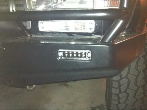

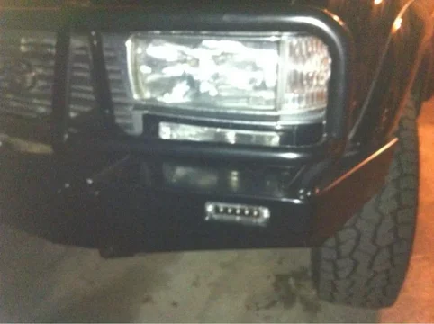

Been looking into lights to use instead of the ARB amber lamps. After a little research I found out that ARB's marker lamps are identical to 1st gen VW golf front marker lamps. A quick search of Ebay landed me these little gems.

Really? For all ARB's, or just the 80 series ARB? Neither of my ARB bumpers had lights when I got them. I just want orange units. Wanna sell your originals? We're going to need to see a night picture of your parking lamps on :)
Man Greg, those VeeDub lights look like a perfect match. I wonder how took their ARB to the junk yard and search all the different makes and models until they found those... :D

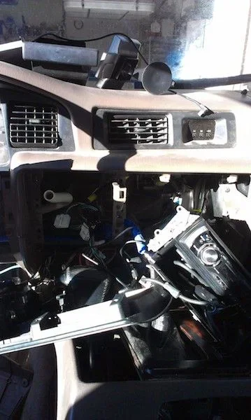

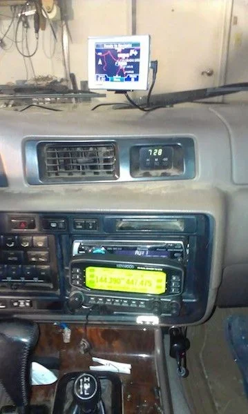

Got a Nuvi 350 with extras off ebay early cheap. The nice thing about this one is it will show other APRS stations as waypoints so comm is bi-directional to the radio. Got it mounted and installed this afternoon. Added a new power port against the center console on the passenger side under the dash.
before
after

Wow, I hate taking my dash apart to that degree. I always mange to break off a little clip or tab or loose a screw. They always rattle after I'm done. :mad:
As for the Garmin, does it let you see the APRS in real time?
If by seeing APRS in real time you mean seeing other stations in real time, then yes, kind of. The Garmin updates periodically based on the other station's beaching frequency. Every time my radio gets a data packet it will send that updated information to the Garmin.
You are right, it sure can be easy to break things taking the dash apart.

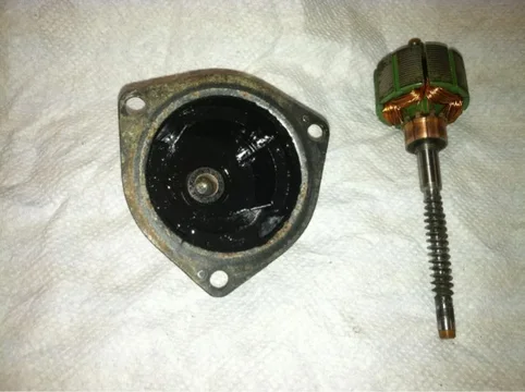

Elocker motor can all cleaned up and the inside painted. Glued the magnets back in with RC car glue. Cleaned the aluminum inside of the gear housing and coated it with battery corrosion spray. Re-installed the motor brushes and armature. Tested it and it works like bran spanky new. Nothing to it. Gerry Rafferty radio on Pandora jamming all night. Figured Travis would be proud :)
Wow - what are you going to do about that chunk missing out of the housing flange!?
I have the piece that goes in the hole and fits like a puzzle. Nothing a little silicone won't take care of :) I figure the O-ring seal is a terrible design anyway, looks to me like the aluminum is low grade, and corrodes quickly. Once corrosion builds around the O-ring, water will be allowed to seep past. I am going to seal the entire thing with RTV.
Yea, the o-ring is definitely crap. I've had trouble keeping my rear one dry even with rtv
