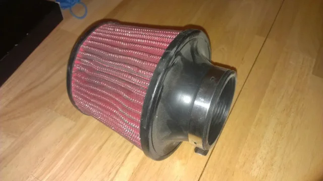

Looks like you got the intake, MAF, and ecu for the vorteq. How's it coming along?
I have this collecting dust in the garage. It's unused and generic, 3" opening, but if you want to run it (even temporarily) on the 60, it's yours.
Awesome man, thanks!
Bought the ECU off ebay for cheap. It's the right setup for my wiring harness, but found out after purchase that some numbers need to match up. Not sure if these do. ??? If nothing else, I'll be able to send it in as a "core" for a new one if I go that way. Still debating on buying a wiring harness vs. doing it myself (I've found some interesting DIY harness info on line lately). Need to send an email to 150Scans / Painless / Howell and see what they come back with.
As for the air flow stuff, I haven't had a ton of time to fiddle with it yet. From a quick fitting, it looks like the stock Vortec airbox will snug up nicely next to the inner fender. Just have to figure out how to get some nice cool, dust free air into the system ( http://www.ebay.com/itm/Snorkel-for-TOYOTA-Landcruiser ). :grinpimp:
