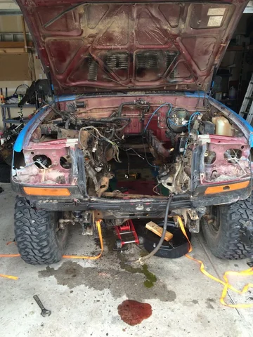

Well. It's out. Time to dismantle it further and clean it up. image.webpimage.webp
Dude that looks like a lot of work!! Not sure I could do something like that, Maybe one day. My stuff doesn't compare to what your doing that's for sure.

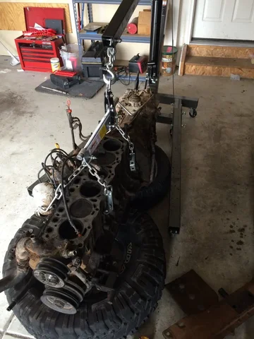

Both the transfer and Trans are leaking from the seals and pans. Wasn't too bad to pull it all at the same time. I'll probably install the engine/Trans as a unit, the. Unsta the transfer after.
It looks like you made pretty quick work of getting the engine and trans out of the truck. I hope it ends up being easy enough to get the whole thing in and out of the truck as a unit, since I think it will be easier to do the assembly outside of the truck.
Just the trans and motor should be a cakewalk. The transfer case really made it more difficult.
