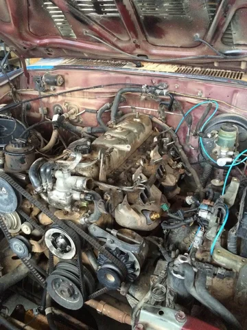

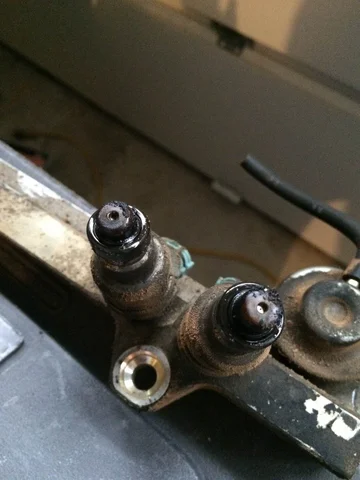

Got some more work done on the 80 today. Or disassembly rather. Upper intake is off as well as the fuel rail and injectors. Should have the head off in a couple days. Talked to some of the guys on Rising Sun. Seems like Rocky Mountain High Performance in Arvada has done quite a few cruiser heads and knows his way around them really well. So I think I'll be taking it up there to have it redone. Also, the injectors will be sent in for cleaning/rebuild and flow testing. As you can see, they don't look real pretty and could really use some love!

Nice work. I'm sure it's going to be great having a fresh 3FE! Are you sending the injectors to RC? I read somewhere that a real cleaning on these injectors is worthwhile after 23+ years, but I also read that they can't be rebuilt. I have no idea if this is true or not.
I'm going to send the injectors to Witch Hunter Performance since I've seen a lot of good recommendations for them. $22 to clean, replace parts, and flow test each injector. I'm sure there will be a dramatic improvement.
Tons of stuff to take off this motor. Trying to figure out how I could put it back in. Right now the plan is to put the short block with accessories in, then add the head and manifolds on afterwards. I'll figure that out as it goes I suppose. Hopefully have the head off and to the shop by next weekend. Want to be complete by mid March of possible!
