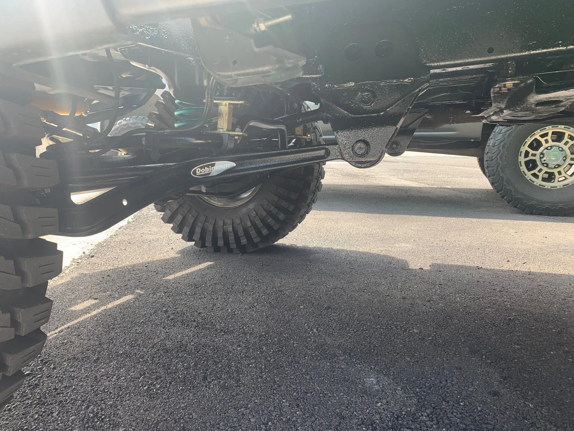

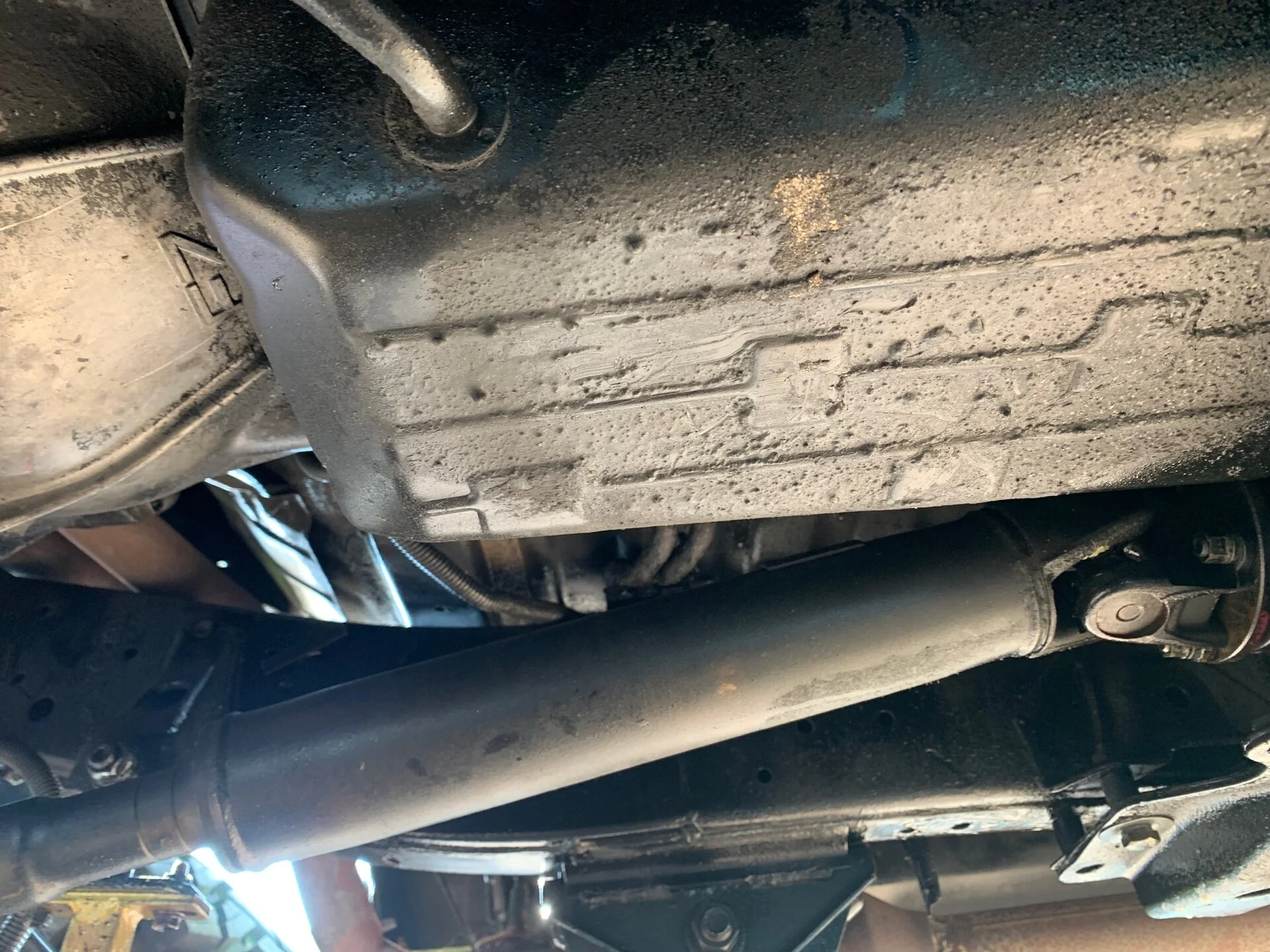

I do have a singe piece DS. didn't think about that causing an issue! I attached some pictures of my driveline angles, didn't think they were that bad! (pardon the shininess just coated everything with fluid film)

1) Your front DS is in phase. It needs to be 90° out of phase.
2) It appears you have no caster correction on your front axle. Your DS is in "brokeback" configuration and both joints will fight each other because of the orientation of your pinion angle VS your Tcase angle. They are supposed to be "opposite" each other.
3) Let's see pics of your Radius Arm drop brackets. Stay back a bit so we can see the DS angles and as much of the arms as we can.
It does have drop brackets for the control arms, and I didn't even think about an out of phase DS. that's wild. So would that involve just pulling the shaft out, and putting the yoke back in 90 degrees? Any tips or tricks fixing that?

Get rid of the tires and fix the driveshaft- itll drive like a different truck.
Any advice on a company for the double carden?
I would get it back into phase first and see what that does before coming outta pocket for a new shaft right a way. From the pics, the angles dont look too bad. If/when you need a double cardan, do a quick search on here for a vendor, or Im sure some of these other guys that have them will chime in. I do my own, but have always heard good things about Tom Woods from some guys Ive ran with that have them.
