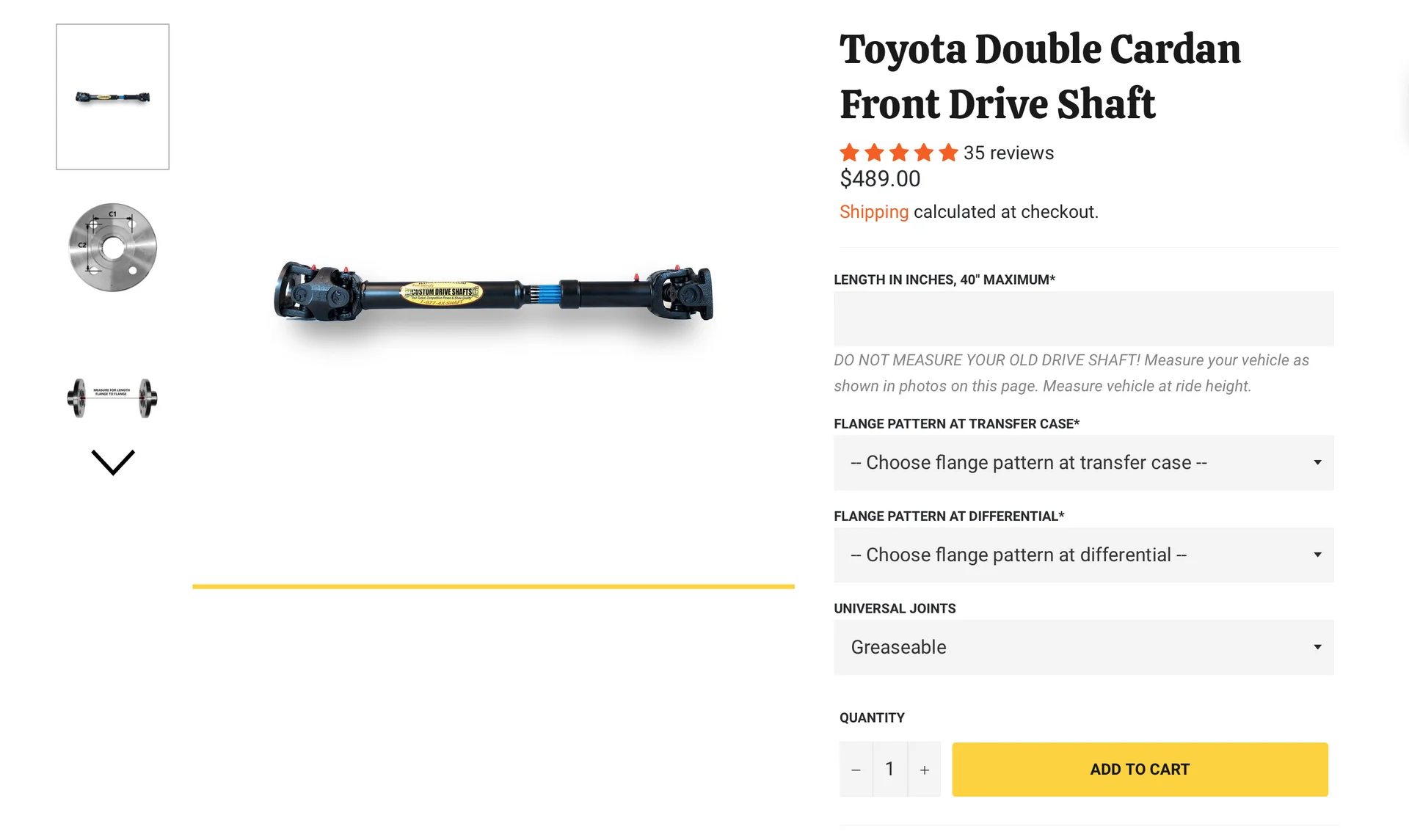

just cause I figure I'm gonna end up buying one anyway, what are the flange specs for the front drive shaft? And measuring length for a new DS will just be flange to flange from Tcase to pinion?
Copy and paste from my recent TW order -
flange pattern at transfer case: 60 x 60 mm (2.375 x 2.375 inches) 10mm bolt holesflange pattern at differential: 60 x 60 mm (2.375 x 2.375 inches) 10mm bolt holes
Hard to tell for sure, but your front DS looks like mine did (I'm at about 4.5" over stock, with caster plates). Front joint looks fairly straight, while the rear is angled. In my case vibes weren't BAD and not constant, mostly at certain speeds and when letting off the gas, but it would go through the rear joint within a couple years (matsuba or OEM) and need replacing. Finally got around to paying for a tom woods shaft, and it's been smooth since.
If you go that route, as mentioned, 60x60 at both ends, and length is just measured between mating surfaces with the truck at rest. The ujoints are easy to grease, but you'll need a skinny adapter for the ball on the DC end. They supply a plastic one, but recommended the plews 05-019 and it works well for me. Still a little tricky with the shaft installed, but works.
