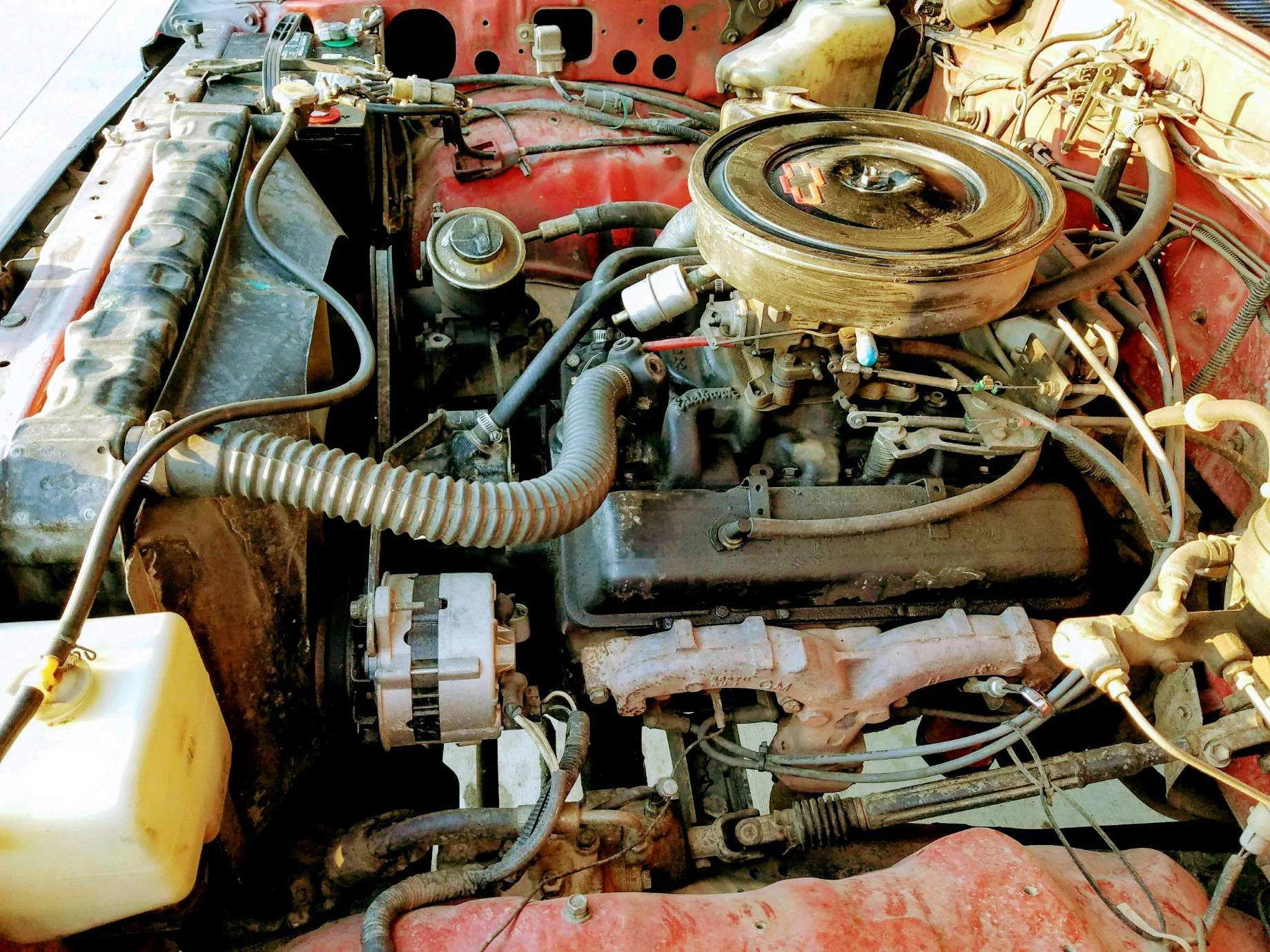

Make sure everything works. All gauges, switches, backup lights, AC, Cruise if it has it. Check the exhaust and how it's run. Oil pan clearance, bump stops extended, how is it cooled. Fan, shroud, etc.
From the visual aspect, did they pay attention to details. Clean wiring, fuel line, hose routing

Thats a great price if it isn't a hack job and isn't rusty. I have a 60 with a v8 and the extra power is nice on the highway etc. Just make sure whoever did the conversion took care of the wiring expertly or you will be chasing gremlins til you are in the poor house. Also make sure the cooling set up is up to snuff. Pics of the engine bay would be key in assessing how amateur or professional the swap is.

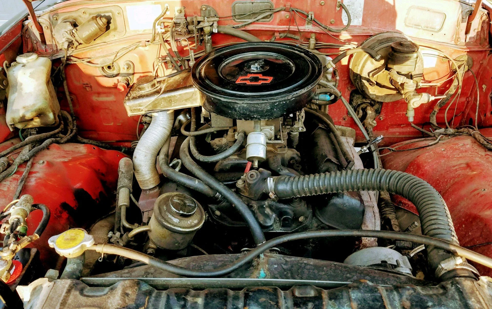

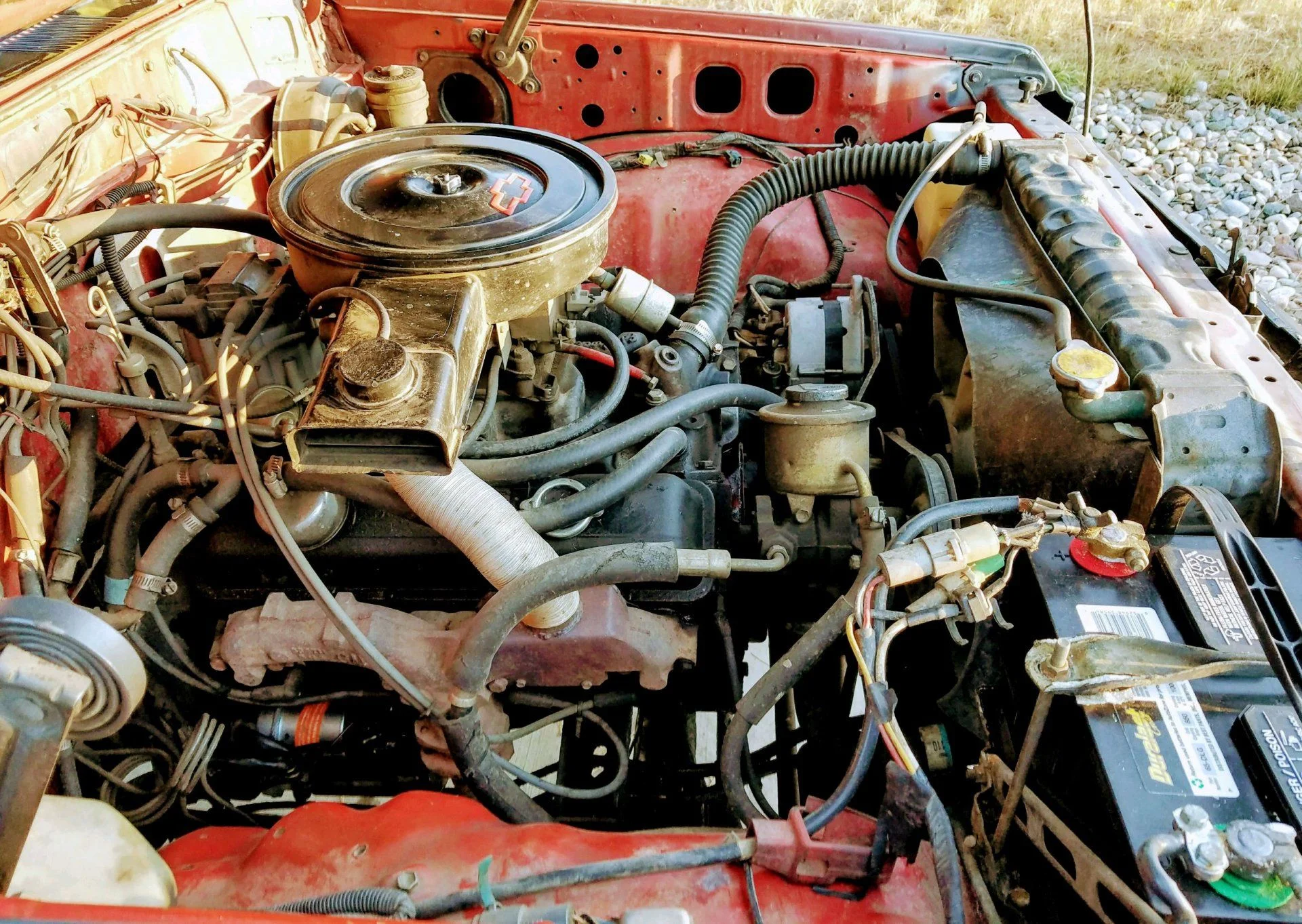

what's with the disconnected fuel filter on the front of the air cleaner? Weird....
For it to be smogged in CO the engine has to be the same year or newer than the vehicle, which would mean it would have to be a TBI engine, I can't tell from the pics if thats TBI or a carb.

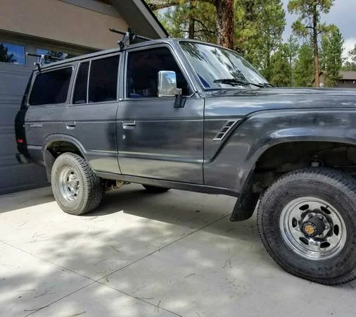

Car has been repainted, from the different underhood paint color, who knows if it had rust and was repaired correctly if it did.
6k may be about right but I would go lower to plan on some repairs. Thats not the cleanest looking engine bay, one too many zip ties for my liking. There is some strangeness afoot. Still if it runs/drives and is rust free go for it. Go over that paint job with a magnet and make sure there is no bondo lurking underneath. What does the undercarriage/frame look like?
If you have the cash down the road to change out the engine please paint that engine bay (pet peeve) Speaking of paint are the door jambs red also?
You should drive it. Get it on the highway, take it through the paces. Check all the fluids. Check the compression. Make sure the transfer case engages correctly. Look for leaks. The positive terminal on the battery looks a little scary to me - where are all those wires headed? If the truck really is rust free, drives well, and runs good - then I wouldn't have any problems paying 7k. 6K would be better, but trucks hovering around the 5-6k mark are getting real hard to find, in decent condition - especially with all the hipsters snatching them up.
